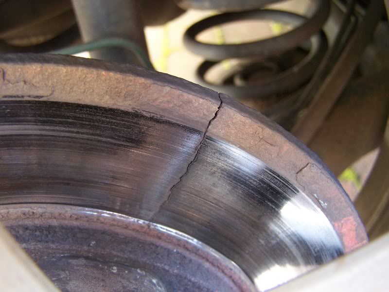

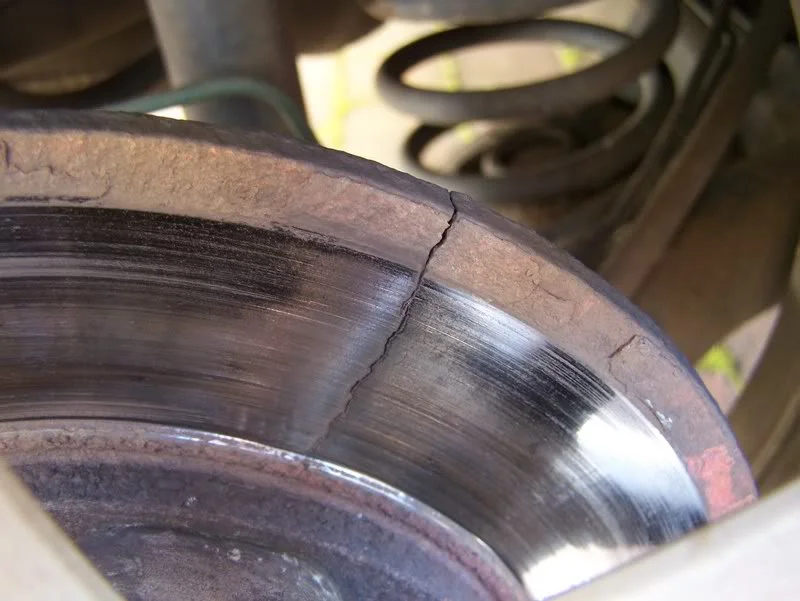

i would say that performance rear brakes are not needed on clio's. however... i did crack my rear discs (as many people have). the discs were on 7mm thickness. 4 years old. 45000 miles of wear.
