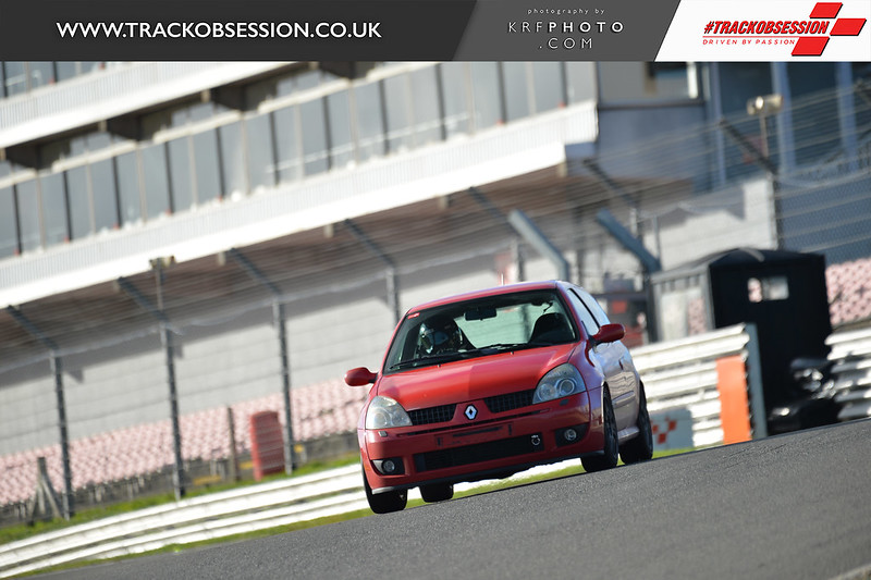

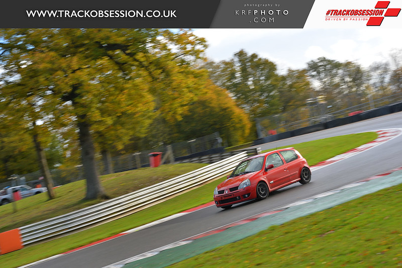

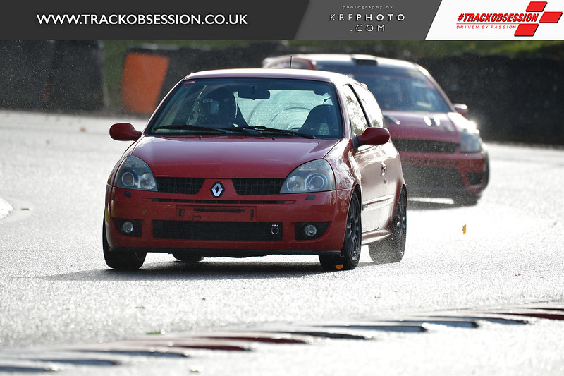

Pictures are uploaded from the day :D Is that three wheels?

Nice peddling! Never seen a Trophy corner so flat 😉
This car is an enigma :D
