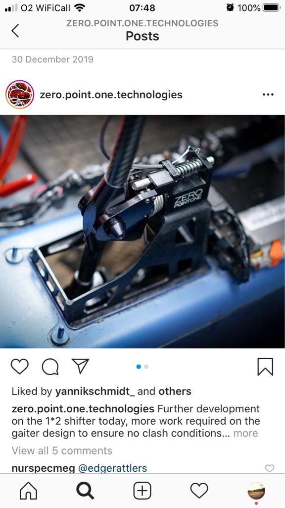

Zero point one are developing something.. don’t know when but I believe they are still at it.. give them a message on Instagram. Let me know if you hear back [emoji106][emoji106]

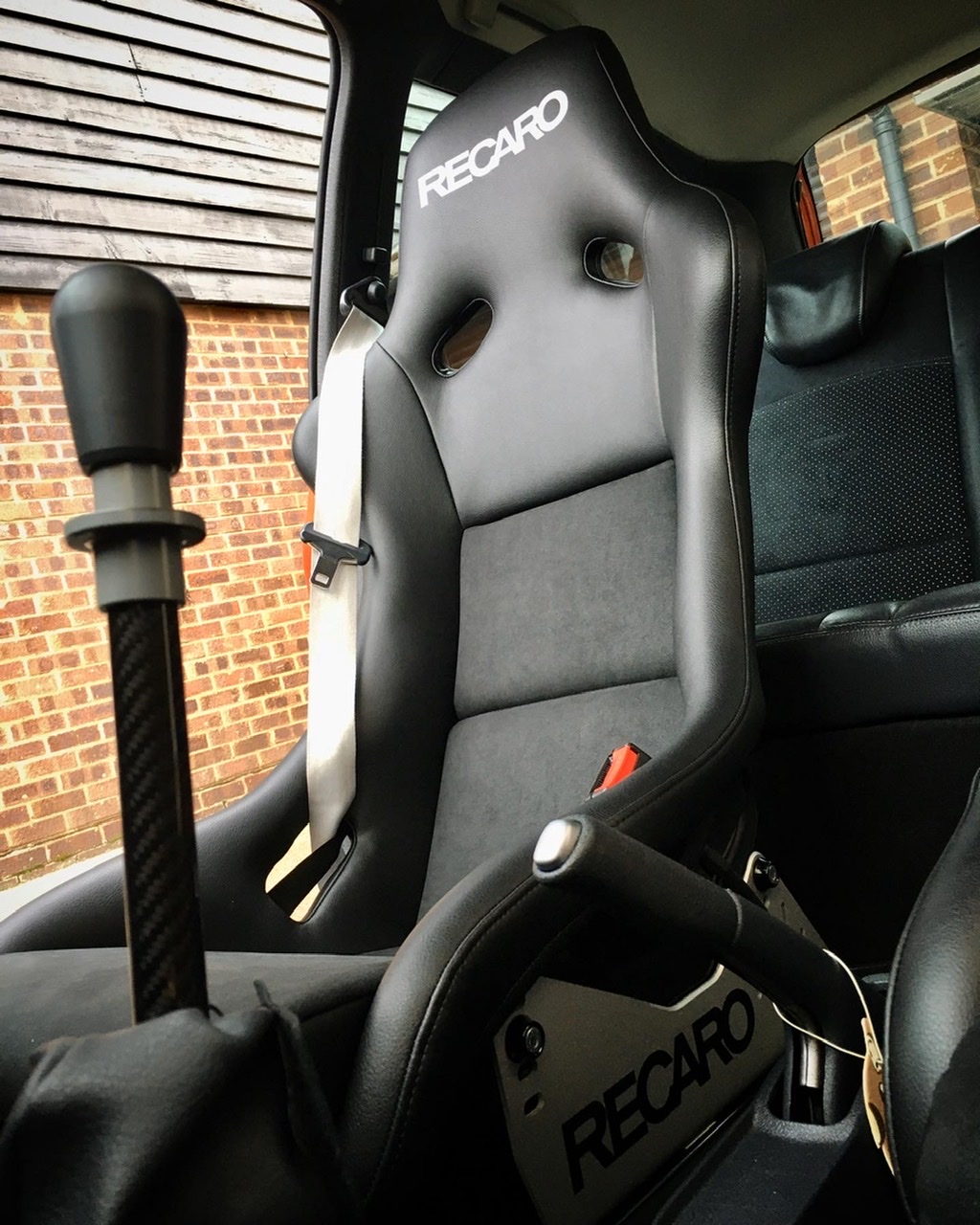

I'm going to fit the PMS with a leather gaitor so its a little more hidden.

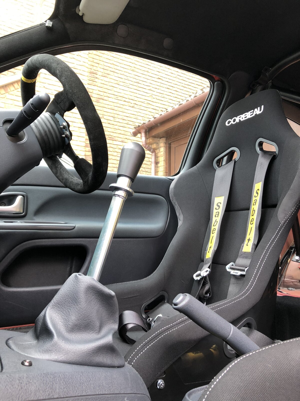

The CAE shifters are for cars with gear cables, but the 172 and 182 have a bar to the gearbox.
One is relatively simple. The issue for the businesses wanting to play catchup to PMS is they have to design a system that still seals the interior from the outside without breaching copyright on the design.
Certainly the Turkish one didnt and has a big hole. The ZeroPointOne has some work to do on that front.
So currently - spend the money, or rebush an original lever, or go BMS so you have an extended level.
