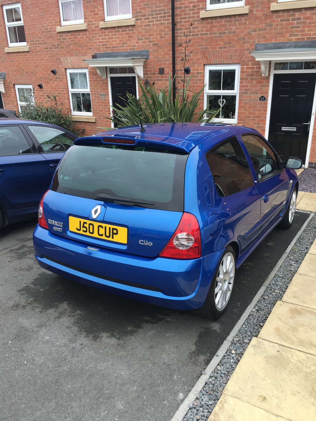

Our new cup
  Megane r26

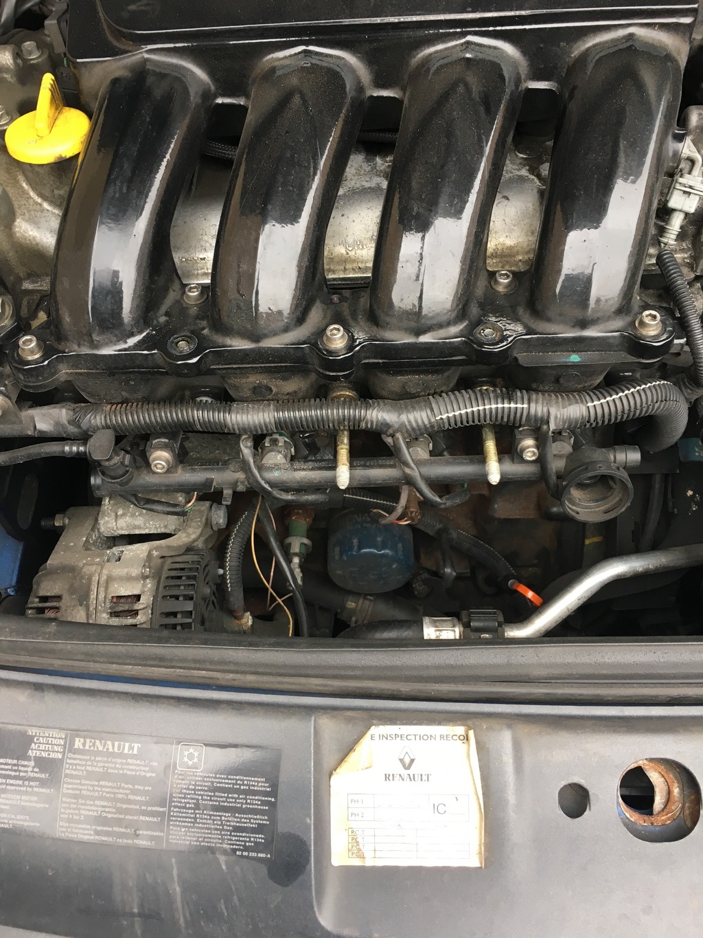

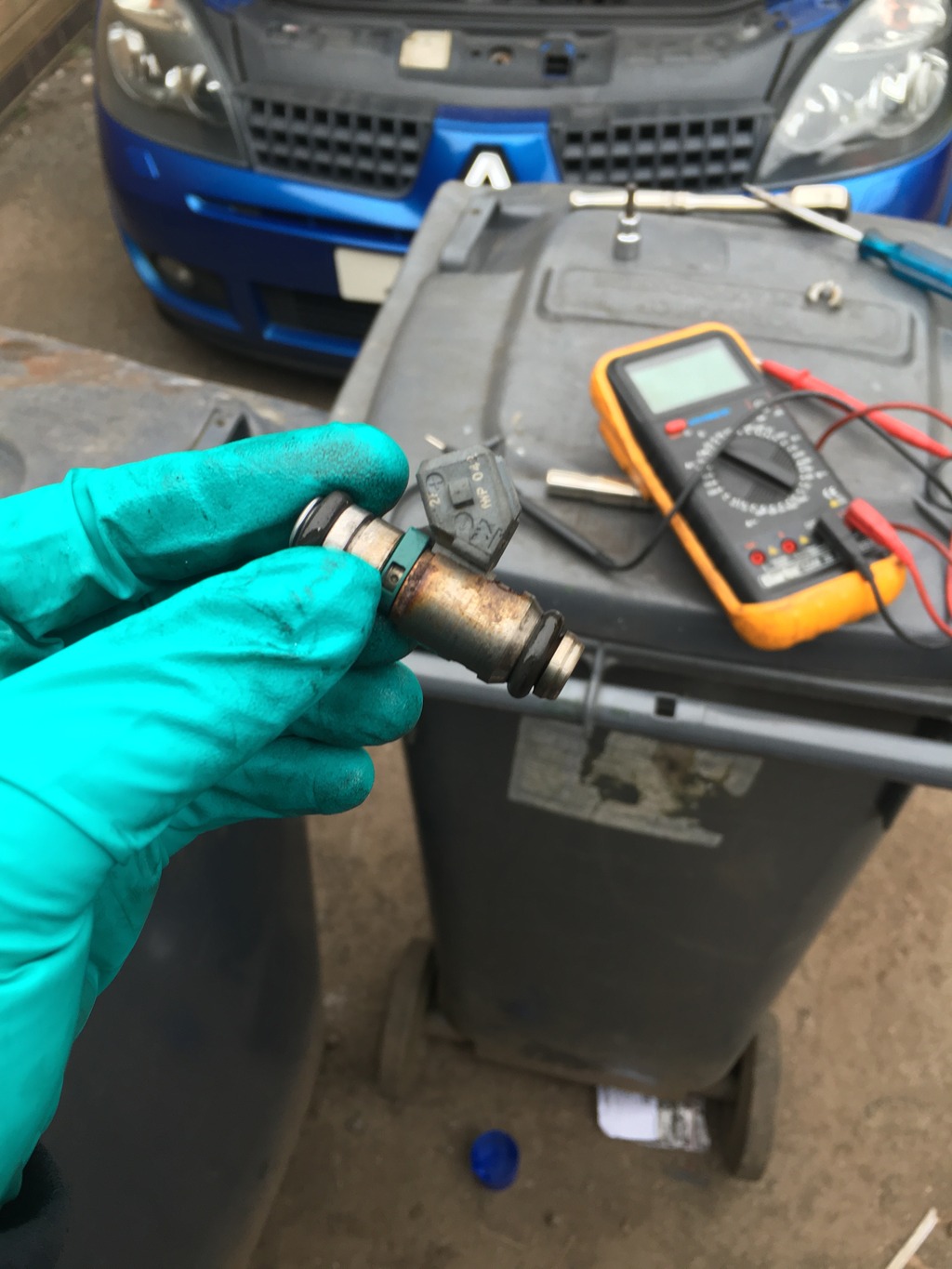

So we all know they idle a little lumpy but once warm it was a little more lumpy then usual. Now I know it had plugs and leads last year so my first point of call was to check the injectors
So out came the multimeter, number 3 was 8ohms so half what t should really be. Quick blast to euro and grabbed a new one for just over 30 quid.
So pulled the fuel rail guard off, unplugged the injectors and disconnected the fuel line
Offending injector

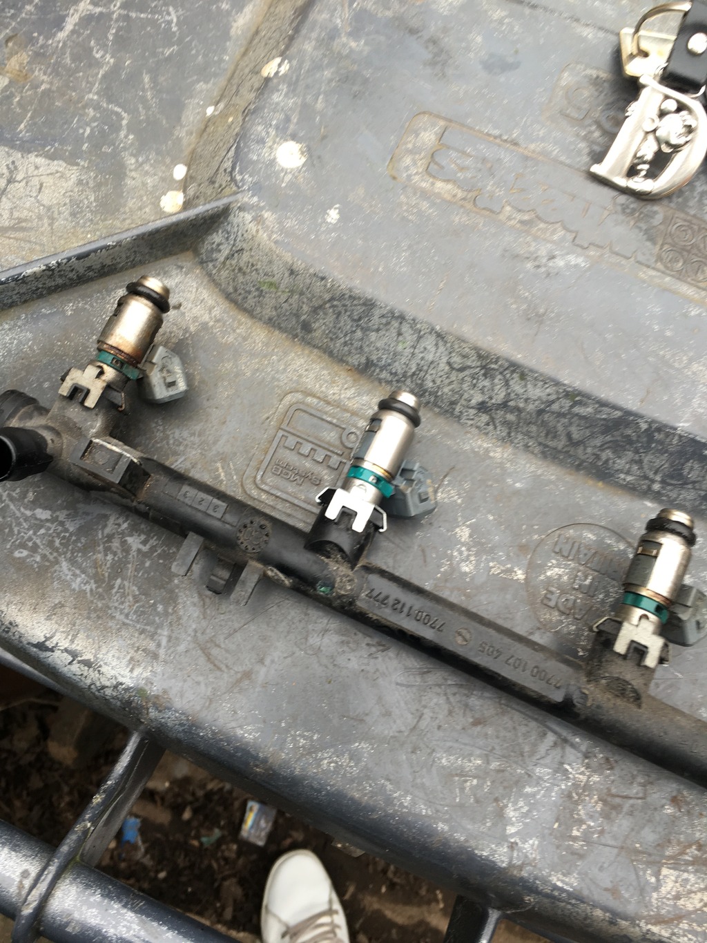

New injector on rail
Fired it all back together and normal service was resumed [emoji106]

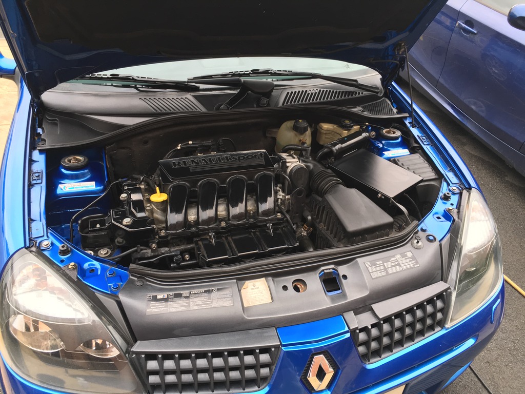

Even gave the under bonnet a clean

Are you thinking about painting the fuel rail guard and inlet silver?
I think that would freshen the bay up a treat.
  RB Clio 182
It's actually all been powder coated tbh mate so I was just going to leave it. I was going to give the rocker cover a dusting of silver but that's it
It looks better than first thought after seeing it again on the desktop.
I couldn't see it properly on my phone mate, yes it looks pretty good :)
