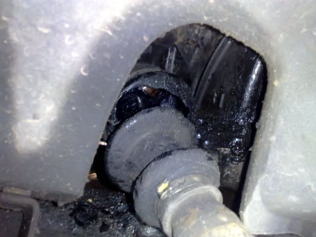

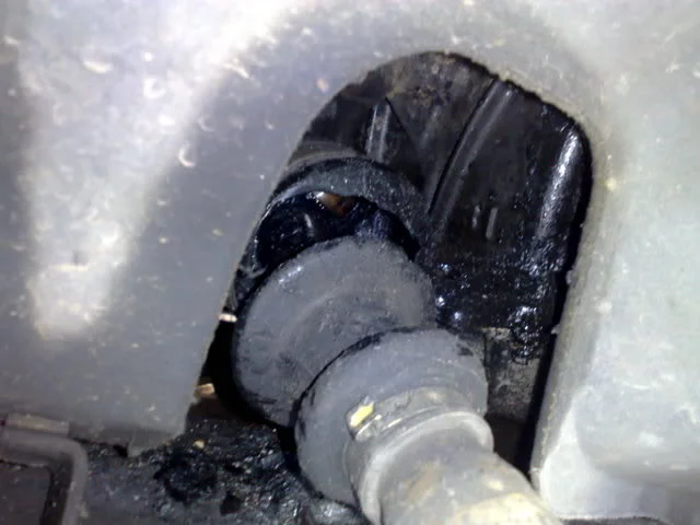

This is whats happened to mine :(
Also related I think..my abs/asp and serv light have come on due to grease I think :(
^ Feckin hell Rich mine was only a tiny nick where the outer boot clip is.
ESP & SERV lights were randomly appearing too but went out again when you turned off & on. Haven't came back on since the boot was sorted :)
Looks like new driveshaft time then..I tried cleaning up the abs rings today but that didnt help..im not too worried about driving around with them not working though....cant say I noticed any difference earlier..in fact im sure it helped my braking!
