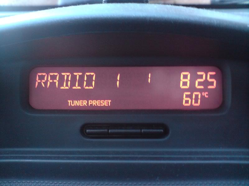

Is this a common problem then? cos mines just gone mad, says its a toasty 33 degrees sometimes dropping to 28! are they easy to change if i get hold of one?
Oh aye definately feeling that one^^ i think yesterday i was up in the high 30's definately good weather were having:eek:
