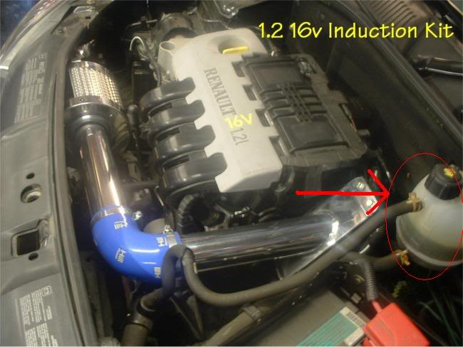

He shouldnt just be filling back up with water. Needs coolant added to it. There is a coolant bottle towards the back of the engine bay, if he has filled it at the rad then it wont have anywhere near enough fluid in the system so he will need to top it up. Also check the engine bay for white marks as it probably has a coolant leak.
he needs to top it up here says on the side the min/max levels..
Water will work, but adding coolant to it makes it work a hell of a lot better. If he hasn't topped it up in that bottle and just filled it at the rad I would put money on it not having enough in the system. As I said previously, it probably also has a leak if it was overheating before hand.
