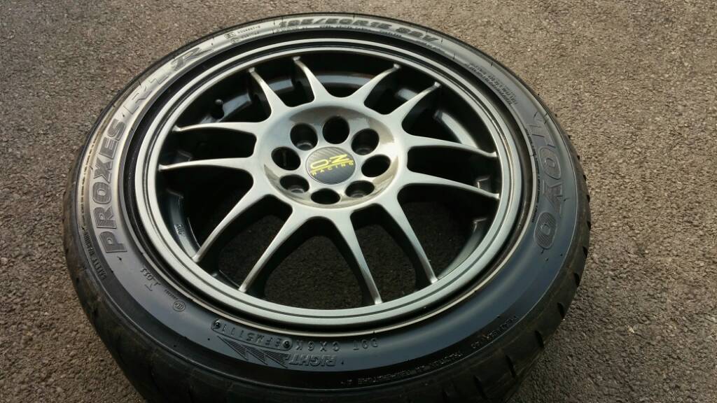

Oz f1 won't sit right on car. Knocking when cars moving.
Got some 2nd hand renault oz f1. Fitted them but as soon as I pulled off there was a clunking from front end on every rotation, even at 10mph
Pulled back in home. Jacked up and the front right wheel I could rock back and forth on the hub by hand almost 1mm.
Took it off, cleaned both faces. Refitted. Still the same.
Took it off. Cleaned both faces again and rotated the wheel then Refitted. Still the same.
Tried my standard 182 wheel and sits fine.
Tightened the wheels up very tight too and still the same.
Very strange, and very gutting. Been looking forward to using these for ages and suit the car so well. But I can't use them.
The wheel looks to be in good condition with no visible buckles or damage repairs. Haven't had it balanced at a garage, that would be worth a try.
Is the only option to take it to a.machine shop to have it skimmed?
Any suggestions? I don't know what to do next

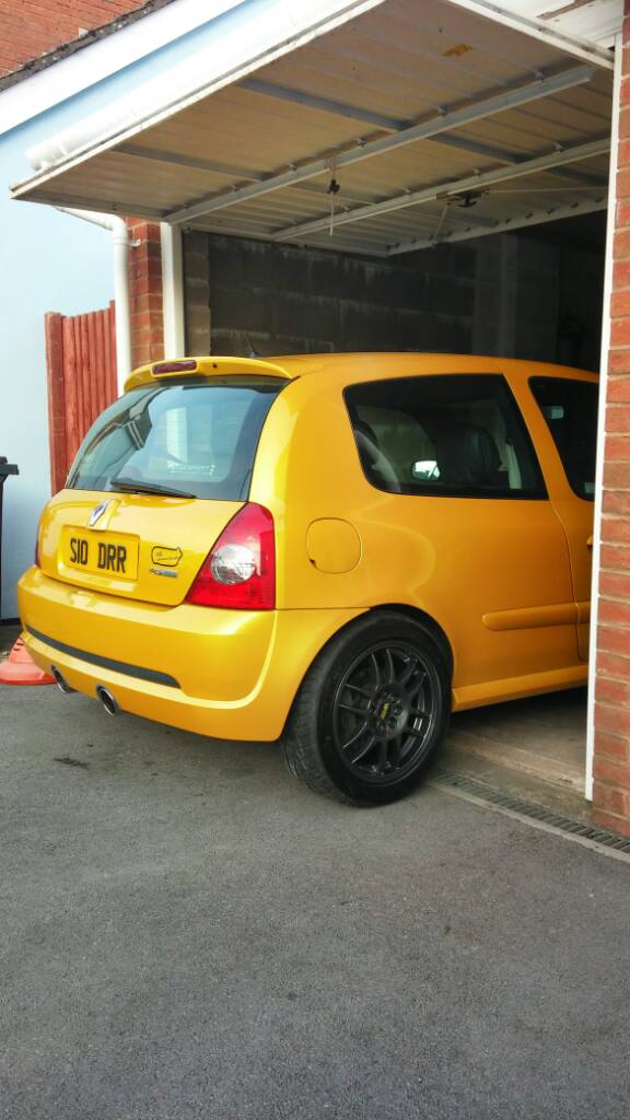

Got my hands on the car this morning. Good news. Wheels are on and all ok now.
Took a grinder to the front bolts to shave approximately 2mm off all front bolts. Rears are fine as their stub type spacers.
Thanks for the help all. Forum saves the day yet again!
Worst pic ever taken;
Hammering down outside so was out of the window jobby [emoji3]
