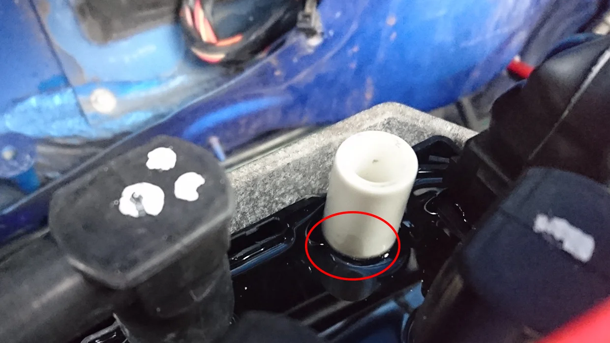

I switched the coilpack for a new one with no improvement but when I went to change the ht leads I noticed a mark on the new coilpack, has it blown?
