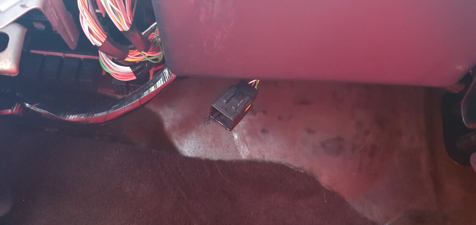

first go under the glove box look under near the bonnet release catch and locate a white connector pull it out give it a good blast out and then wd40.
i was told to do this buy rensport as the previous owner said ask him what he did to the electrics to sort it......it worked straight away.

Thats bizarre. Do you know what that conector is actually for? Must be for something regarding running otherwise why would it work. I dunno, these french baguettes blow my mind sometimes.
tbh i still dont know what its for just followed rensports advise and it worked, weirdly the car still runs unplugged.
he said my car was in to him and it took him a while to figure it out and it ended up being a condensation issue down at that connection.

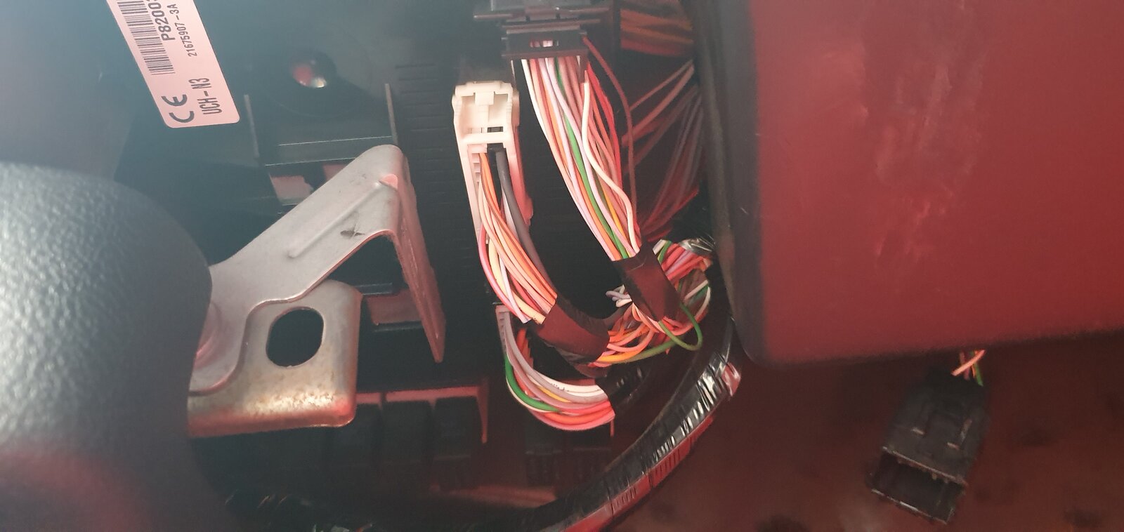

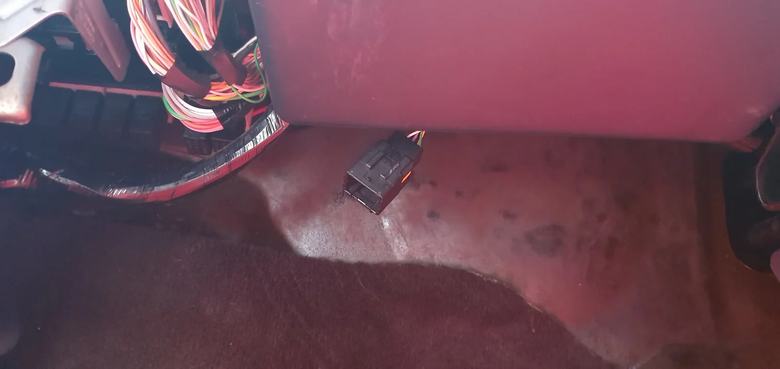

Also, for clarification, we are talking about the white plug pictured?
You've both said different things!
The inside "white connector" is the one above where the passengers feet would go.

Just realised I'm talking about a different white plug 😂
That one in the picture is on the UCH, which pretty much controls the electrics side of the car, like lights, wipers, locks...
Whoops. So where am I finding this magical white connector before I dip my car in a vat of WD40 and cross my fingers :ROFLMAO:

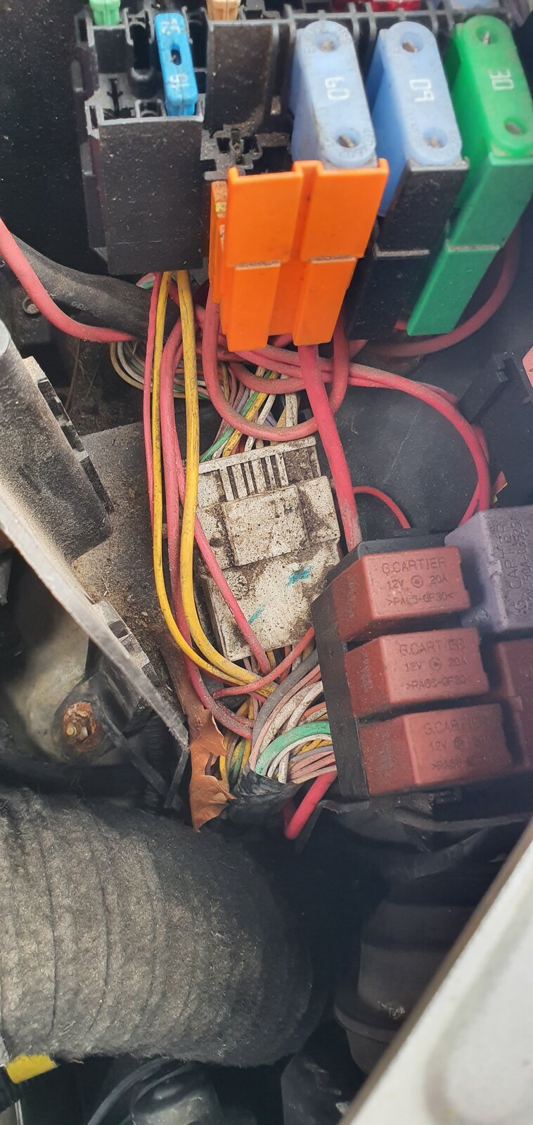

The engine bay I cant sort today as I should be working!
Maybe later I should swap out cylinder 2 injector with a spare I have?
I tried to unplug the white one in the engine bay fuse box but couldnt, just would not play ball!

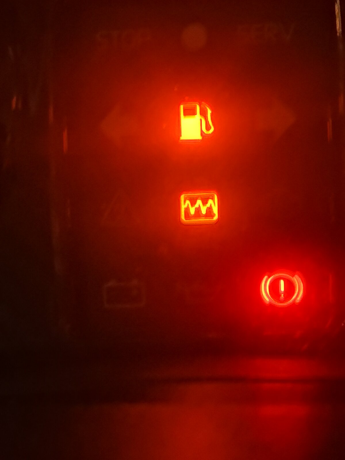

Now it wont start looooool. Turns over 5 times maybe then cuts. Had this the other day randomly. Ideas?

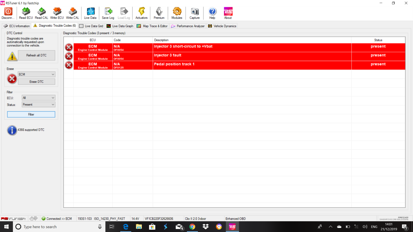

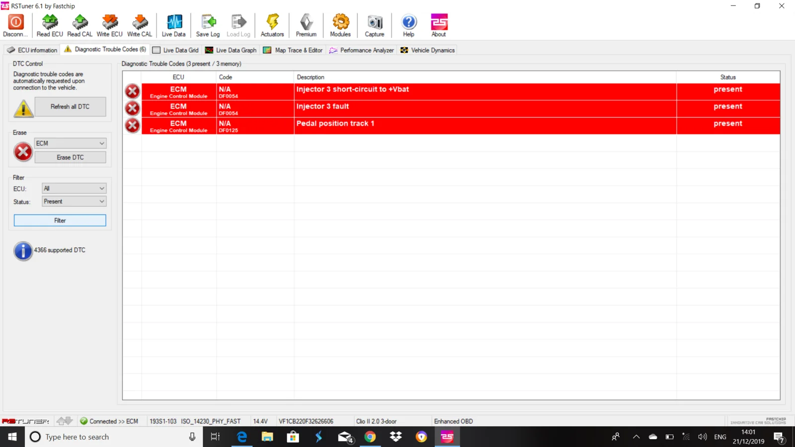

just cleaned mine out only injector 3 says its faulty but now a new alert code has come up and car wont rev high or at all when in reverse gear
