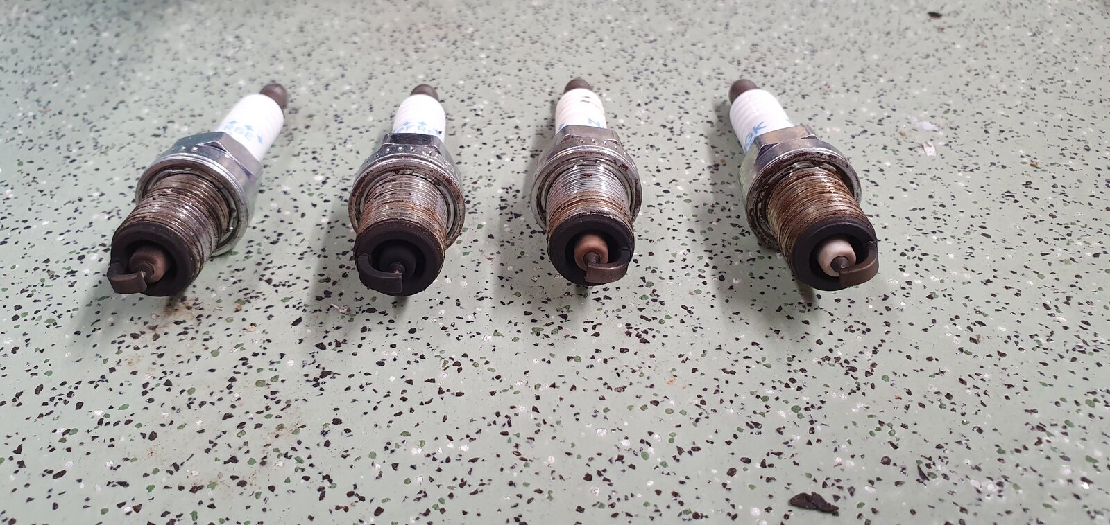

See below for the spark plugs. They're in order. Spot cylinder 3!
  dan's cast offs.
Plug gives it away but if the reader just brings up a generic misfire see what it says under freeze frame data, that normally tells you what cylinder.
