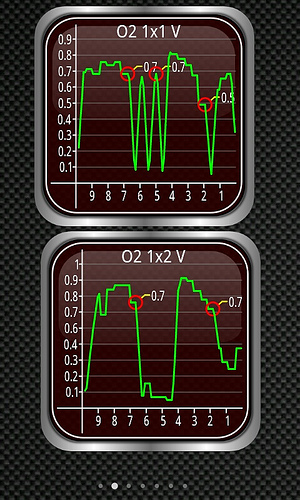

just an update - it seems after the car gets warm the 2nd sensor goes a bit crazy, looks like this...
does this mean the cat aint working properly when warm?
thanks!
Dave
Would look like it, was this after a blip or anything like this?
Would really need to look over a longer timescale. If car is at idle does the 2nd one switch consistently?
the reading above was what I was getting for a 25 mile journey.
after the journey this is the reading i got when the car was left at idle for about 5 mins...
