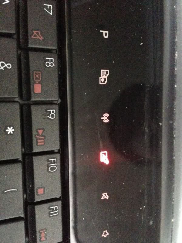

The screen stays black with the HDD in or out of it mate. Wouldn't mind but it's a decent laptop and he's a great mate (my detailer ;) ) so if I can get this sorted some free valeting muhaha. If you look real close the screen does a very small flicker then stays off the rest of the system powers up the lights all light up on the keyboard and one light stays lit not a clue what it's for though? Possibly touch pad lock, here it is:

Exactly the same as mine mate, the hdd light doesn't flicker or make a noise at all
