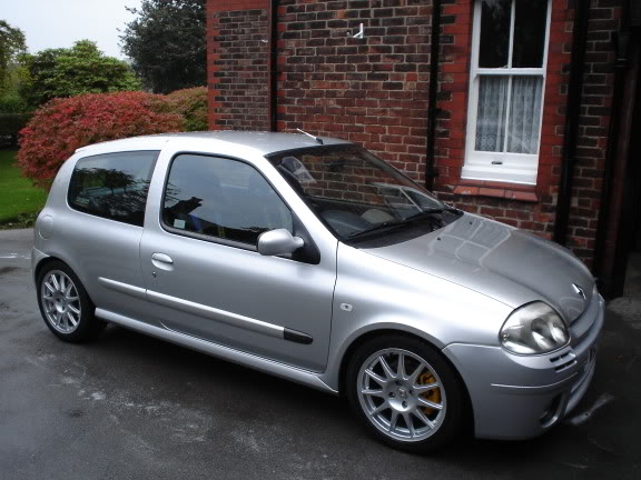

Twas a fine day yesterday so got me calipers painted :)
im liking the yellow, took me pretty much all day cos i did three coats of paint :S
stage one in the preperations for fcs is now complete :D

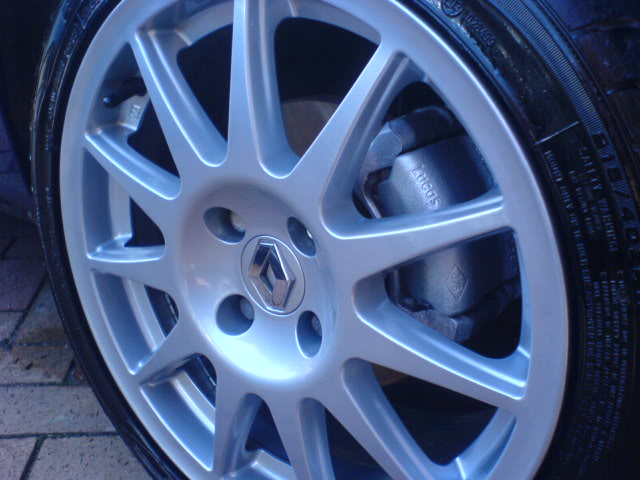

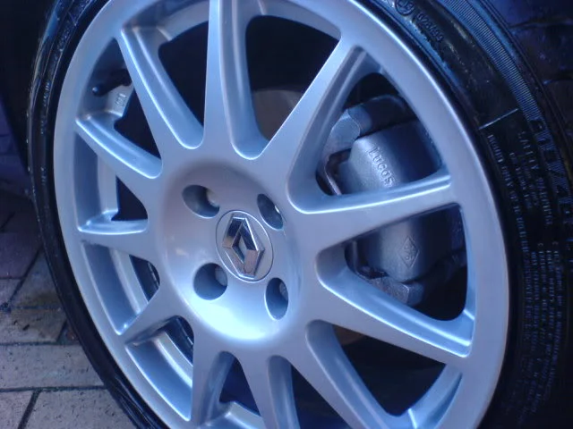

heres one b4 shot cos they all pretty much look the same lol:
A front and back after shot:
one of the rear jacked up:
and one of the front with the wheel on:
im really chuffed with the yellow on the clue :D

gotta be yellow now ive seen this....any pics of the whole car showing the front and back calipers?

Have you got any more pics of the whole car showing both calipers in the yellow?
Thanks
  Tangoed Works
Looks very nice. Its amazing how puny the rear brakes look on these cars. No weight at the back, so not much more needed I guess.

Did u manage to get any more pics mate....Ive got the paint now just need to see a full side on view with the yellow
Thanks
  VRS
Thanks
soz dude, didnt wash the car in the end, was busy polishing the inlets, i will get a piccy for you 2moz (the car will be dirty tho lol)
its actually quite hard to see the back calipers through the wheels cos their so tiny :( but i will have a go for yer
