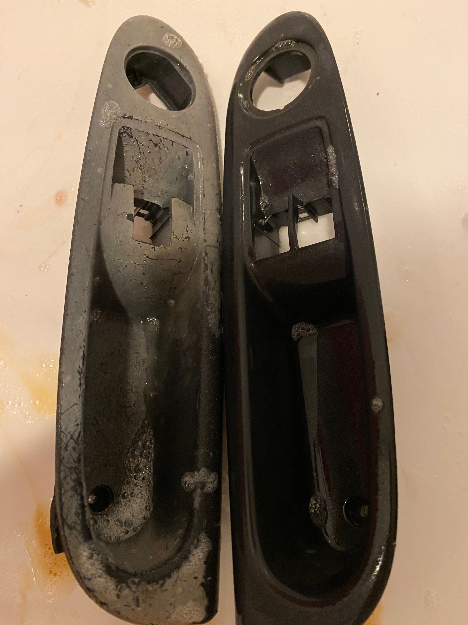

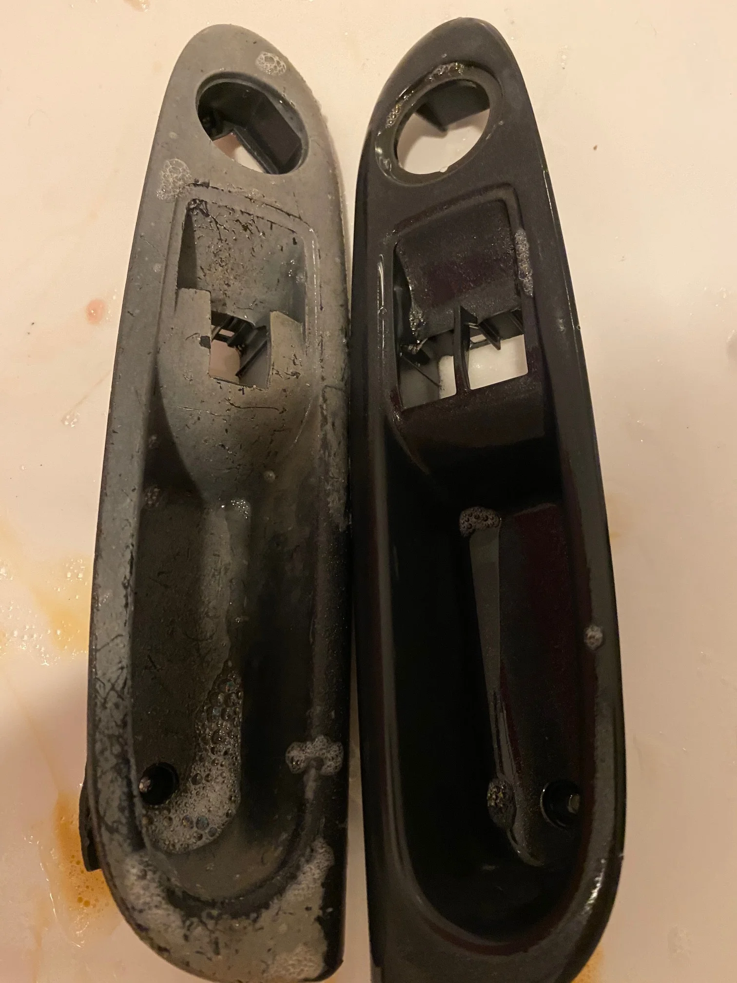

To be fair Mossy, I put them in a warm bucket of hot water and Fairy liquid mix and left for an hour. Came back with a sponge scourer and the result on the right was literally a couple of minutes of going over with the sponge.
I'd say it's got rid of at 95%+ of the sticky crap that was on there - I bet with a quick wipe down with rubbing alcohol or similar, the last dregs will come off completely. :)

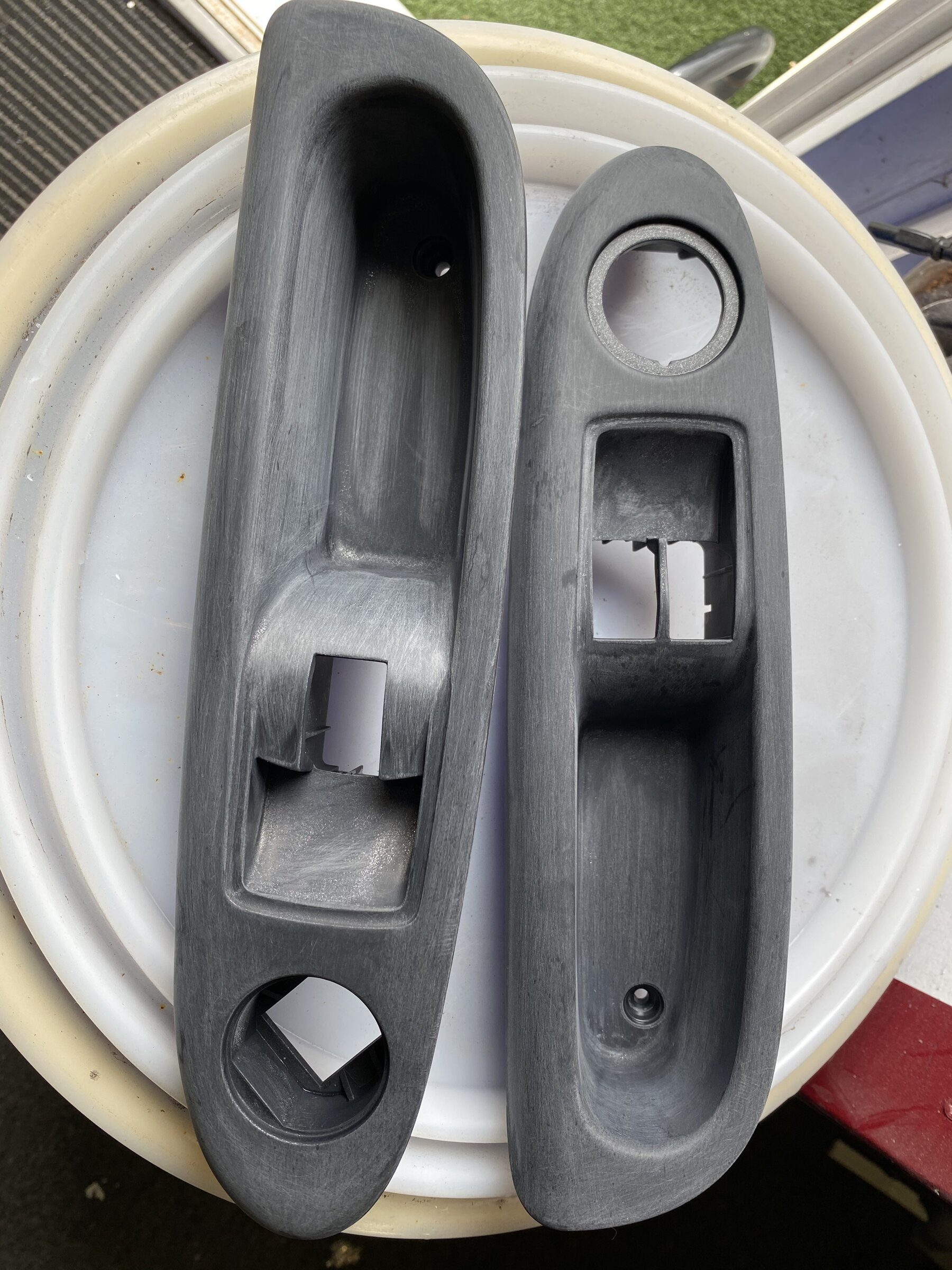

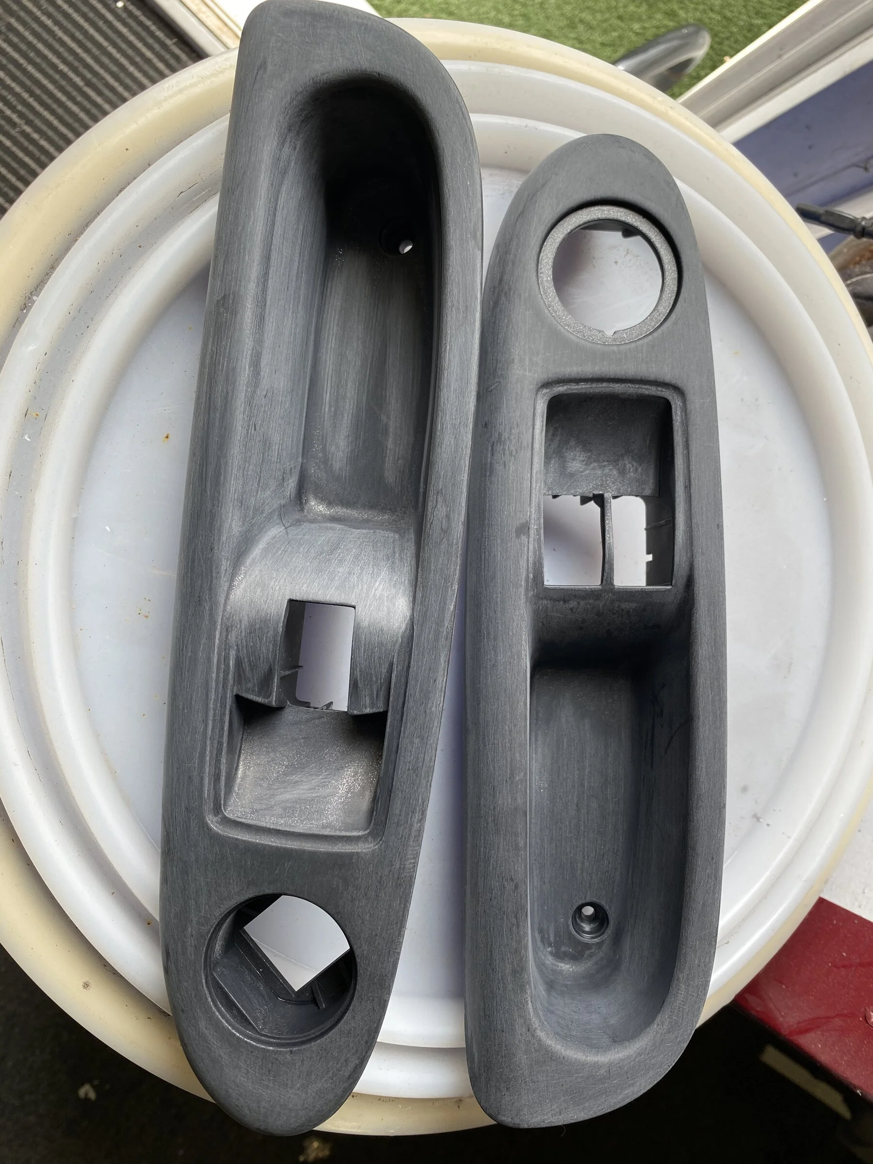

Next step done. Went over them for a few minutes with a fine grit paper. Got rid of the last bits without any need for further chemicals. Plus, it keyed the plastic a little for the primer - even though it probably didn’t need it.

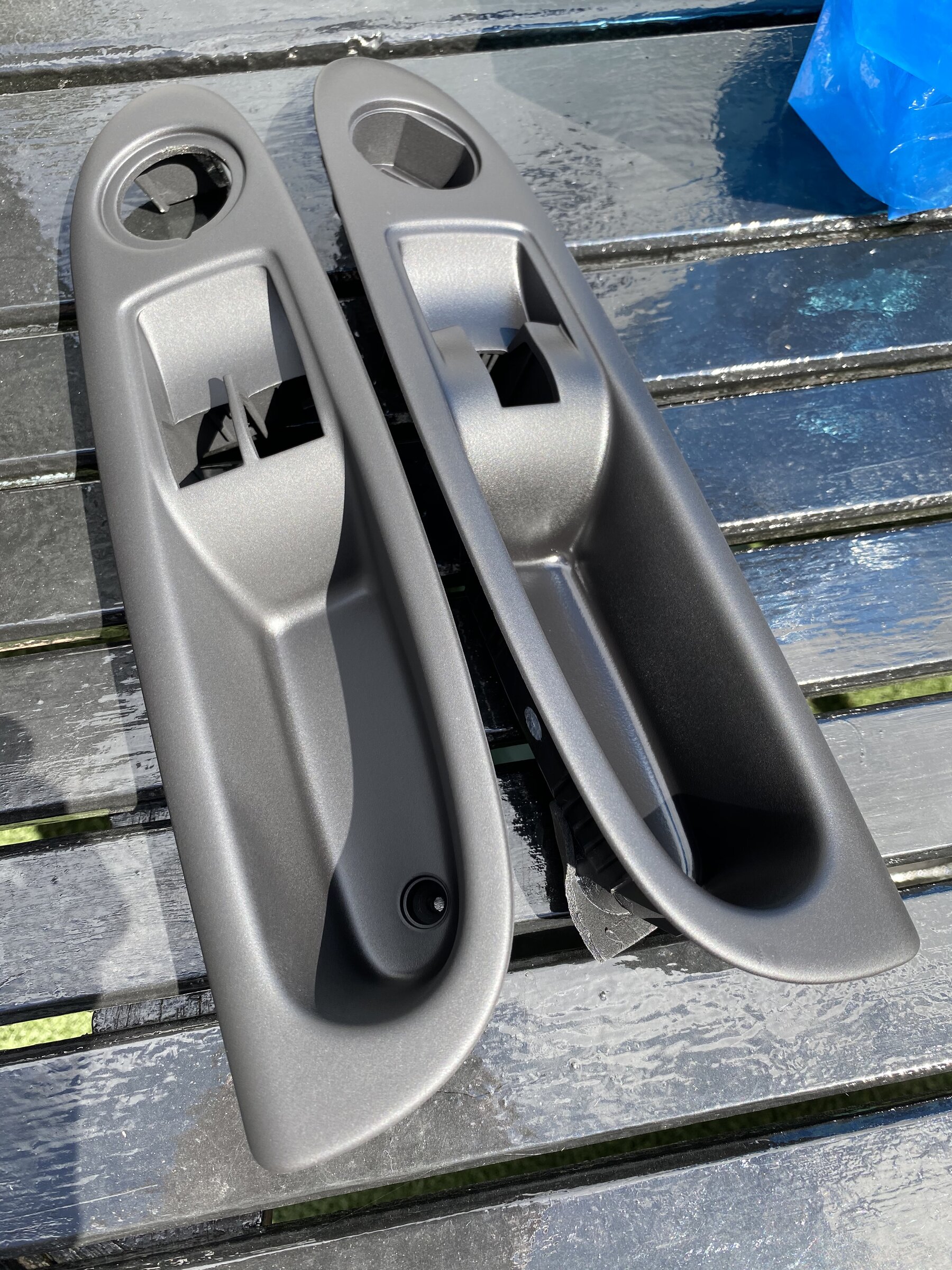

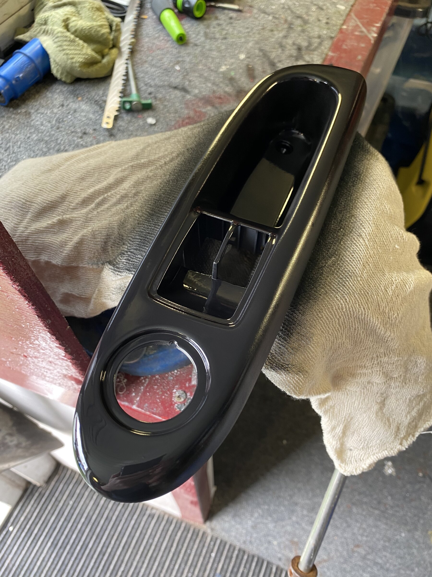

Using the primer, in several light coatings, it certainly applied itself well.
Then left them out to dry for a while. Will hopefully be painting them later today, followed by a clear lacquer tomorrow. So far, all good. 😃

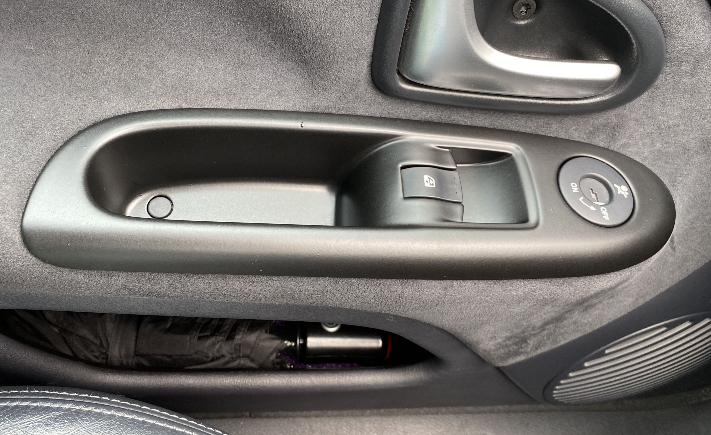

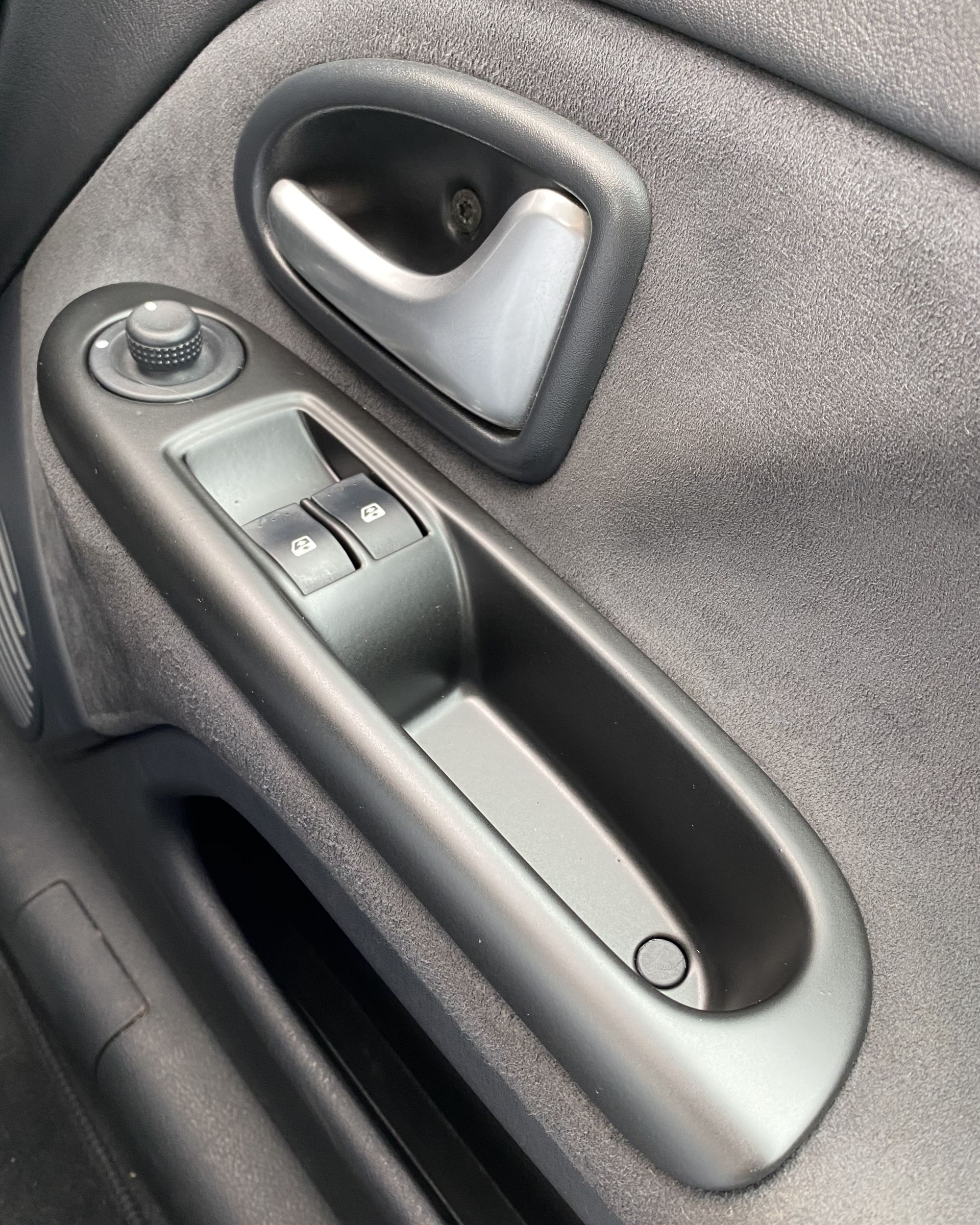

Fitted them in earlier. A big improvement, but not flawless by my (lack of) spraying skills! They started to get some dust on them within seconds it seemed, but at least they can be wiped with a cloth easily now.
