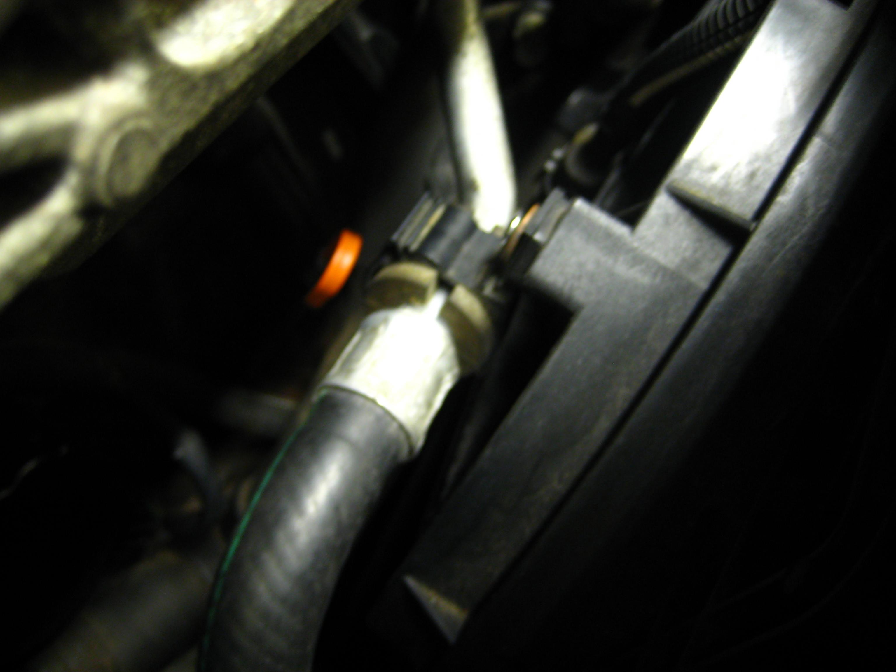

I'v bough today two original mounts that hold the PAS line...now if anyone could plese post a picture of the engine where to put the mounts that hold the PAS line.
thnx
i think one mount is holding the PAS line below the rail fuel guard, and the other one???
Anyone? Please help me with a pic of an engine bay where i can see the correct position of them
Which PAS line you talking about? If it is the high pressure line from the Pump to the rack then I can only think of one mount which screws onto the plastic fan shroud under the fuel rail guard and supports the flexible part of the line. The other mounts are permanent mounts brazed to the rigid pipe. They are bolted to the front of the gearbox, the end of the gearbox, the heatshield by the Exhaust manifold and lastly on the Steering rack.
yes Soot1e the high pressure line it is...could you or someone else post a picture of the plastic fan shroud so i coud know where to connect it? i can't locate it...do you have to remove the rail fuel gard to connect it?
thnx
can that mount that screws onto the plastic fan shroud be moved somwhere else, for example above, to the rail fuel guard or?
because on my plastic fan shroud i don't have nothing to connect the mount to...HELP
If you have a/c then I don't know the layout but on non a/c you don't have to remove the guard. The P clip just uses a short stubby self tapping screw to fix it to the shroud. Alternative is to use a cable tie. I'll try to do a photo later.
Yes i have a/c...i was thinking to screw the mount below the guard (it has 5 or 6 holes for a screw).
Because as i said on my fan plastic cover there is no place to screw it to. If you could have a better idea for placing the mount...
Please if you could take a close-up picture.
Thnx!
Just had a looksie. The high pressure hose comes out of the pas pump and runs under the bottom coolant hose, it is attached to the bottom hose by a simple double plastic C clip. the first true mounting is where the rigid pipe is bolted to the front of the gearbox. The simplest way to secure the flexible part of the pipe is to use a cable tie around around the bottom hose. You will have to jack the front of the car up a bit to get a good look. Cant get a photo. I was wrong about the fan shroud mounting, this is for the low pressure pas hose from the pump to the pas reservoir.
thnx a tied it with a cable, but could you please take a photo of the low pressure pas hose from the pump to the pas reservoir
IMG_0879.webp Taken from the top of the engine bay and looking from the offside. The fixing screw is at the top of the clip, you can just see the shiny head.
