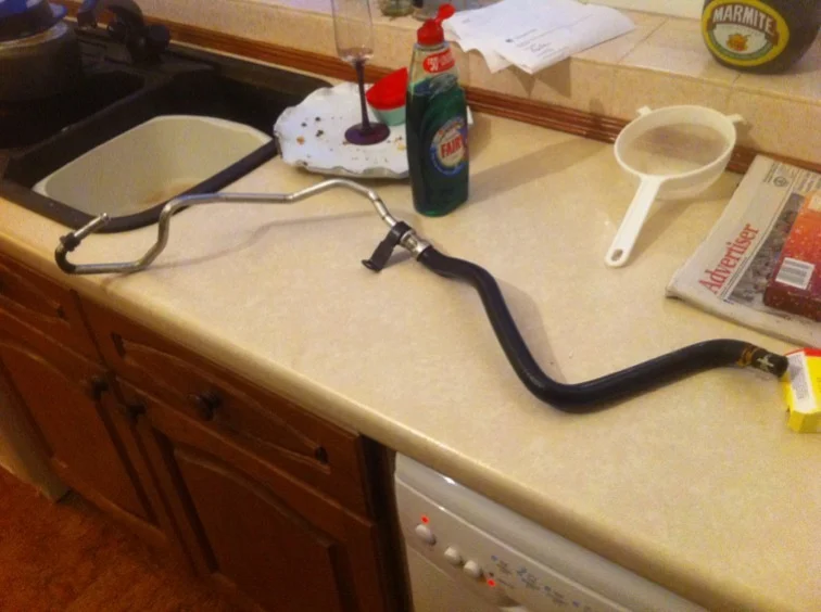

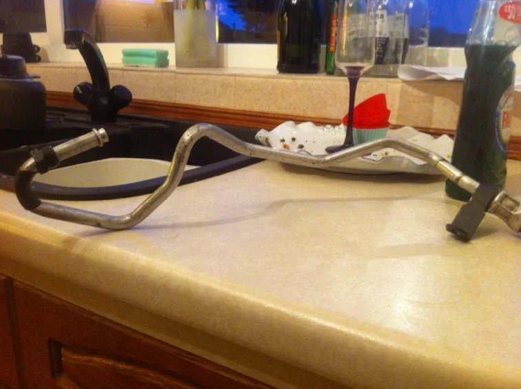

Power steering pipe, part number??
Does anyone know what the part number of this is, it's the smaller one that goes from the rack up to the pas fluid tank? Cheers
