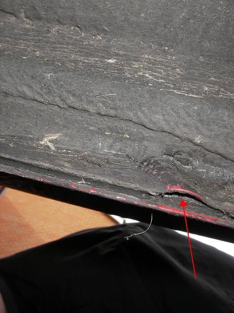

My floor is soaked, I noticed it a few weeks back. I think it may have been due to the bad winter with all the snow, hence people getting into the car with snow on feet, but there is at least a litre or slightly more of water on the deck.
Whats the quickest way to dry it, everything is lifted up to air can get to the snonge. Should I leave window slightly open? Have vents on hot and blowing on the floor?

Check the sill drain holes arn't blocked causing water to leak in. Theres a guide in the guides section of where they are.
it's hard to tell, but I think it's a pic of the front wheel arch. The drain hole is behind the arch cover closest to the door from looking at the guide. Not tried it myself, but it makes sense.
