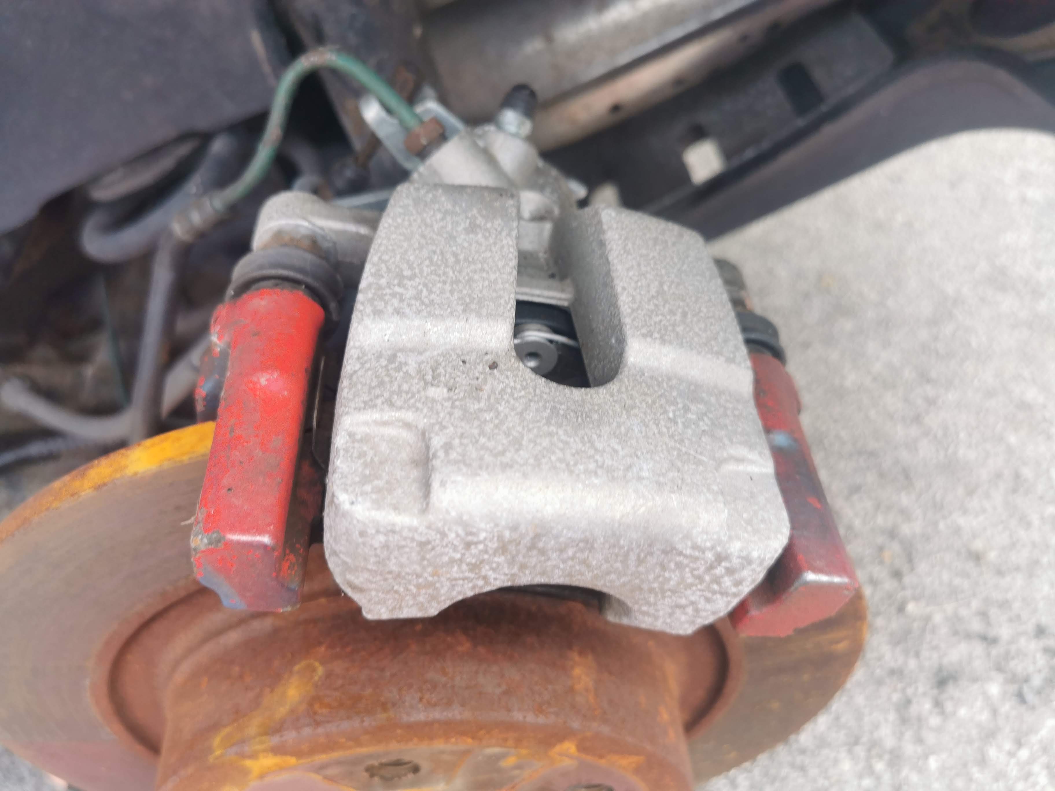

I had the week off work after easter and the car needed prepping for an MOT attempt. I'm not a fan of bleeding brakes, I'd prefer someone else gets the blame when I cant bloody stop and end up a tangled mess. So I booked the car in at my local garage for a once over and a service and in a massively optimistic way I booked the MOT for a couple of days later. But the brakes needed a bleed so I could drive it to the garage so I bought a gunsen ezibleed and some fluid and set about making a mess. Starting at the rear it turned out it wasn't just new discs that had been fitted by the previous owner.
New calipers on both sides too. After finally sealing the gunsen I managed to get a fair bit of air out of one side and the fluid was lioke new too so I moved onto the front. And then hit a snag. The bloody wheel won't come off! I wiggled it, waggled it and swore at it (lots) and then twatted it with a mallet and it didn't budge a mm! In a strop and with the Mrs telling me dinner was 10mins out I packed up and cursed myself for buying another clio😆. I'll have to revisit the front again but I'm hoping that the air that came out the rear will have done the trick. It only needed to get to the garage a mile away!
I also noted that the handbrake cable seemed fully withdrawn on the drivers side and yep the wheel was easily spun with it engaged.

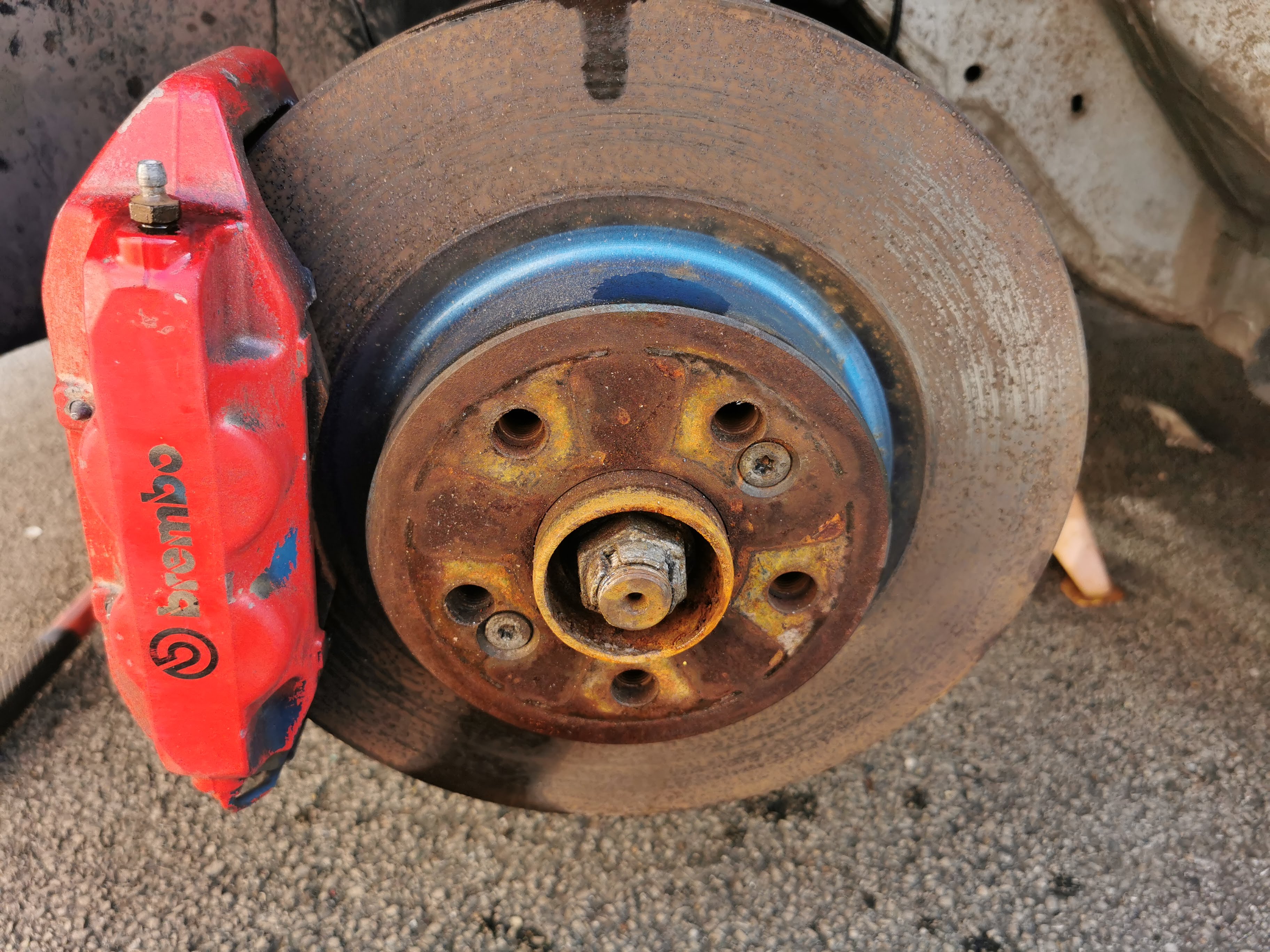

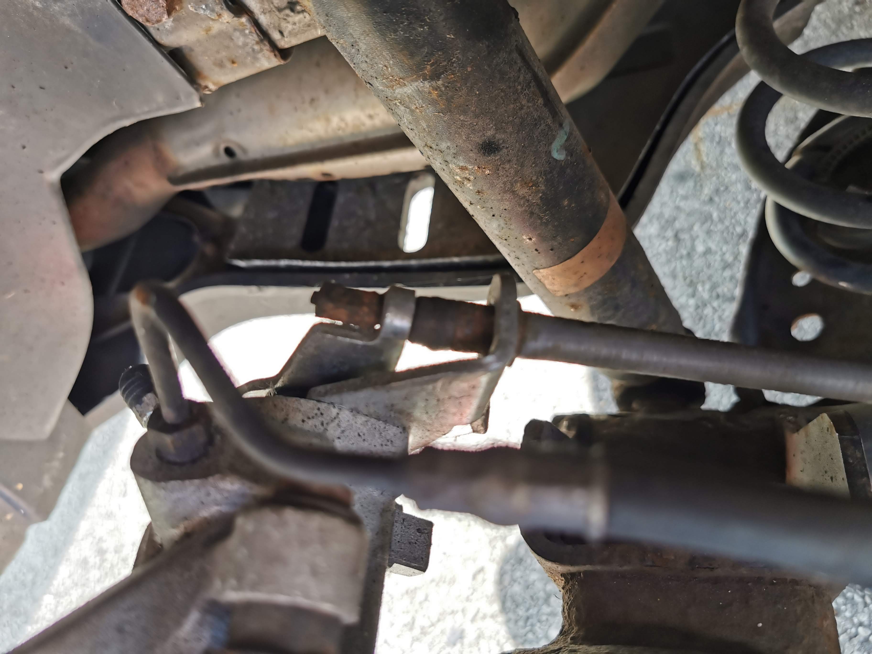

Up early the next day with the aim of getting the front wheels off first and then continuing the battle with the brakes. I'm not a fan of jacking clio sports up. I really don't know why they have a front and rear jacking point as they are so stiff either one lifts one side clean off the floor! With an axle stand under one side the 200 is even worse than the 182 as it was blowing in the breeze with 3 wheels in the air! With the front on stands and the rear back on earth my trusty deadblow mallet was recruited for some gentle persuasion.

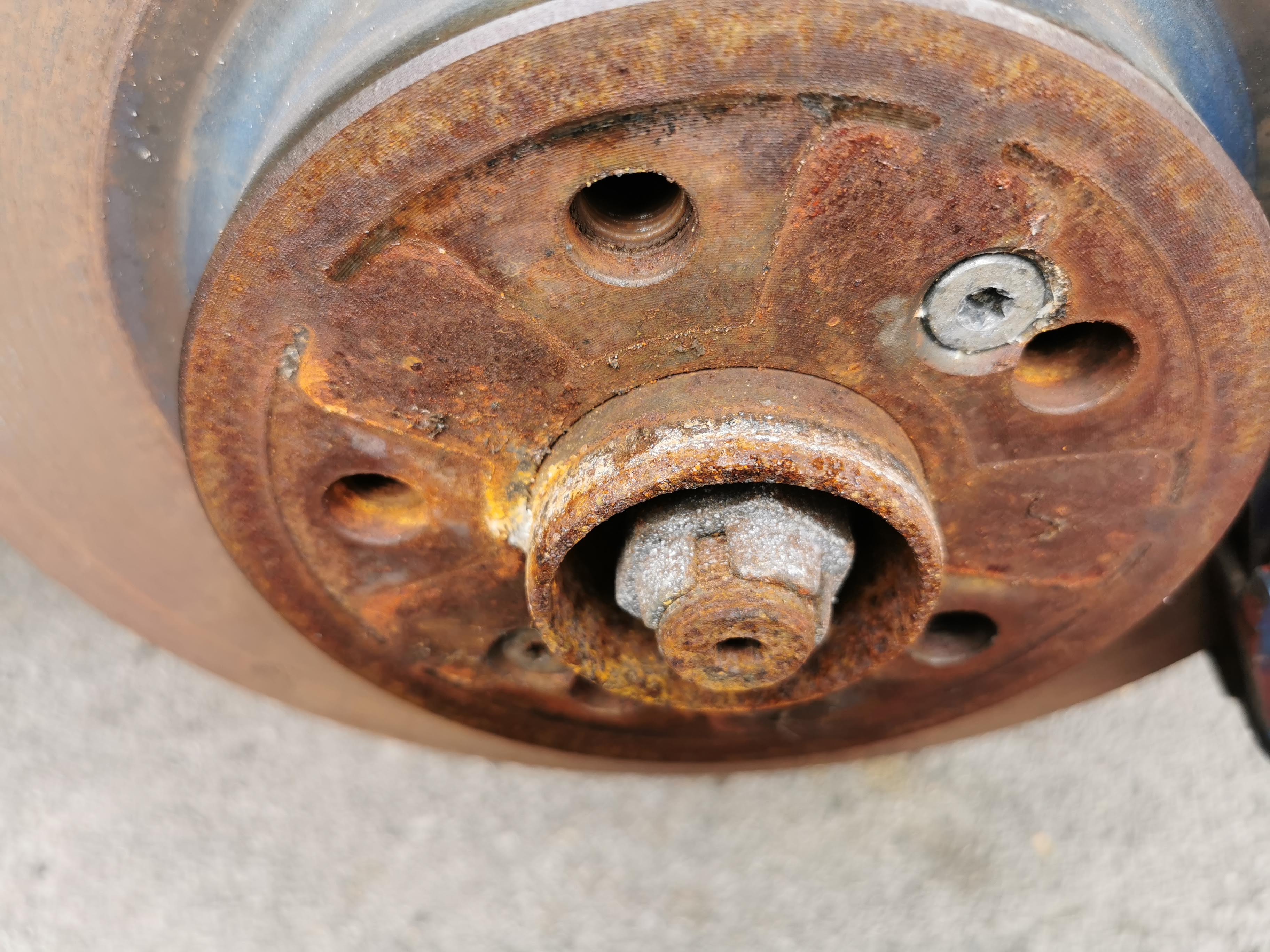

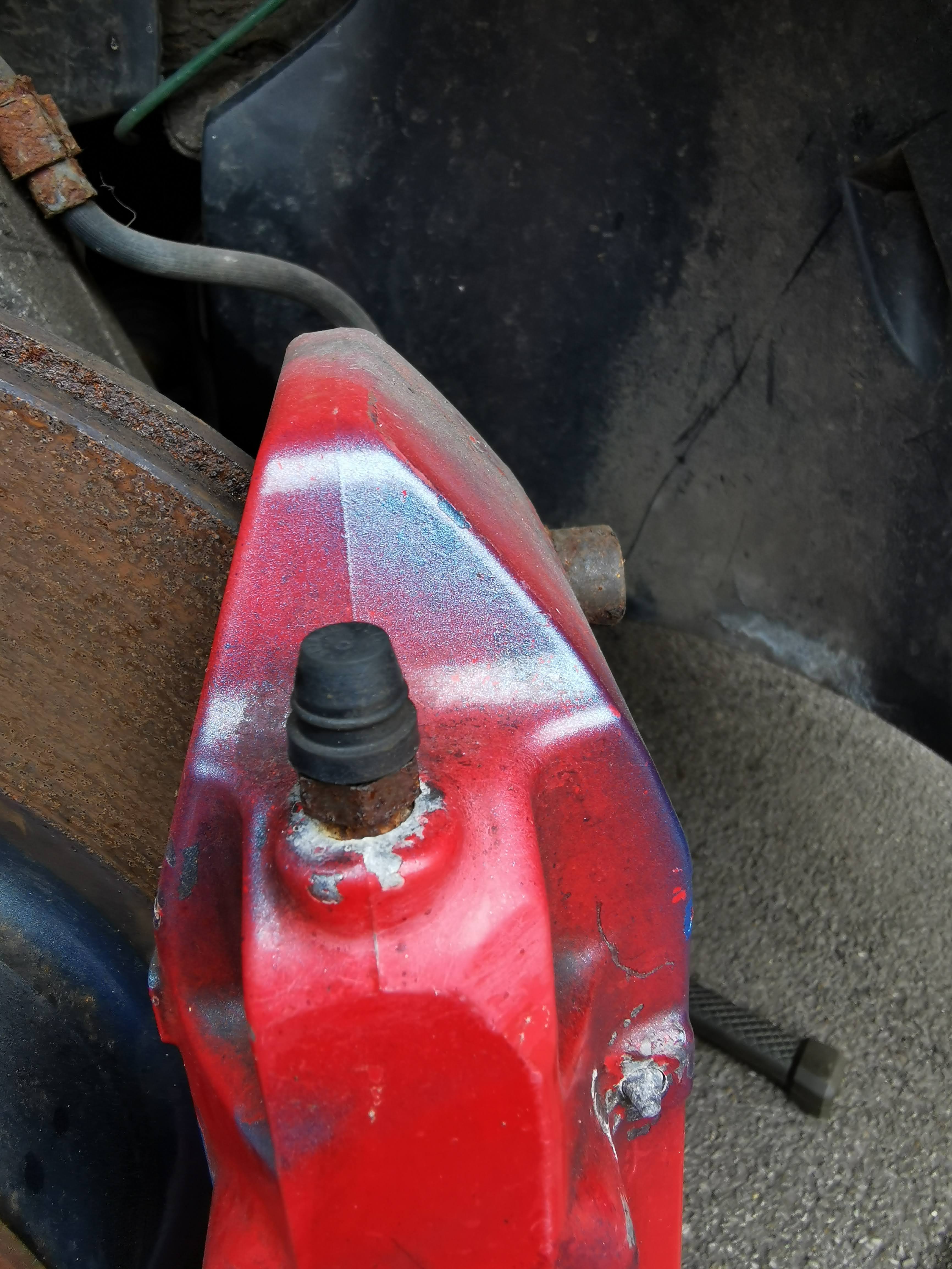

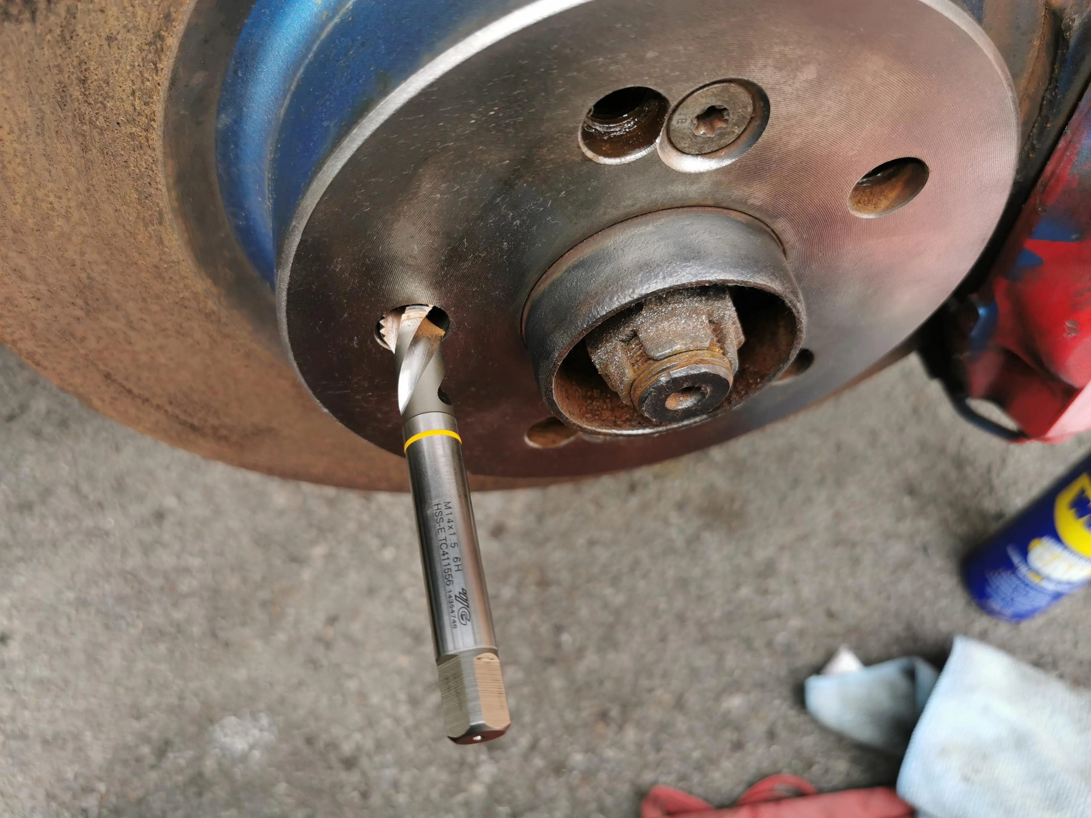

Ok so that's a tad rusty and gentle persuasion soon became full twatting to get the wheels off! At least I could carry on with bleeding the brakes.

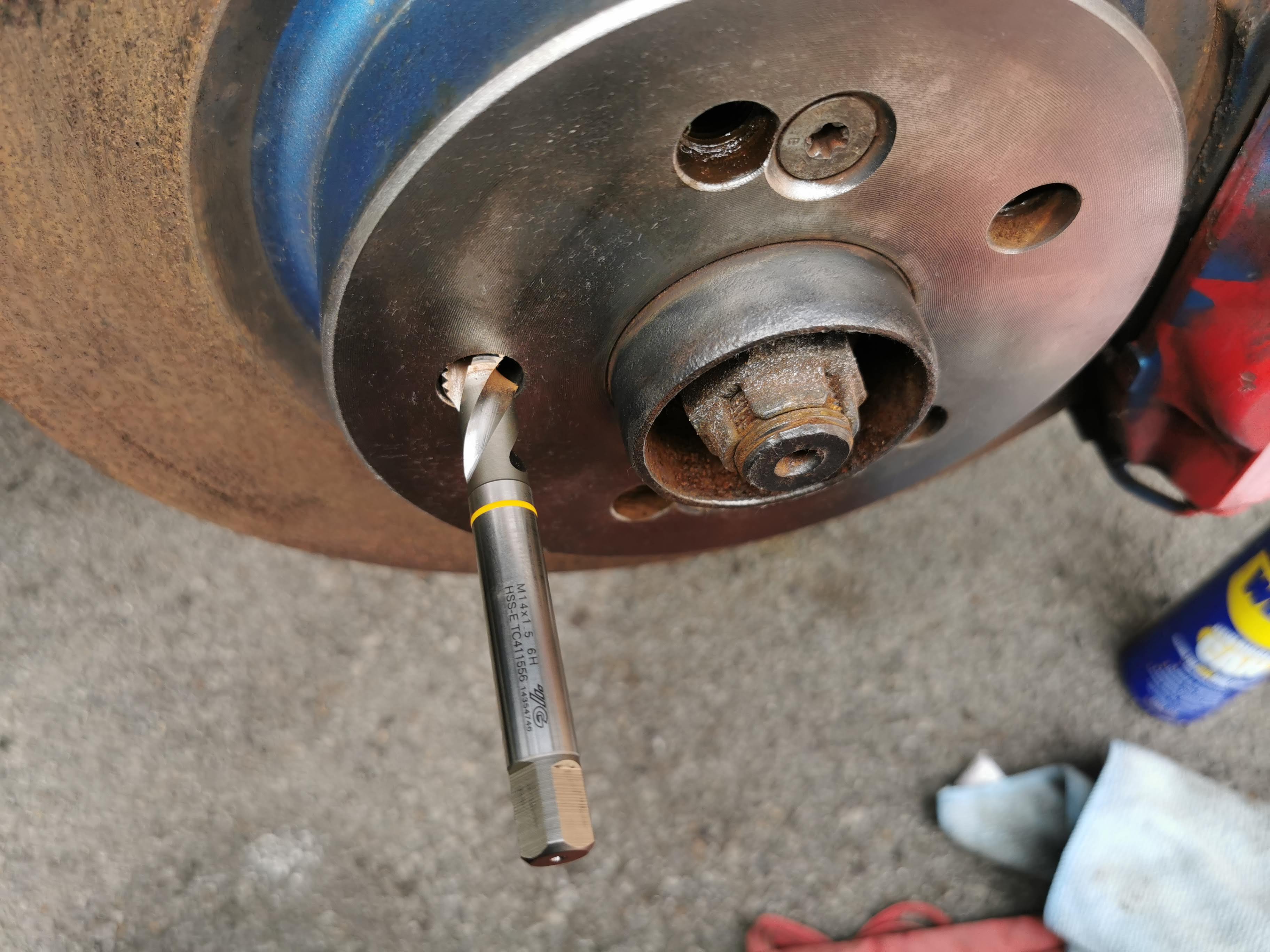

Oh that nipple doesn't look very friendly does it? After attacking them with a wire brush and spraying with WD40 I started cleaning the disc face with some emery cloth while the WD did its best.
As expected the surface rust cleaned off easily and I ran a tap down to clean out the threads. At this point I had an epithany regarding the spastic blue. The previous owner told me the wheels were blue when he bought it at auction and he had later had them refurbished anthracite and fitted new discs and pads. Note the blue on the discs. So either he didn't fit the discs or he was the spastic with the blue paint! I'll have to remove the discs and clean the blue off but for now it's back to those scabby nipples.
No joy. As I don't have a flamethrower to hand I'll pass the job to my trusted mechanic and let him replace the nipples. After hammering off the other wheel that was in the same state.

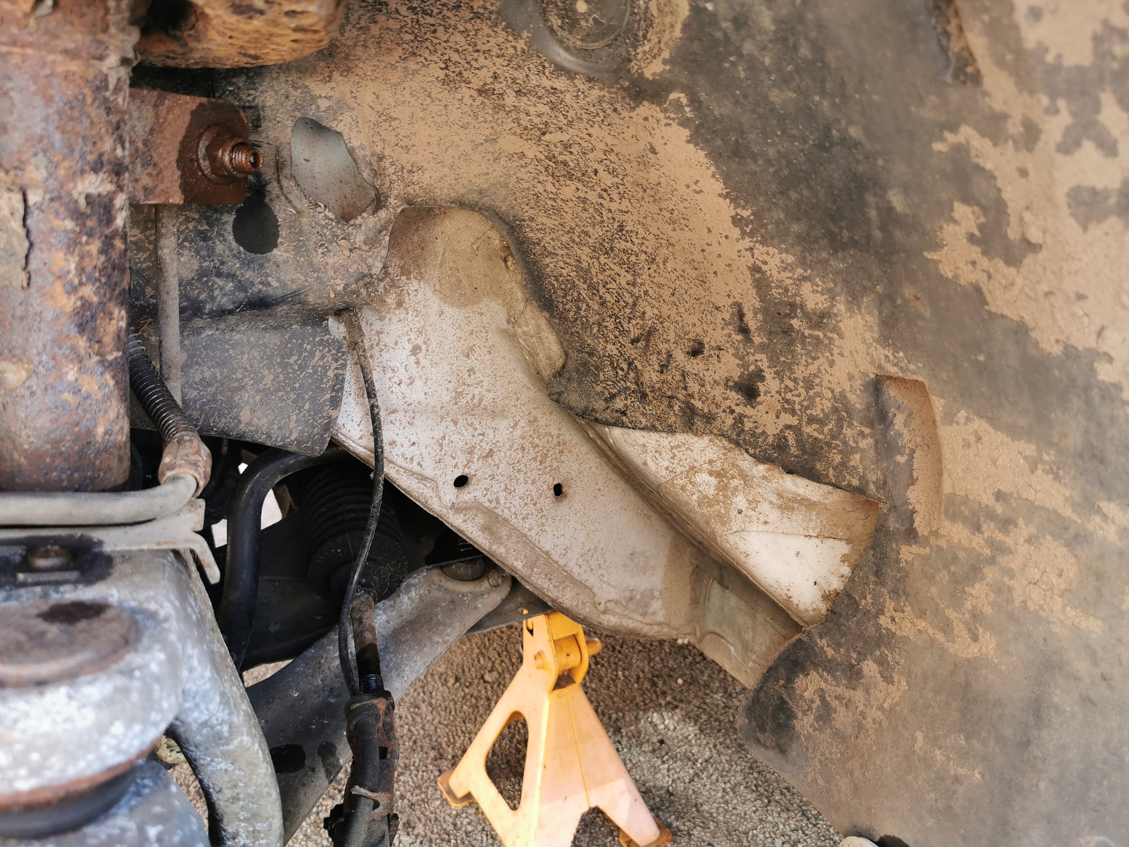

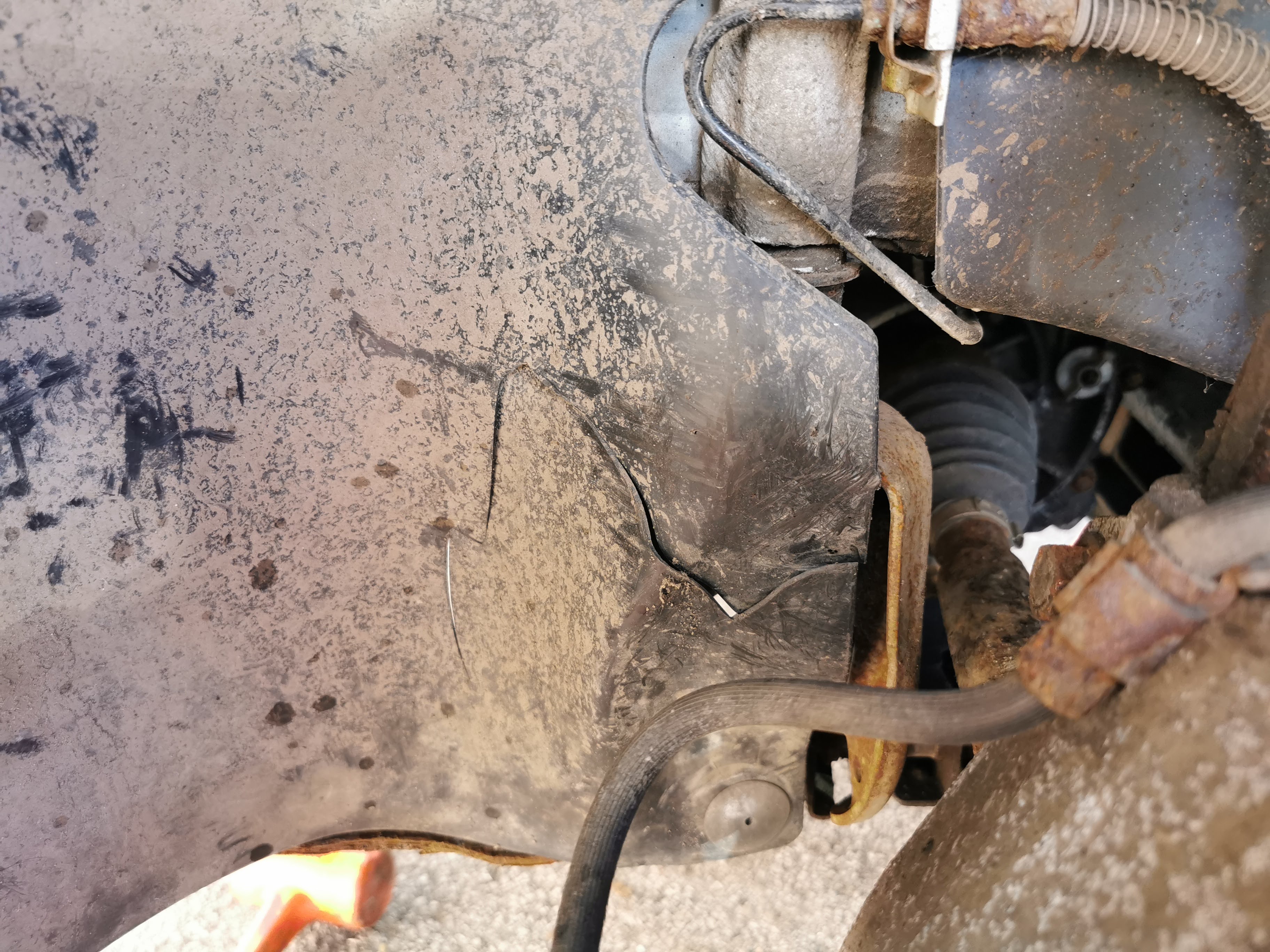

While I had the wheels off I noticed the passenger side front arch liner is broken so that will need replacing and all the mud cleaning out.

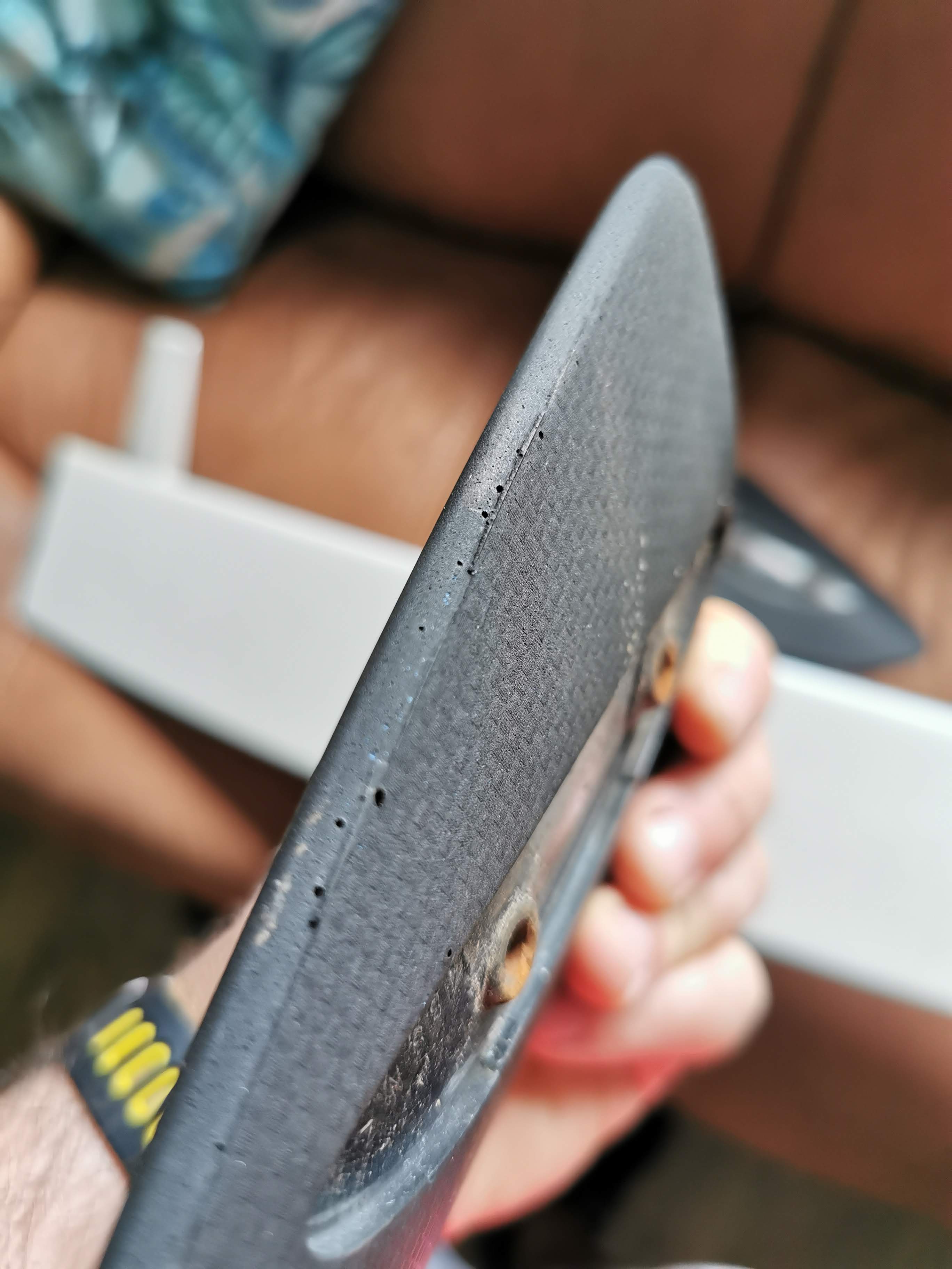

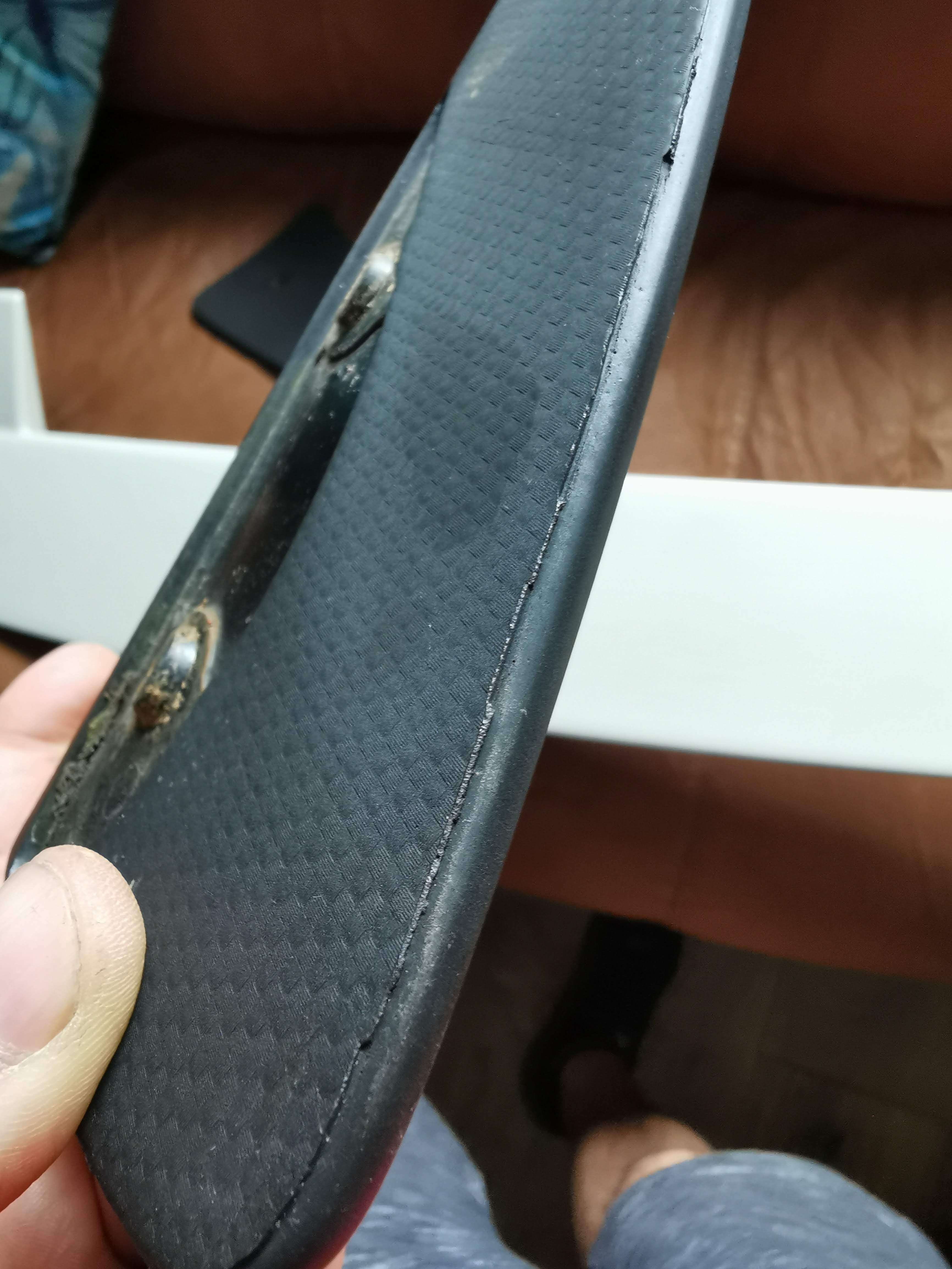

The mk3 RS really does look rubbish without a spoiler imo. In all honesty the cup spoiler wouldn't have been my choice if it wasn't already bolted on but if the car came like that I'd be fitting a sprint spoiler before having it MOT'd 😂. As it is I can't live with the crazy paving paint job on there so I've removed it to have a go at wrapping it gloss black. Of course removing it adds more questions as to wtf the blue spakka was playing at!

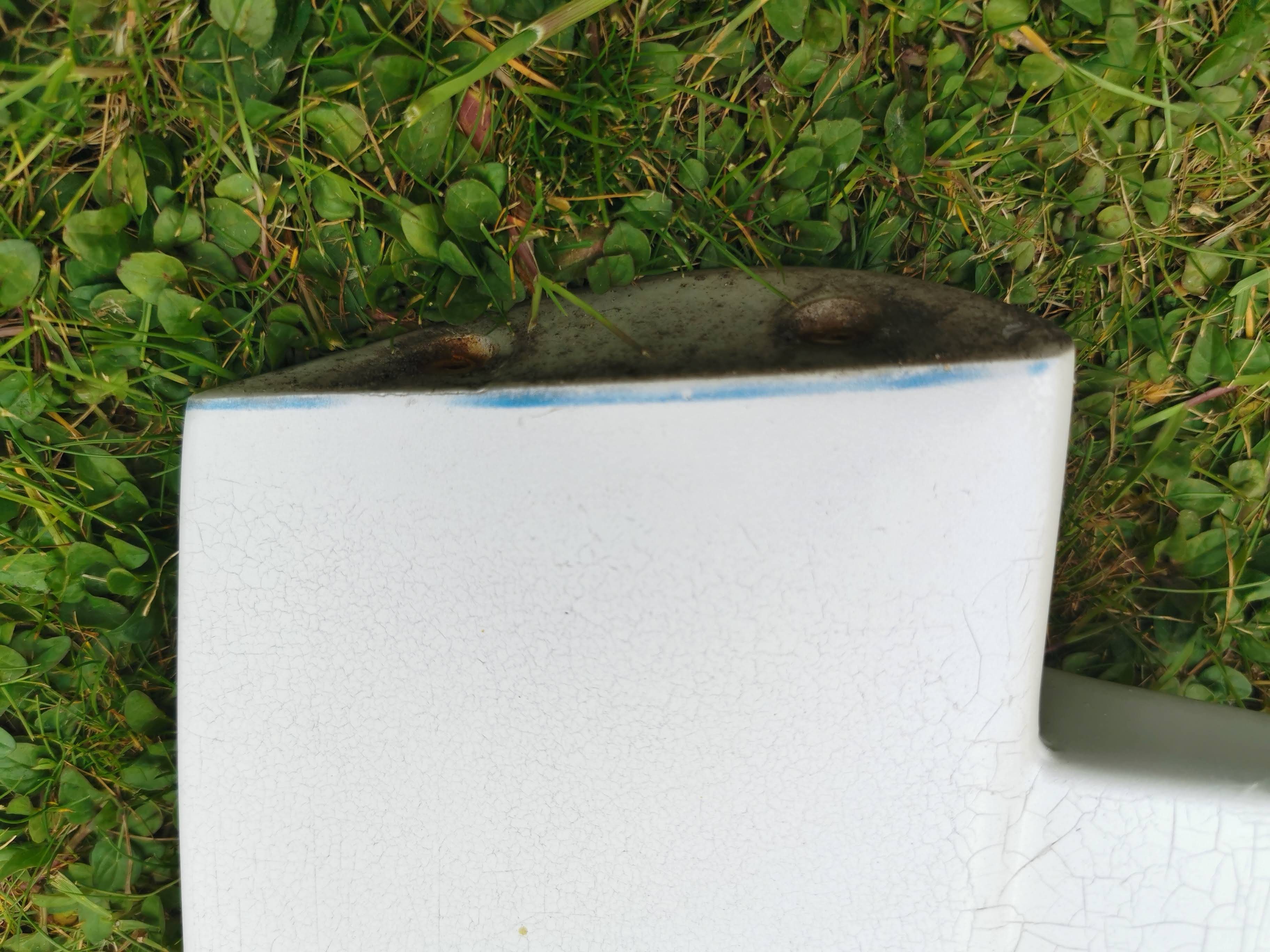

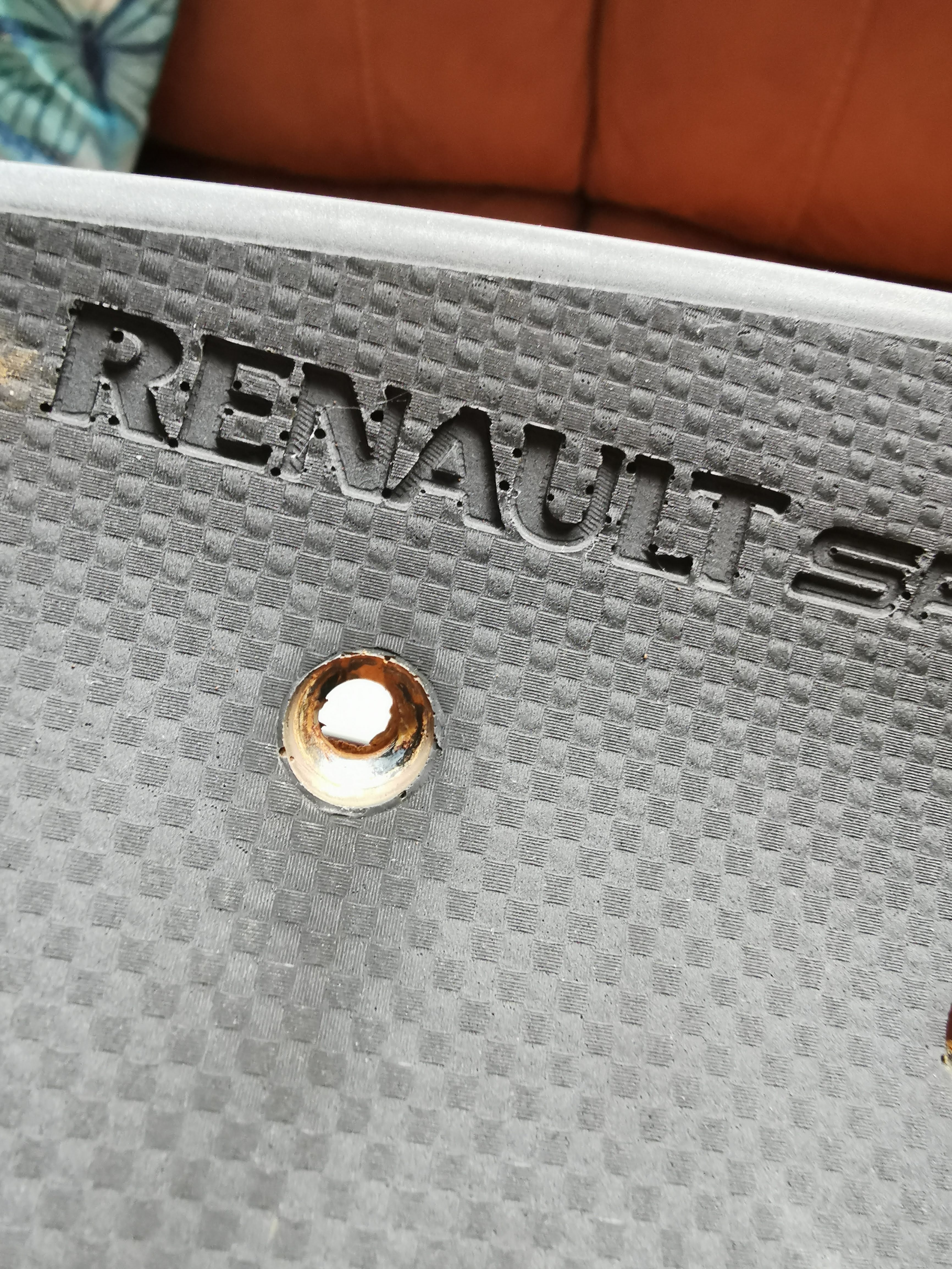

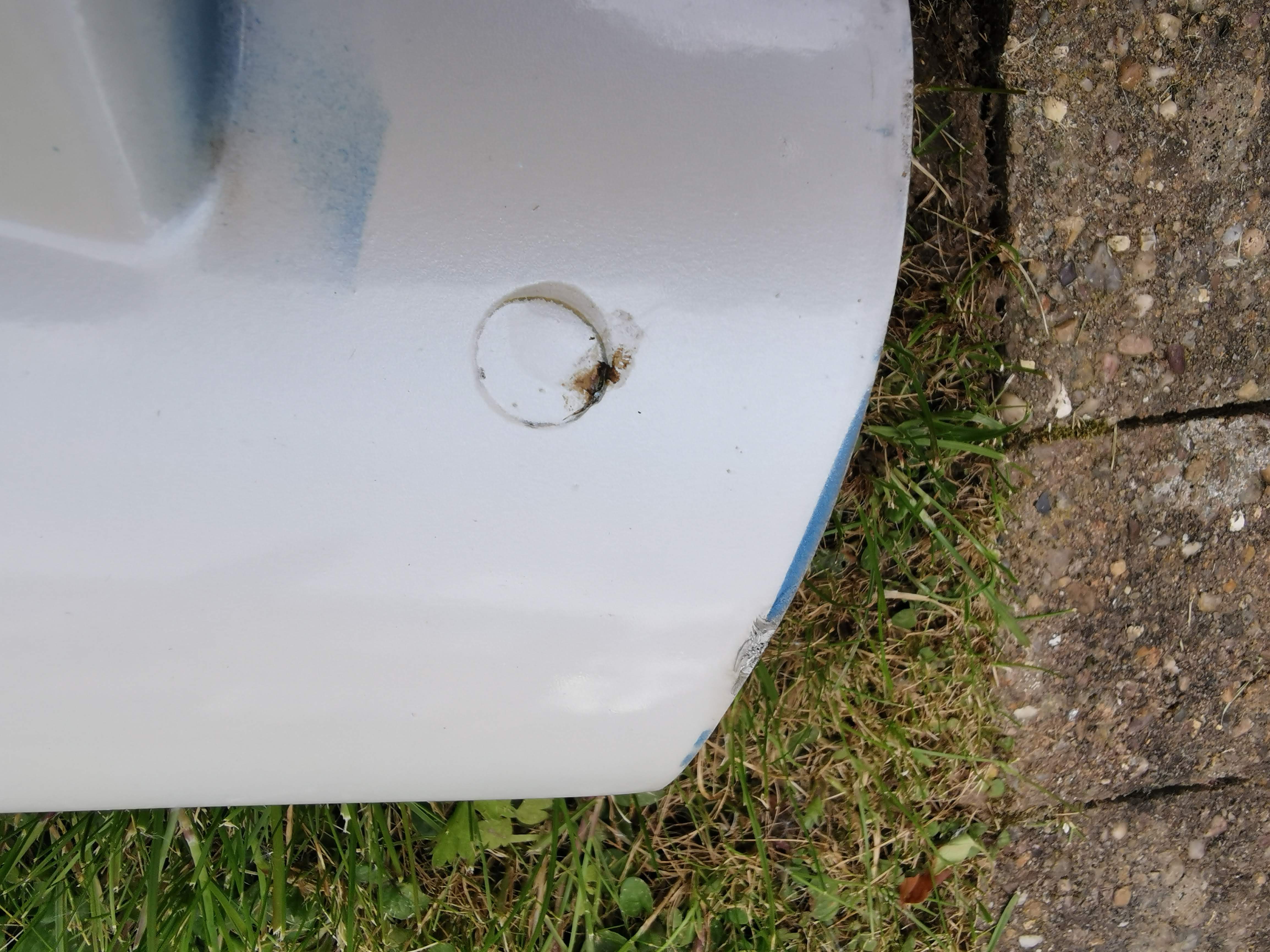

More blue which is making me wonder if the end caps were painted the same as the wheels? And having had a close look at the end caps I was surprised to learn they are genuine Renault items!
The porosity and sharp flashing on the inside edges is embarrassing and I'd have been asking for a refund if I'd bought it like that. The screws were quite rusty so I dropped them in some deox solution and will spray the ends matte black. I'm still trying to pluck up the courage to attempt wrapping the spoiler😆.

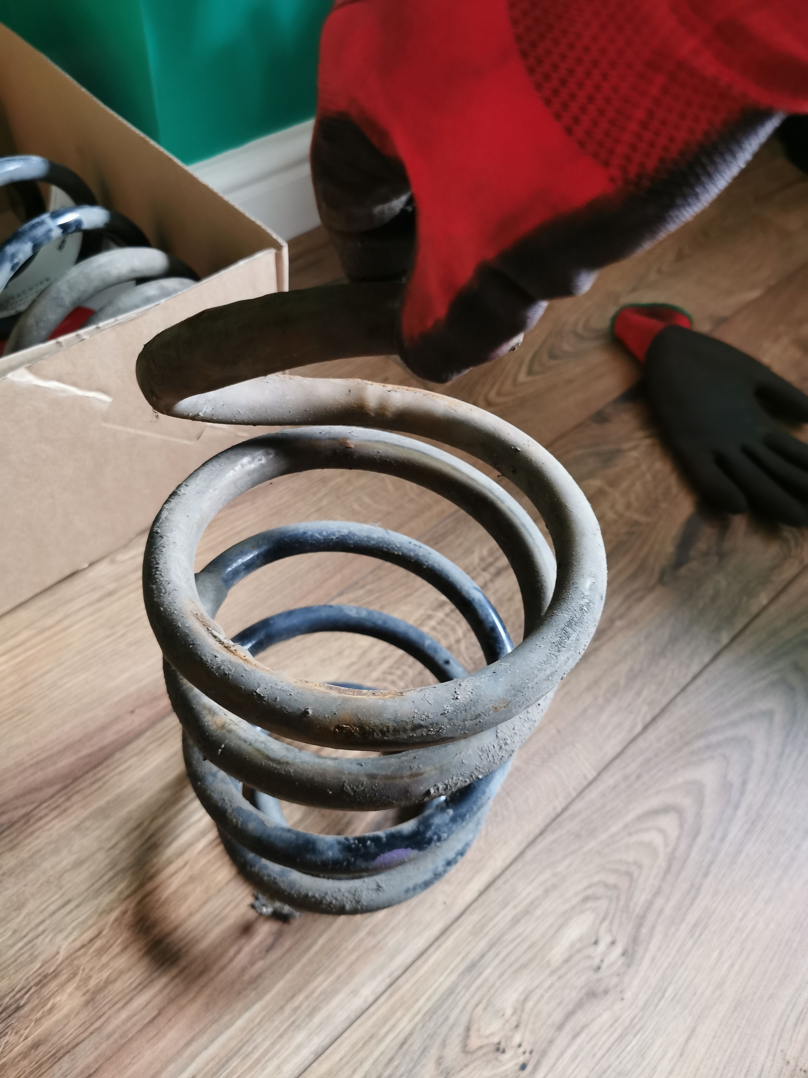

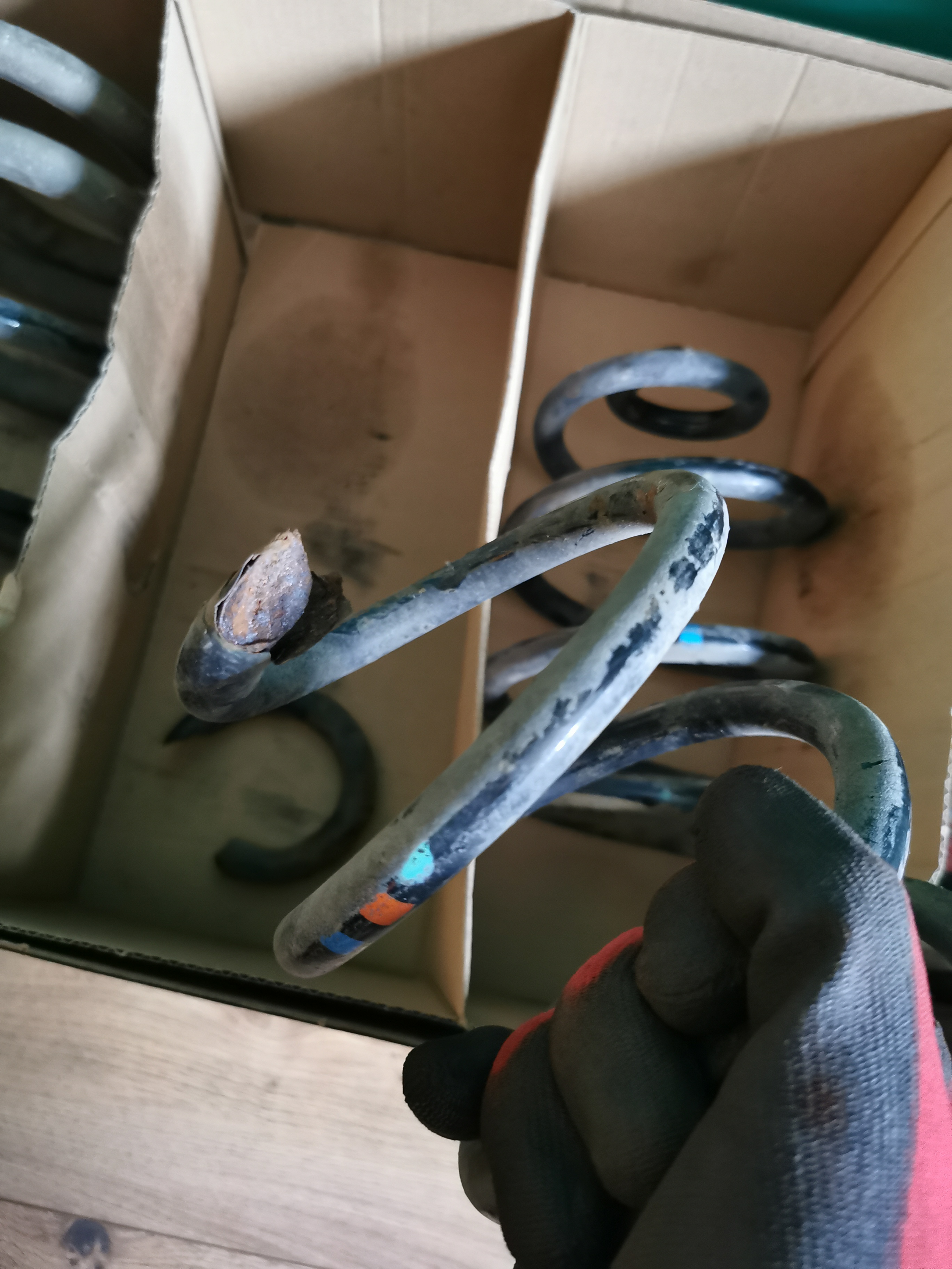

After a look over the car they discovered it has a broken front spring, a broken rear spring, swivel hub bearing needs replacing and the handbrake cable is corroded and jammed.Could have been worse. He then started explaining why they weren't keen to strip the hub and fit new joints to it, worried that it may break and the car then be stuck on a lift until a new hub was sourced he suggested buying a new one from Renault😆. So the search for a used hub was on. @Yorkshire Pudding had one, for the opposite side of the car🙄 but using his rollerdex of Renault fwends he managed to source the other one for me👍. I was givena place and a time and off I went to pick it up, turns out it was @RenaultRy, Nice to meet you mate and thanks again for the hub👍. That just left the ball joints and springs. After some searching I ordered the joints from @Kev@KAM as I'm 100% confident they will be right and the service is second to none, they were with me the next day🙂. Unfortunately I couldn't overlook the £70 saving on some Eibach springs autodoc offered over Kam, sorry Kev😆. Shame they don't have the same delivery times. With the necessary parts all at hand I went to re-book at the garage for it all fitting and the earliest date was June 6th. I left the hub and joints with them and I'm contemplating fitting that and the springs myself and then sending it for MOT. But that means rolling around under a bloody clio again🤔.

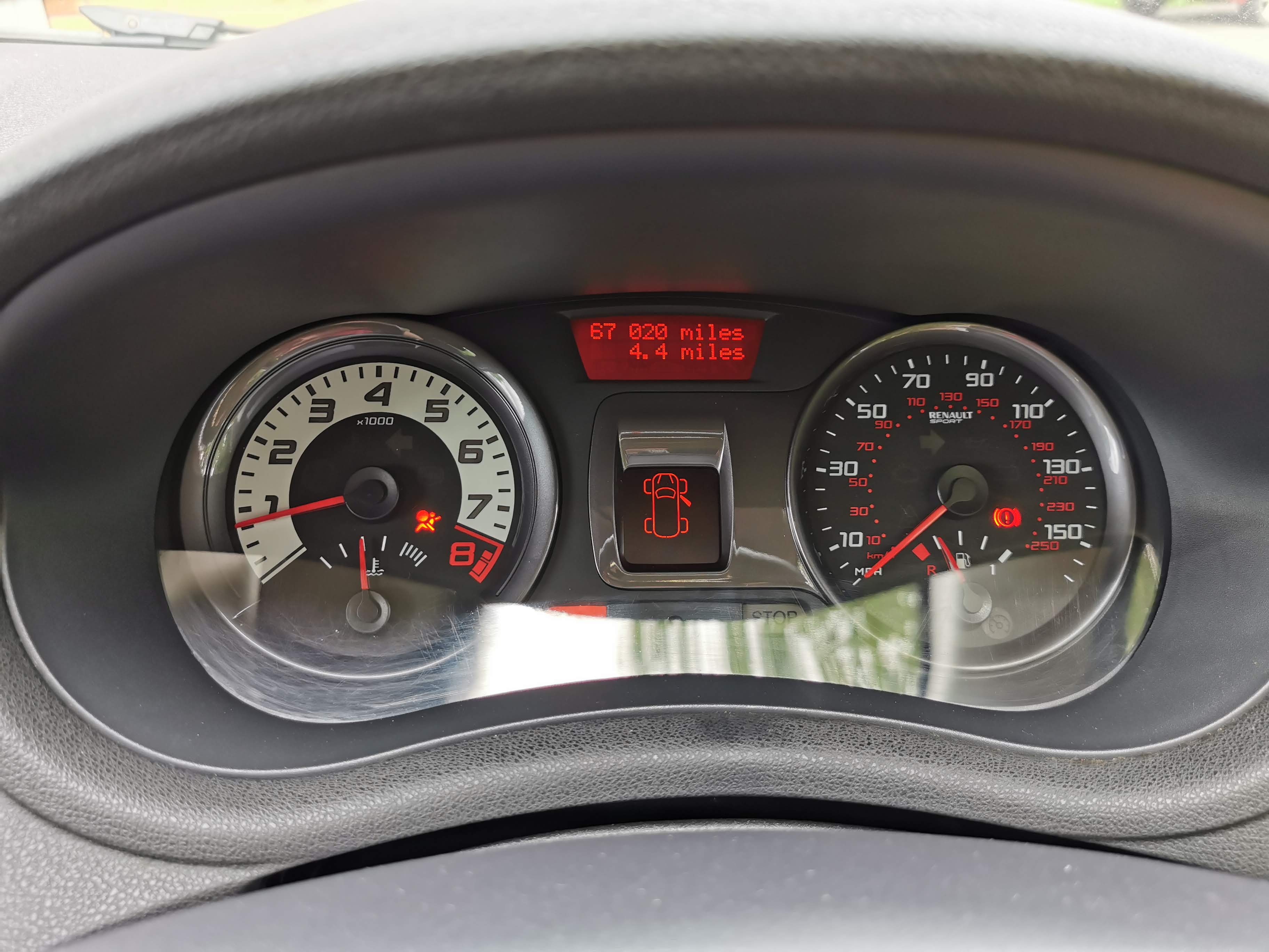

After the chatter about pcv valves and thermostats recently I fired it up and left it to get upto temp.
I think the temp is sitting about right but I will clean the pcv as a precaution when I service it. Speaking of servicing are the timing tools the same for the 182 and 200?
Oh and yes I have only driven it 4.4 miles!

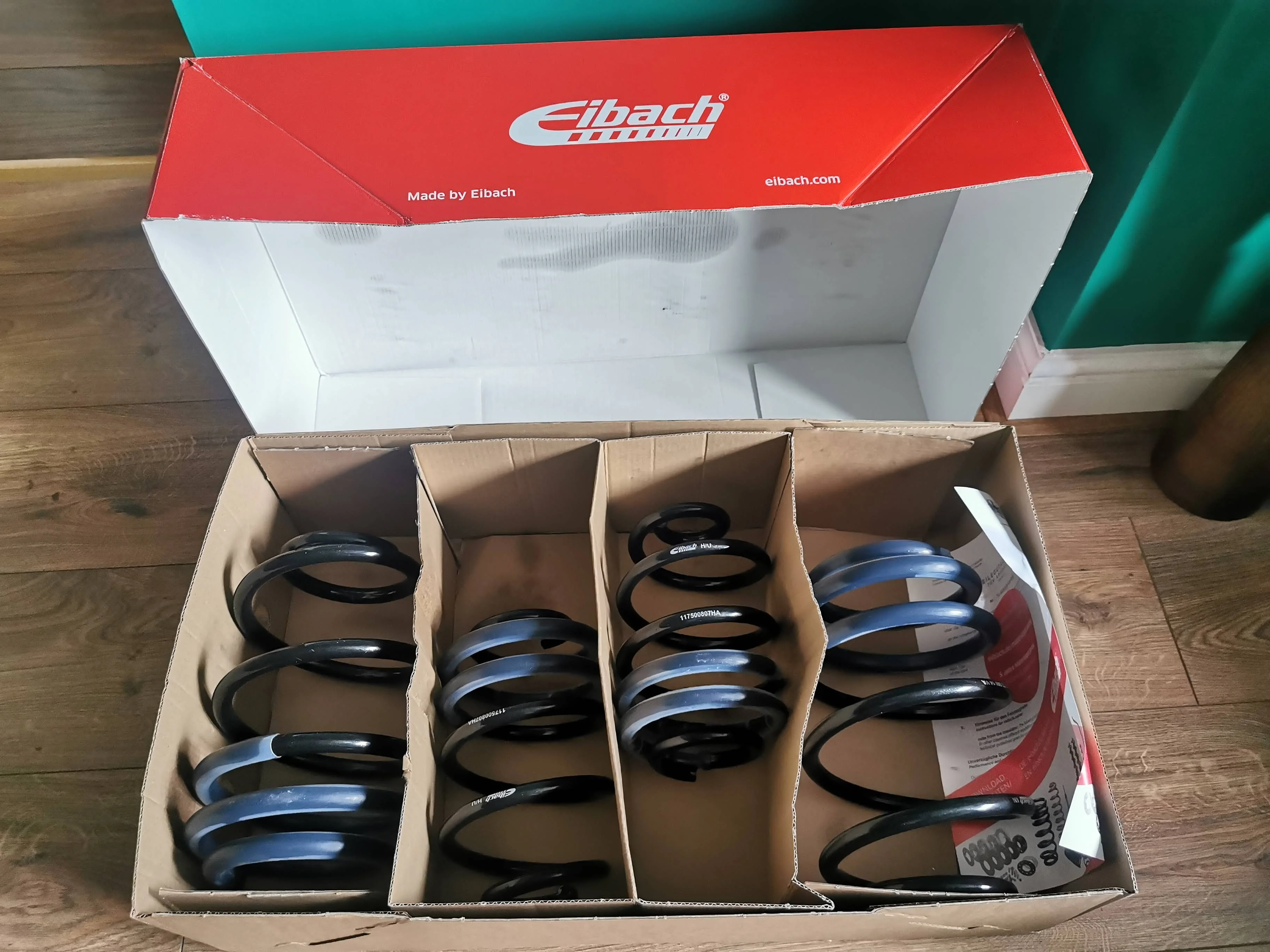

Well that's it modified now🙄😂. Lowered a bit on the eibach Pro kit and luckily didn't need any other parts replacing. I'm massively surprised that it all came apart to be honest.
Drive wise I can't really say if it feels different or not and 80% of the road between the garage and home was resurfaced last week and is super smooth! They were supposed to service it too but somehow hadn't noted that when I booked it in so it didn't get done. I've spent enough there recently and £40 an hour labour at a small back alley garage is a bit steep these days so I'll do it myself.

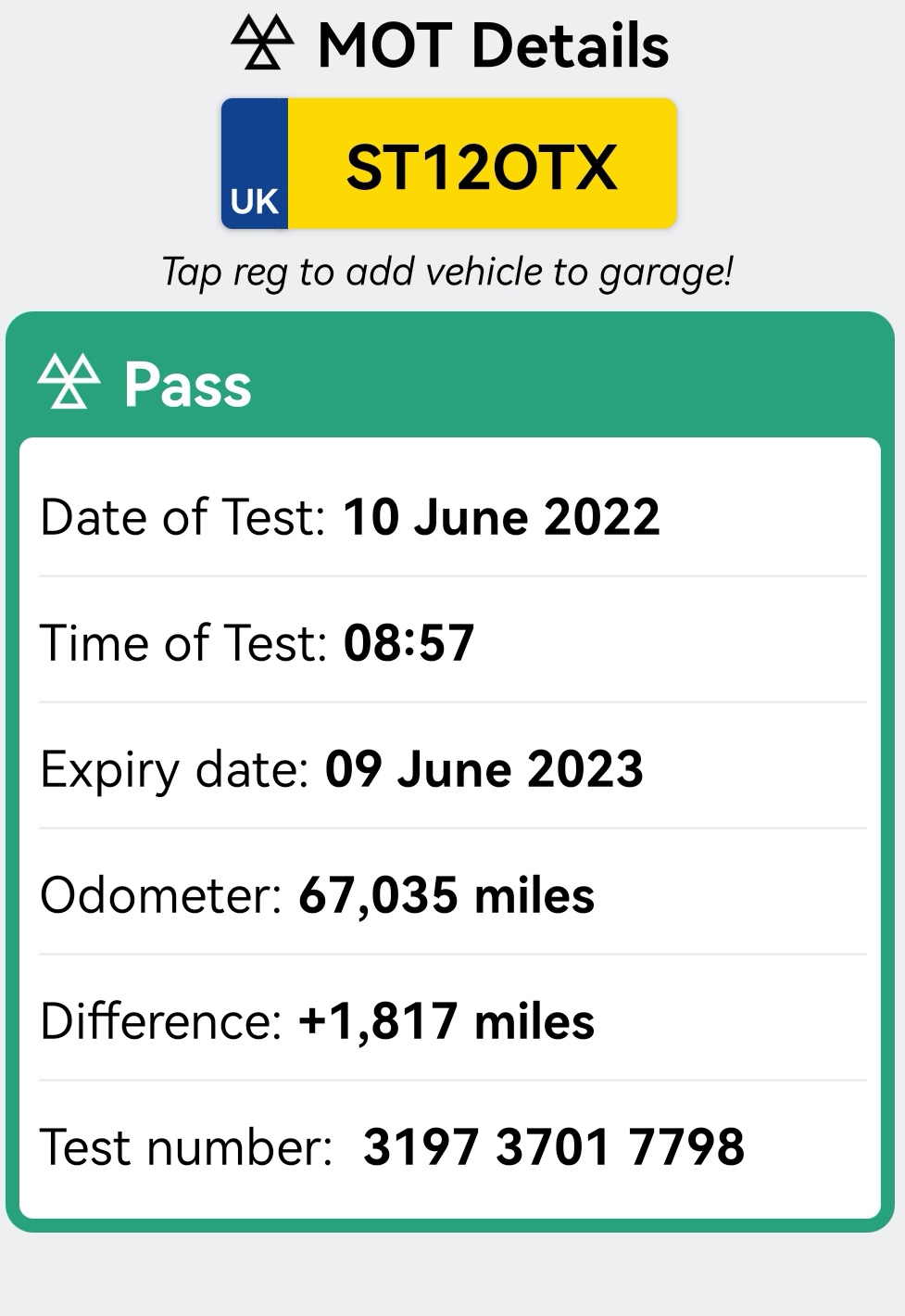

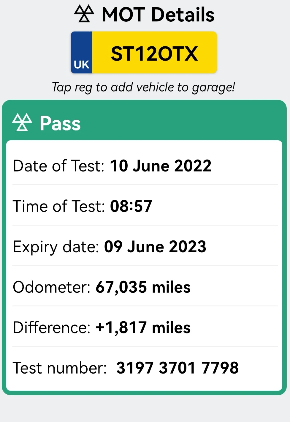

Suppose I'll have to tax it now then. 1817 miles in 4 years and 3 months! 😆 Tester said it has got a new steeing rack on and the manifold flexis have been replaced so hopefully that's 2 jobs I don't have to worry about, although the cat needs removing because it's rattling it tits off. There's also a horrible squeak from the rear that wasn't there before the springs were fitted, sounds like a dry bush so that needs investigating too. It may have an mot but there's still plenty of work to do.

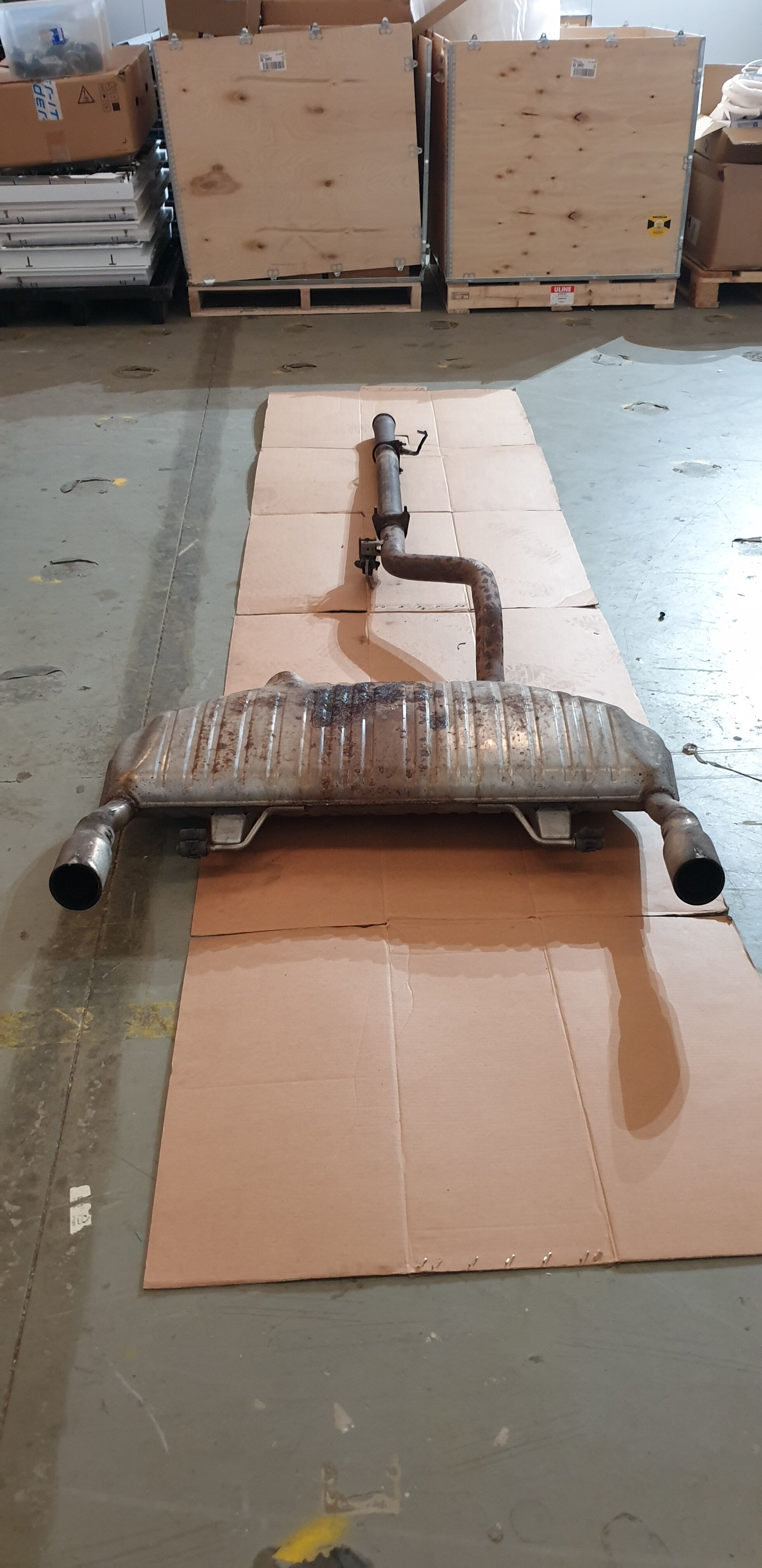

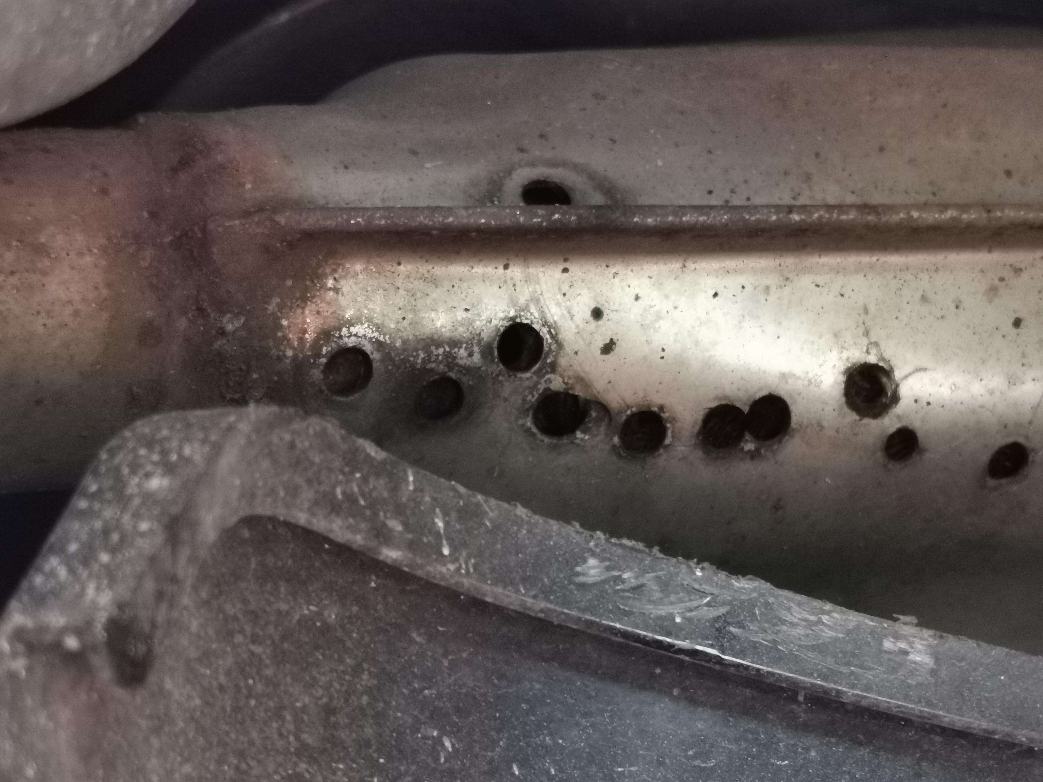

Lastly I sprayed some wd40 on the rear suspension bushes in the hope it would cure the squeaking. While I was there I noticed something I'd not realised before.
Someone decided some extra outlets in the backbox would be a good idea. That could explain why it sounds different to the other 200's I test drove. So that's a new exhaust for the next mod then.

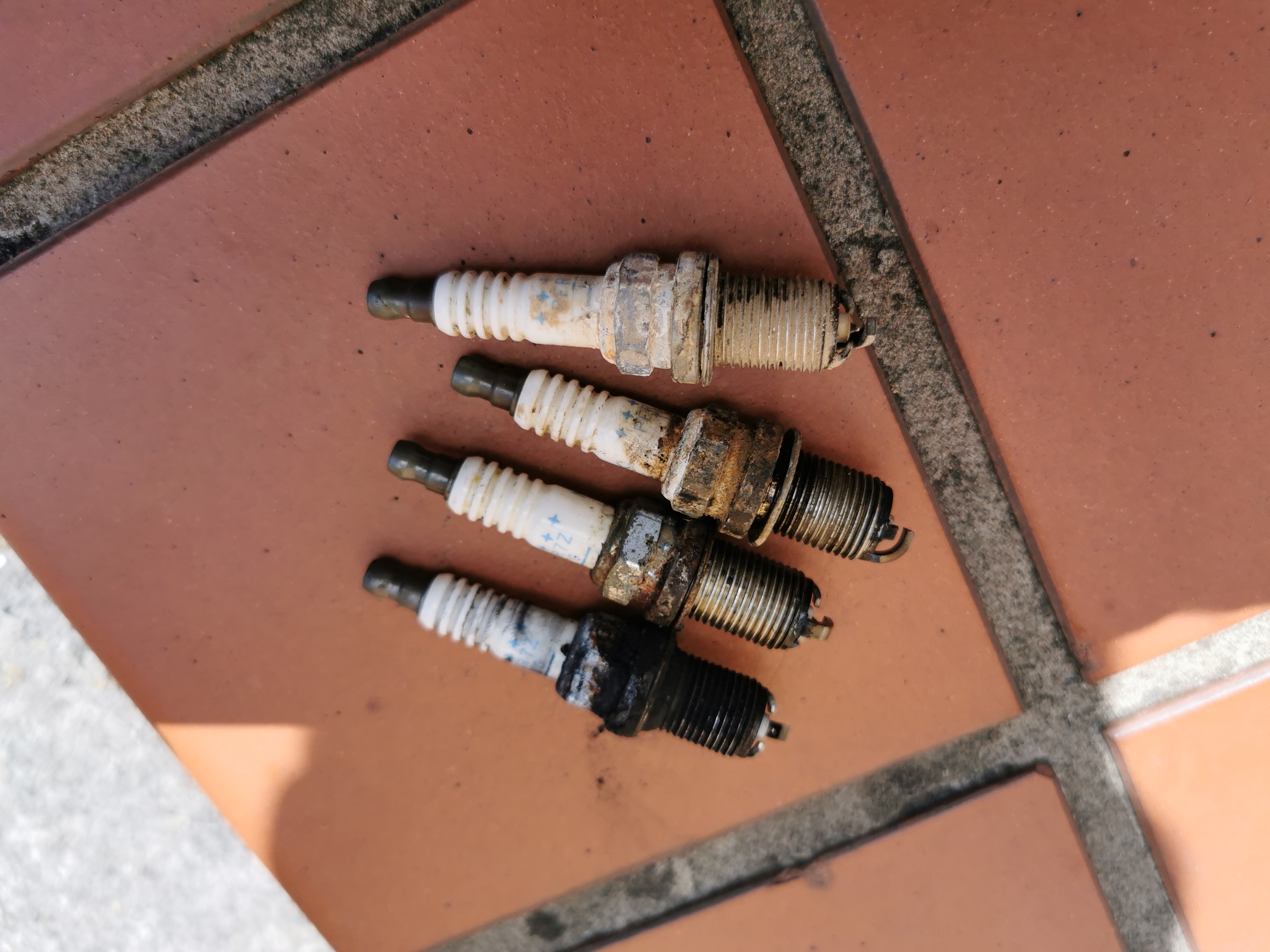

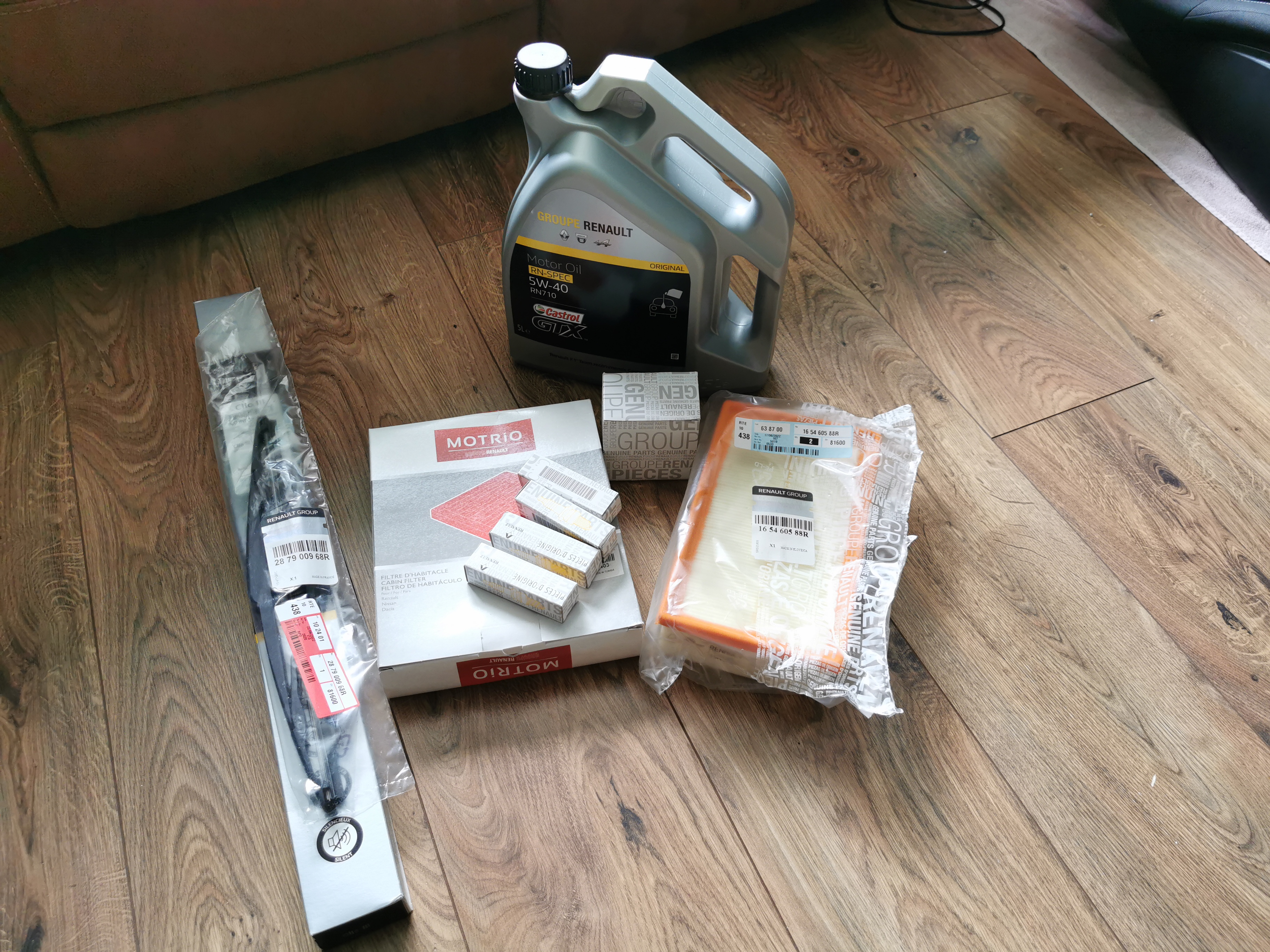

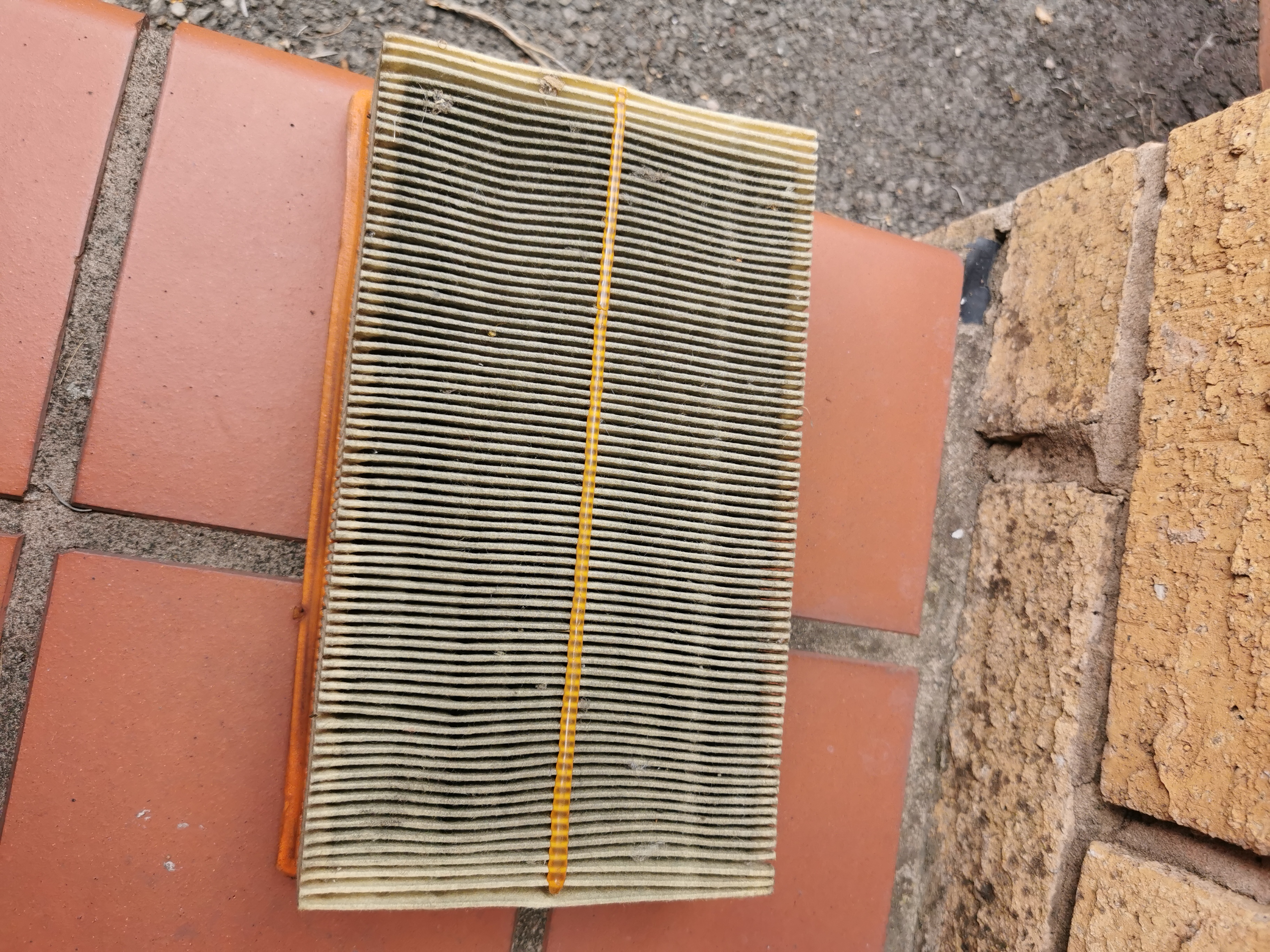

I gave it a service this weekend, god knows when it was last done and as its been behaving itself i thought it was worth it. Ordered the parts from @renaultpartsdirect which arrived promptly as always 👍.

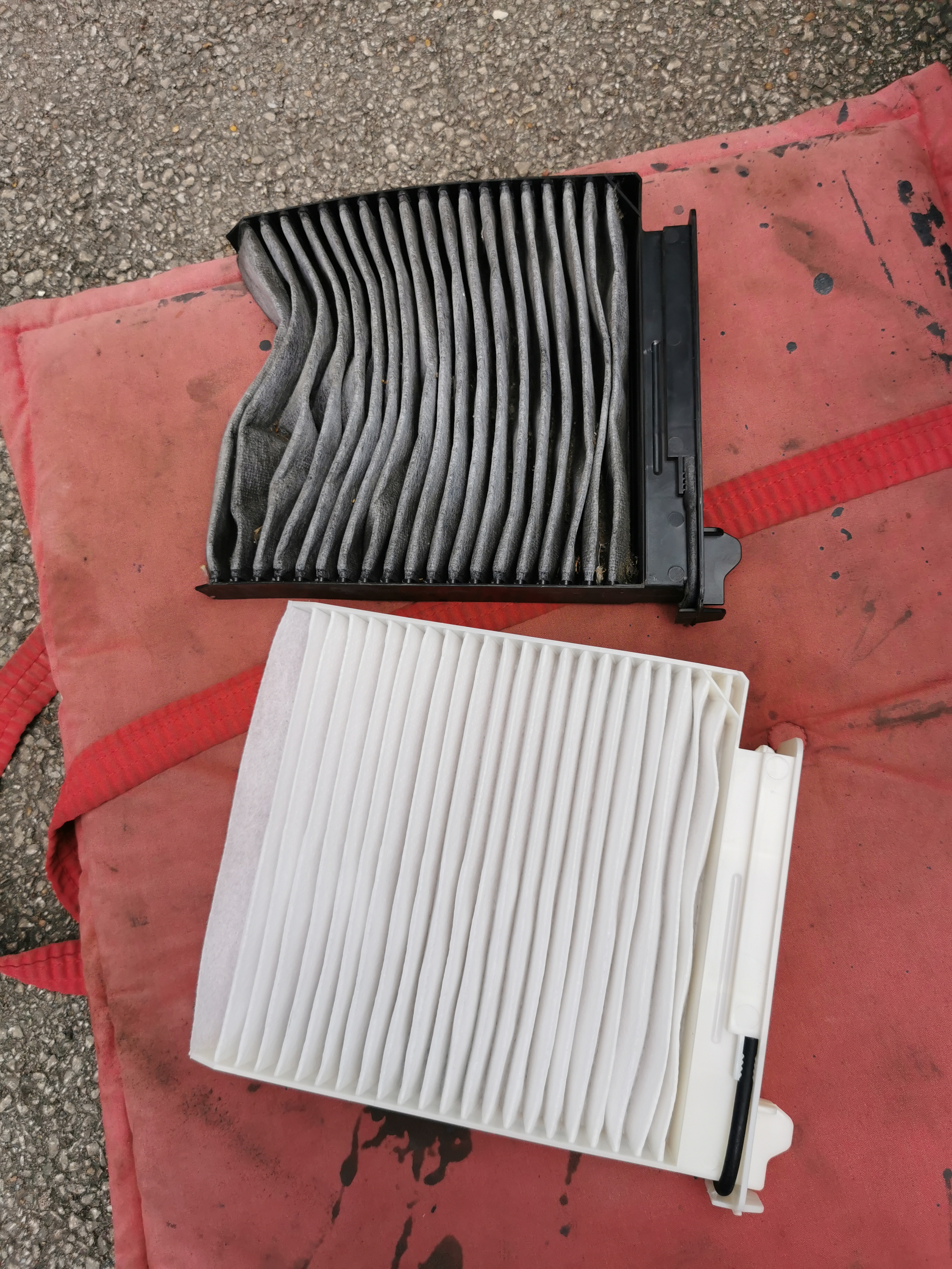

The cabin filter and air filter weren't that bad, but why would they be when the cars not moved for ages? Still new ones are always nicer.

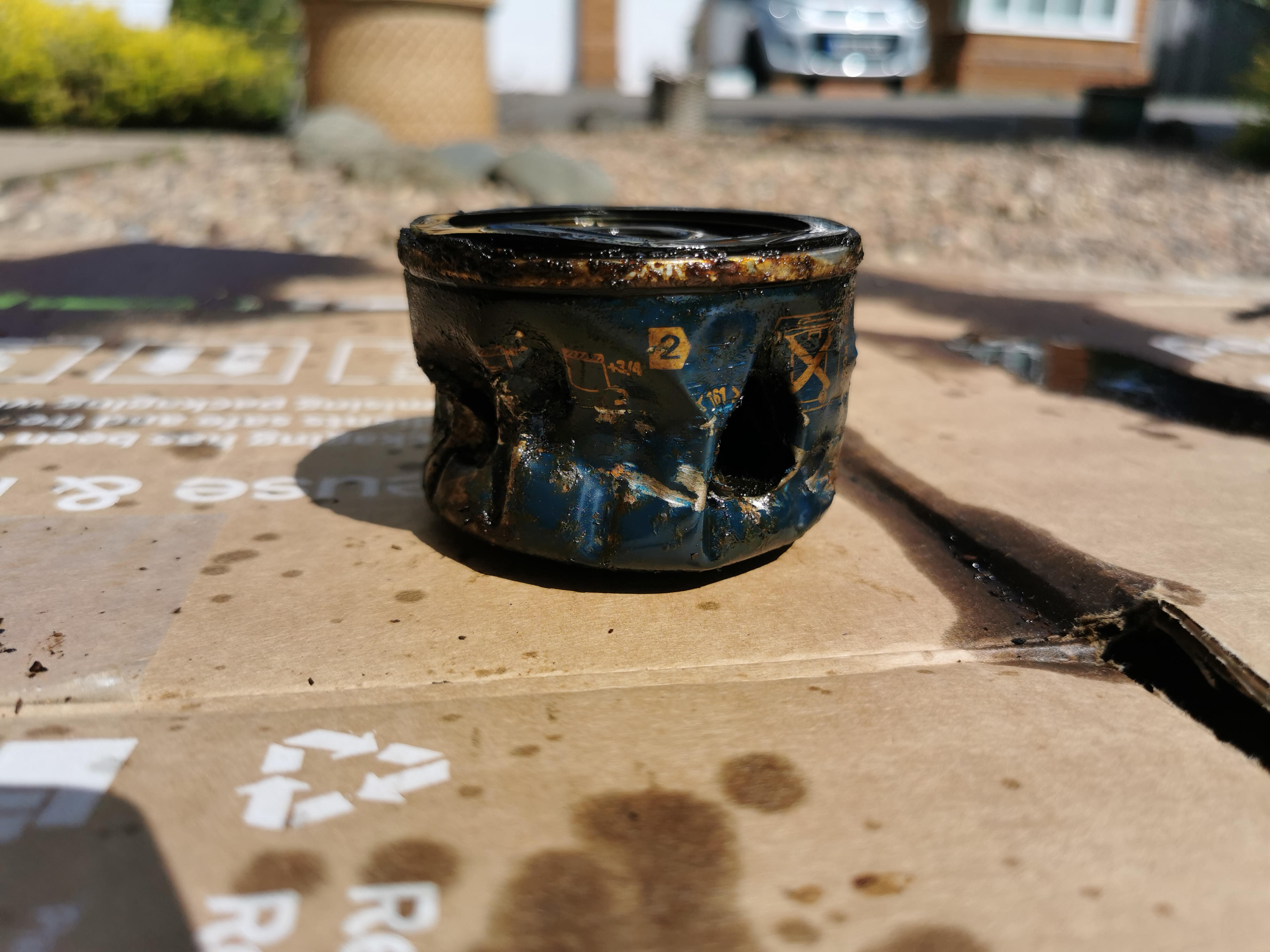

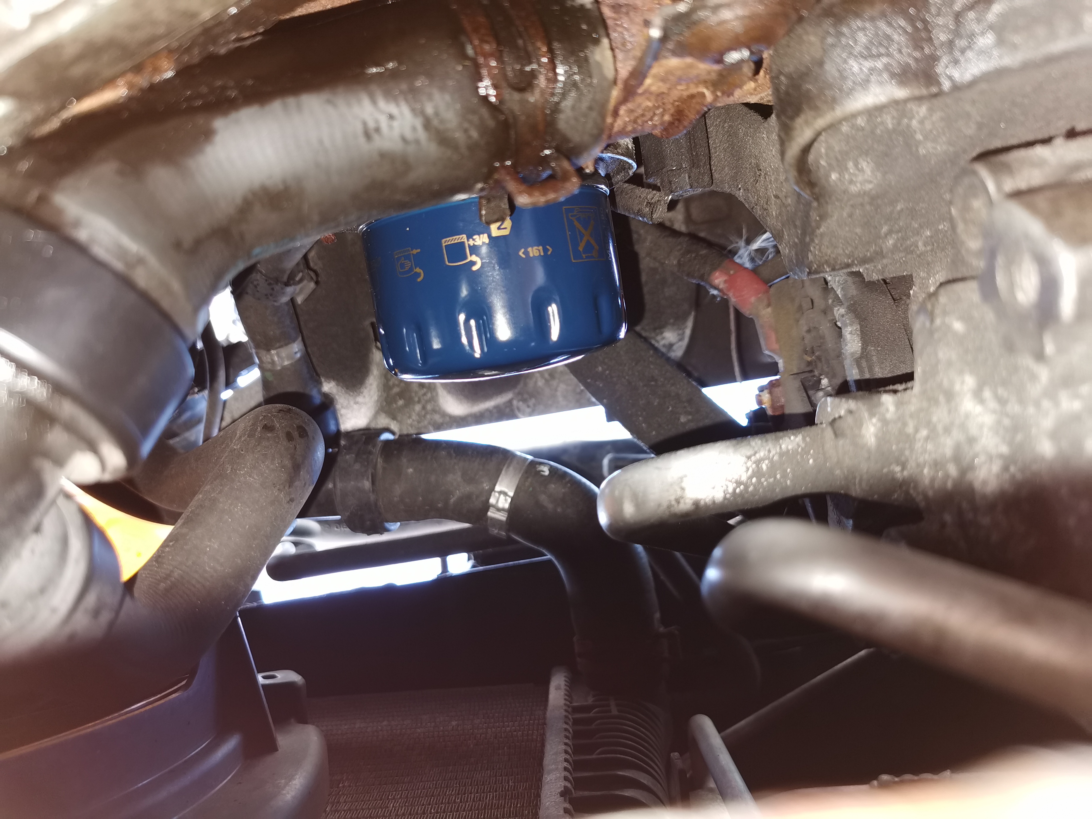

The oil filter was a different story though. How the incredible hulk got his hand in there to tighten the bloody thing up as tight as it was I really don't know😂. Some snappage occurred.

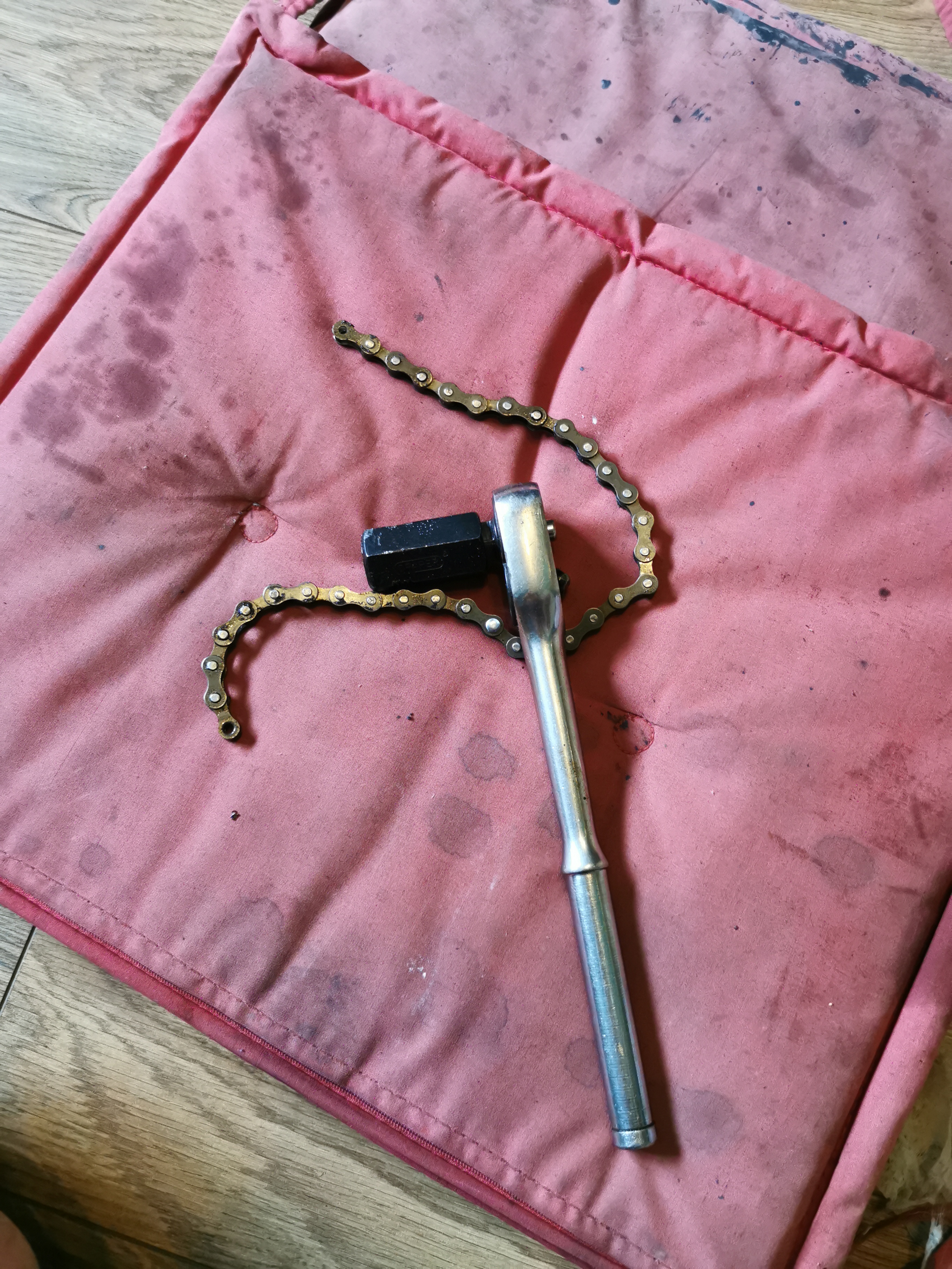

The chain tool I'd bought from halfords for the job, and got refunded today! In the end I punched a big hole in the filter so I could get a crow bar in it which did the job. I was not impressed.
I remembered to put the new oil in and its stayed in so job jobbed at 67400 miles. New wipers fitted and then into the spark plugs. No3 was tight but thankfully warming the engine and a spritz of wd40 freed it up. The car runs sweet now.

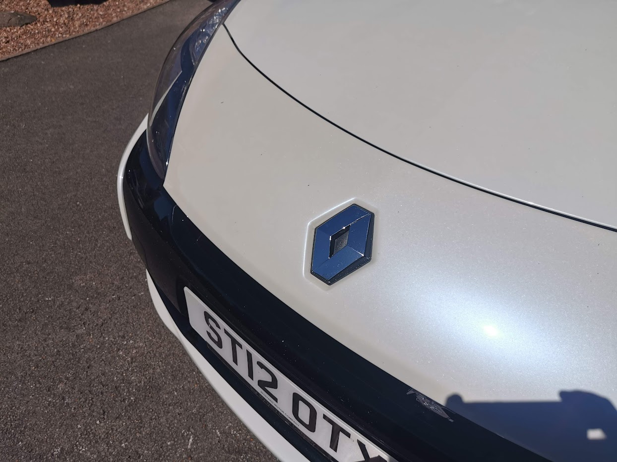

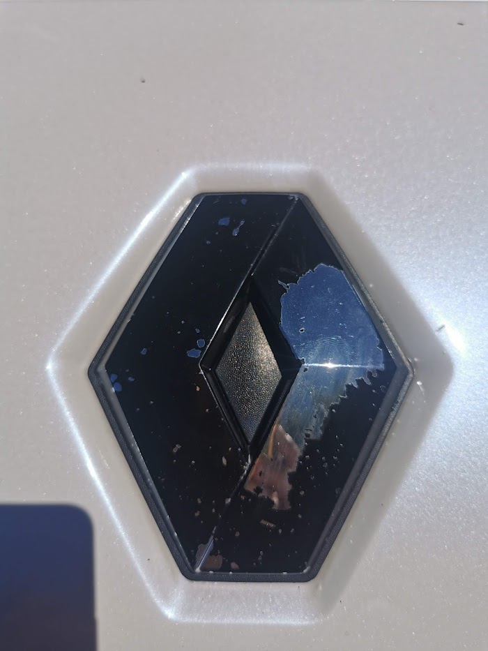

The peeling black paint on the front diamond really let the car down. I've got some new badges on the way but there no time to swap them this week so I got to scraping the paint off hoping that the plastic chrome wouldn't suffer too much.
Ooh nice and shiny. Not perfect but still much better than it was. I might do the rear one if I can bare the heat again.

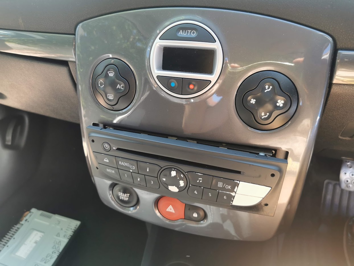

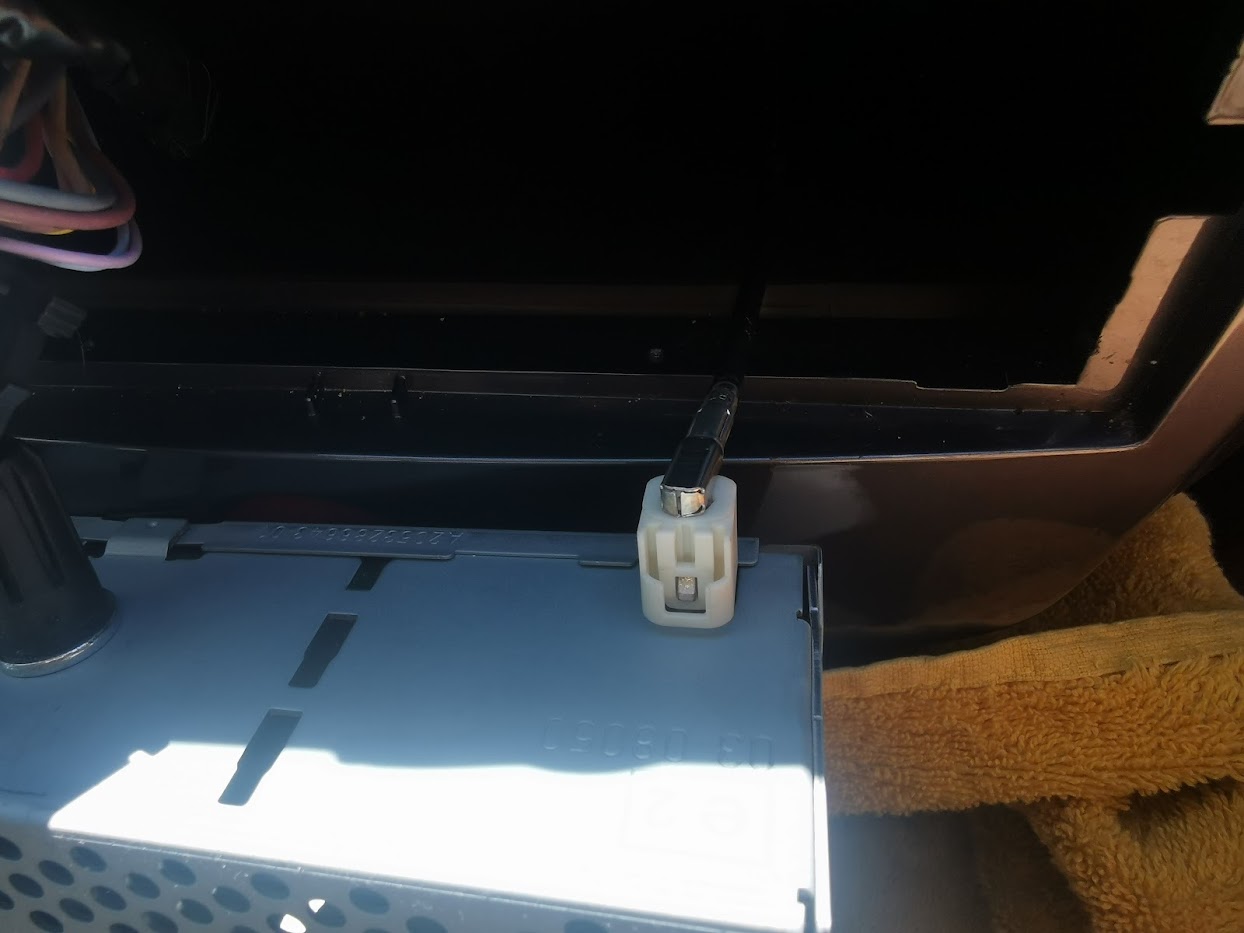

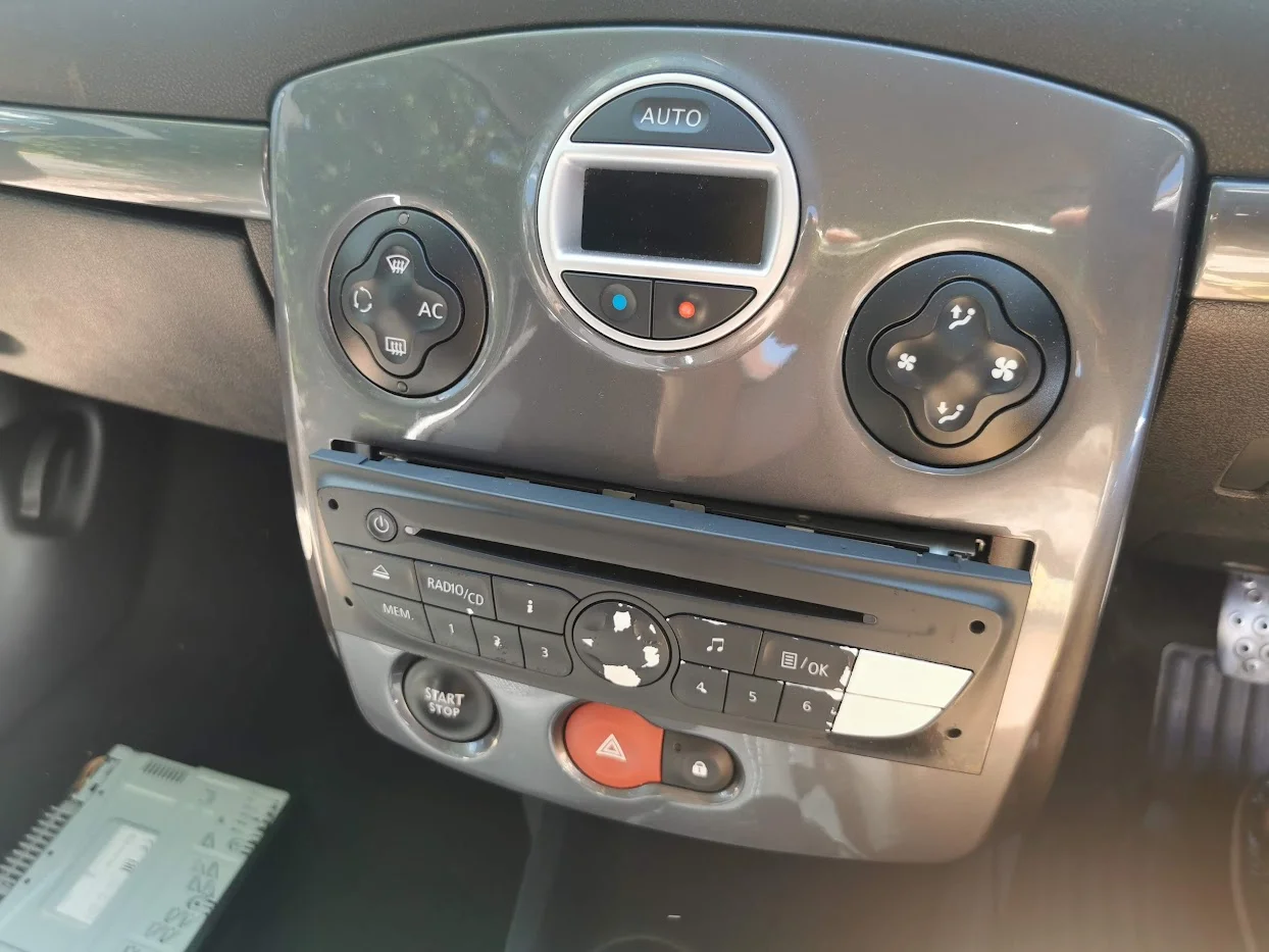

The other job I wanted to do was to fit an alpine HU I have sitting around. I've had more than enough of the radio now, modern music is painful to my old ears 😆 . So I dug out my radio removal tools and pulled then scabby renault unit out. And then it all went pear shaped. There's 3 plugs on the back and only 2 on the alpine. So I guess I need some sort of adaptor harness? Anyone able to link me what I need?

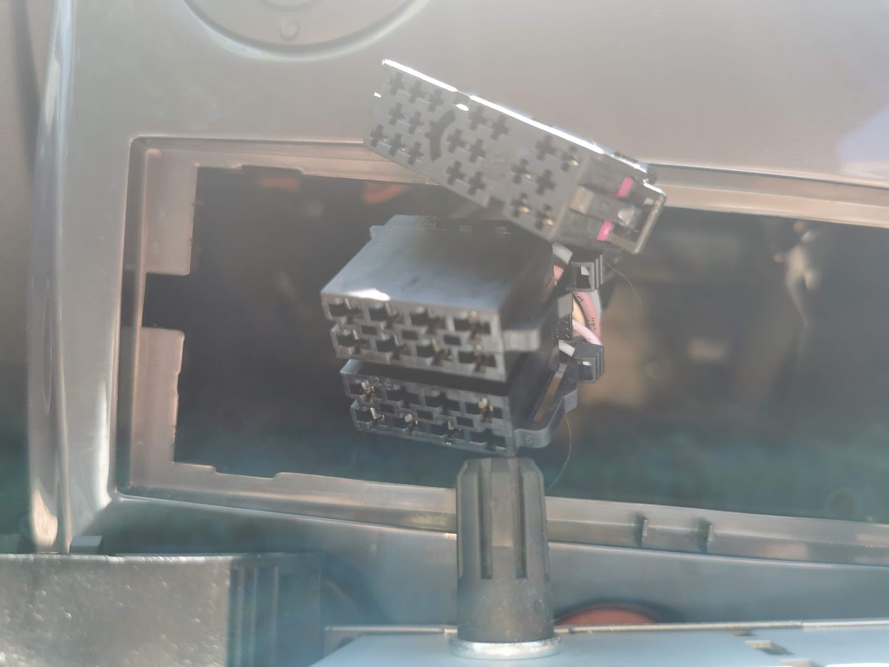

And what's with this aerial connector that I've never seen before? Seems no one on YouTube has either and I can't get the thing off!
And being a renault there's not enough room for the cables behind the radio😩, so:
If I can get the right harness this week I'll rip the dash apart and fit the alpine. If I can't I'll be driving to Blyton with earphones in 😂.

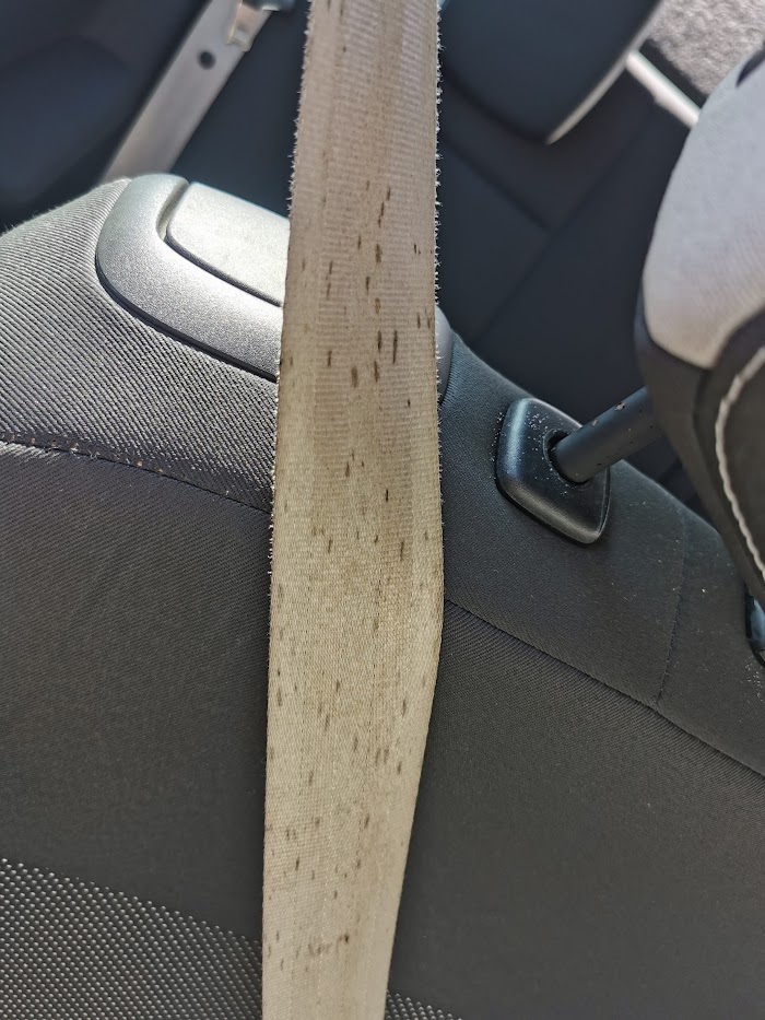

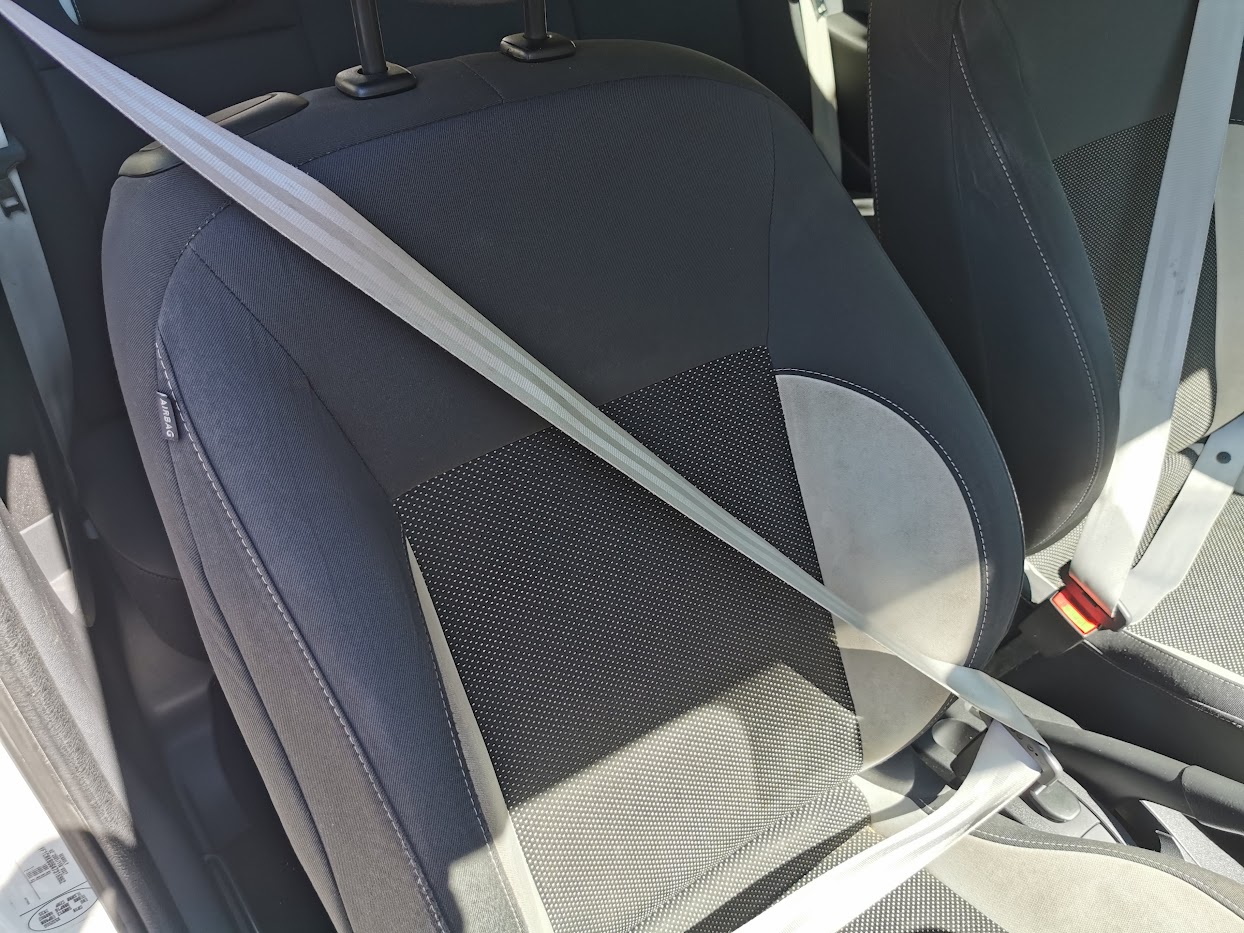

The heat was good for one job today though.
Soaked in a bucket of vanish and then given a little scrub they are now several shades lighter. Still got some muck spots on and the edges will never be clean but better and now they aren't like cardboard they actually retract easier too. Silver seat belts ffs renault!
