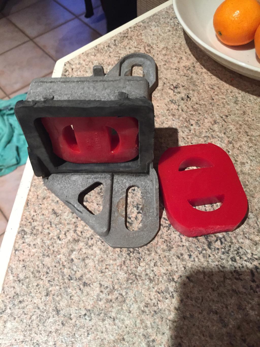

I will be changing my exhaust mount rubbers tomorrow due to the standard ones deciding to collapse. I have chosen to go with some Powerflex rubbers as i've always heard high opinions on them.

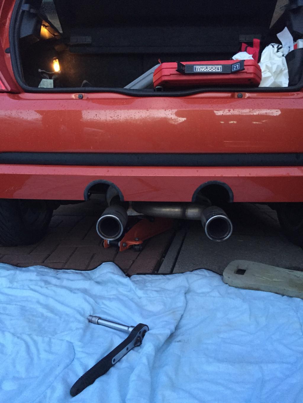

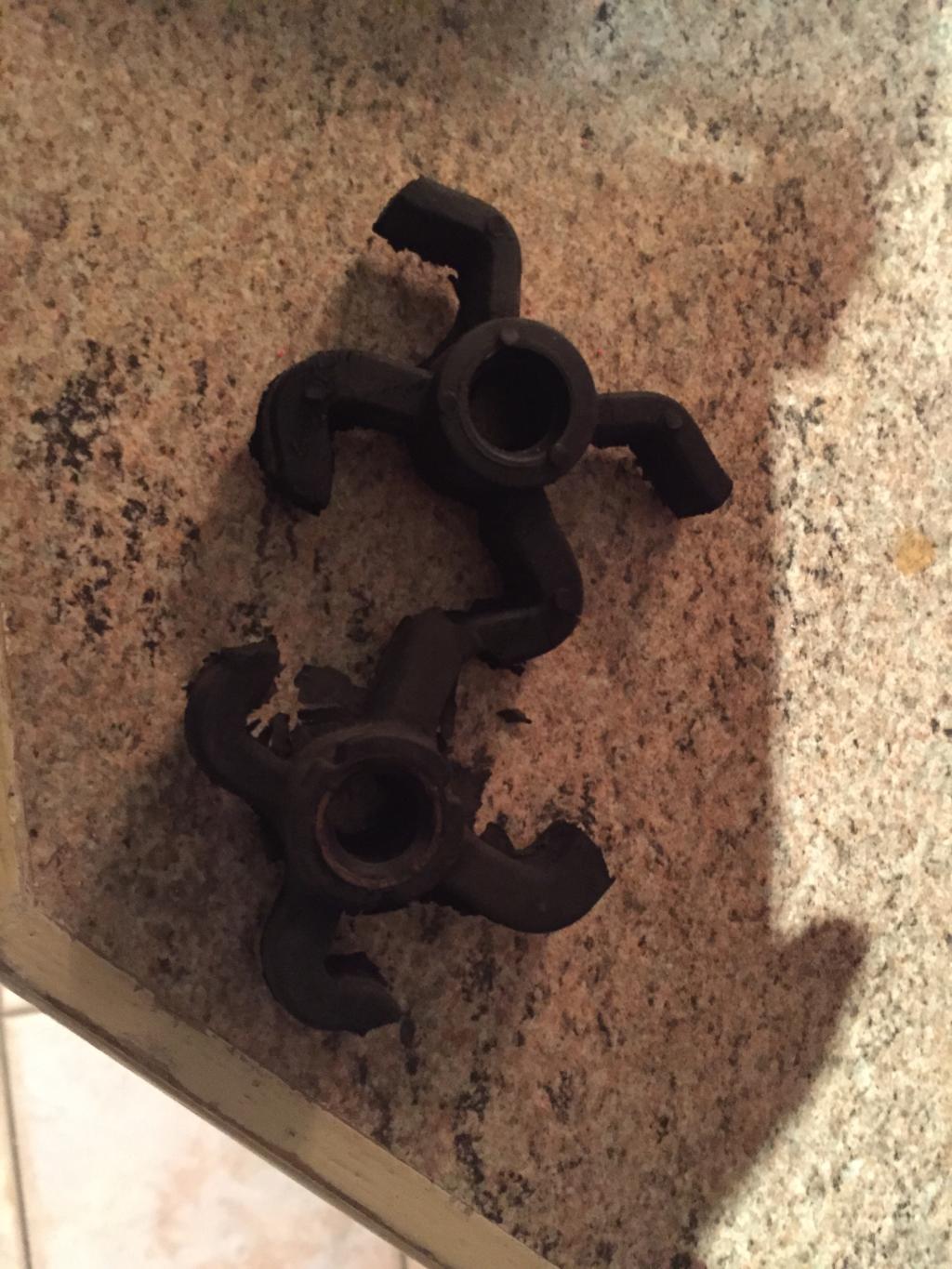

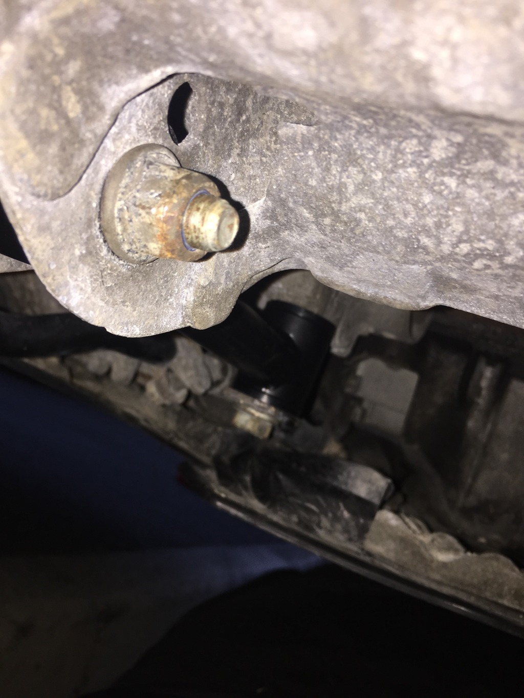

A few weeks back my exhaust mount rubbers decided to collapse, i decided to buy the powerflex rubbers then replacing the old ones with new Renault ones as they will end up collapsing again down the line. My mates mounts were too stiff and the exhaust was rattling on the rear bumper so we decided to change both at the same time.
Once done couldn't resist a cheeky photo :tongueout:

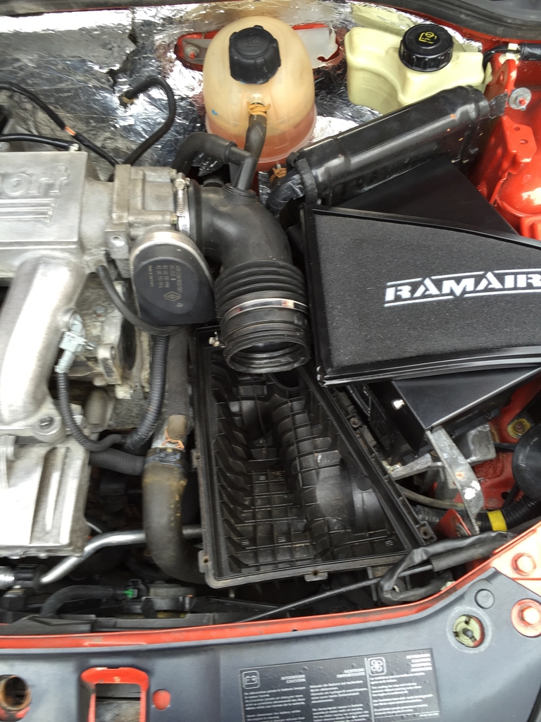

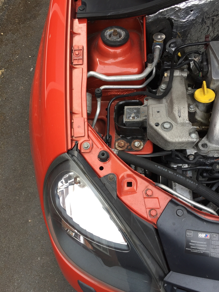

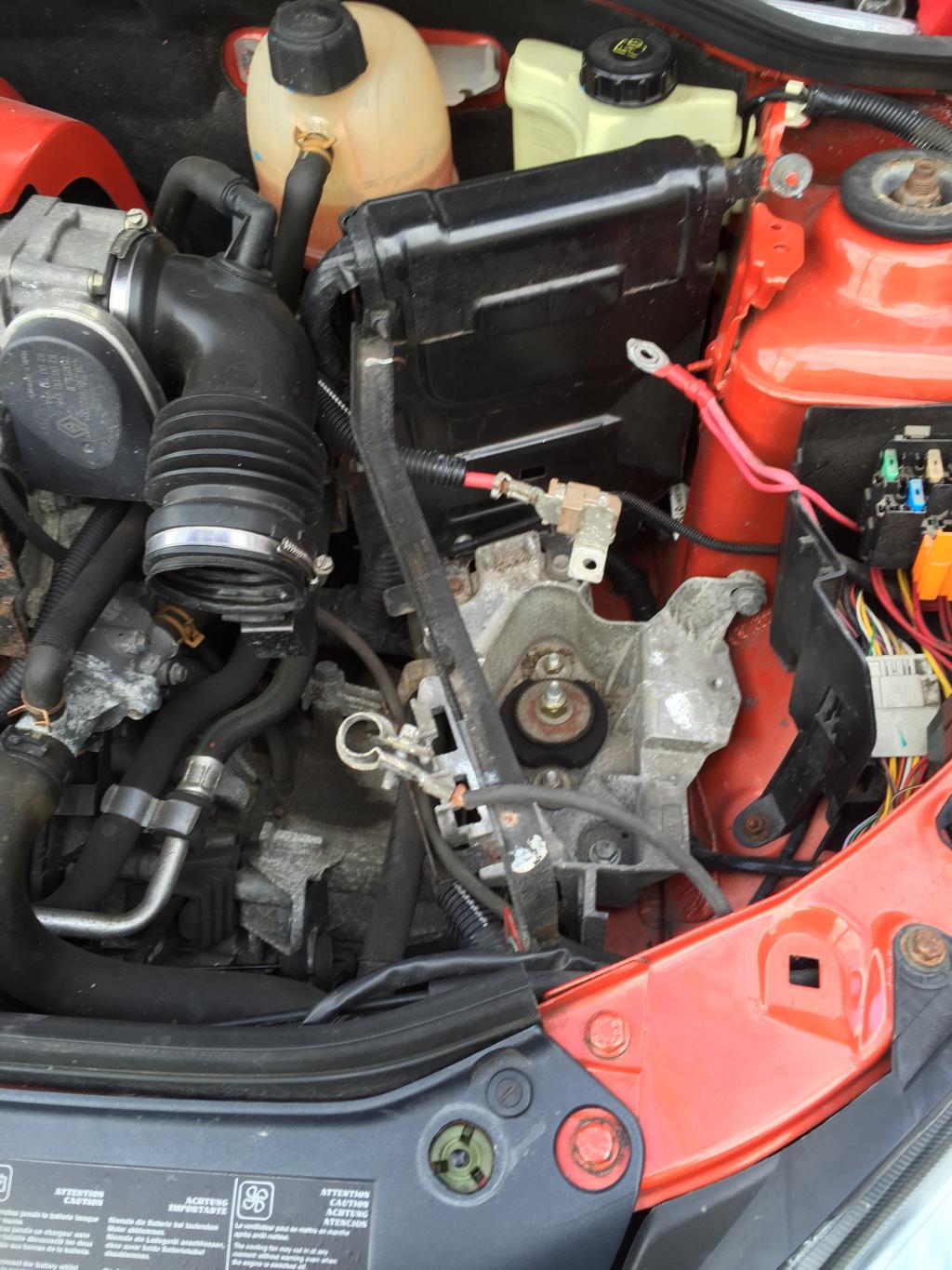

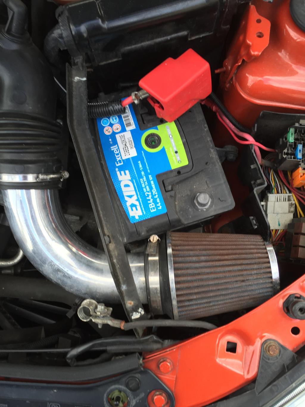

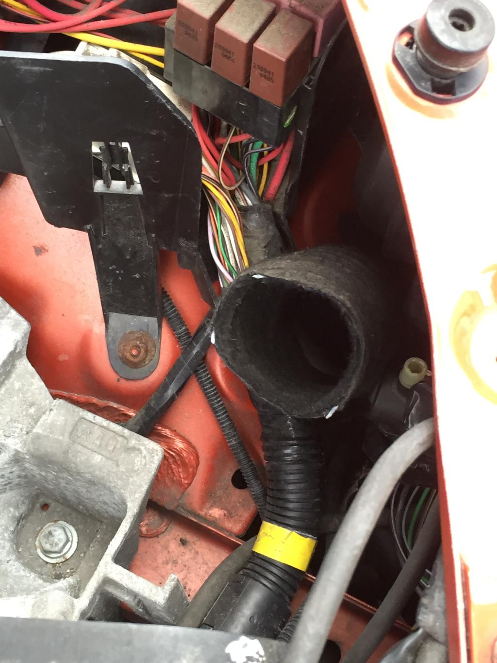

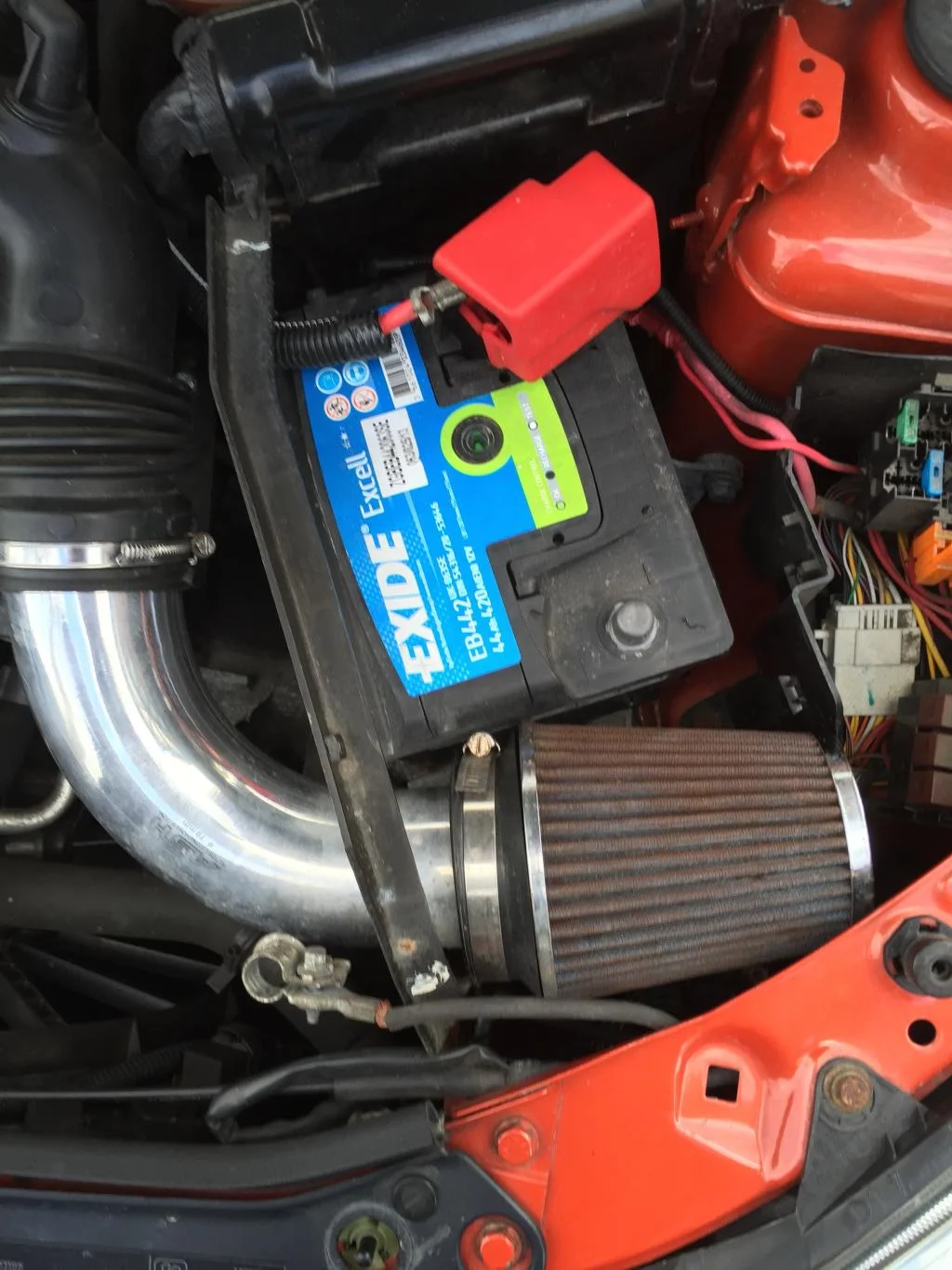

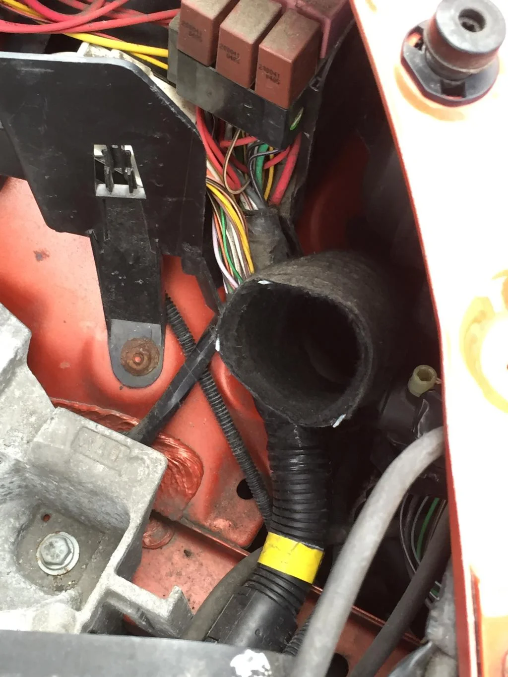

Before the event decided to give my car some TLC and some alterations. Before i cleaned it i decided to re-fit the cold air feed pipe i had to take out to fit the new air filter.
To access the area of interest i decided to remove the battery which made life a lot easier.

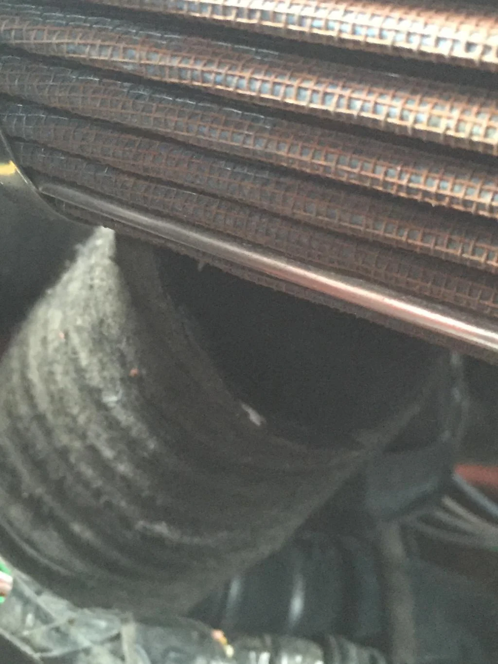

Once the pipe was re-fitted it needed to be cut so i could fit the new air filter.
Sits nicely under the air filter :smiley:
All snug back in position

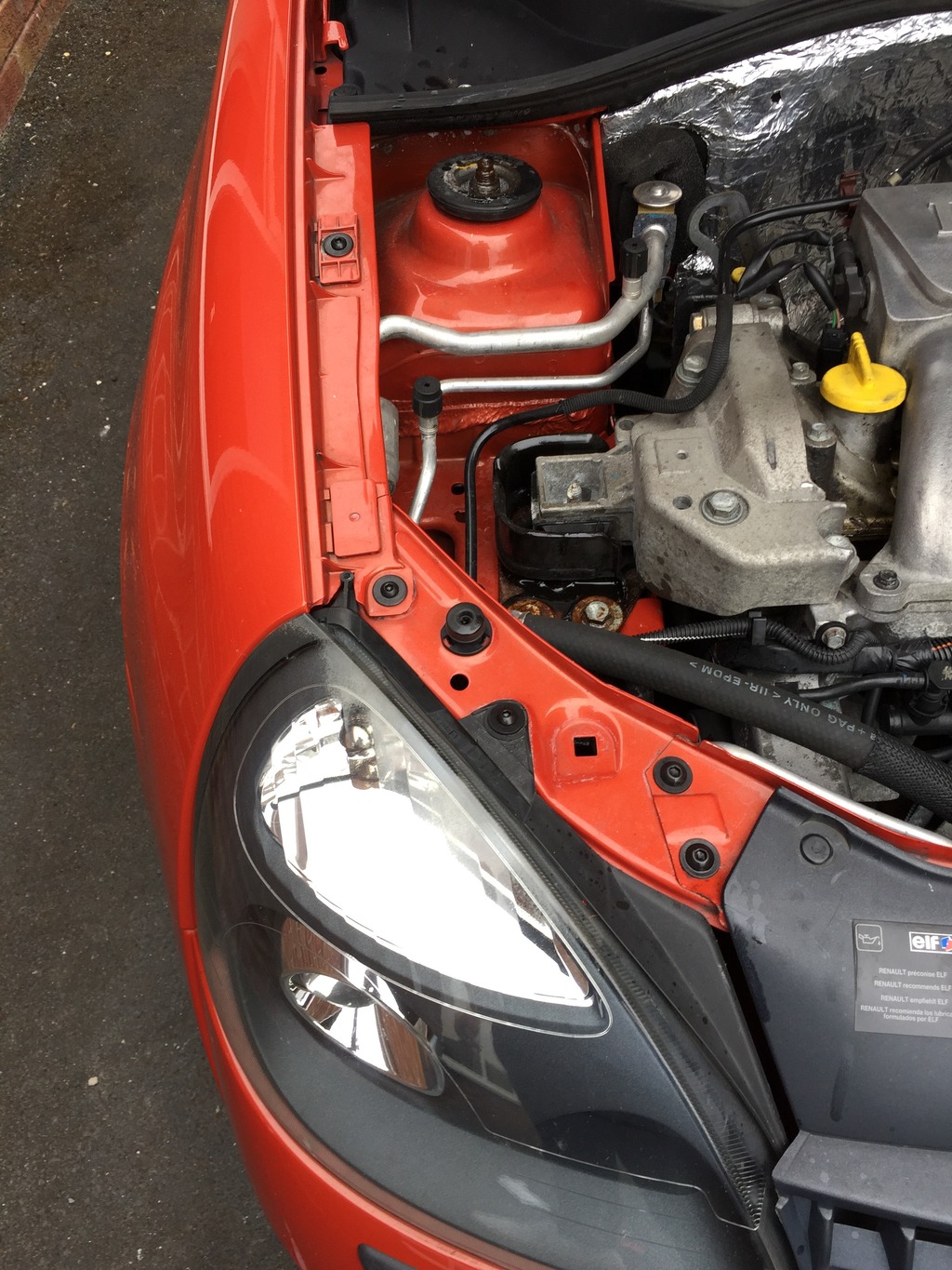

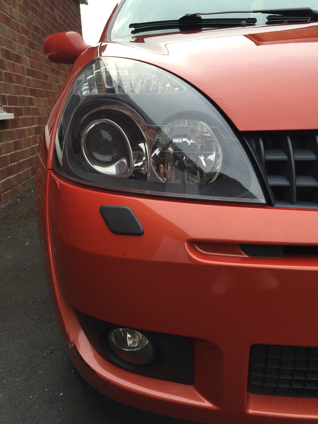

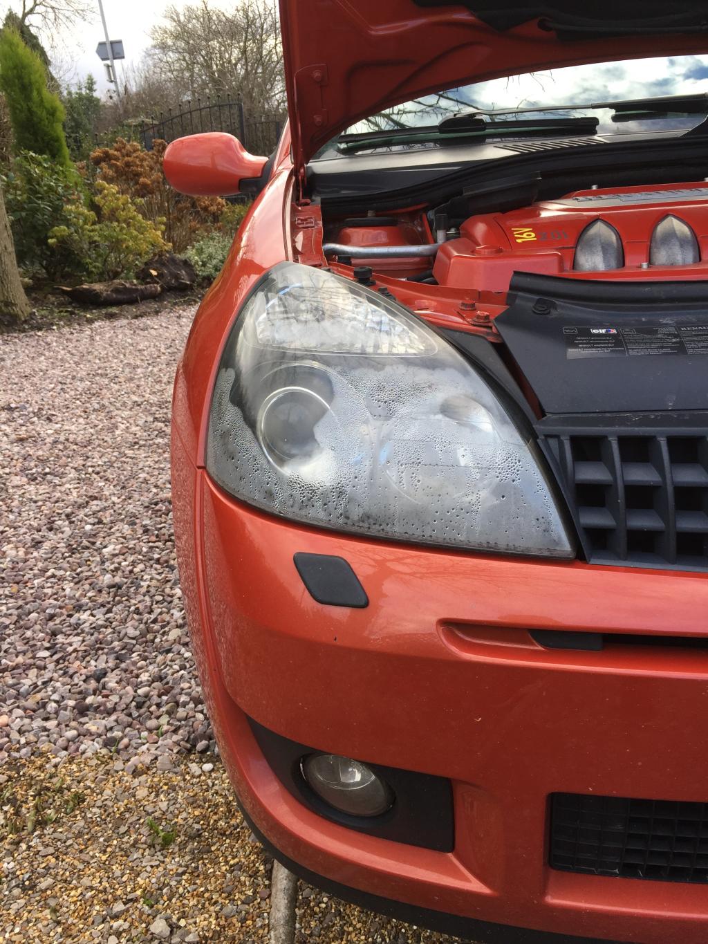

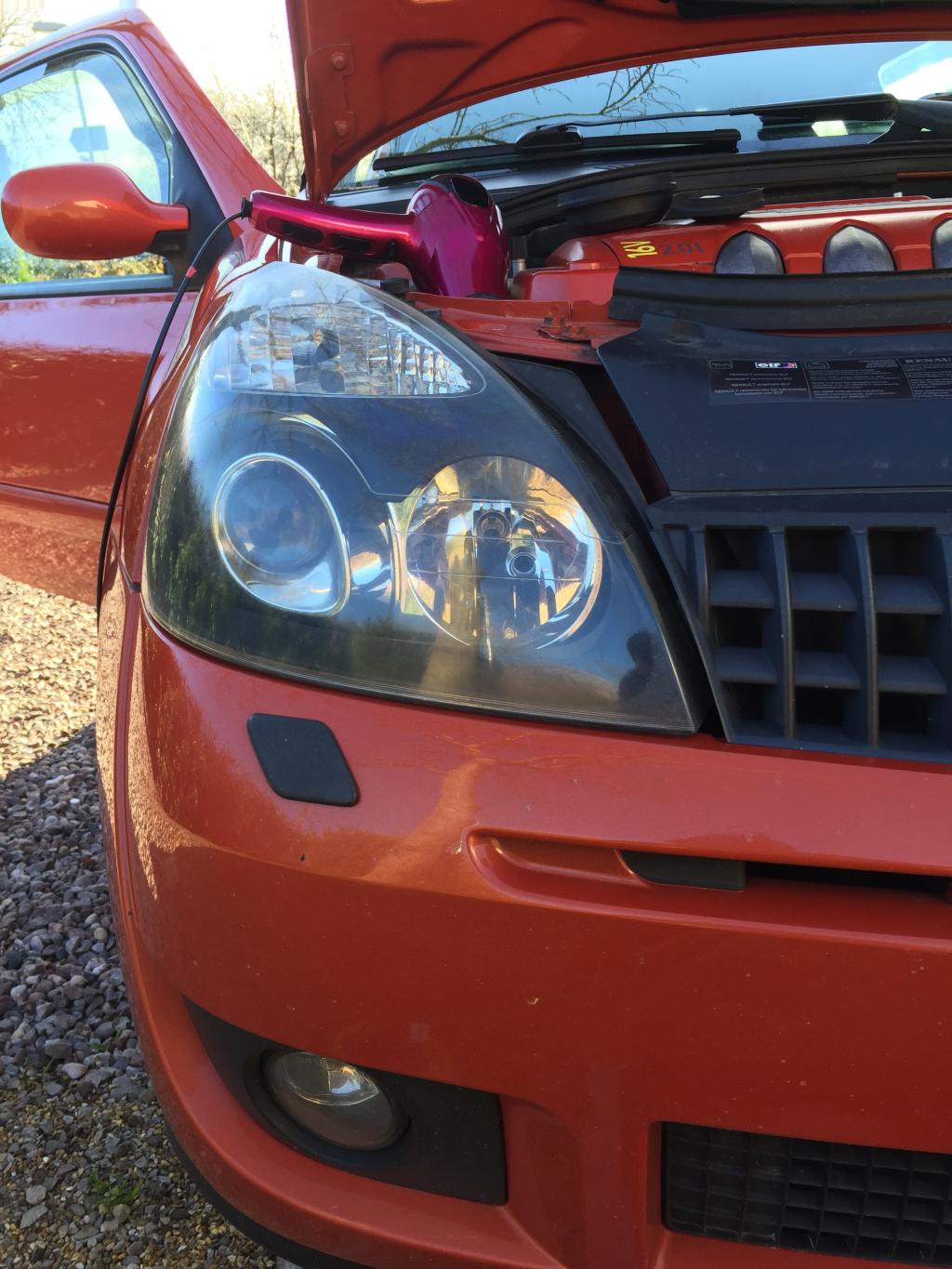

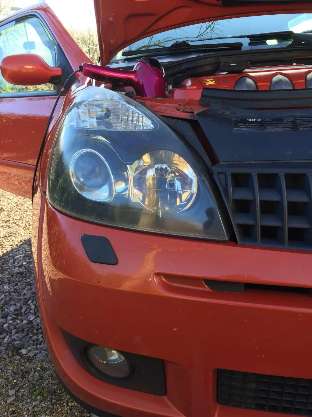

A problem that has been getting on my nerves for some time is the condensation in one of the front headlights.
Time for the trusty hair dryer to do its job :up:

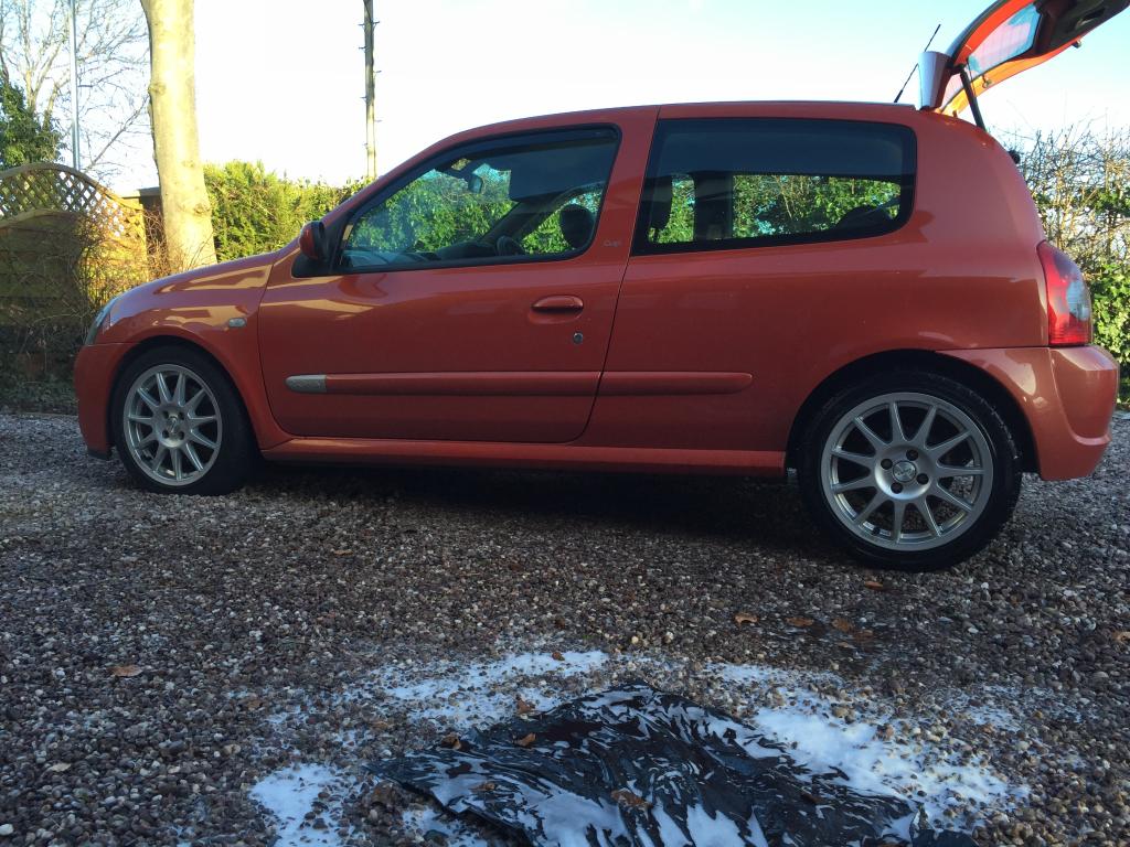

Now time for a good cleaning :smile:

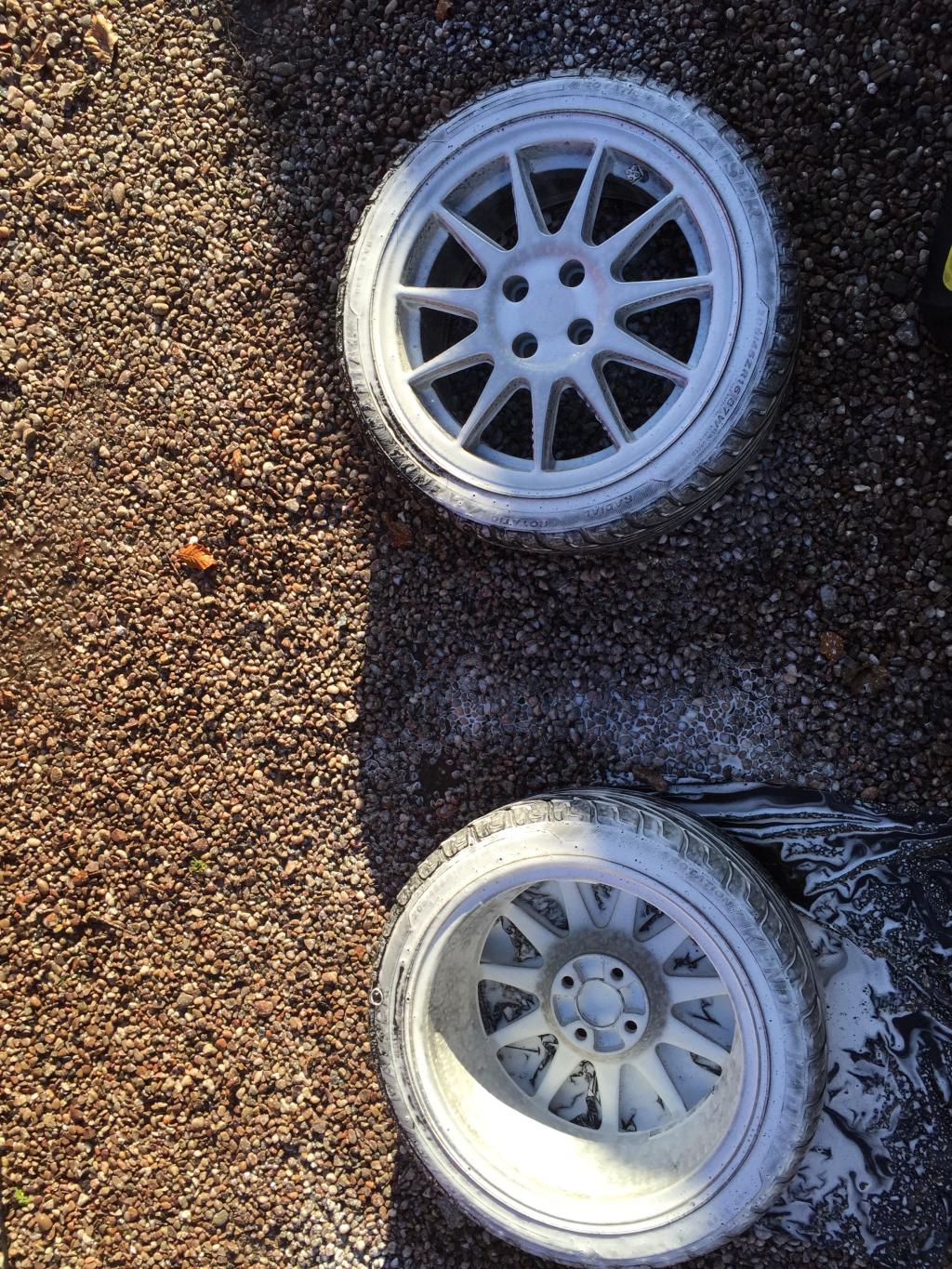

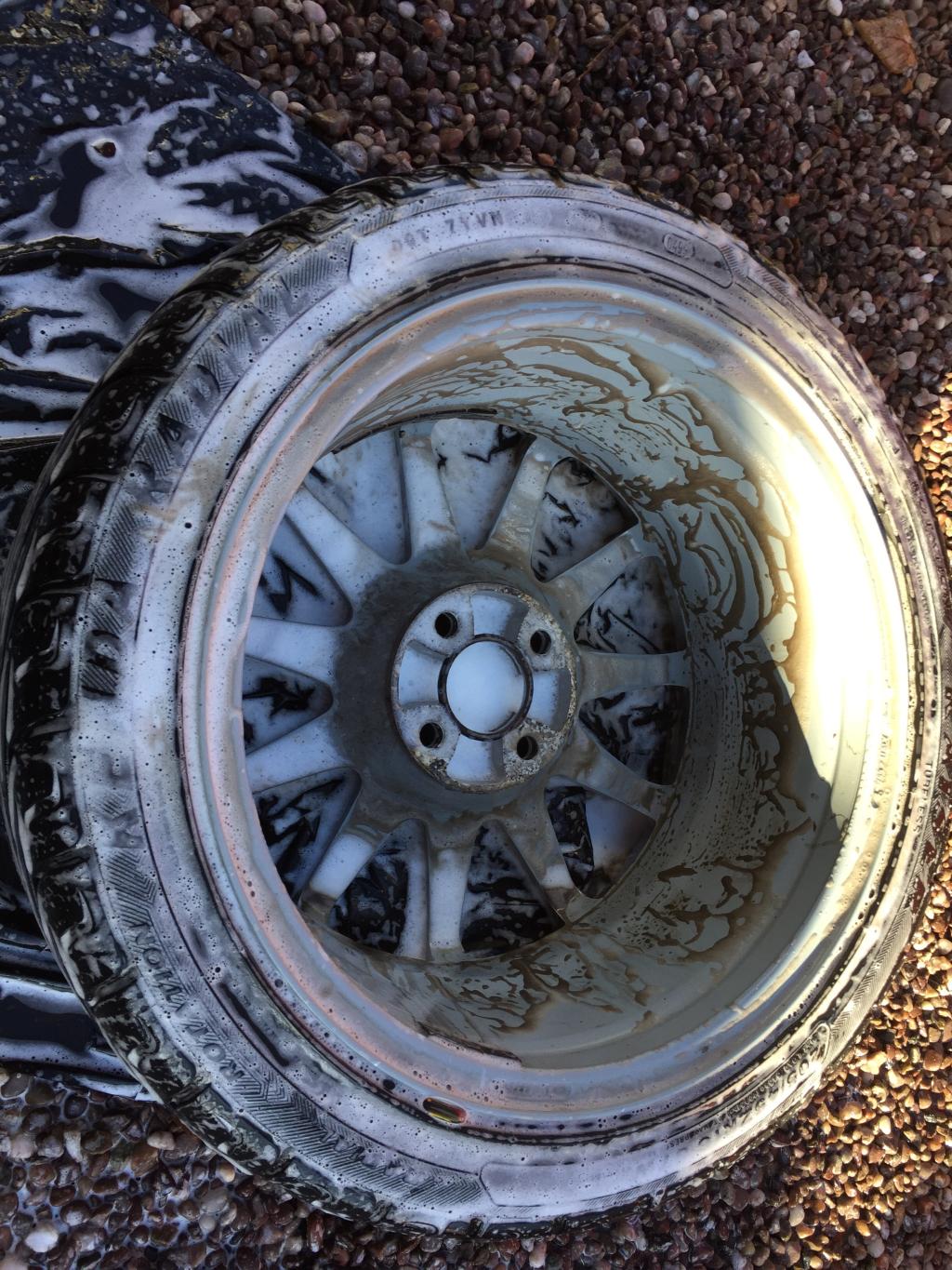

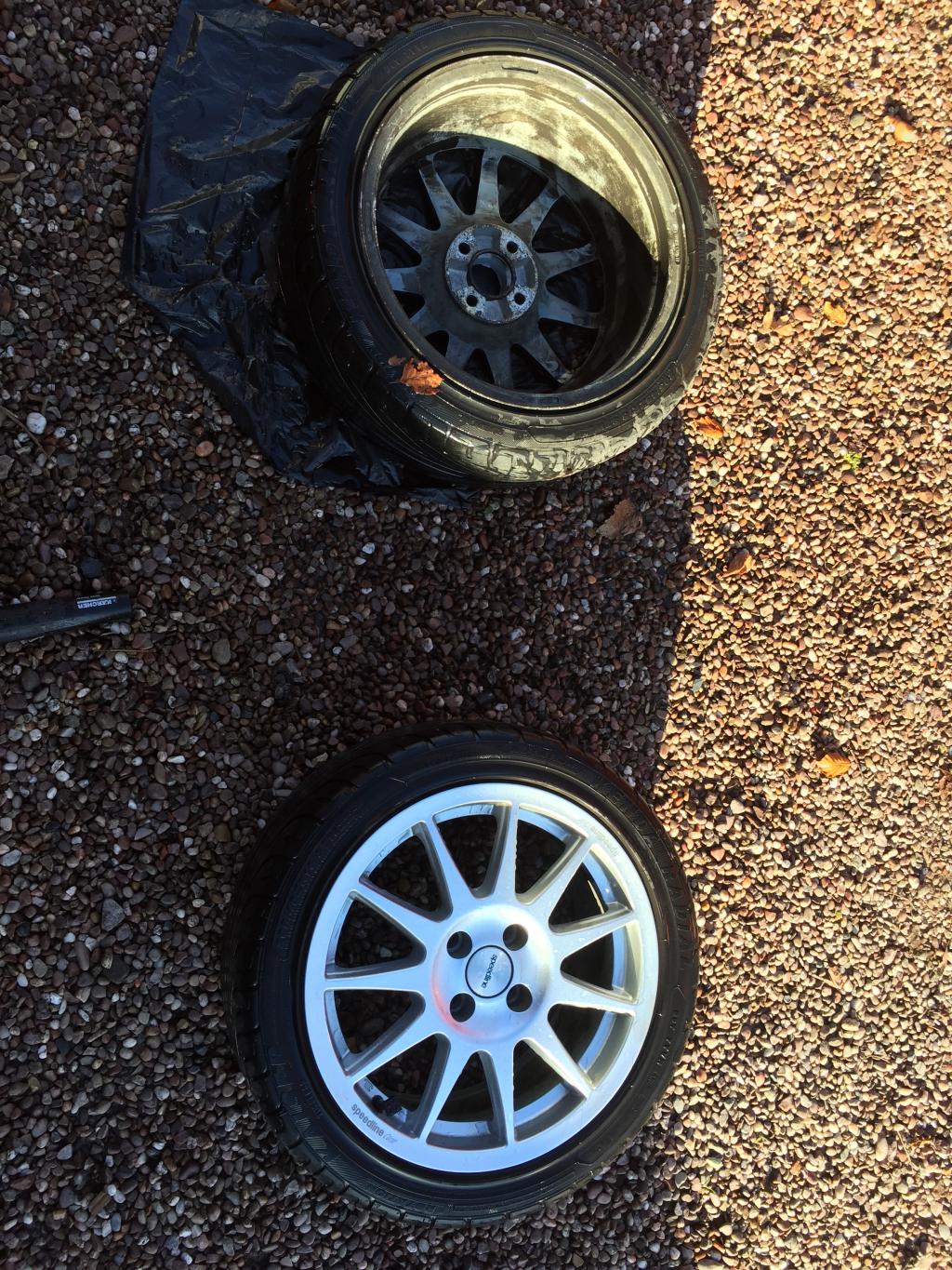

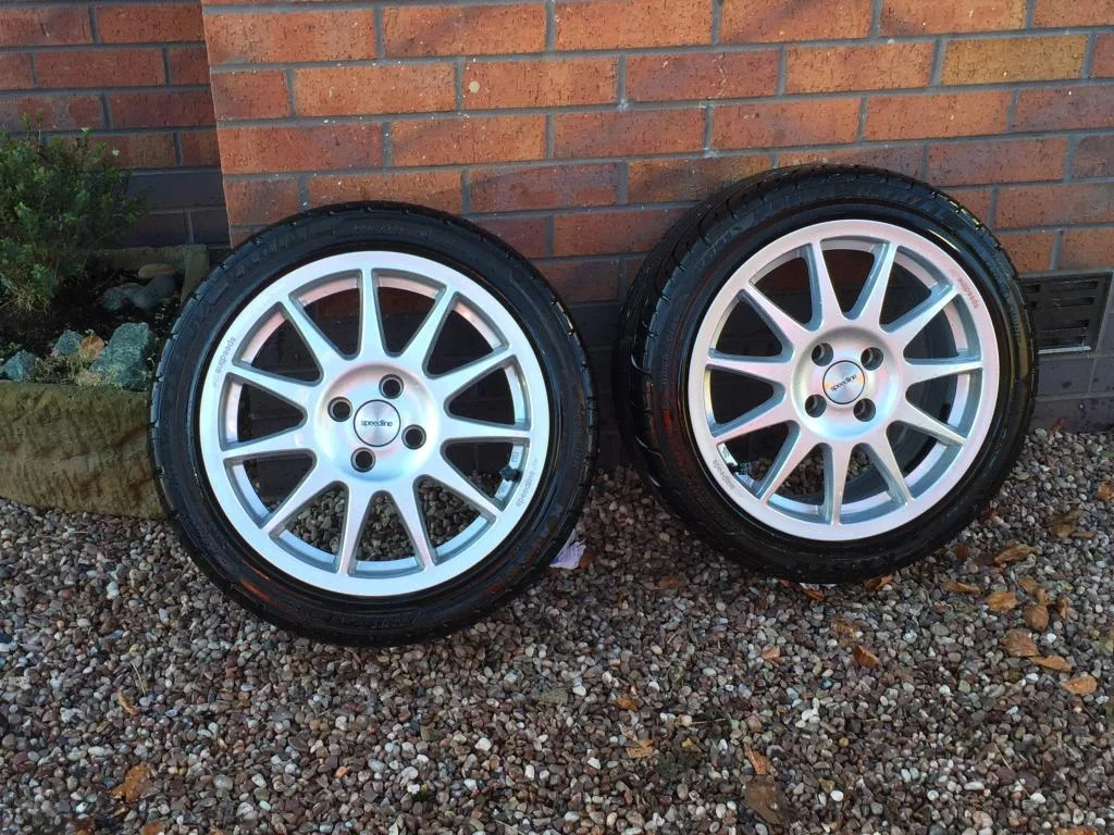

I started off with giving the wheels a proper snow foaming and scrub once off the car.
They came out looking well :smile::up:

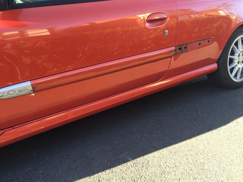

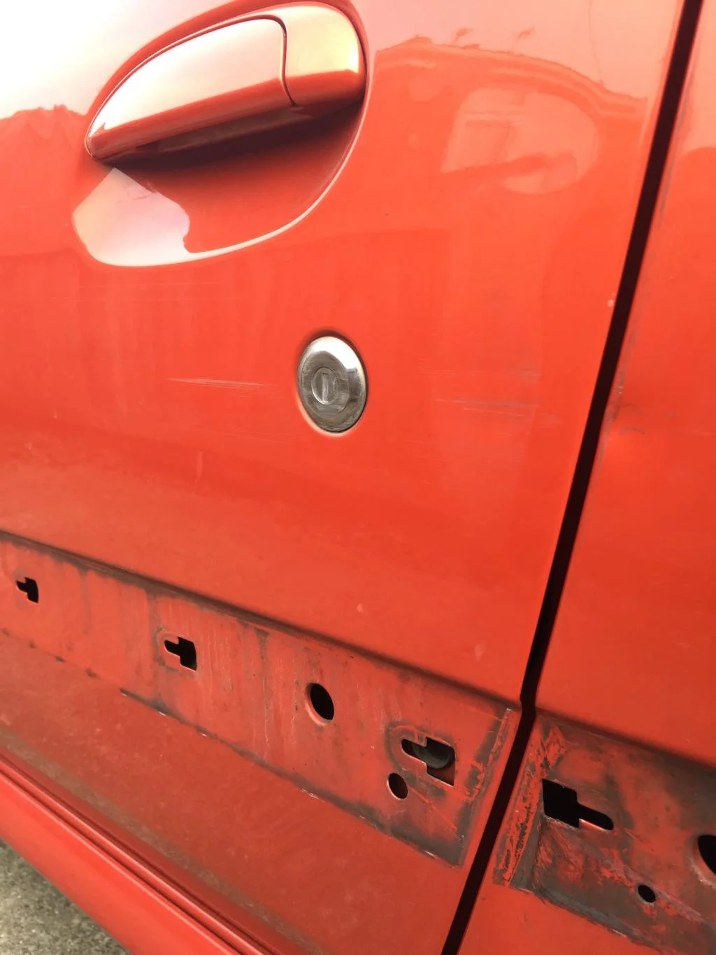

Before i got it sorted i manged to scrape down the side of another car that was hidden in front of a bus (s**t myself) when i saw the damage i nearly shed a tear, (lost the rear trim).

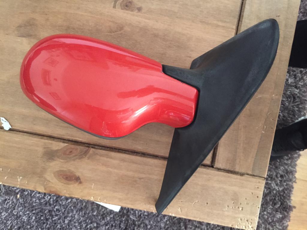

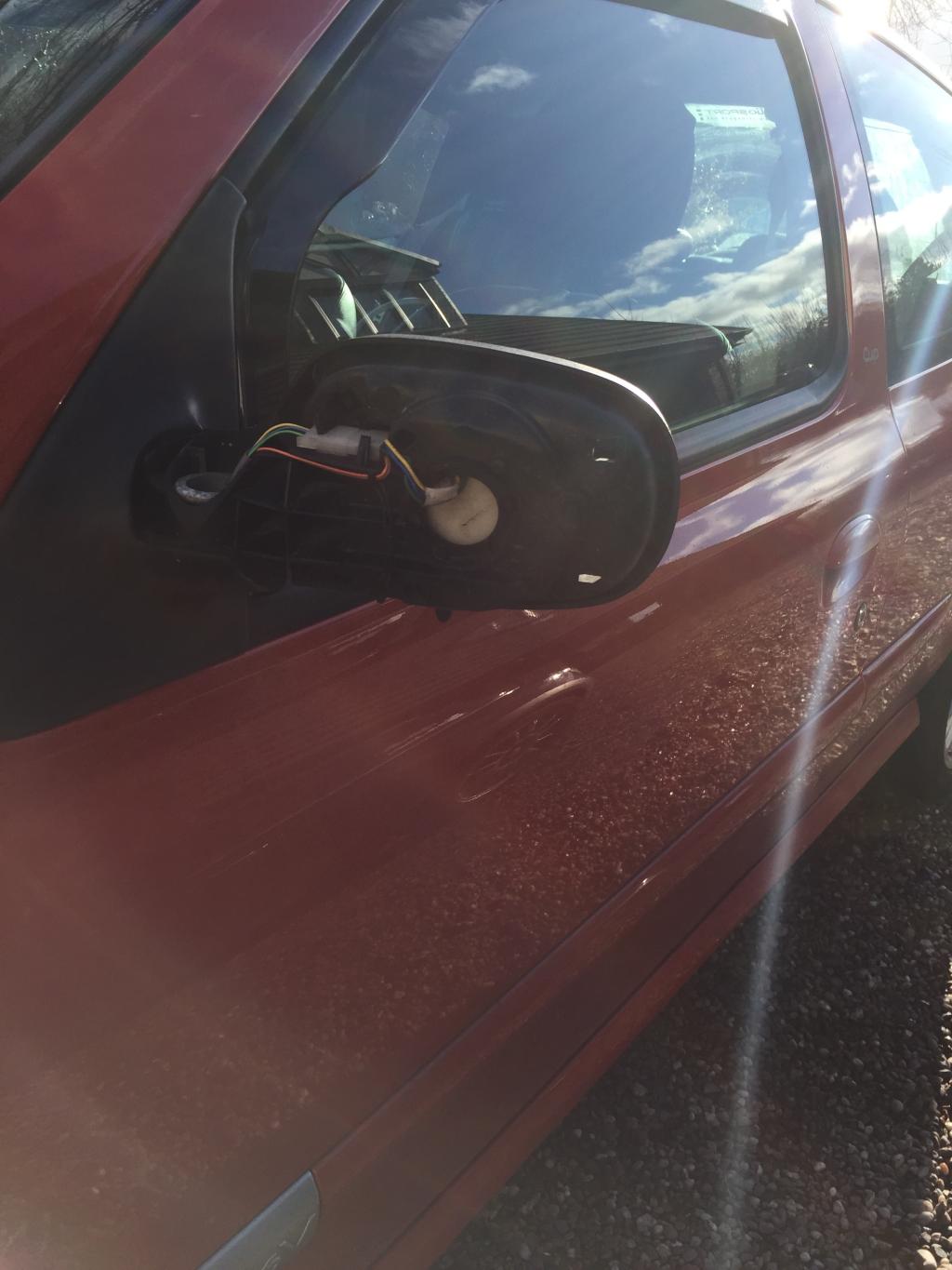

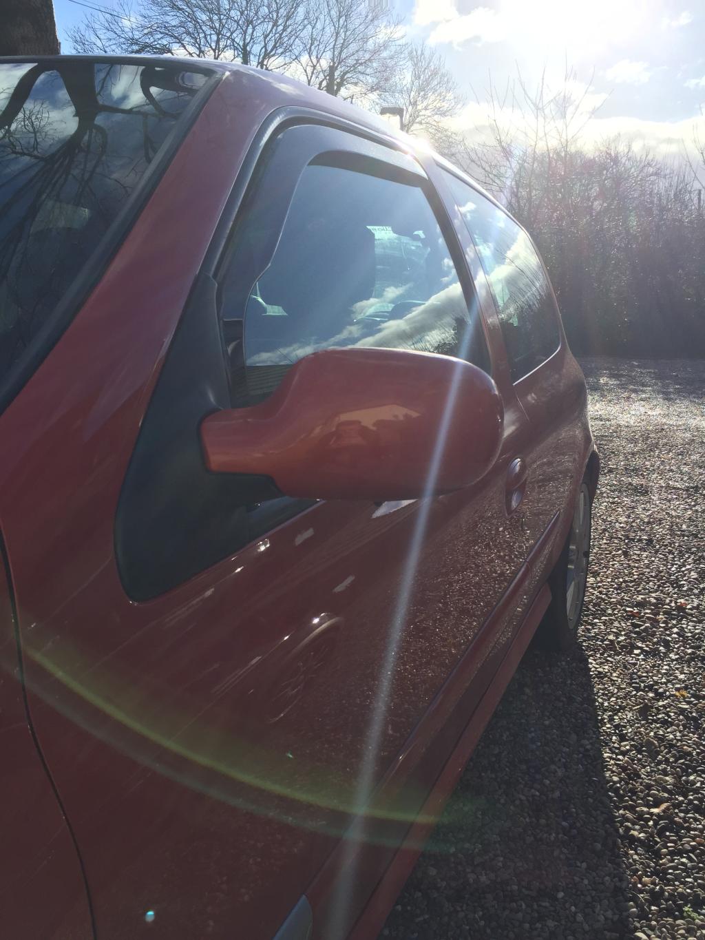

I got a quick replacement for the wing mirror cover which was quickly fitted.
Looking on eBay and the internet i manged to get a replacement bullet and trims. I soon got an e-mail telling me the rear trim section had been damaged in the post so i only got the front and bullet (still missing rear trim). I fitted the new front trim and bullet which ended up getting stolen 3 days later :astonished::rage:. I am now left with no trim or bullet on the passenger side :down::tired:.
I have recently found a full set of trims and bullets in blue which i'm gonna spray orange in the next week.

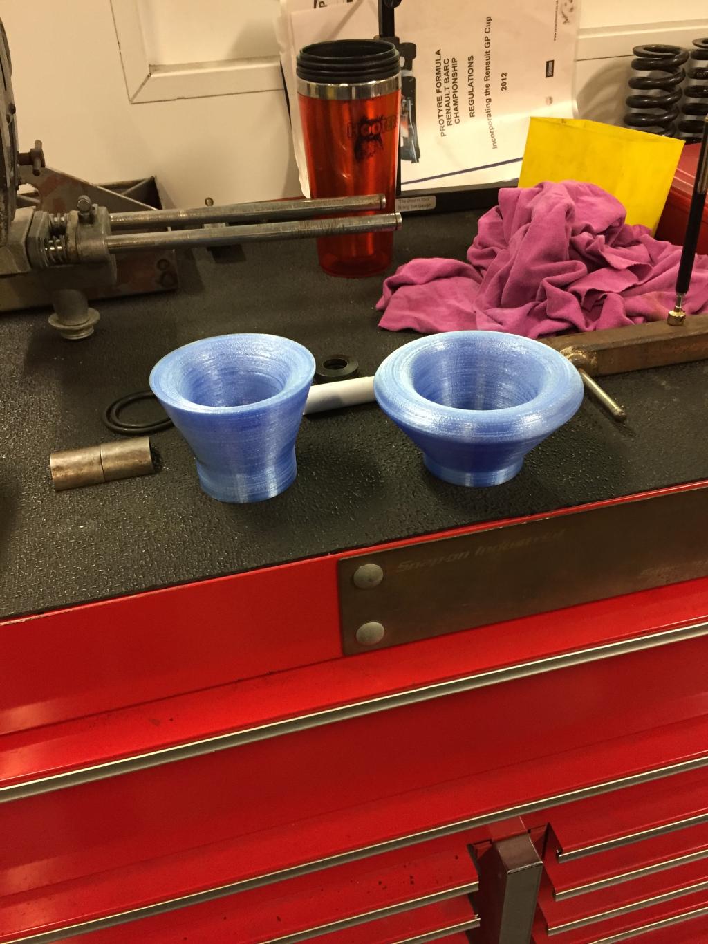

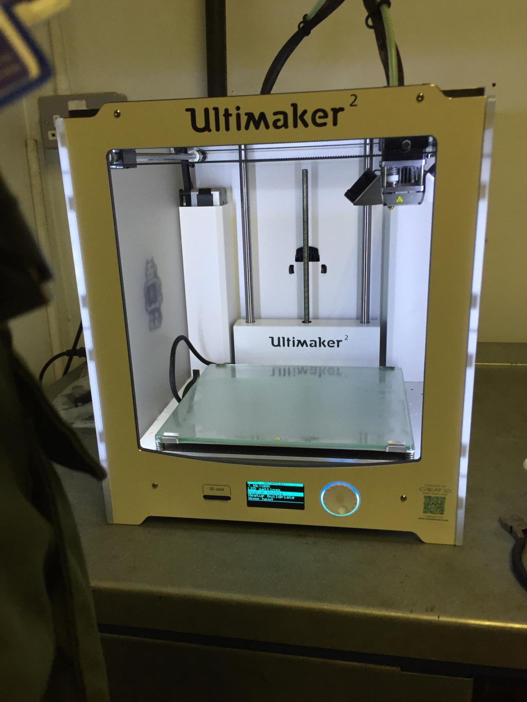

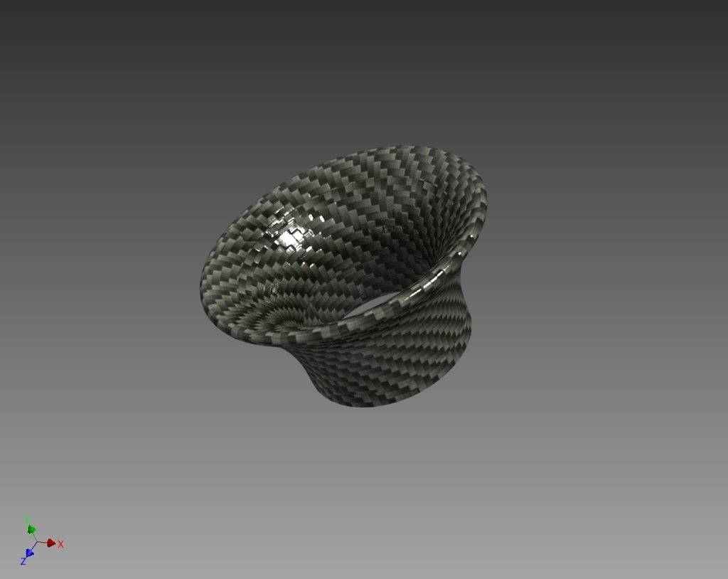

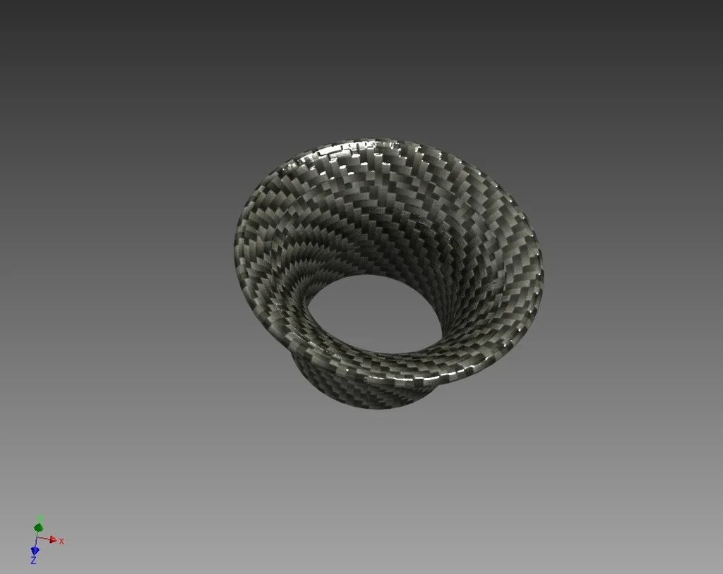

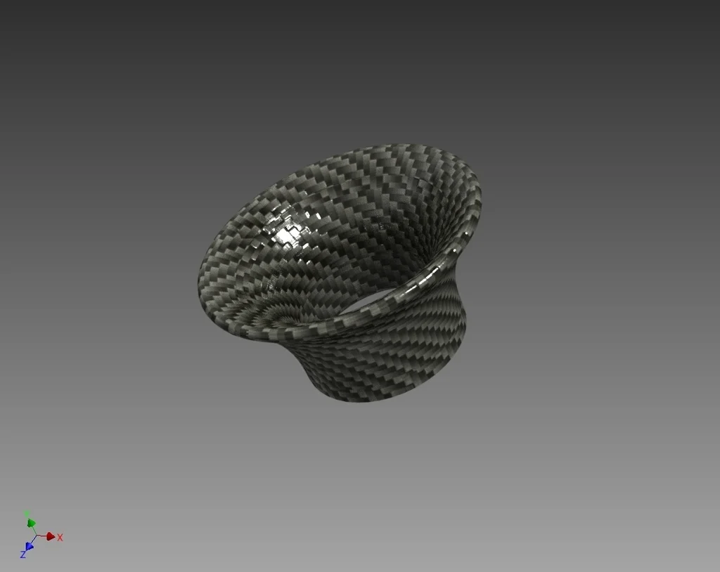

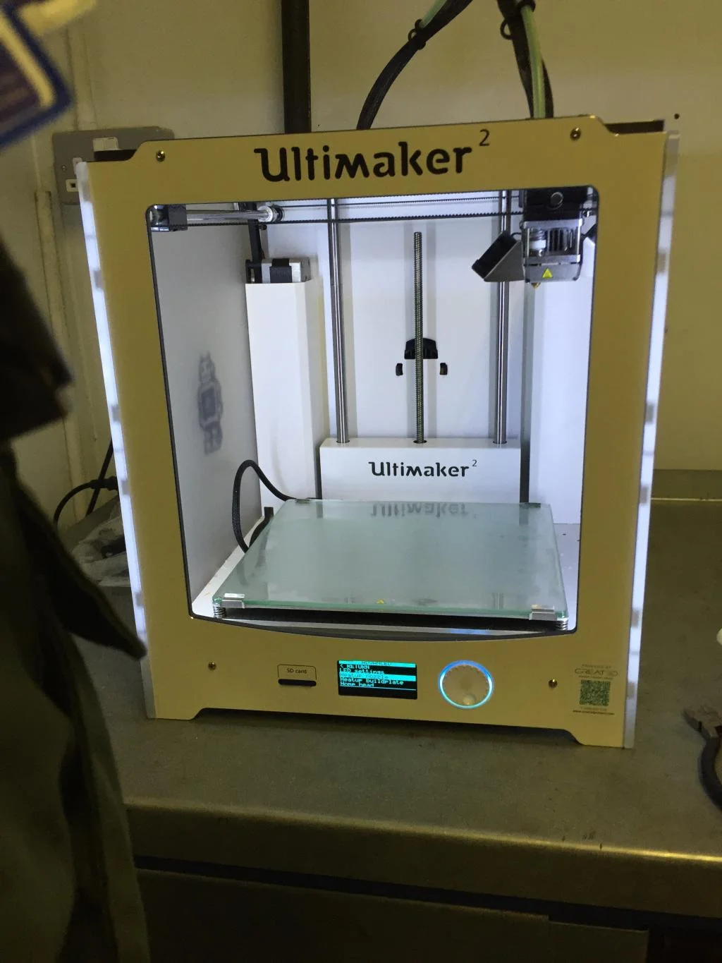

Another alteration i have decided to take on is designing a trumpet for the end of the cold air feed using 3D-Cad and a 3D printer. I've got two prototypes made up.
Once I've decided on a design i will then get it re-printed in the best quality in my chosen colour.

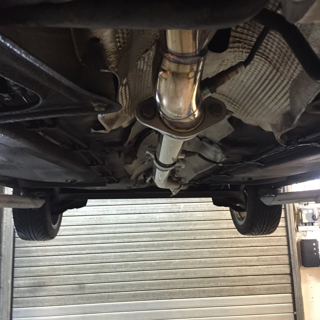

To make up for the negatives i have decided i am going to purchase a de-cat in the next week, this decision was made due to hearing the delightful noise @Stonzy car has been making with his de-cat.

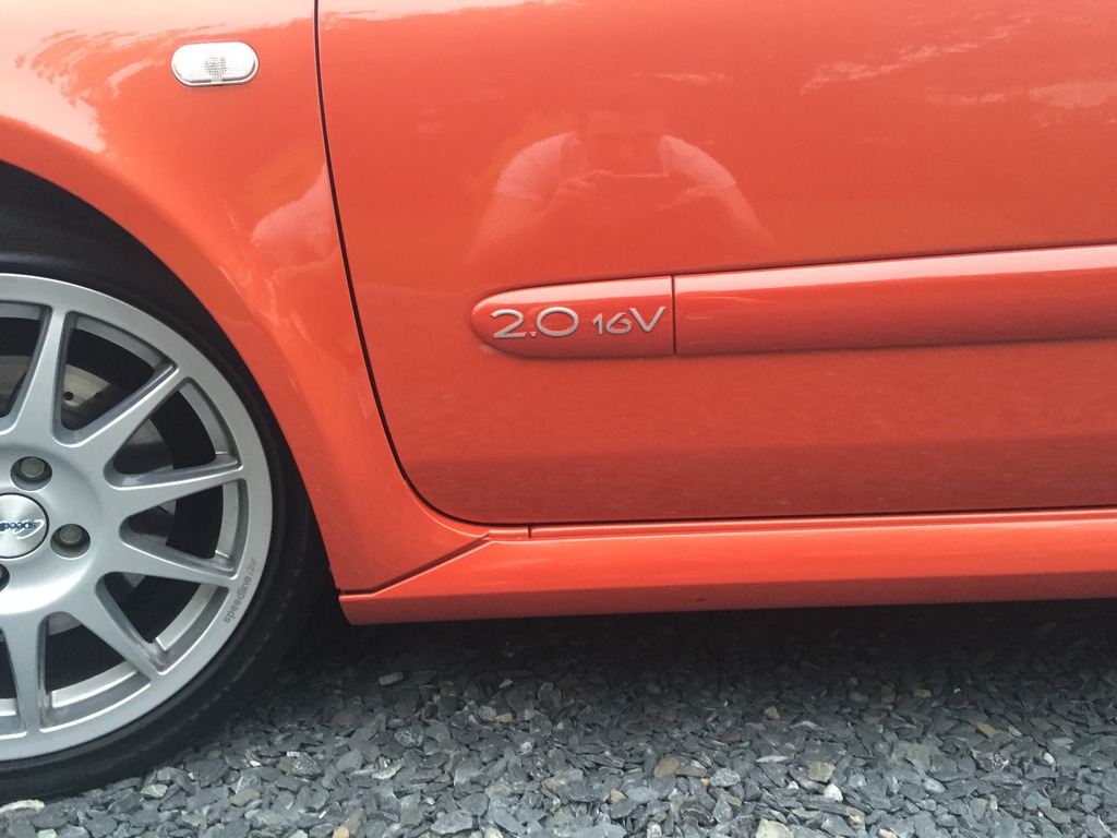

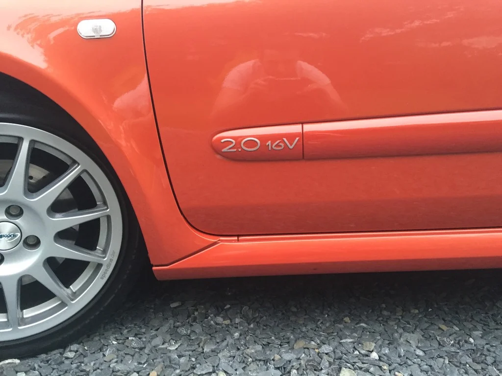

It's Been a hell of a while since I last updated this thread and I have carried out a lot of work on the old guy. After my replacement trim was robbed i decided to purchase a set of blue trims and spay them inferno orange , also i decided to spray my bullets orange and the 2.0 16v silver.

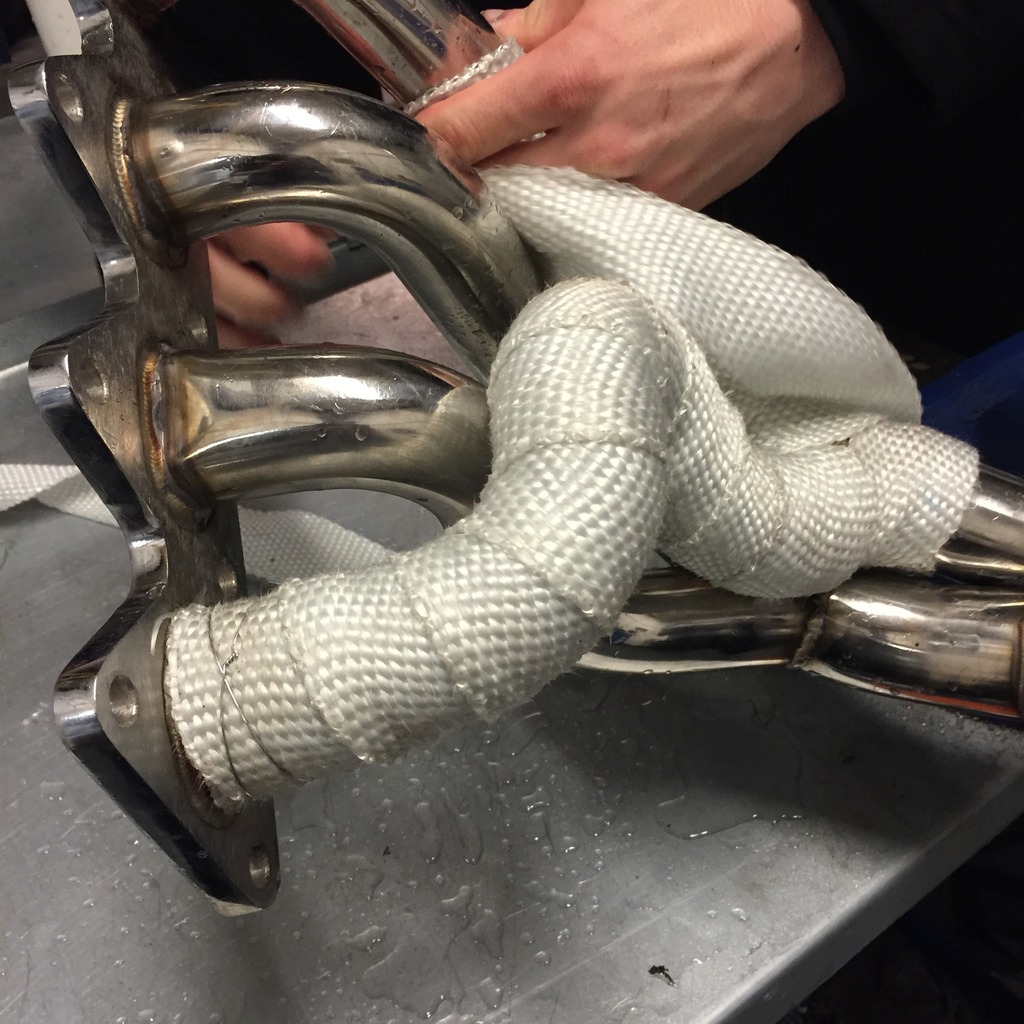

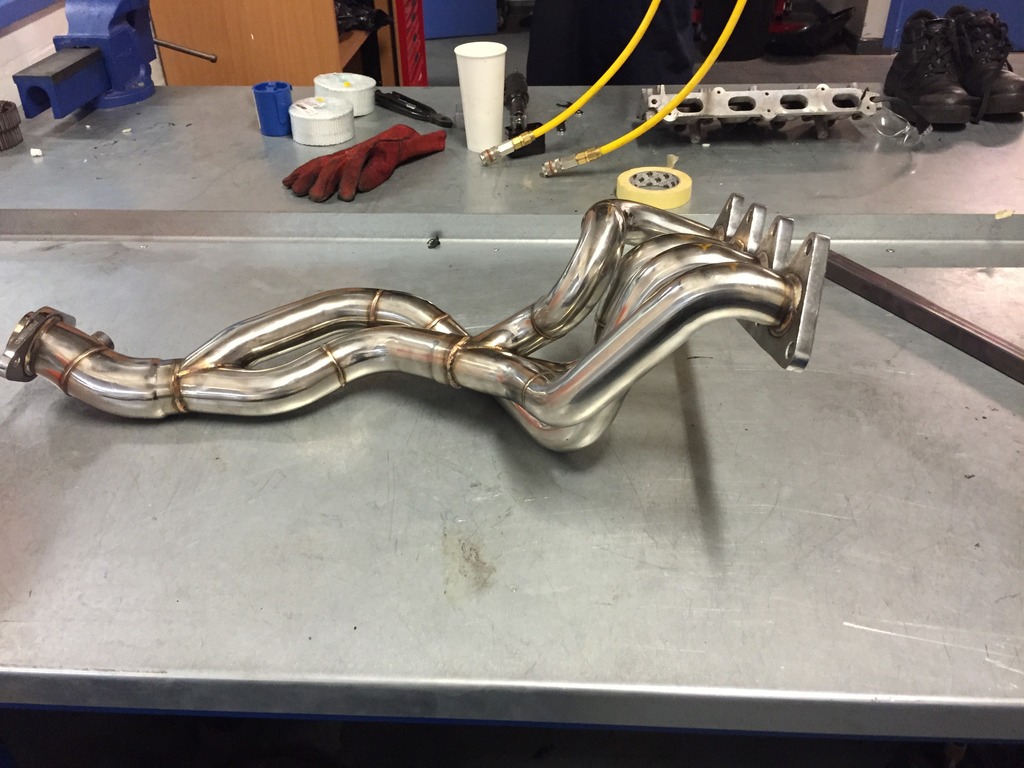

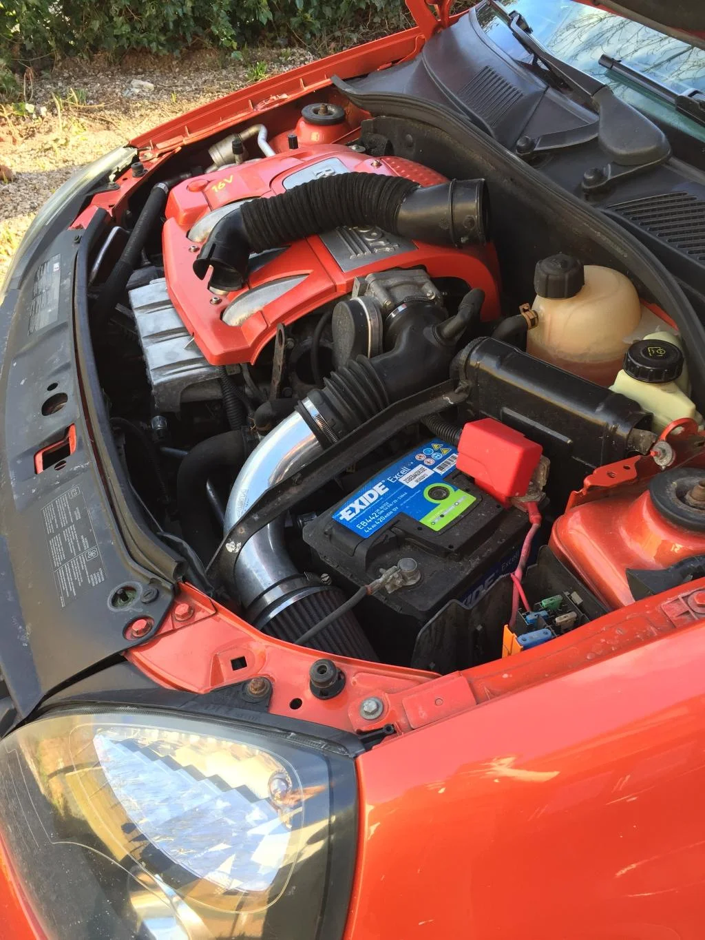

Now my body work was finally back to par for the third time lucky and i was quite happy with the results of the bullets. Next I decided to purchase a toyosports manifold and manifold plus a non resonated scorpion centre section. When purchasing this I didn't realise exactly how much of a ball ache fitting the exhaust manifold would be :weary:, I ended up having to drop the subframe, disconnect the steering rack and the gear linkage, also remove the intake plenum just to fit the exhaust manifold. Before the manifold was fitted I decided to heat wrap the manifold. Implementing this i ended up getting drenched and covered in fibres which don't particularly play nice in the wash :tonguewink:.

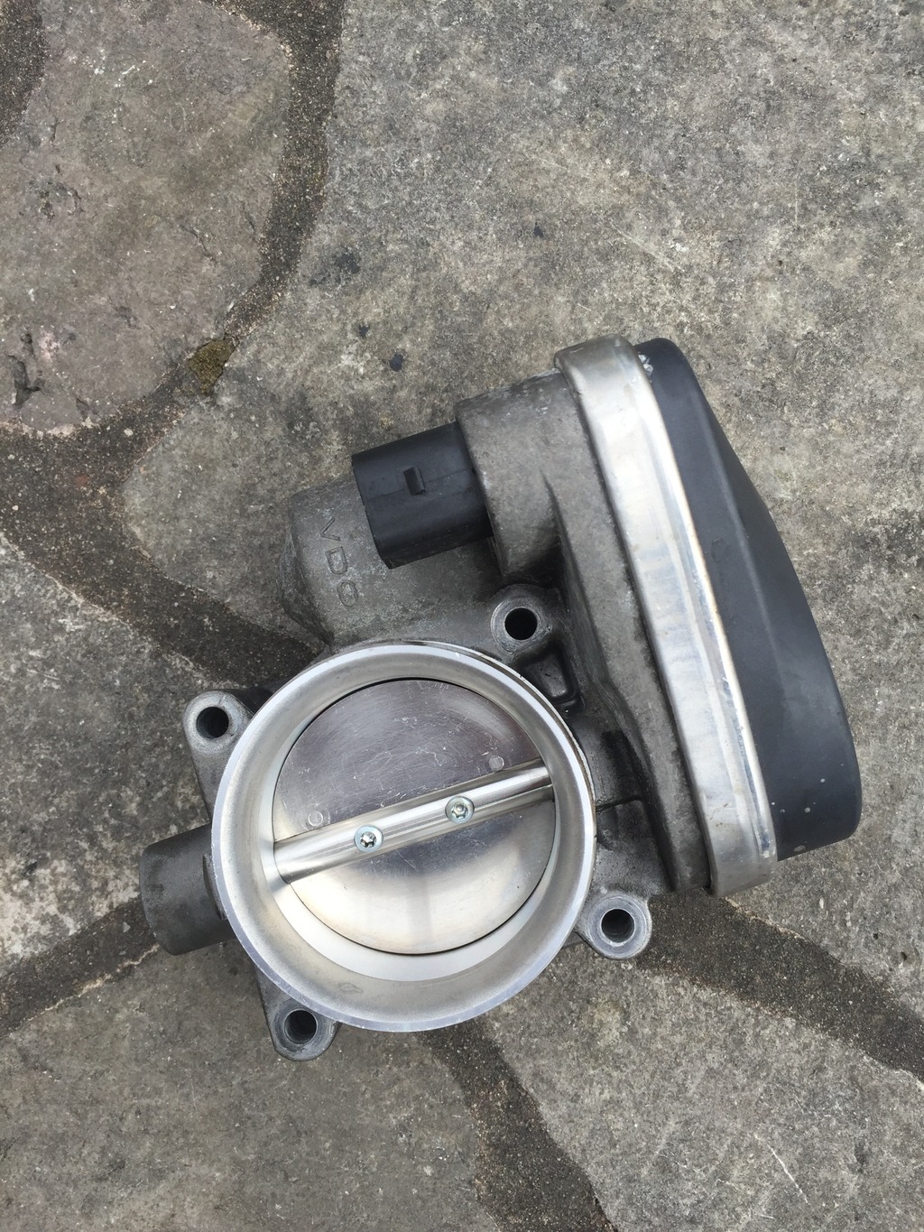

While the intake plenum was off the car I decided to clean the throttle body as it was full of grime, after some carburettor cleaner and some elbow grease it come out like new :up:

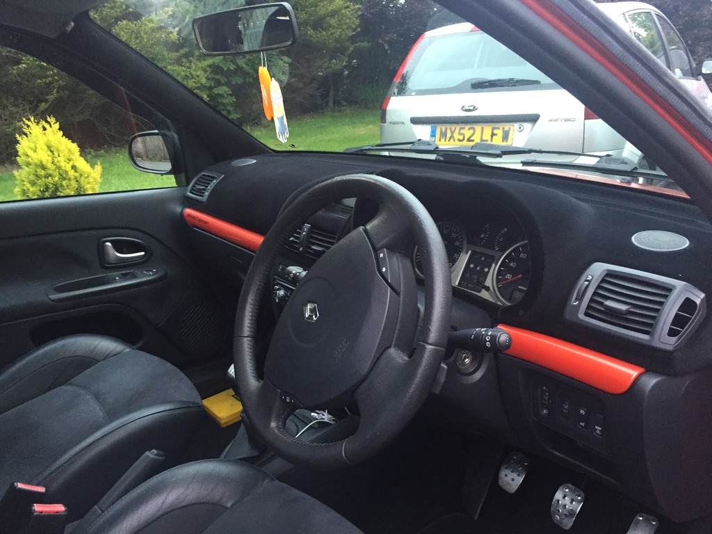

The next edition to the car was a flocked dashboard and pillars. Luckily for me @arctic-182-rs was selling them on here. The top dashboard was quite simple to fit however I had to break the standard pillars to get the sensors off them. Once fitted i really think it finishes of the inside, however I didn't anticipate how annoying they would be to clean :grin:

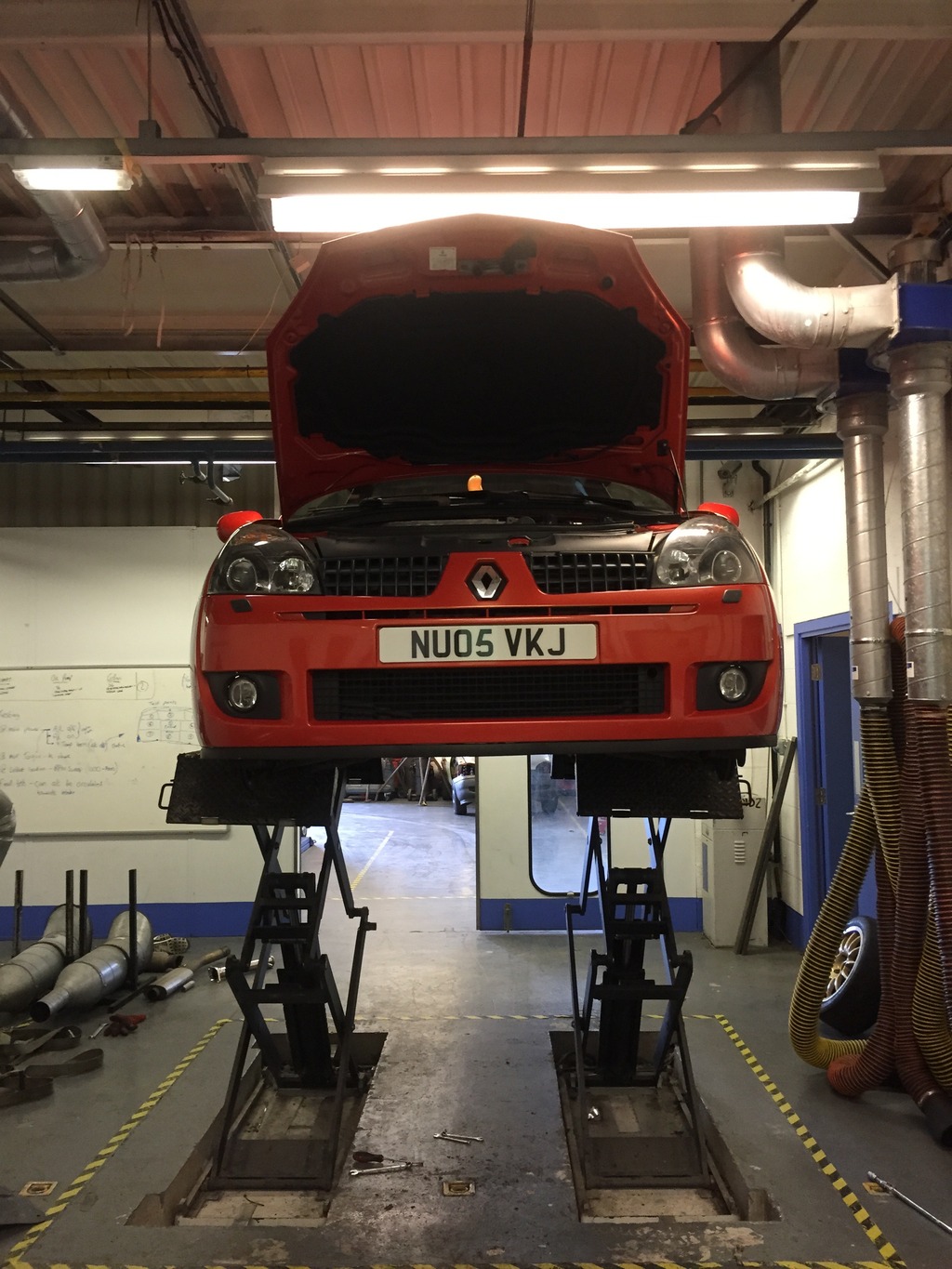

After recently finishing university I have recently landed a job as a dyno test engineer which is awesome. Once receiving my first pay check I decided to spend a little bit of time and money on my car. I decided to alter a number of little things before I start purchasing bigger upgrades.
I decided to:
  • Purchase a Battery cover
  • Replace slam panel bolts for new black stainless steel ones
  • Change washer jets for Peugeot Mist style ones

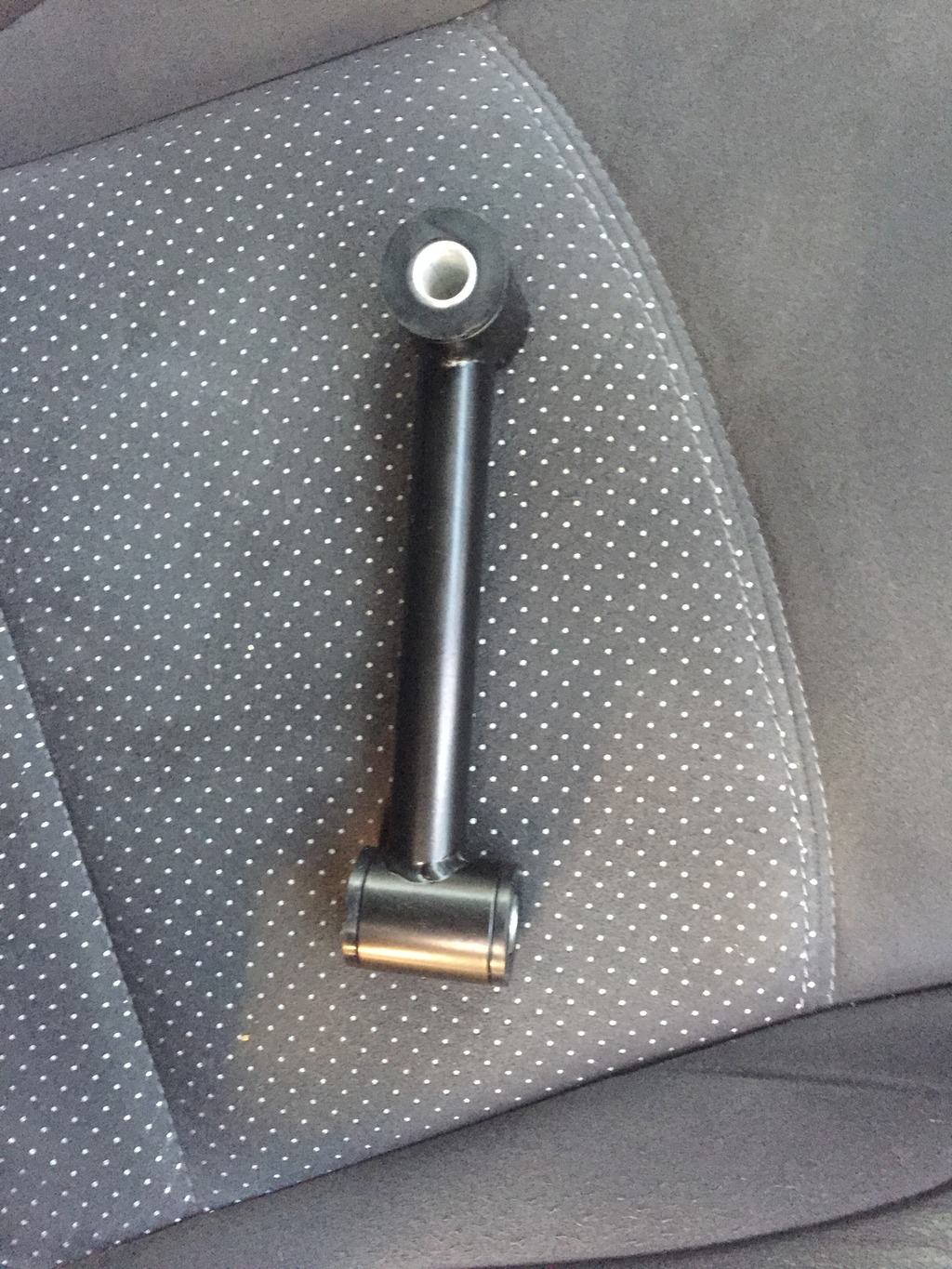

  • Fitted Solid Gear box stabiliser bar
  • Replaced cone filter for standard air box with ram air filter
  • Replaced side Cup stickers with genuine cup badges

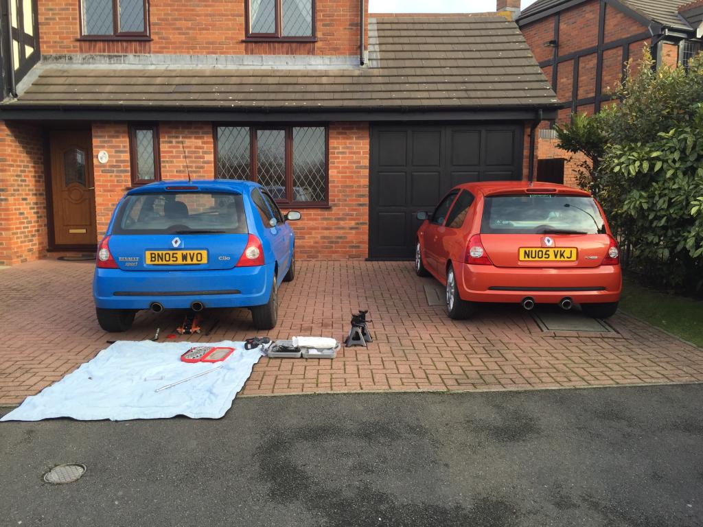

I started off by fitting the gearbox stabiliser bar which was relatively easy as it only consisted of removing two bolts, However I couldn't wait to take my vehicle to the workshop so I decided to fit it outside @Stonzy house with the use of a jack and axle stands.
The stabiliser bar has definitely improved gear changing however there is a slight increase in vibration though the steering wheel which doesn't bother me :D

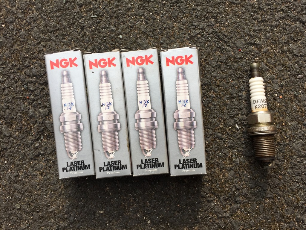

Next alteration to the car was replacing the original spark plugs with New NGK Laser Platinum ones as over the past week I noticed my vehicle was mis-firing, The original spark plugs were definitely past it and weren't the recommended ones anyway so it was about time they got changed. Also while the bonnet was open I also replaced the standard panel filter with a one produced by ram air. I also got round to fitting a battery cover.

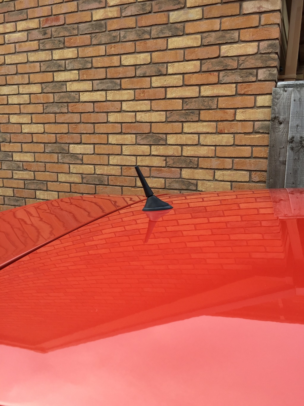

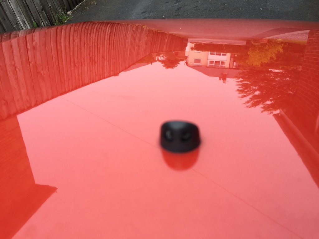

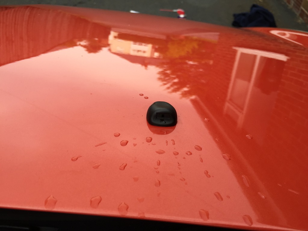

For the past month i have not been able to get the radio as someone decided the look of my aerial and basically took it without asking 😢. I decided to purchase a new stumpy C2 aerial as I did kind of miss the radio.

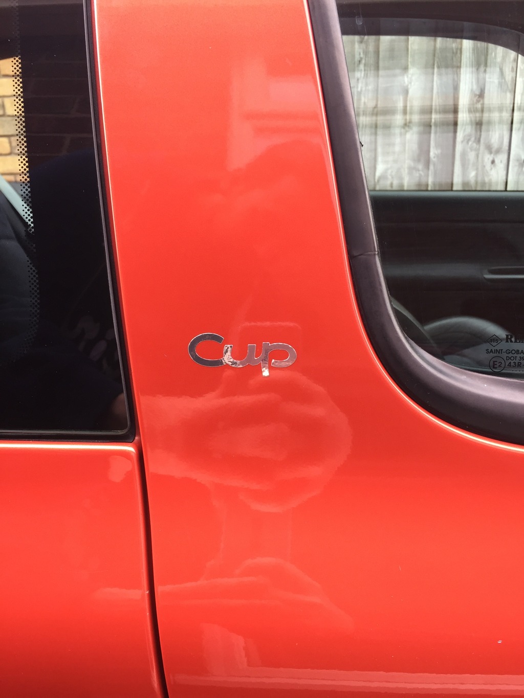

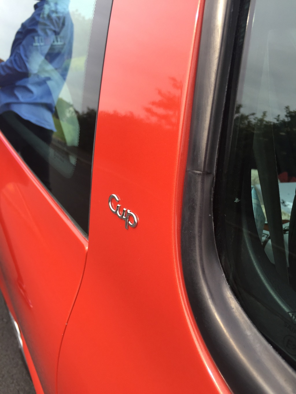

The final alteration of the day was replacing the cup stickers on the side of the doors with genuine cup badges.
BEFORE
AFTER
I know this isn't a huge change but I do prefer the badges over the stickers :up:

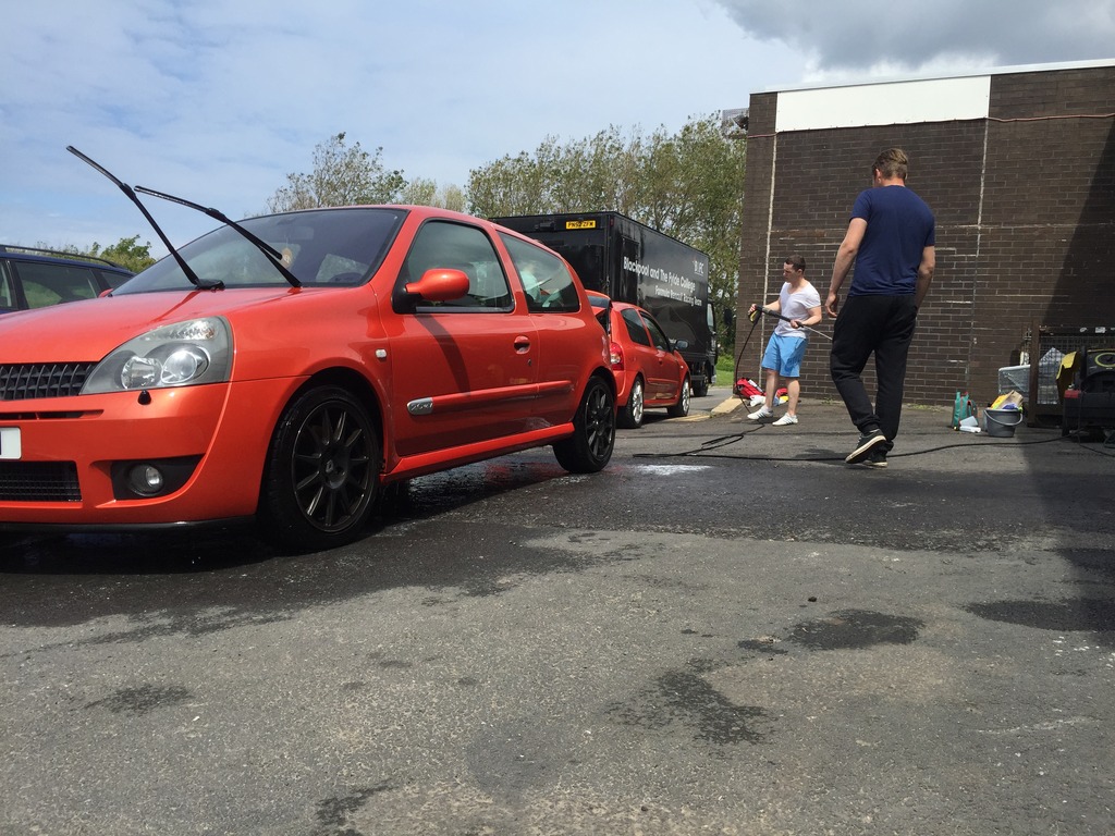

Now everything was completed I decided that the motor deserved a bit of TLC since I haven't really washed it in a while.

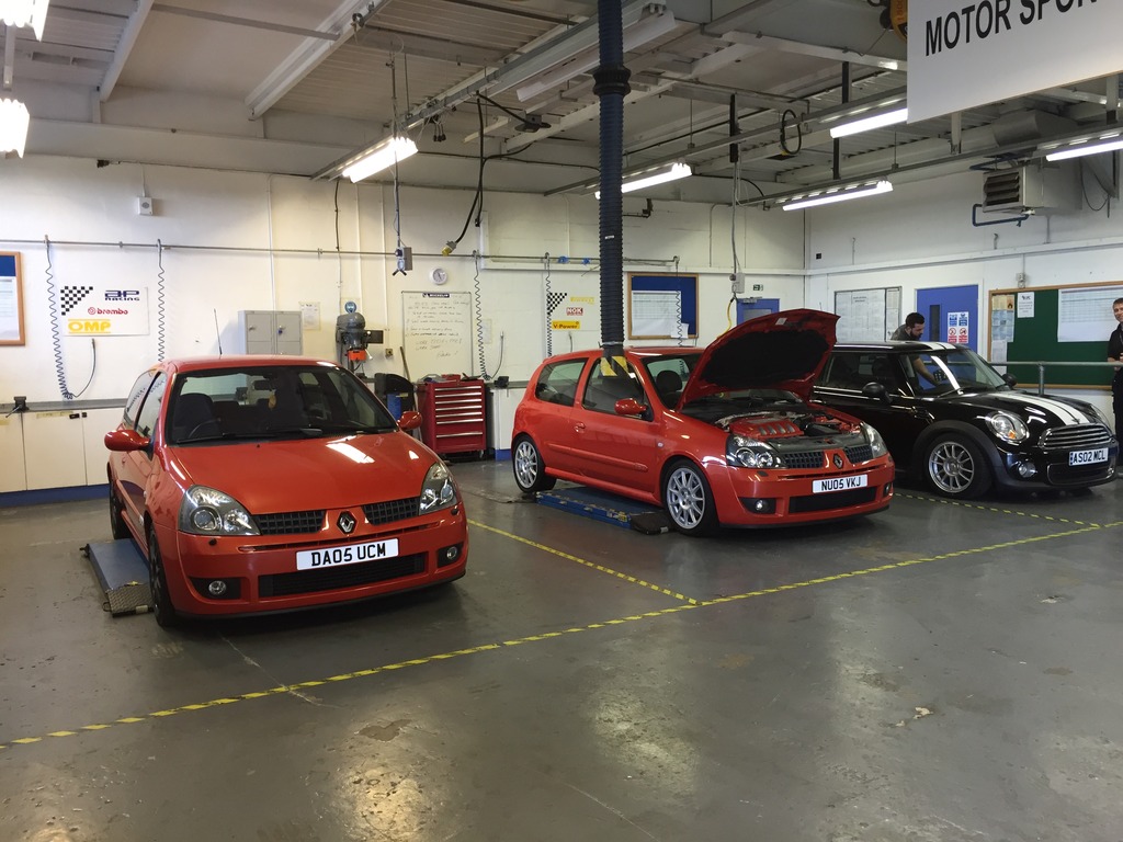

Mine and @Stonzy car showing up the mini obviously :P

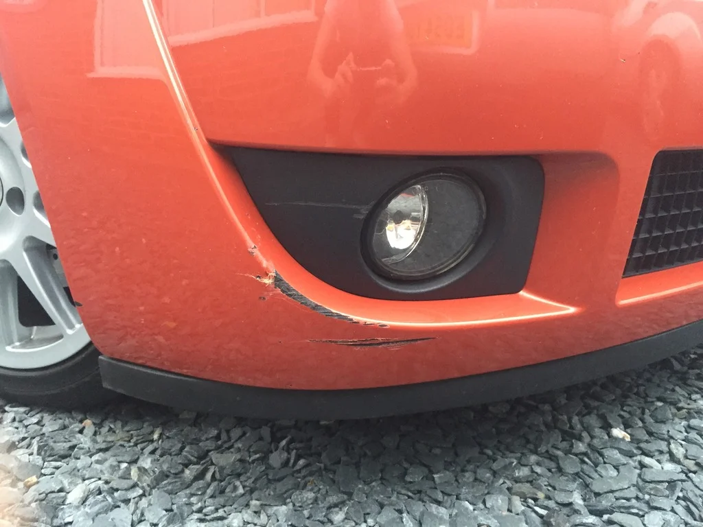

After all these positives can never happen without something s**t happening. In my case some invalid decided to drive into my car and basically engrave my front bumper. I'm really contemplating just buying a second hand bumper as it'll probably cost the same as getting it smoothed and sprayed, however there is a limited amount of front inferno orange bumpers up for sale at the moment . :down::sweat:
If people cant drive or park properly then it leaves me to do things like this :grimacing:

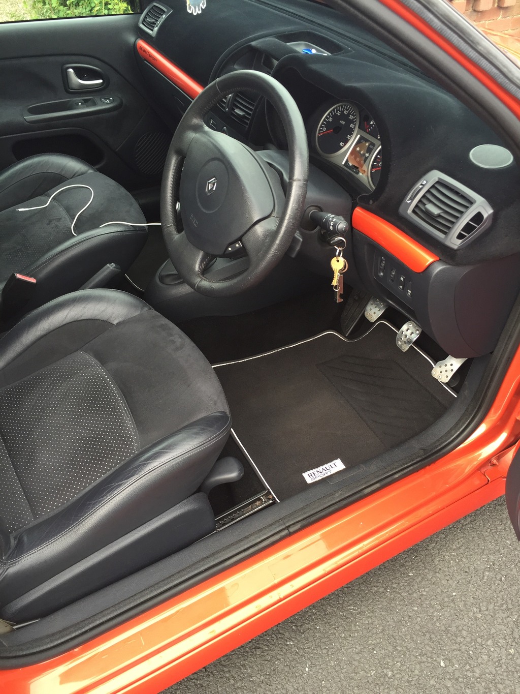

The most recent edition are genuine Renault Sport mats thanks to @cwt :smile:
