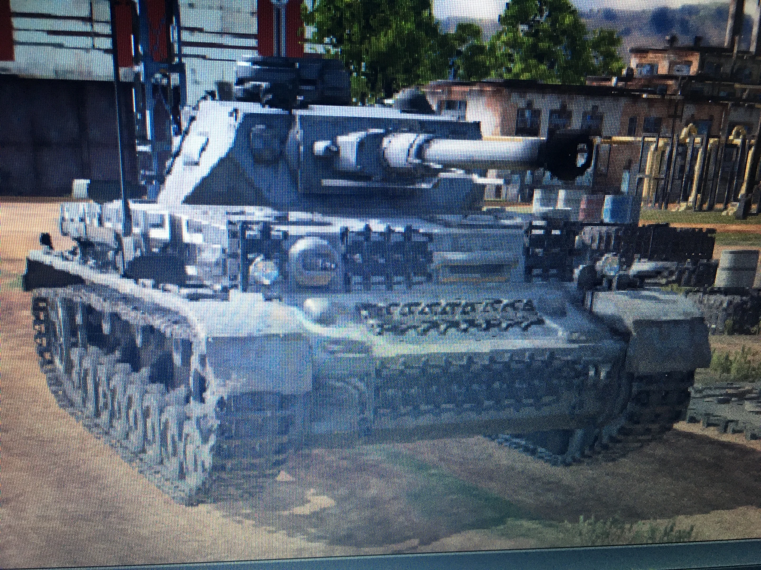

I have been playing War Thunder for a while now,but now the graphics have dropped res!.i have done no changes to my laptop & have done a routine update & with the game.
The in game menus look all fine as normal but then gameplay & background graphics are rubbish now,they have gone all block like.

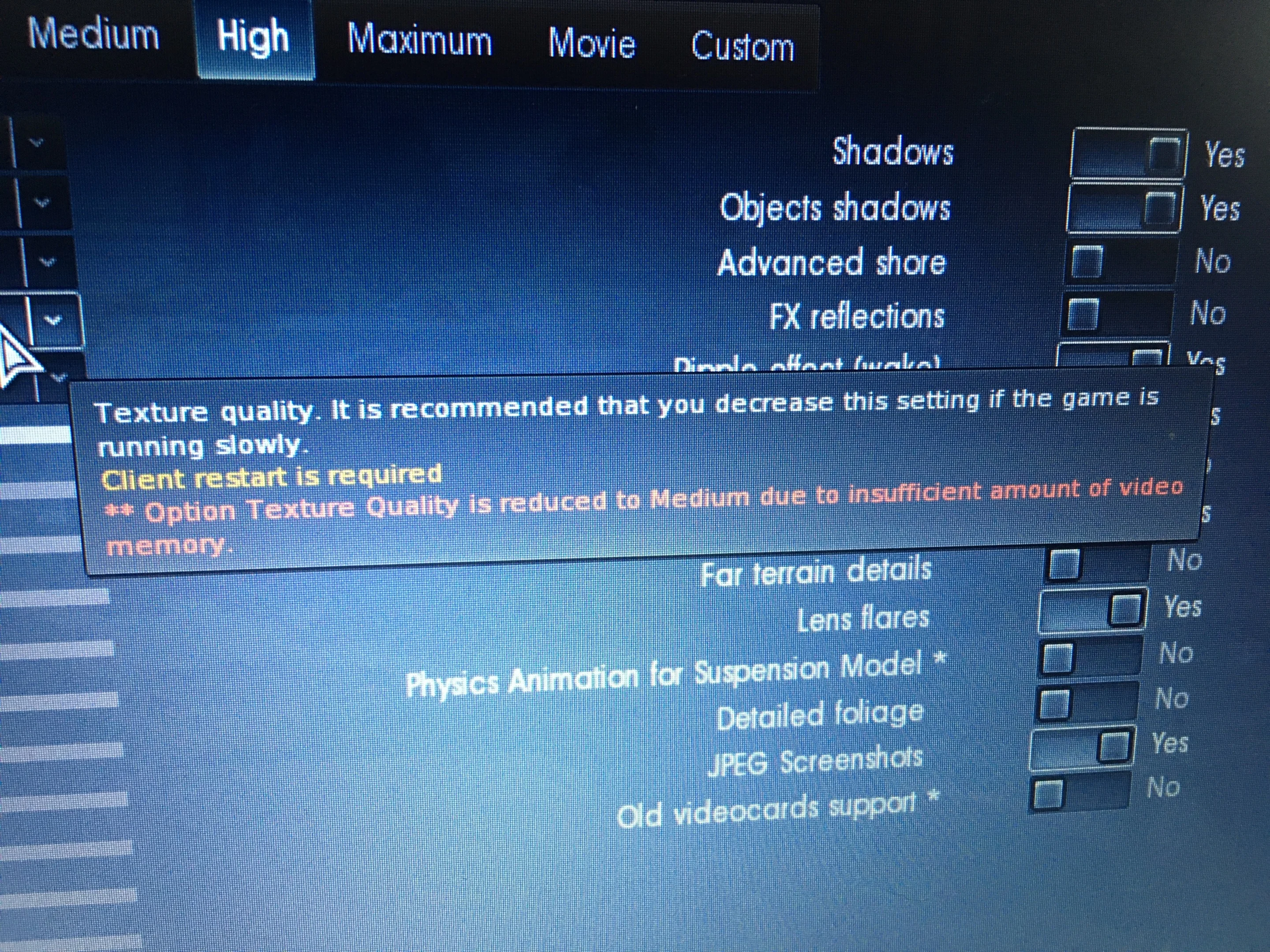

It does come up with this tho with the texture quality..

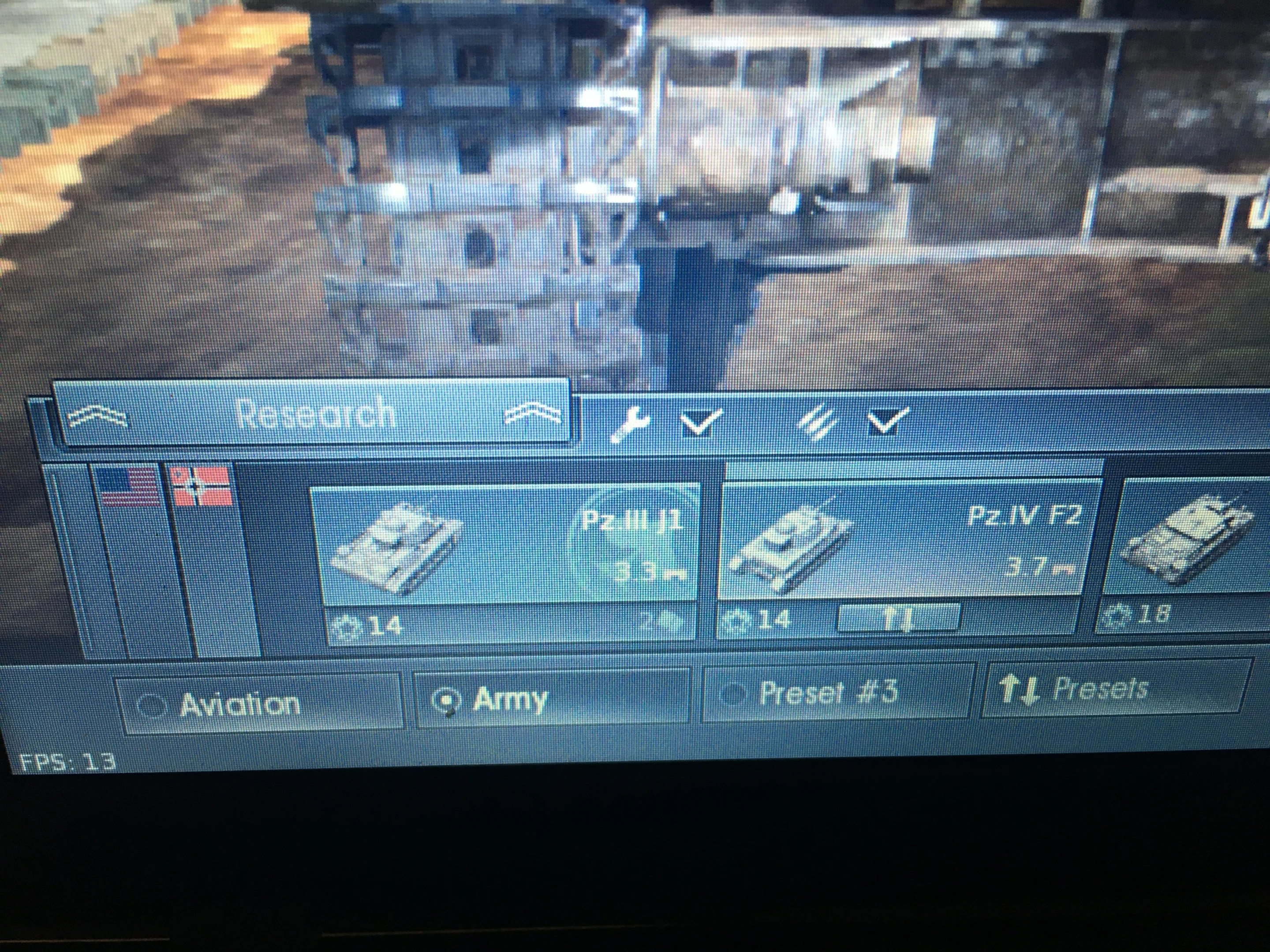

Here are some more photos of what i mean,sorry for the quality as taken with my phone.
Thanks
Has the resolution actually dropped?! Or are the texture simply looking blockier? If the texture quality / resolution has dropped due to the lack of video memory then it may well look blockier. What laptop and graphics card are you using?

Did you have the texture quality warning before or has this started recently along with the problems? I'm wondering if a recent update has 'upgraded' the game graphics and just raised the requirements a touch higher than your system can handle (or could previously handle). As Daz says, it very much suggests a recent update has caused this but it's hard to say what exactly.

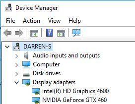

Are you familiar with the Display Adapters screen within Control Panel? If you expand the menu like on my work PC below, you can see that there's two graphics adapters:-
There's a chance that after the recent War Thunder update that the game has defaulted to the Intel CPU graphics and is ignoring the more powerful, dedicated card. In that instance, usually there's an option within the Graphics/Video settings of the game that shows the Primary Adapter or 'GFX card in Use' - something like that. If you have more than one option, there's usually a drop-down list to choose from.
Like I said initially, it's a long shot - but certainly worth looking into. I've had that happen to me in the past - but it could be that the developers of War Thunder have simply upped the requirements and hardware demands in the recent patch, as @SharkyUK mentioned earlier?
This is what I was getting at above
