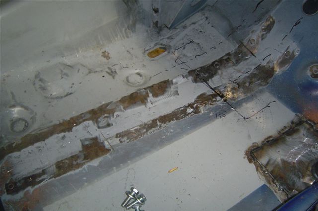

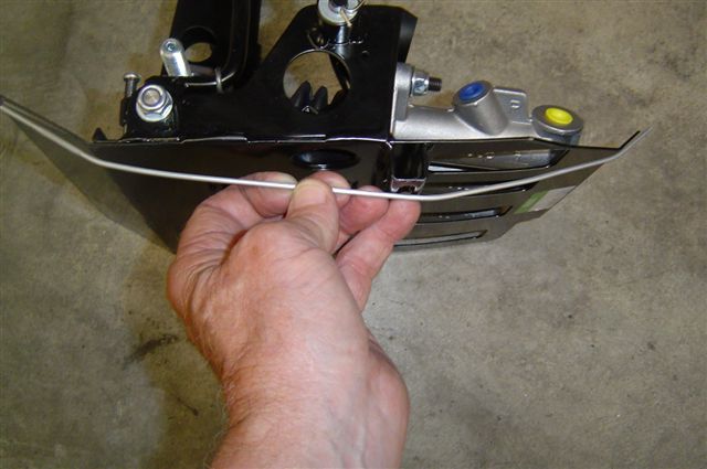

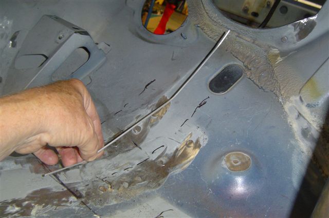

"On arrival, inspection showed it to be bent, it was missing hardware and quite frankly never looked like going to fit this car.
There were no instructions to fit a Clio, I believe there are for other models but not clio. Then I have an email from OBP stating that this is a universal unit ie it fits several cars ( but not particularly Clio )
It was clear firstly that the floor brace ( a long reinforcement about 13mm high had to be unstitched from the floor of the car....refer photograph # 2 that I had sent some time ago and Photo # 1 of this attachment

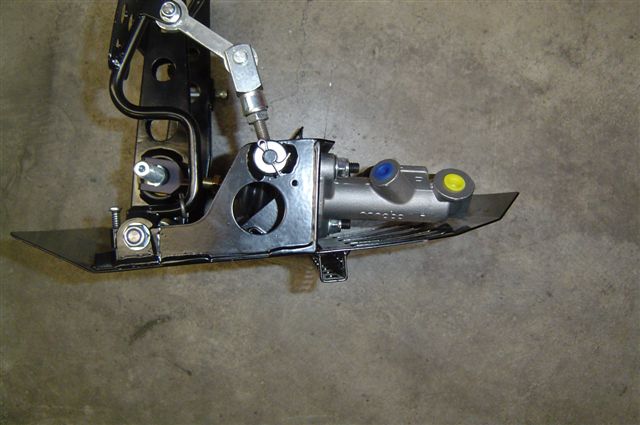

So after reshaping the pedal box frame which incidentally is nothing like the Floor to Firewall shape of the car, we assembled the cylinders to try to gauge the shape a little better. Still no joy with that either.
If you refer photos 2, 3 and 4 of this attacment I have bent a template of required shape of the unit versus actual floor / firewall shape. Absolutely nothing like it but could be made to fit at extreme with many hours welding and fabricating.

I've loaded a couple of images for context.
