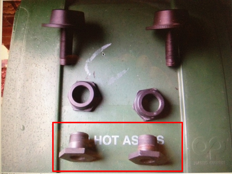

Sunday i purchased some H&R coilovers off another member, i received them today, to find the bolts that holts the rear spring adjusters are missing :dapprove:

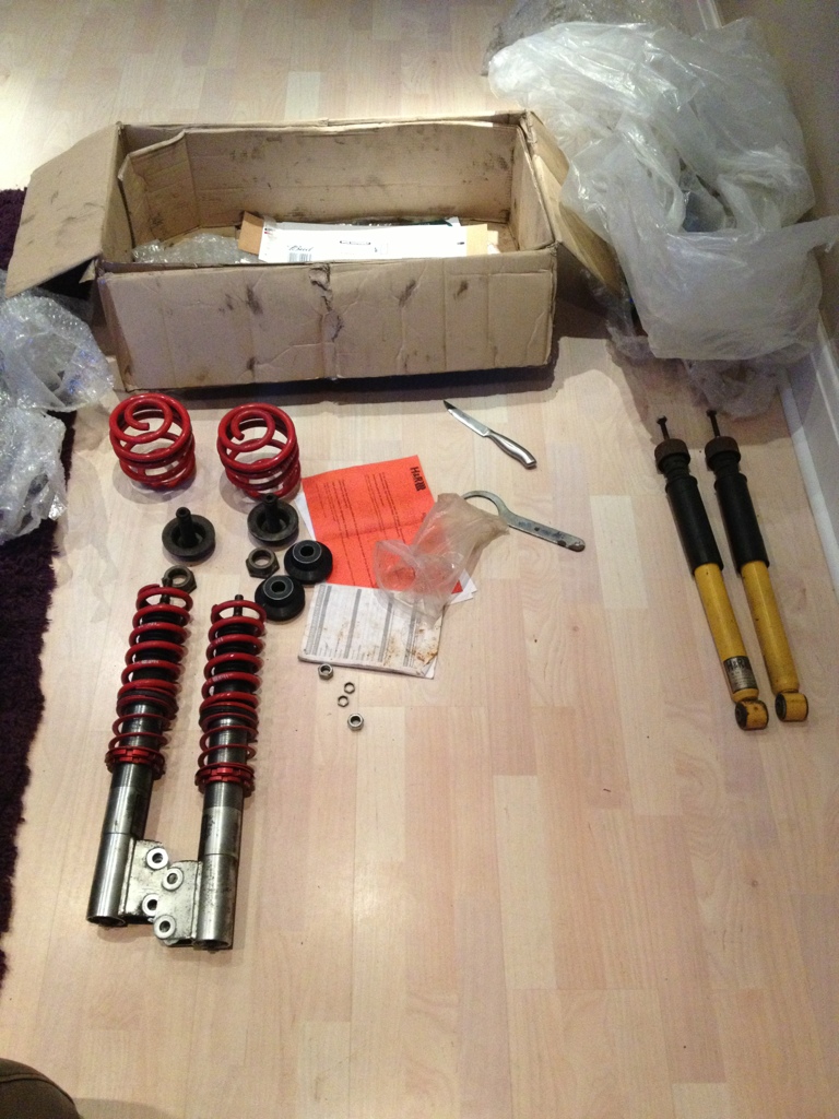

Can someone who has H&R's, or has had experience with H&R's please advise on what's missing. This is what i got:
The problem is, i don't know what i need for the top of the front coilovers, i know i'm missing the bits for the rears, the seller said if i can locate the parts he will refund me, where would be best as H&R are in Germany would there suppliers such as K-Tech or Kam racing be able to help?

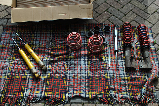

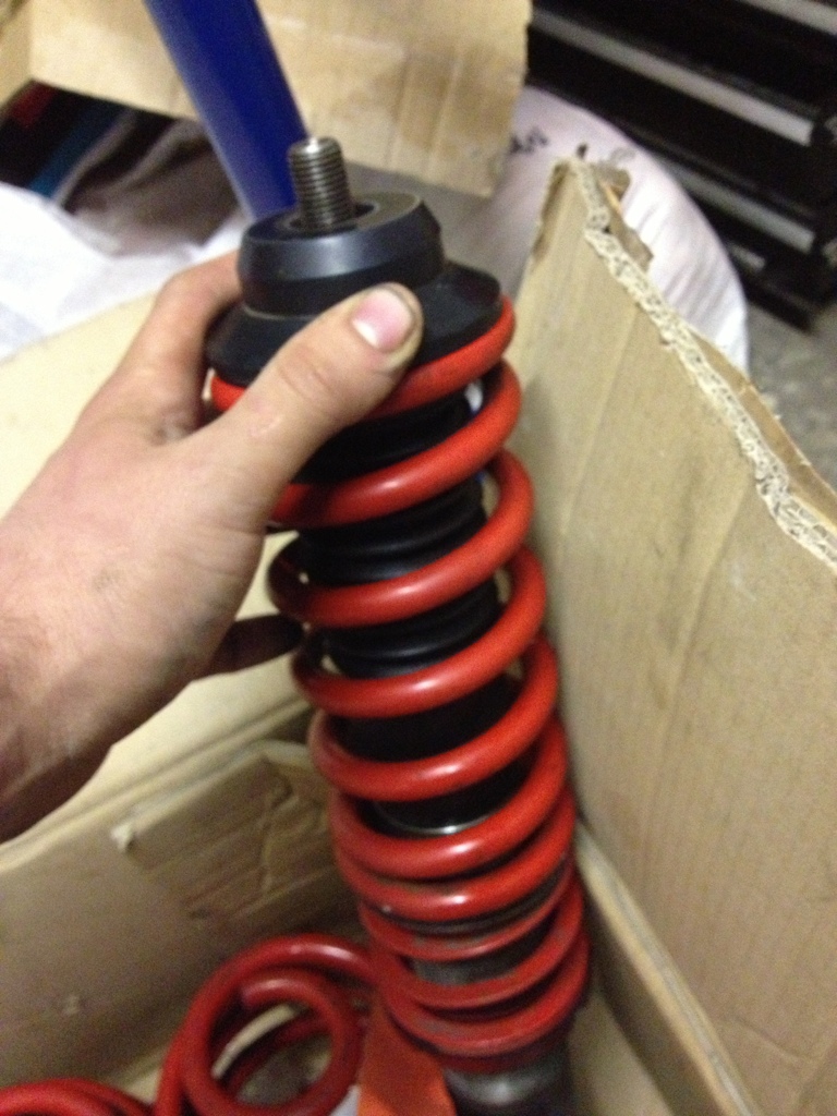

The top cap is there for the front shocks (the part that sits on the inside of the spring and then the bearing on top) you basically just plonk your old top mount and bearing ontop of that cap, and then fit as per norm. Remove the one thats on them at the mo though, they look like theyre off some other top mounts?
however the rears are missing part of the adjuster, theres another threaded collar missing (should be 3 bits in total all threaded) they will fit on, but will be fixed at the rear and if i say myself far too low tbh.
Should be 2 spanners too, one for the lock ring and the other for the spring seat, Ones bigger than the other.

So is this front right? Then my top mount just goes on top:

Yep, those bits squared above are the bits missing.
