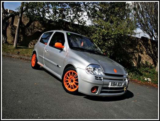

Ph-Orange Track car
maynard
  ph2 172 track car

Saw the car at combe looked good!
How'd it go?
Although think I need to change wheel colour too many orange now :eek:
Ben
Looks wicked although from the ph-orange I expected the whole car to be orange ;)

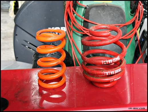

This pretty much sums it up. Very soft and alot of bodyroll, and the back end seemed very skittish, not sure if thats due to having no weight in the back but it just didn't feel right?!
I'll be replacing the rear springs with the AST's that came with mine, I've got a trackday at Llandow on the 3rd October so i'm hoping they'll make a difference. If not I'll be ditching the H&Rs and saving for some AST's

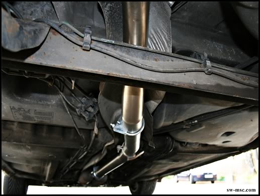

I took a nice 3hr drive to K-Tec to have the following fitted
*Cambelt and Aux belt change
*Matched inlet's fitted

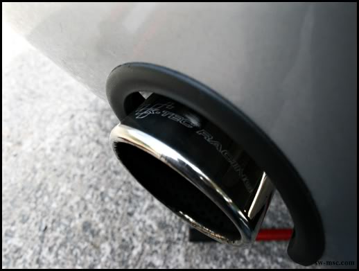

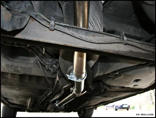

*2.5inch recessed exhaust
*Catcam 428 camshafts
*Remap

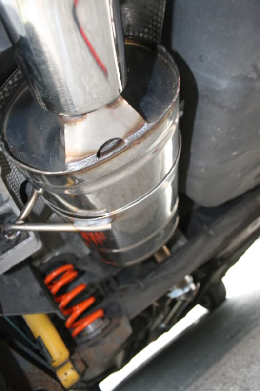

Also While I was up there I had a new throttlebody fitted to fix my idling problem.
Hell of a difference after having all this fitted, I have all ready managed to embarrass a few bigger more powerful cars!
Also fitted the rear AST springs that came with my car.
Few Pics
AST Vs H&R
New Exhaust and Tailpipe
Alot happier with the AST's on the rear the car feels alot steadier now.

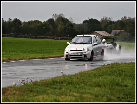

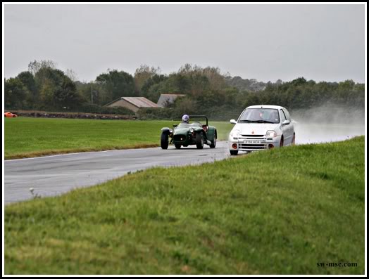

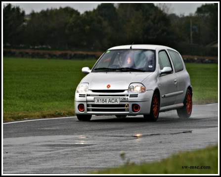

Right attended my last track day of the year at Llandow, last weekend.
Had an awesome 2 sessions and was really looking forward to the afternoon sessions, but due to some c**k pissing oil everywhere the track was closed and the fact it was pissing down most of the day didn't help either.
Here's some picture's if you haven't already seen them.

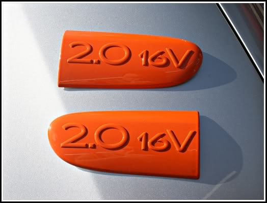

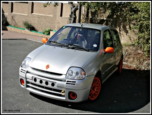

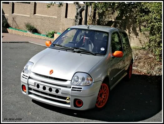

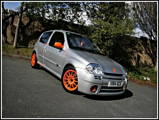

So I whipped off the front bumper, wing mirror caps, Side strips and badges and had them all painted.
Everything came back last night and everything is perfect, except for the sidestrips which were painted orange instead of silver. Not to worry though I should be having them back monday. Also got a orange "Castle Combe" sticker made up!
Few Pic's
As you can see in the first picture I've had some holes cut out of the bumper for when Ifinally buy and fit an oil cooler.

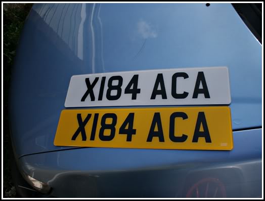

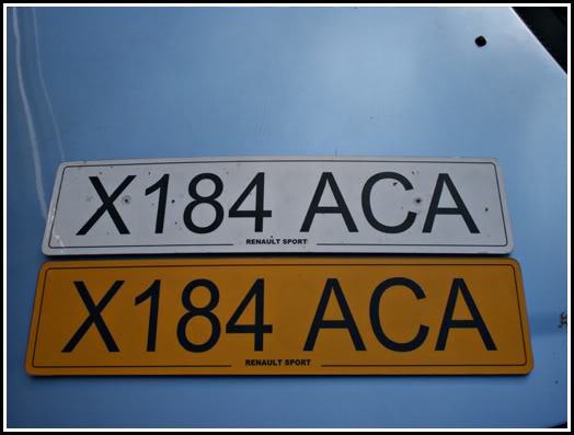

Also decided to buy new plates as the currents are disgusting and chavtastic, they came with the car BTW.
Old Vs New Plates
And Fitted
Much Better! :)

What do you think of the car with those springs on? did you notice the difference?
Like chalk and cheese.
I was really dissapointed at Castle Combe the car was really sloppy going though corners plus I had 28psi in the rear tyres. There is now 26psi not sure how much of a difference 2psi makes but this and the AST's have made it 100% better.
The car drove very well at Llandow and even though it was very wet I managed to Lap a Corrado VR6 and virually overtake everything on track!!
But like I said it was very wet so most were babying it round the track. :evil:

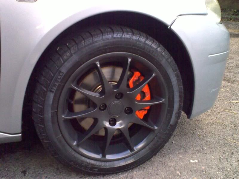

How about calipers??
Did think about this, not sure ATM may just paint them black. I've got a brand new rear calliper that i'm going to be fitting when I order some discs and pads, so will prob paint them then.

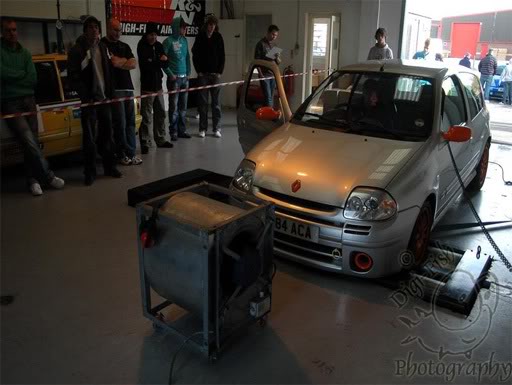

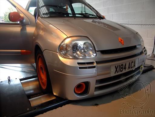

Had the car RR'D at GotBoost on Sunday and pulled 183BHP
Very happy with this, the car has the following mods
*Matched Inlets
*CatCams 428's
*K-Tec Exhaust
*Remap
The car still has a cat on and a s**tty pipercross filter so with these gone and a decent map I'm hoping I can hit my Target of 190BHP
Some Pics
Comments Welcome
:D

i just love this car. i know i've said it before but the orange suits it so well!
nice figure on the rollers too :)
