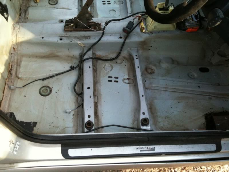

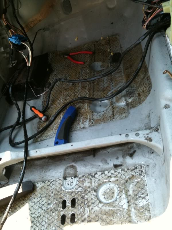

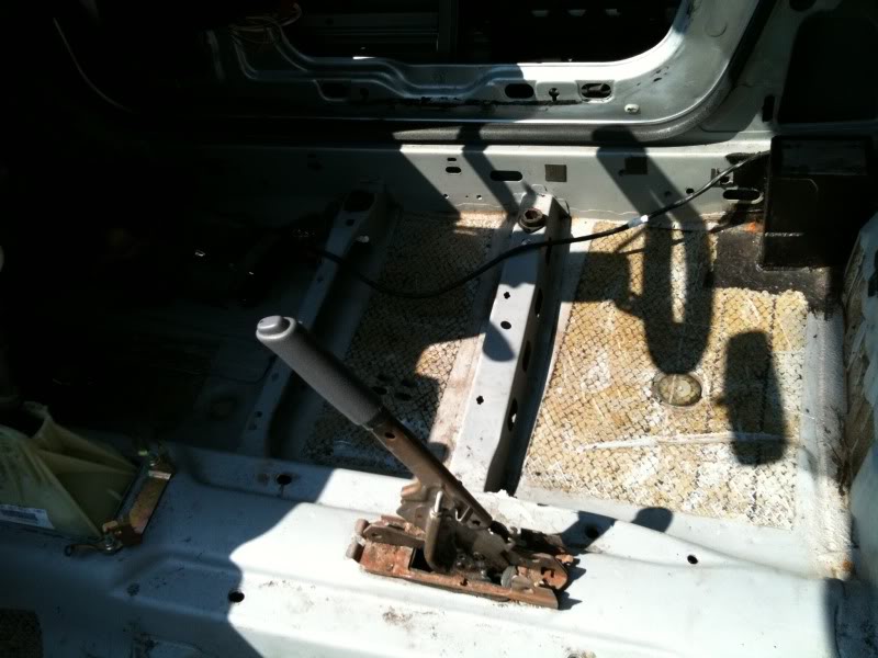

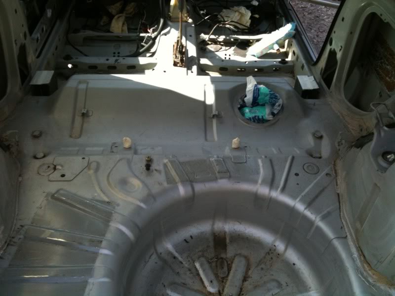

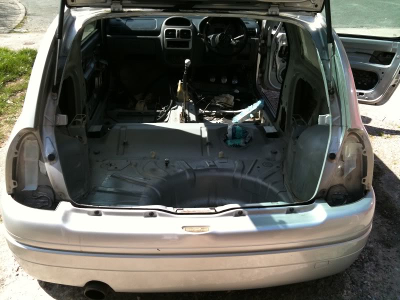

Well all the sound deadning is out!!
I had planned to scrub all the excess glue out today, but couldn't be arsed if I'm honest.
Pic's

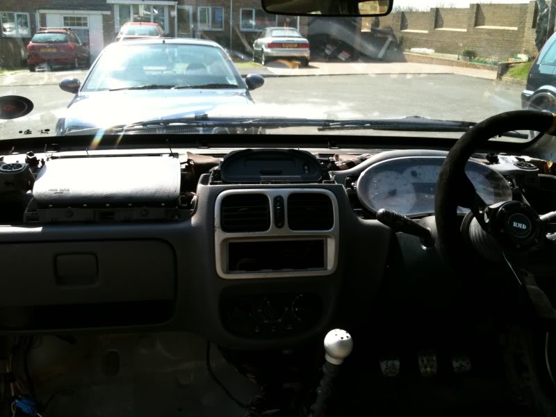

Also removed the dash top to get at some wires, and some more sound deadning

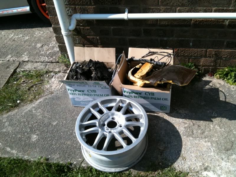

This is what I've managed to remove in the past few days!! (wheel used for size indication)
Hopefully I'll scrub the glue tomorrow and then start prepping for paint Friday.
Comments welcome.

How much does the stuff removed weigh?
Not weighed it yet but the box on the left is very heavy, at a guess around 10-15kgs the other box is probably around 4-5KGs
I've removed anything and everything that I dont need. E.G Rear wiper wire's, rear washer pipe, most of the brackets for the rear seats and the ariel wiring.
Looking to get rid of the cd player loom soon, along with the speaker wire's. :)

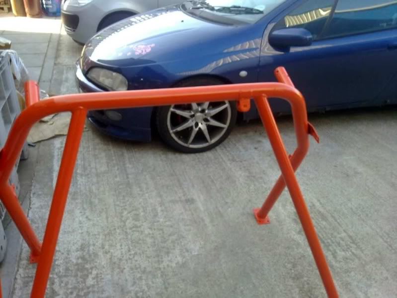

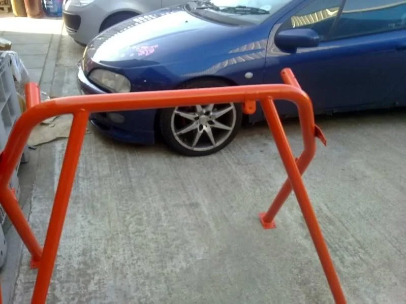

Just had this photo sent to me by a friend who is sorting out the Powder coating for me.
Excited isn't the word!!

Why not? Orange FTW!!!
I can say I started the Orange cage trend on cs then!!
That'll give me legendry status! ;)

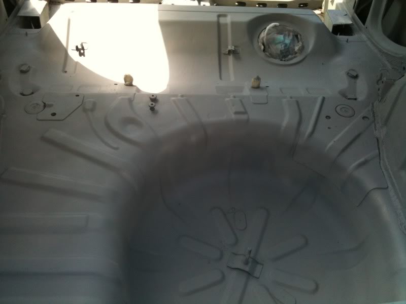

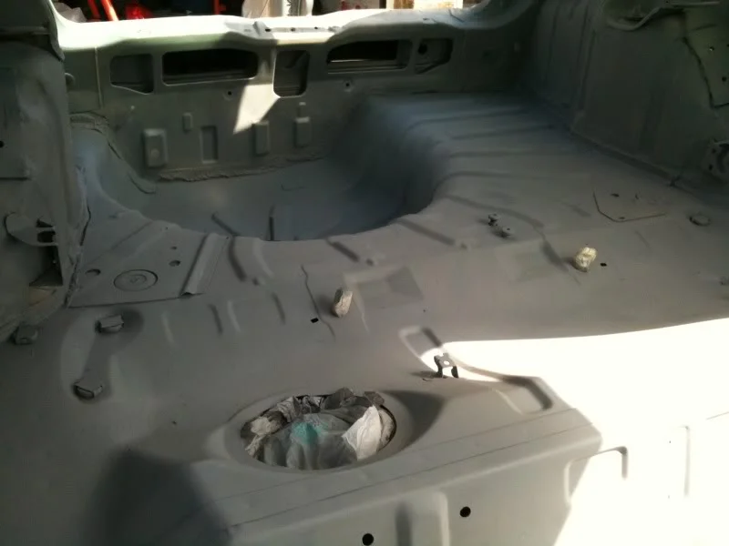

Update!

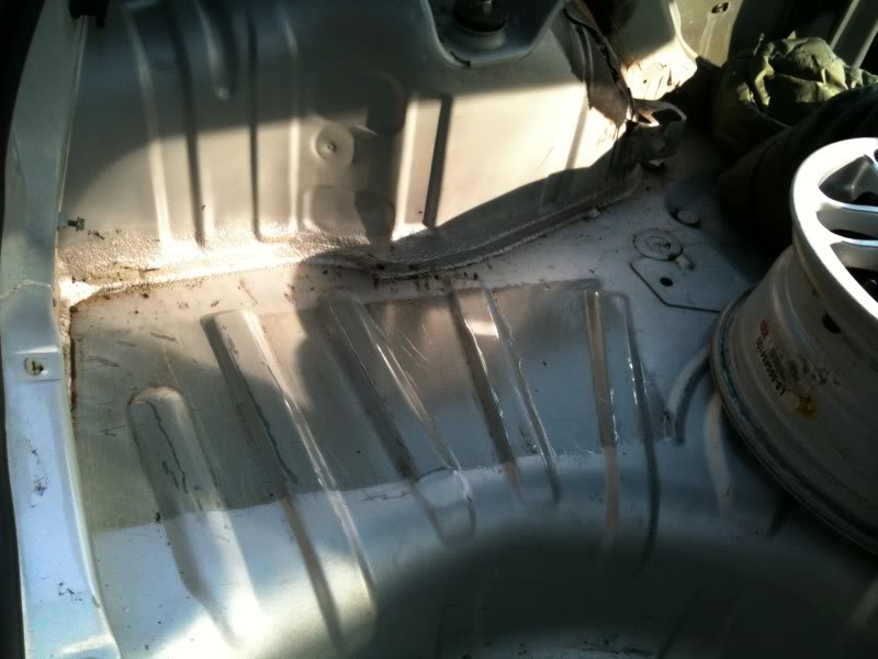

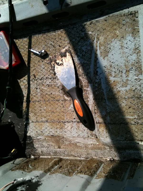

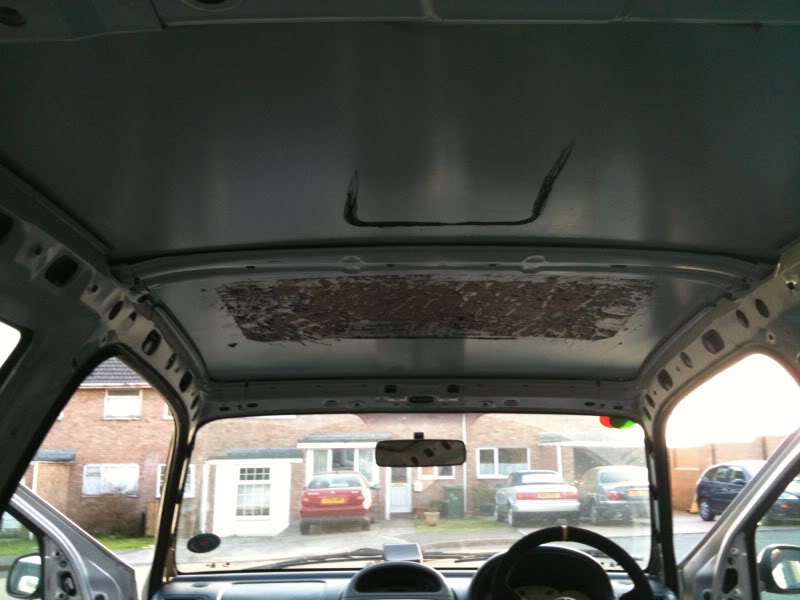

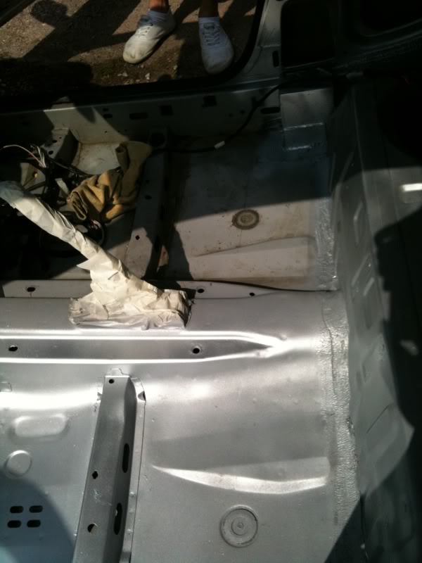

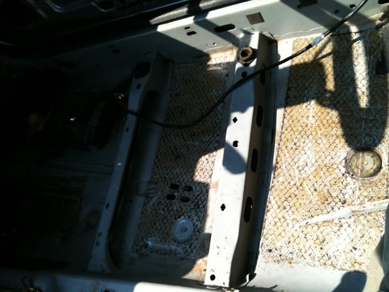

Got started on the glue left by the sound deadning today.
After all the suggestions on here I used thinners, came off a treat! Alot easier than I thought it was going to be.
Some pics
Then I decided to get on with the big patch on the roof, took me about 30mins and I'm prob 1/4 though it! will finish it tomorrow. :)
Also bought myself a little present with Combe next week.
Hopefully will start painting tomorrow!

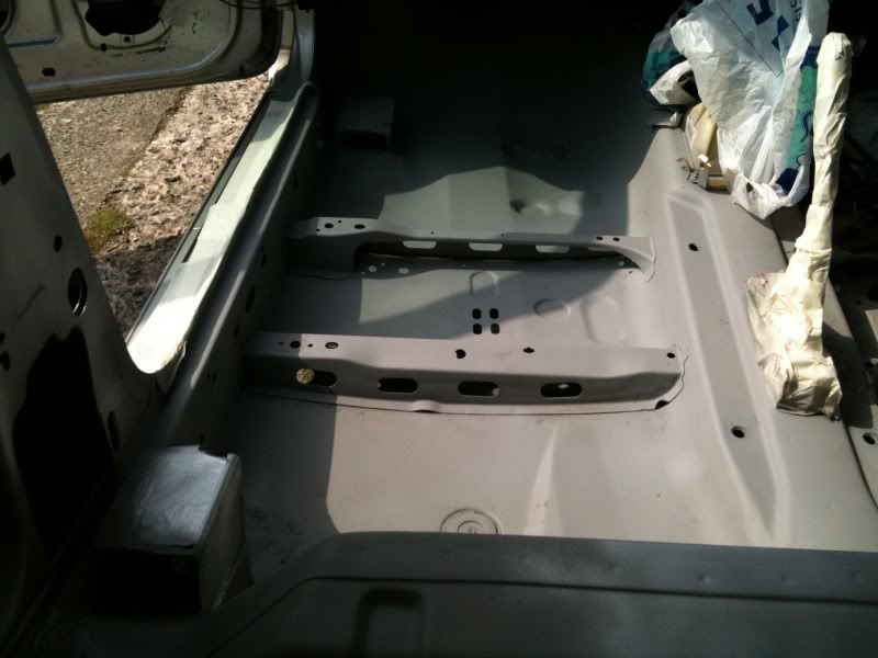

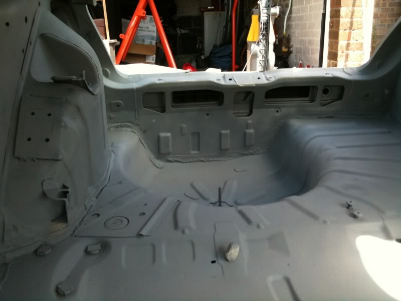

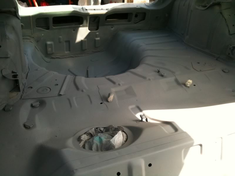

Painted!!, well the rear half of the car.
Will sort the front out in a few days.
Anyway I'm quite happy with the finish, not perfect but it'll do.
Pics

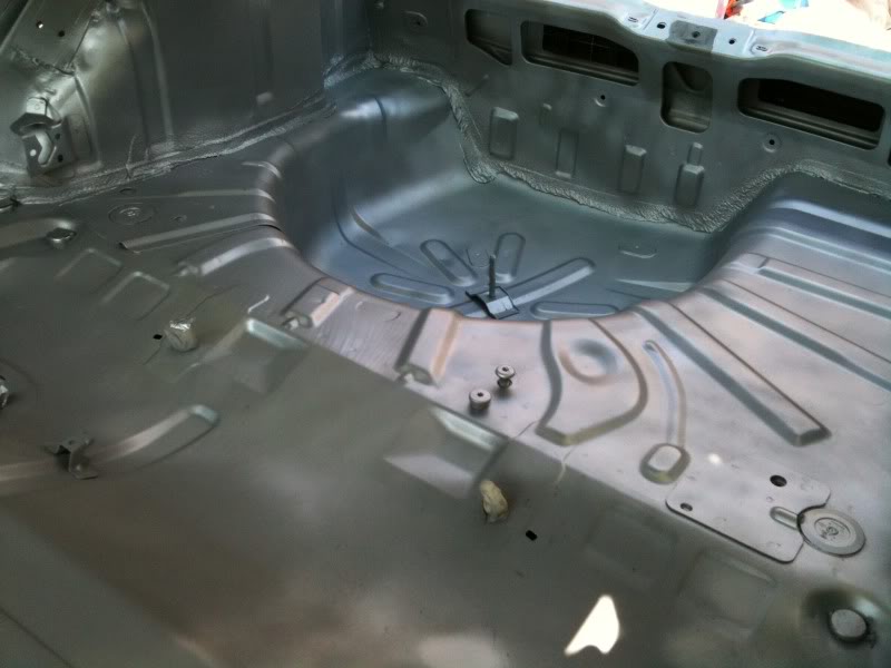

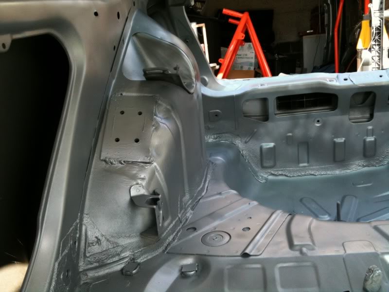

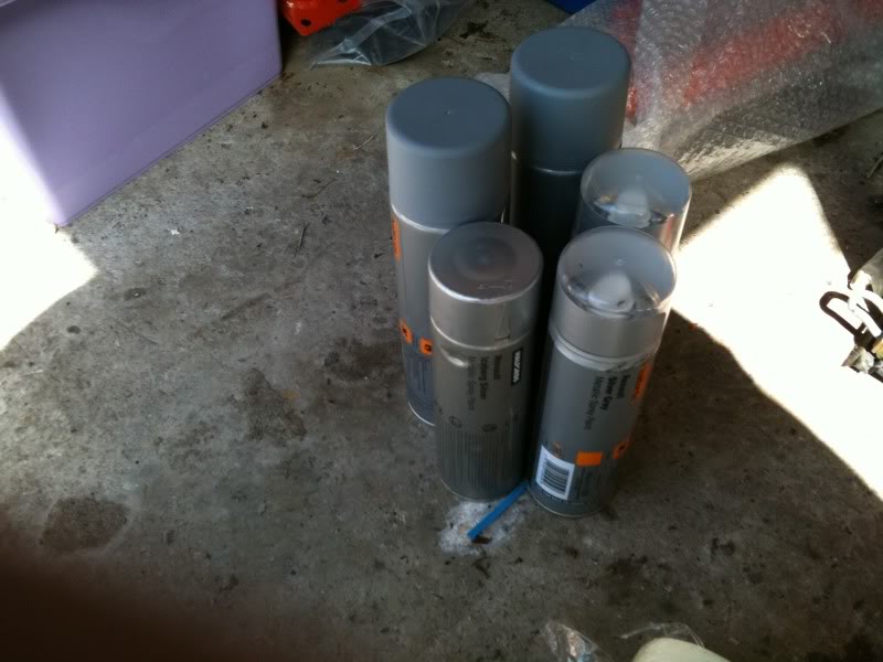

Prepping
Tools (didn't last long at all!!)
Base coat
Top coat
Like I said it's not the best job, but the rear is all one colour and looks a hell of a lot better than the mess it was!
Comments welcome. :)

very nice looks much better, i need to do this to mine soon and am going to use same method you have with a couple of rattle cans, did u mask any of the out side up in case of overspray or was it ok ?? - did you just spray it up out side??
doesnt look that bad for cans either mate
  RenaultSport 172
I masked up the windows, removed all the door seals, removed all the wiring from the back and thats pretty much it!
Don't get me wrong I'm not going to win awards for the paint job, but it's a track car..
It just helps clean it up a bit. :)

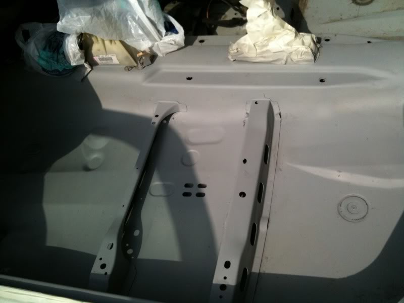

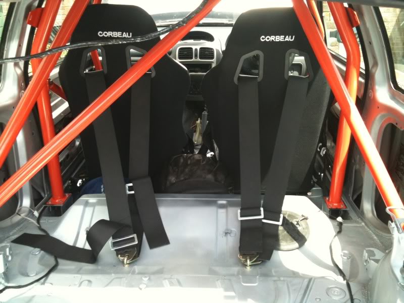

Opps Havent updated this for a while..
Managed to get the Front half of the interior painted before the action day at Combe and also managed to get my cage in.

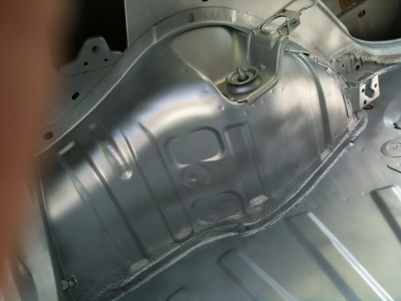

Front Floor in primer
50/50
Pic of the cage and everything back in the car.

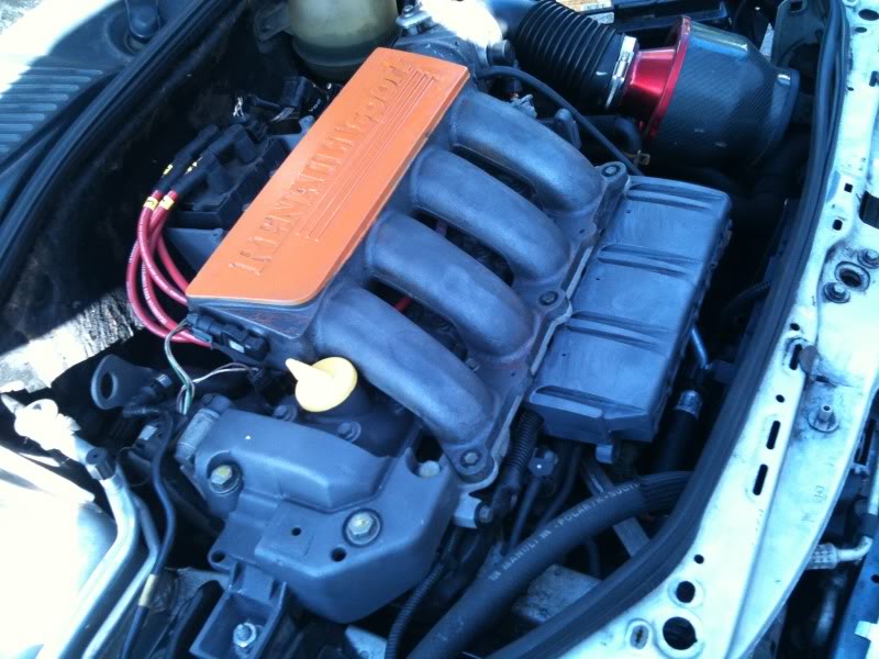

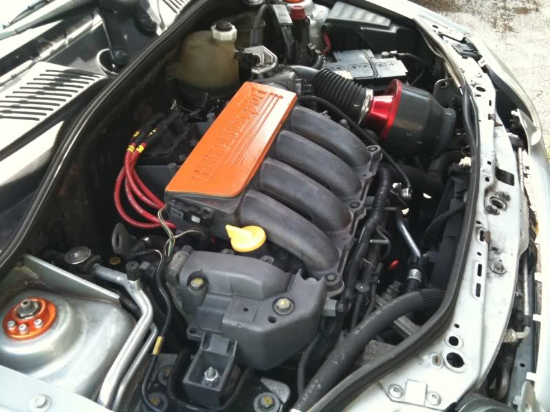

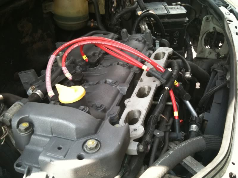

Then after seeing Gray's thread about him painting his Cam cover and inlet manifold I decided to give it a bash too.

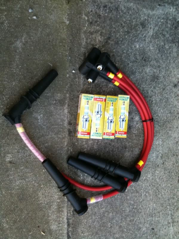

Whilst the inlet was off I thought I'd change the spark plugs and the Ignition leads.
I decided on the KTR Iridium spark plugs and the Magnecor red 8.5mm ignition leads.

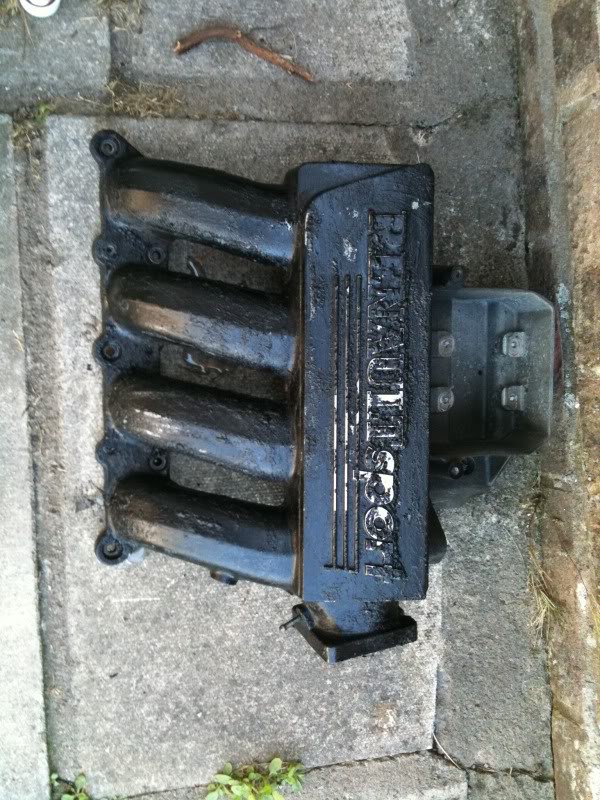

Just to give you an idea, this is what the inlet looked like before.
This is it with Nitromoors painted over it to remove the paint

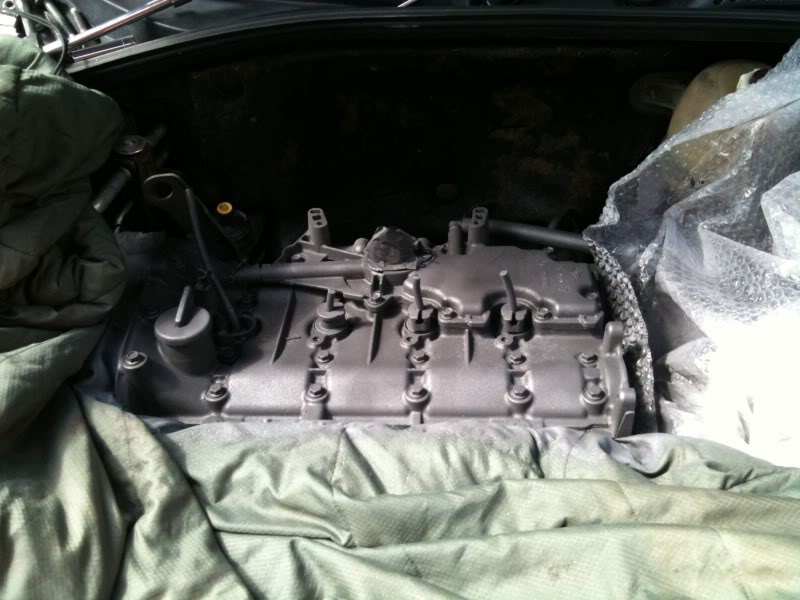

I then removed the engine mount and sprayed that separately to the cam cover.
My rigged up spray booth

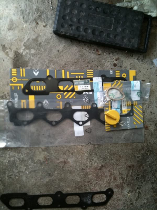

With the inlet removed and being painted I decided to get all new gaskets and even bought a new oil cap.
Painted engine mount fitted with new oil cap
And here's the inlet fitted and painted too
The fuel rail guard is in the Garage drying ATM pics will be up once its fitted.

Love the new engine colour. I want to do the same to my engine at some point :)
What paint did you use for the engine?
  RenaultSport 172
I just used the VHT Halfords paint - Metalic black. Looks more anthracite/Charcole which I prefer. :)

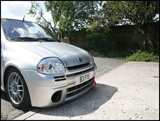

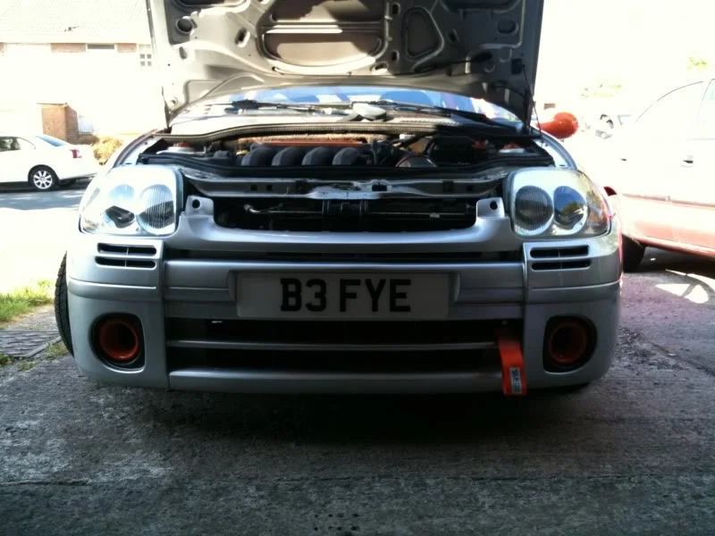

Small Update

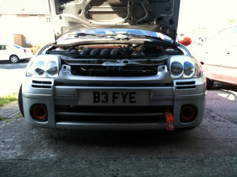

Fitted my fuel rail cover and my TRS tow strap that I've had for ages
Plans are to just enjoy the car for now, I'm sure a few updates will still come along but I'm looking into ITB's for the winter. :cool::evil:

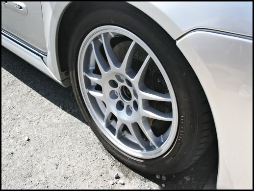

Anyway after swapping with Daniel the car looking rather odd with the mirrors,bullets,diamond and trumpets painted orange. So I set about with some rattle cans painted the mirrors silver, trumpets black and the bullets anthracite.
Now I'm not really sure why now but I'm now loving the car again!

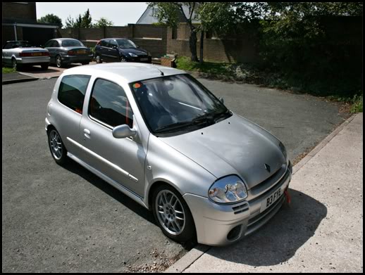

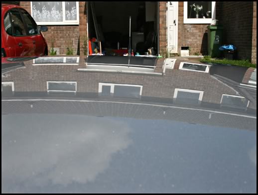

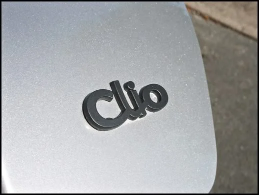

So today I gave it, it's first clay,polish,wax since buying her 18 months ago.
Pic's
Also swapped my orange track stickers for some anthracite ones (Looking to replace the Llandow one as it looks s**t next to the others)

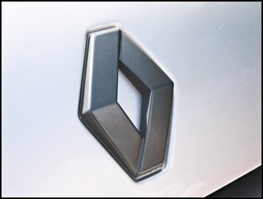

I've also bought some goodies for her that I'm waiting for..
Centre caps for the F1's
4 x Yoko Parada spec 2's (Hate the T1R's and they're also not the best on track)
Clear indicator bulbs

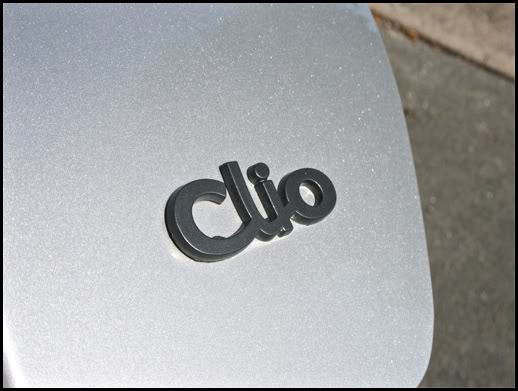

"New Style" Renault sport badge
