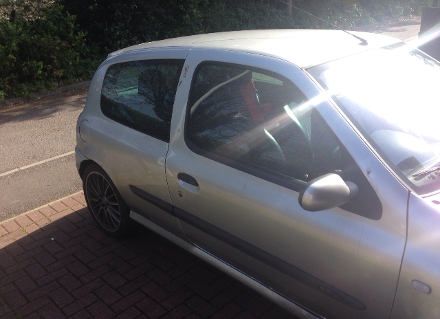

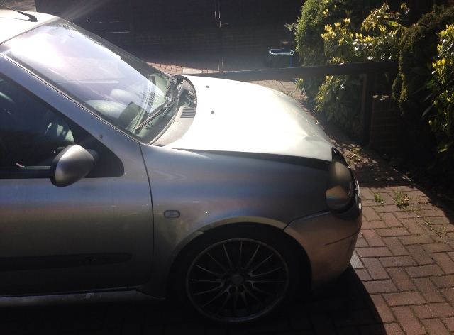

Browsing ebay knowing I didn’t really have much to spend but knowing I wanted a toy, I came across a light front ended Phase 1 172 for good money (or so I thought), 10 miles away with little mot and tax, a deal was done for Sub £350 minus the 17 inch wheels. I put a rather rushed deposit on it, sourced a set of wheels and a few days later brought it home. However, it wasn’t without its problems!

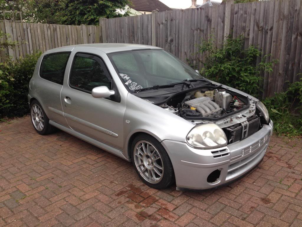

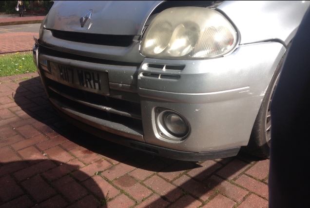

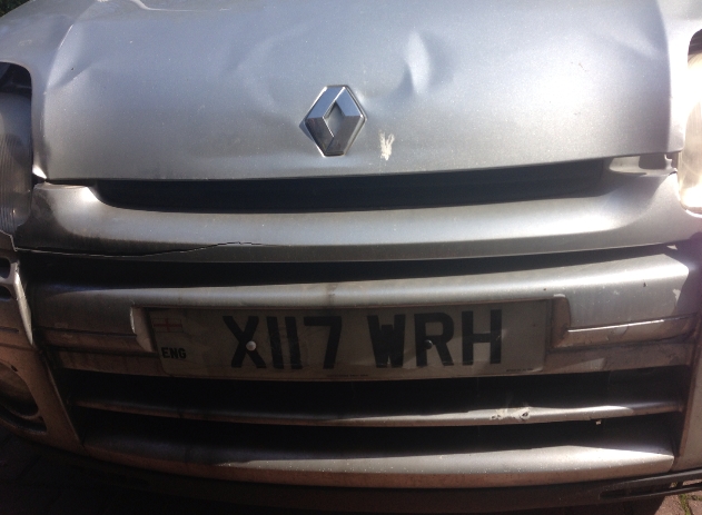

After about 5 hours of ownership I had stripped the front end down my findings where:
slam panel was very slightly bent and needed pulling straight
needed a bumper
both headlight brackets where damaged
wing was slightly damaged
it didn’t idle
the rear quarter once wiped clean revealed 2 different colours
I didn’t think I would be too bothered but HPI’d it and found out it was a previous Cat C previous to this little shunt.
This is as far as I got so had a cuppa tea and a chat with my understanding missus and decided that although my thoughts where to spend money over time and fix it up im really not that skint and putting money into this car will leave me with a Cat C car with no history, and by the time the belts and dephaser where done, it had some paint and parts, it would owe me over £1000.

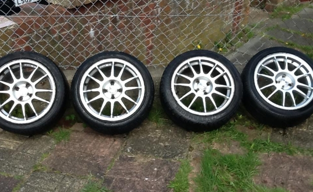

​The best thing about this week was the wheels I picked up for it – 16 inch super leggeras with tyres and centre caps, for a whopping £90, 2 mins from my house via facebook.

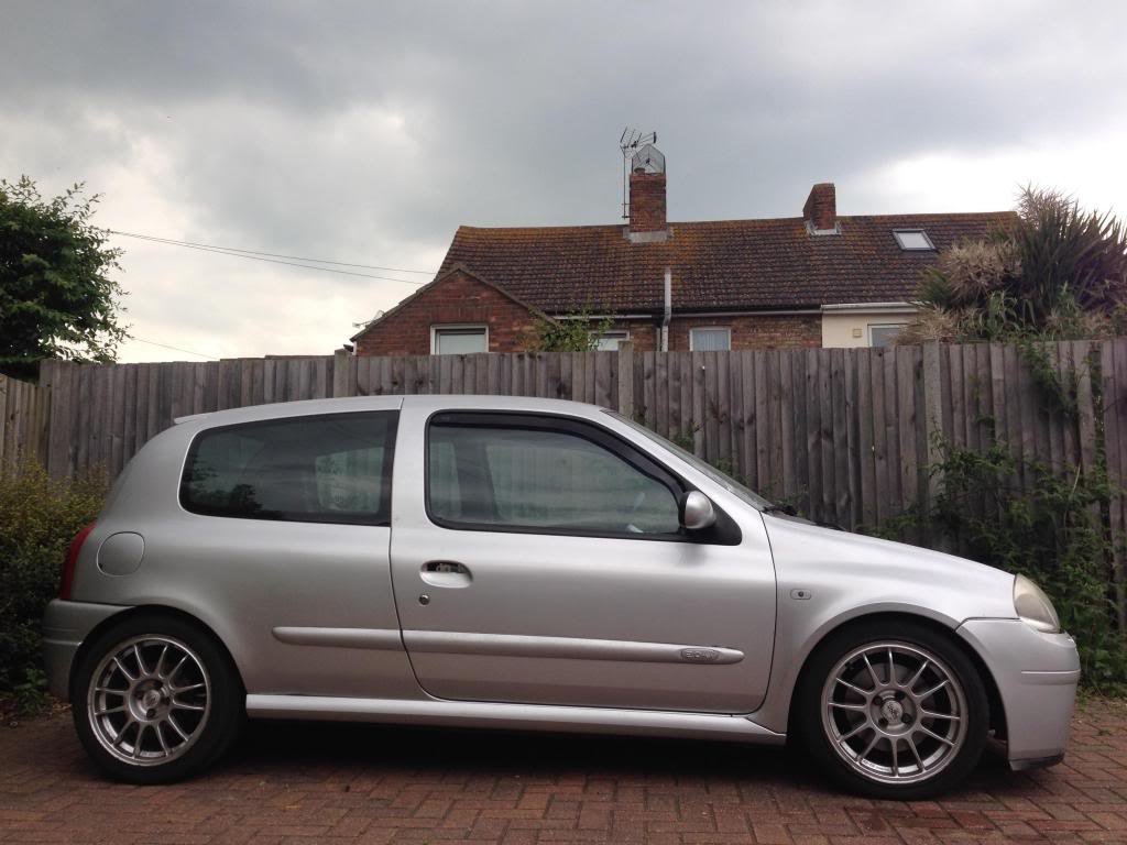

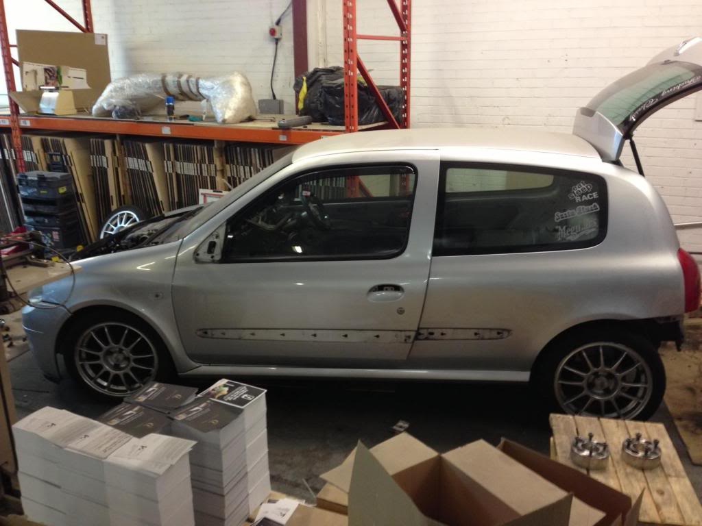

When I got up to Adams dads place I was greeted with all the bits as described, however it was a nut and bolt nightmare. There must have been 100+ nuts and bolts (not all clio) to sift through.
What needed doing was:
Front suspension incl wishbones and ARB bolting to the car
Rear dampers and springs fitting
Rear axle bolts fitting
After 5 hours I was done as far as I could, I found I needed rear damper nuts, Wishbone bush, front top mount top hats and a steering wheel. Then it could be put on 4 wheels and moved. I’ve not got it running, and I haven’t tried, but it only needed top inlet and coil fitting and it should go.
This is how it is today and im due to go back up there next Friday to finish the rest off.

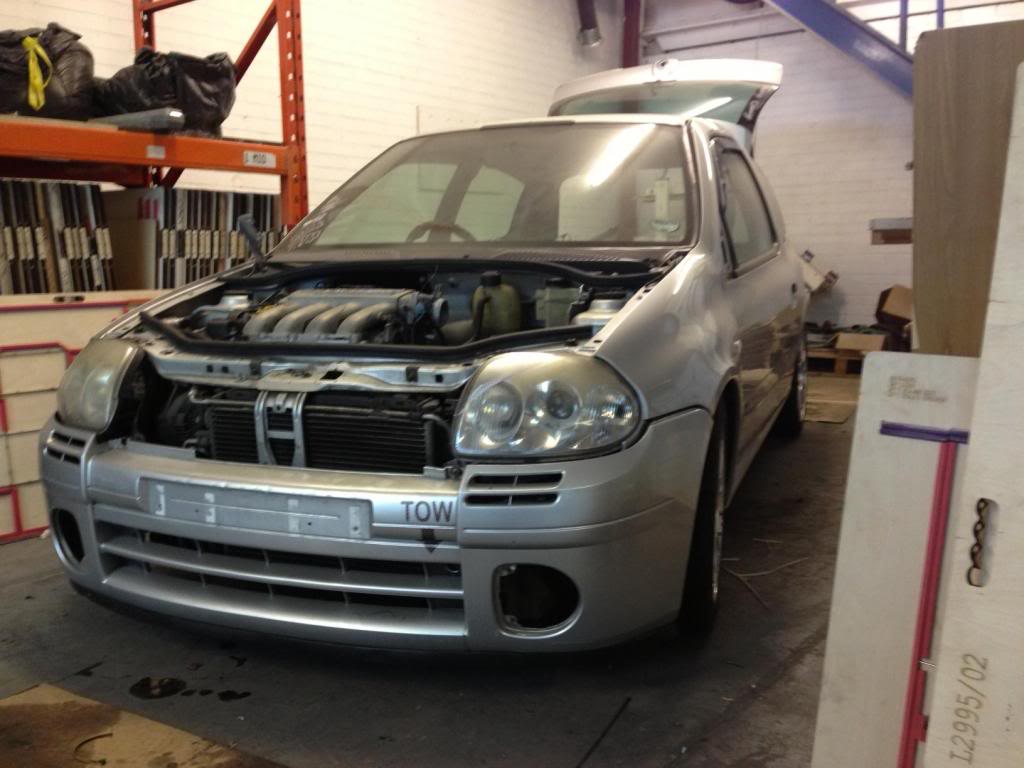

​Today I went to a scrap yard and picked up the following:
2 x phase 2 rear lights
the various nuts and bolts and top mount bits
and steering wheel and boss
I have an engine mount and 2 rear callipers on the way to me.
I spent another 2 hours on the car but didn’t really make great progress, just tidied up all the parts, fitted the engine mount and all that was left was fitting of the wishbone, which hadn’t turned up.

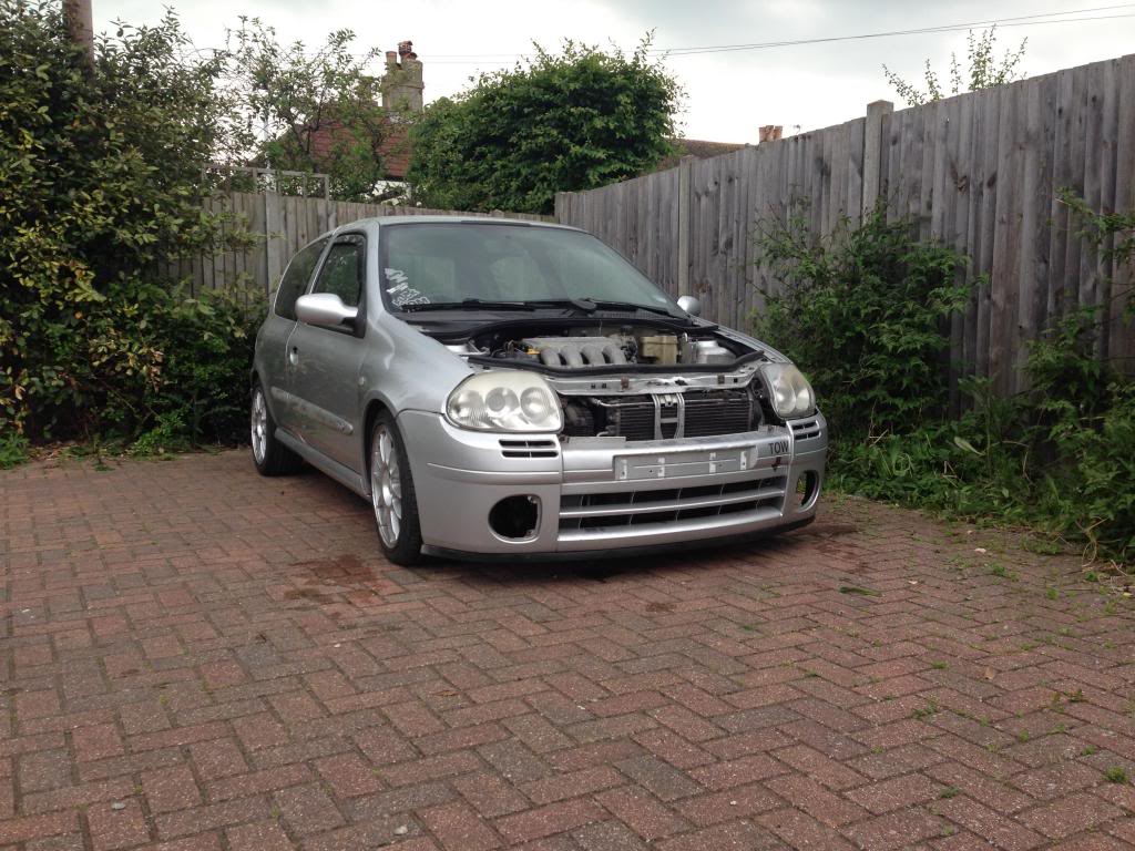

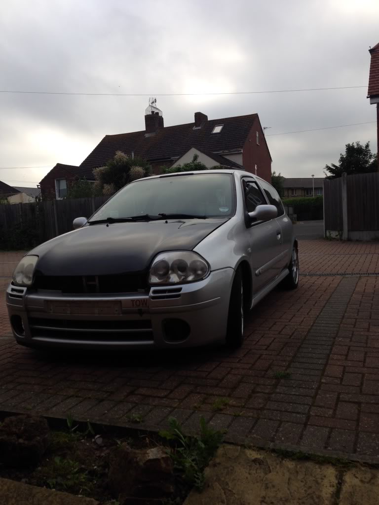

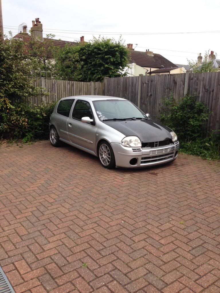

3 weeks has past and with my stag do to Ibiza in between I finally went up to Adams place, fitted the wishbone, loaded it onto a recovery truck and got it home. This was 2 days ago. My missus asked why I had bought 1/3 of car but didn’t really batter an eyelid as long as it looked like a car by the end of the day.
It had no bumpers bonnet or grill fitted so I had to get it done as to keep the neighbours happy.

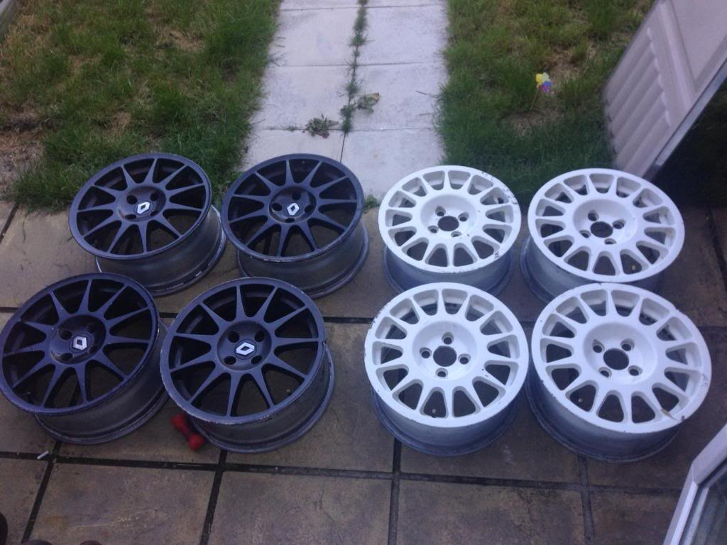

I had a couple of deliveries come through as well, sourced the turinis locally and Stu sorted me the 2118’s. Plans where to refurbish all the wheels I have, but now im thinking just keep it on 2118’s daily and sell the other 2 sets.

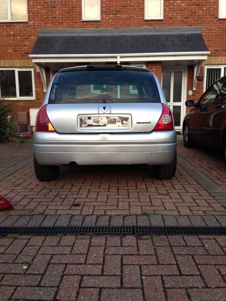

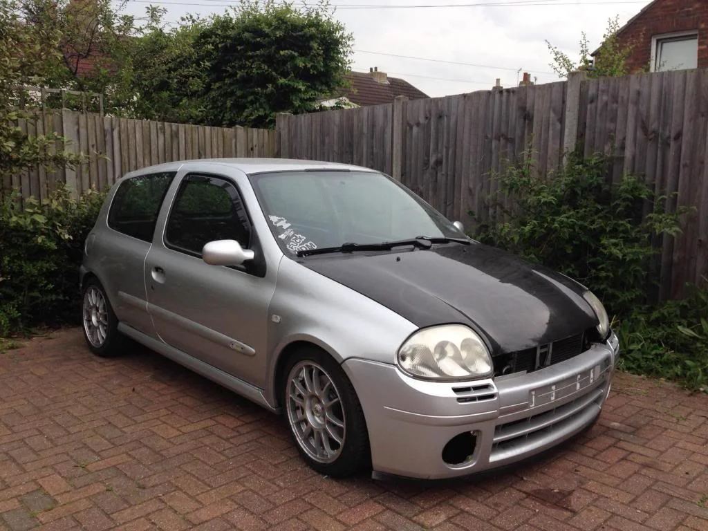

By the end of day 1 of it being home I had roughly fitted the front and rear bumper, This also gave me a good idea of exactly how it would sit at the rear with the weitec springs, I knew I wasn’t going to be overly happy but I have some FK springs in the post at the moment which will go down the extra 10-15mm which I want.

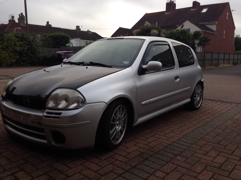

I had to cover the bonnet over night as my bonnet was sat in a friend’s garage 30 miles away.

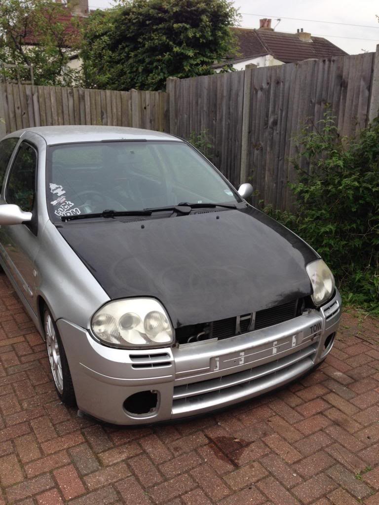

The following day my man dropped of my carbon bonnet, which I won on ebay 3 weeks ago. Im not 100% keen on it so it may be wet sanded, polished and sold on when the rest of the car is complete. Its currently just keeping my engine dry!

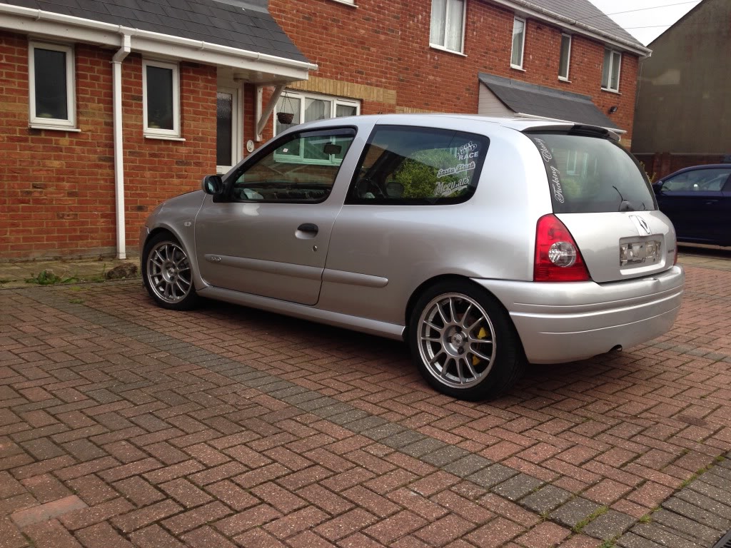

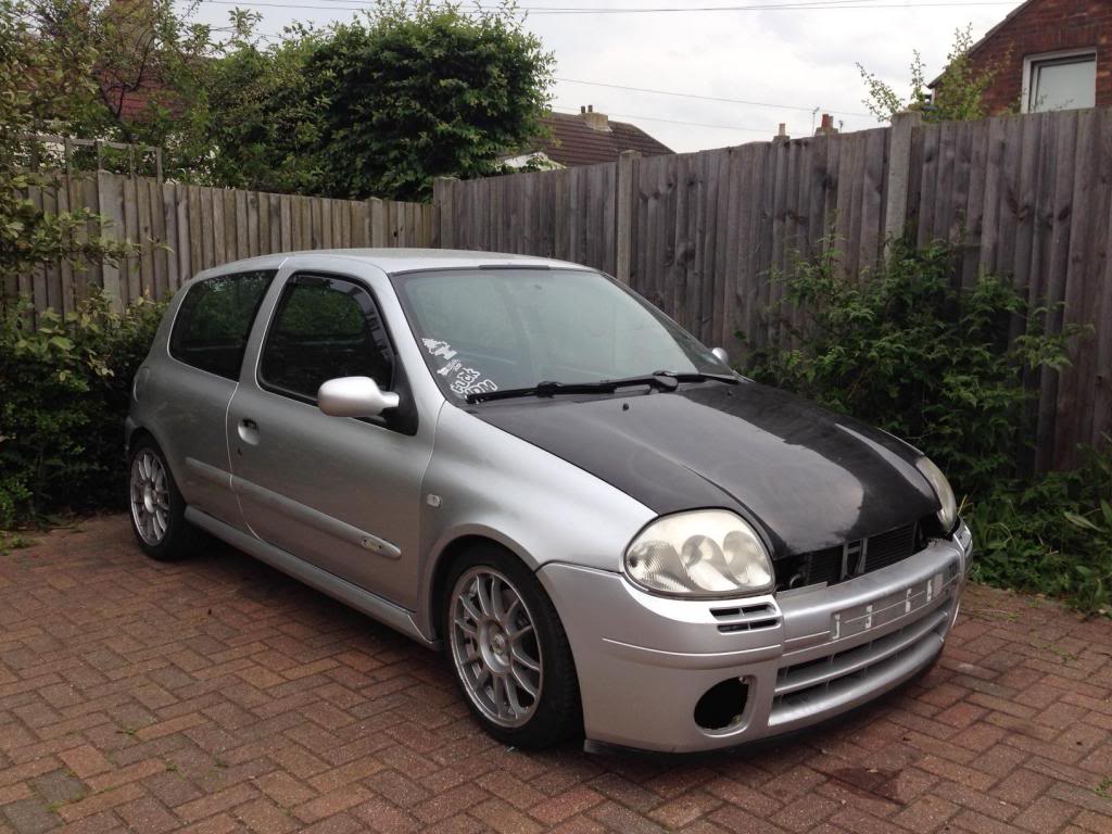

​So the rear bumper is now fully installed, the headlight clips/screws are now sourced but ive not fitted my grille as I want to do some wet sanding this weekend.
Also fitted my Phase 2 rear lights – not wired in yet but just needed to clear space and old parts.

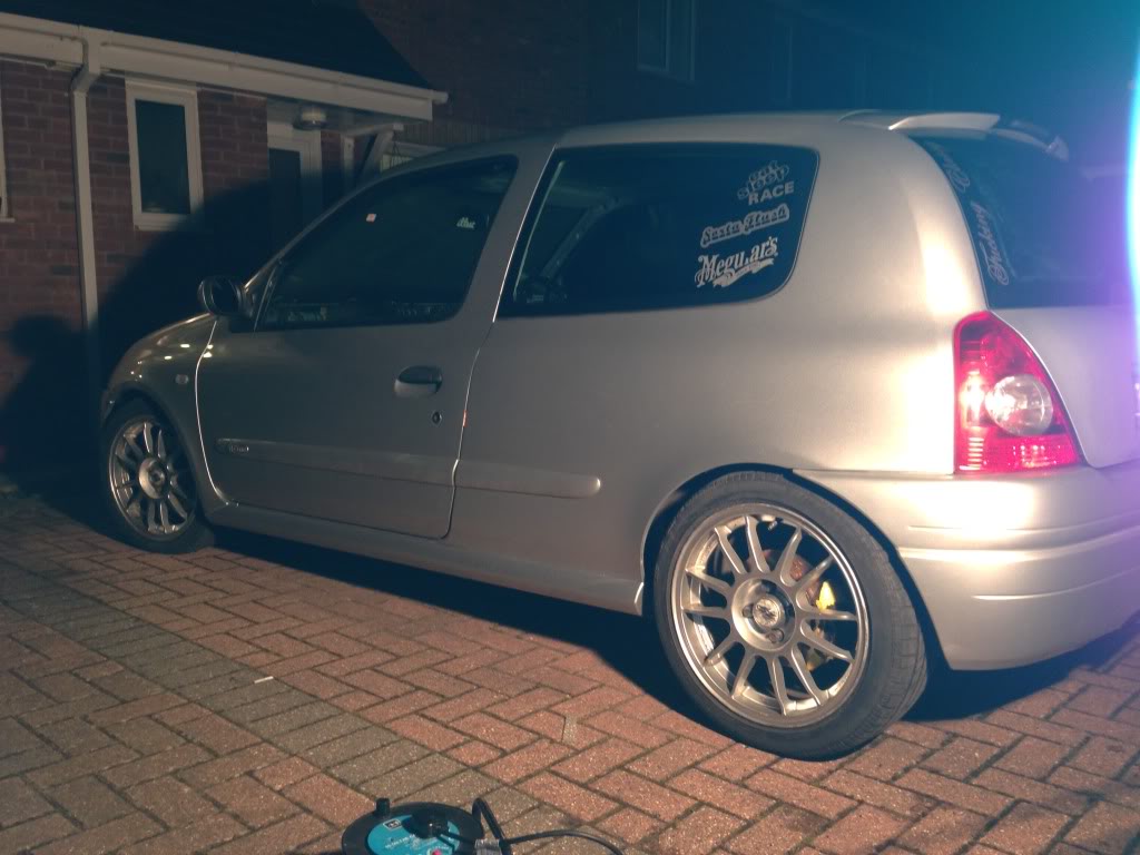

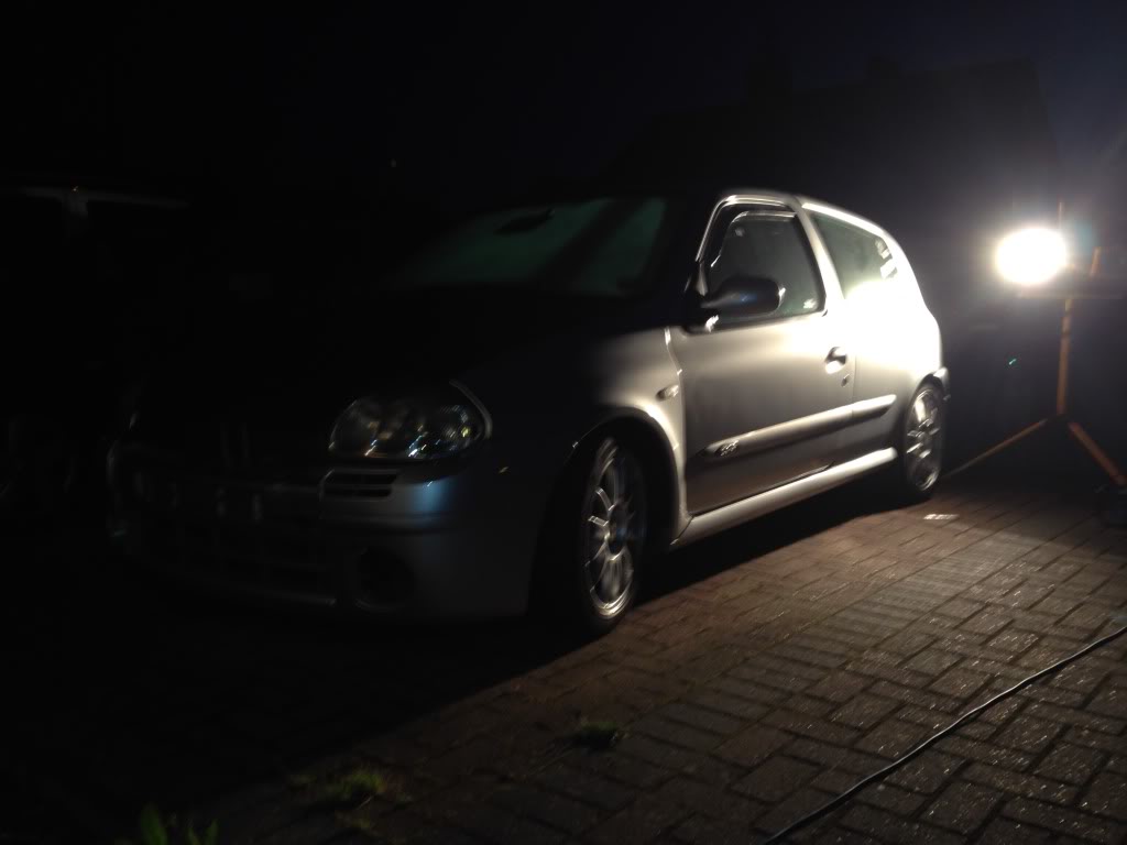

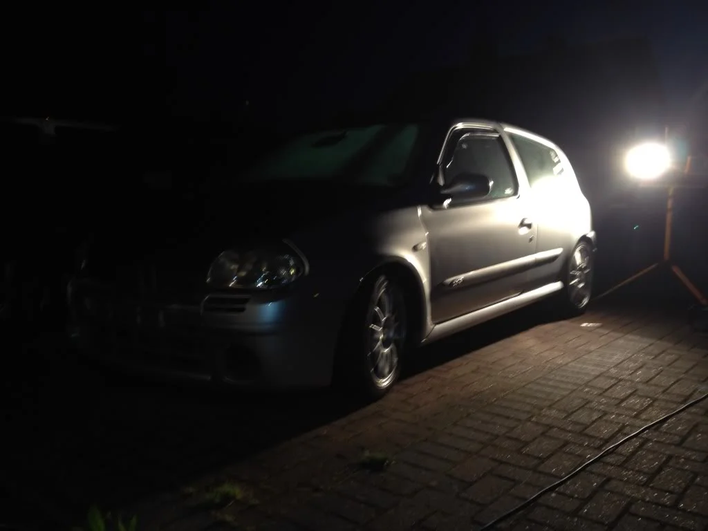

As my missus has gone away this week I have had a couple of spare evenings this week to do as I please. Firstly I removed all the tools and parts/ spare parts from the car and put all parts which require fitting back in the car so I know what I need to do/fit.
So I setup my working lights and worked last night until approx 11pm – discovered I need some rear calliper bolts before I can get the last side fitted. So they’re on the ‘new’ list now!
In that time I got my new FK springs fitted as I wasn’t happy with the weitecs
Suffice to say I am over the moon; I can go lower or higher now, the weitecs where as low as they could go
Weitecs
FK
