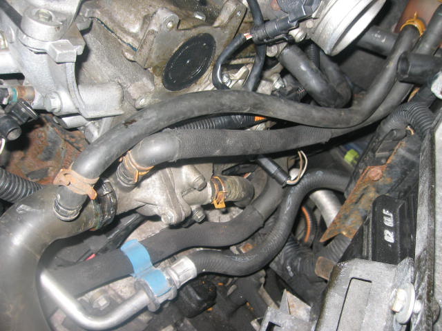

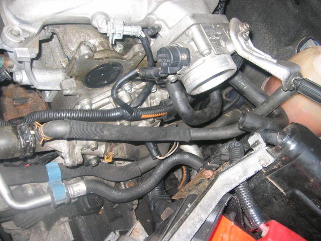

car failed last september - run tonight no water leaks but havn't connected up all the air system yet but a bit confused over the pipe?
Save me having to crawl over the engine if someone would tell me where to look.

Hose that comes out of the water bottle IIRC..
Its similar but thats fitted as is the pipe that goes below the thermostat. I ran the car for 2 mins and didnt get any water coming out anywhere?
  Lots of Alfas
Its the pipe that goes from the top of the thermostat to the top position on the coolant bottle.
  Lots of Alfas
I think hey must be connected up wrong somehow, does it still go to the top coolant bottle??

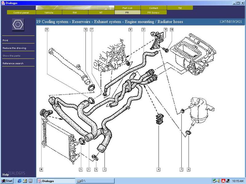

It should be setout like this:

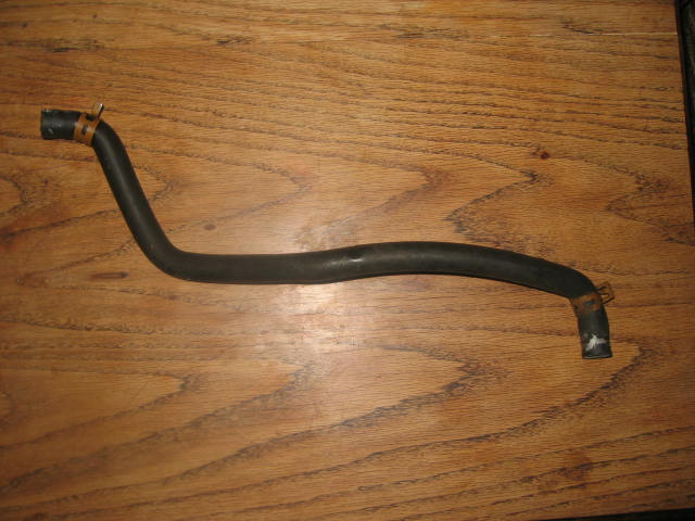

Heres a picture of the mystery pipe alongside the one from the thermostat cover to header bottle - as you can see it is a shade longer but it would fit. The one fitted has a covering I guess to protect it should the airintake rub on it. Clearer picture of that too. Ran the engine today for 20 mins no water coming out or oil fumes apart from burning off the exhasut from when the cam cover and head were removed. Most strange.......

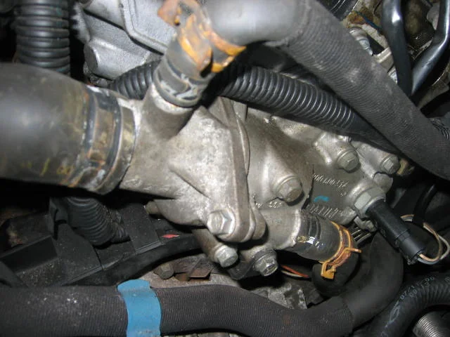

The plumbing is as your diagram but I have one pipe over - when you say main radiator thats the big pipe?
  Lots of Alfas
Yeah, the big pipe that goes in the front of the thermostat. The smaller pipe that runs off the big one shouldnt be there. From the front of the thermostat there should be 1 short thick pipe to the top of the rad.
