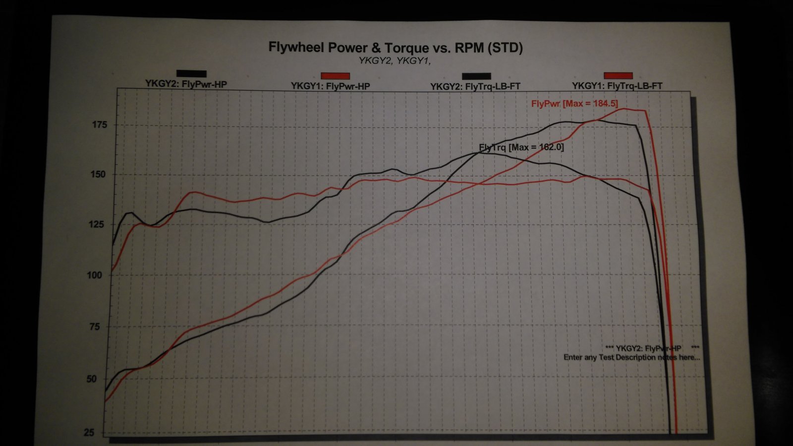

  dan's cast offs.
it's the black on that one. phase 1, epas, pms exhaust and everything else standard.
chris blue
  172 Ph1 2001
Peak bhp is 182 then? Guessing at 6krevs
Power range delivered differently on 2 runs
Or am i reading the graph wrong?
  dan's cast offs.
it's the black, the red was a different inlet setup. was touch over 180bhp with the matched inlets etc. would have to dig the graph out to check thee actual revs etc.

Mind you, only a 6bhp or so increase
