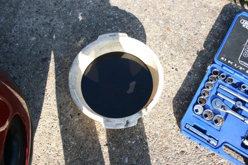

Few hours work this morning, just doing little bits and bobs tbh.Old gear box oil, only about 2.5L of it and it was black as black. Luckily our washing broke so i used the hose from that to refill it!

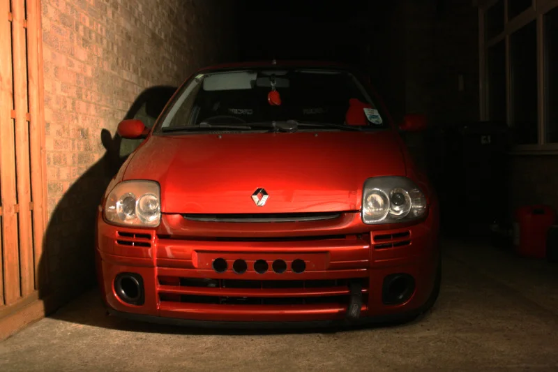

Undersealed the rear arches, pic is part way through painting one side. You can also the air deflectors i folded for the front brakes, dont think these will be going on as i cant secure them tightly, if they come off they would cause some damage i recon lol.

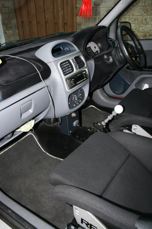

Folded a bit of metal at work, to mount hazard swtich and cig lighter. Ive ordered some 3M carbon wrap to go over this, shouldnt look to bad when done! Oh and hid the other wires up behind the dash :)

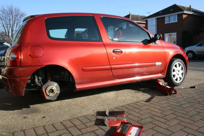

So today, my car was running rough. Misfiring, engine lights flashing, sound like a lawnmower and had no power! Luckily i wasnt far from home so limped it home and straight onto the drive way.

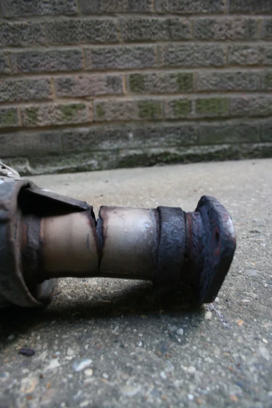

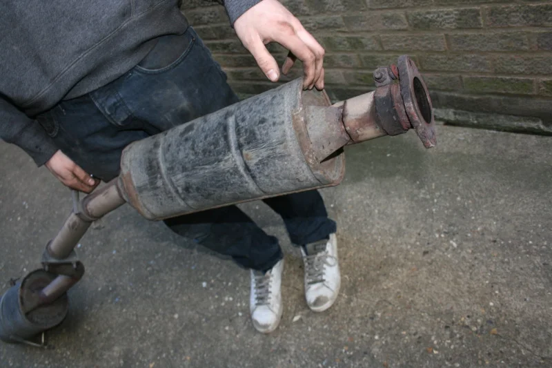

A little while later after a bit of angle grinding and undoing bolts the exhaust was off. Which revealed this lovely crack! (KTEC Stealth Exhaust)
As you can see, the weld which holds the silencer on is where the crack has started and then spread round. Obviously a weak point. Systems on about 25k from looking at previous owner receipts.

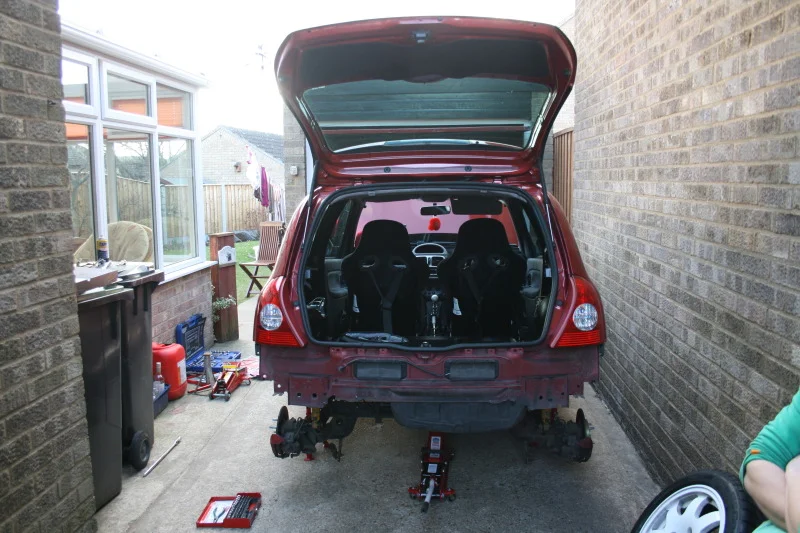

This is how it stands for now. Wheels are off so i could drop the rear axle lower and the bumper was in my way lol.
My dad is taking the exhaust with him to work, to attempt to fix it. Im hoping this will work, otherwise ill be heading to lewis to pic up another exhaust :)

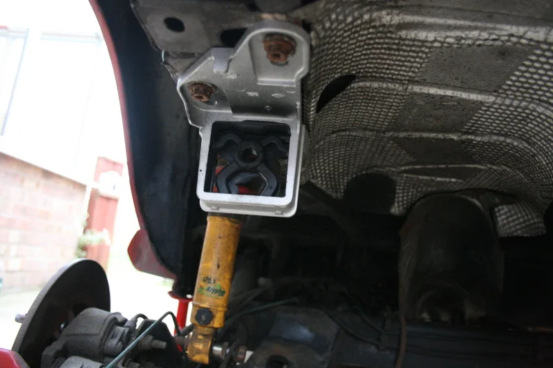

In anticipation for the exhausts return i though I would throw on a new hanger.
