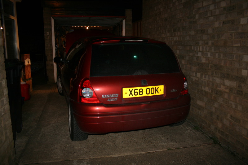

Ph2 lights on, and looking sweet even if my car is filthy. Literally took 5mins.

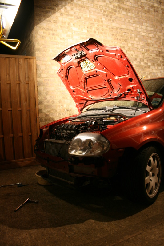

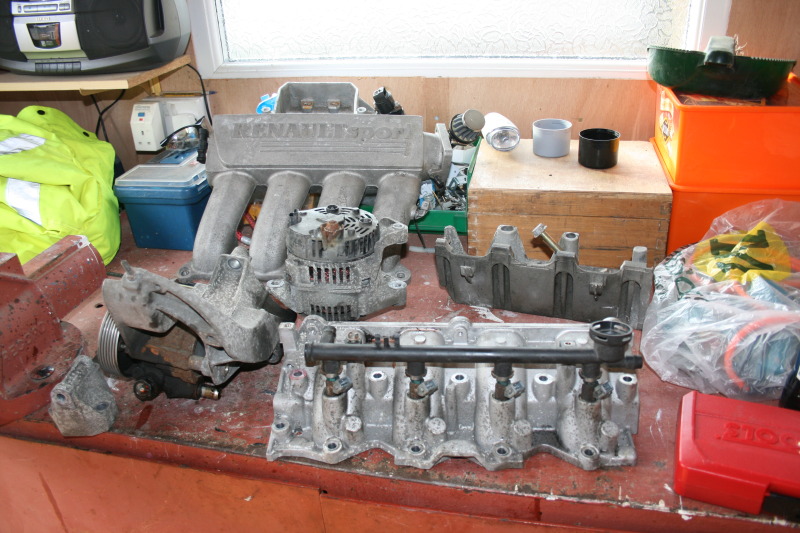

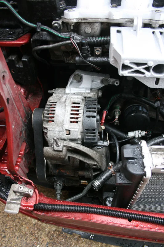

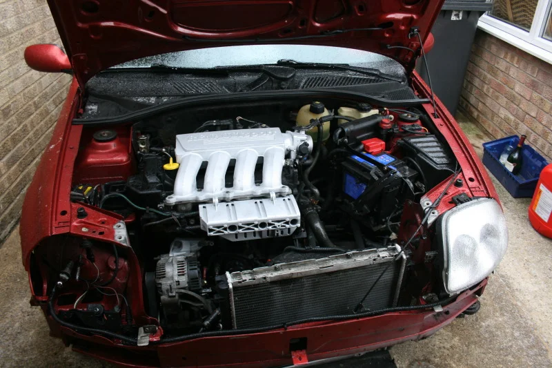

Cup alternator fitting time. Complete b**ch of a job to do! So many awkward bolts.
Stopped as its absolutely freezing out there!
Got all the old stuff out, new PAS pump on, just gota bend the high presure hose.
Tomorrow
-get the alternator on and new aux belt
-swap inlets to matched
-put things back where they should be
-bleed power steering
-make it look like a car again

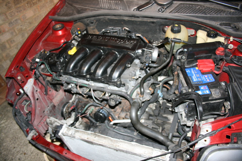

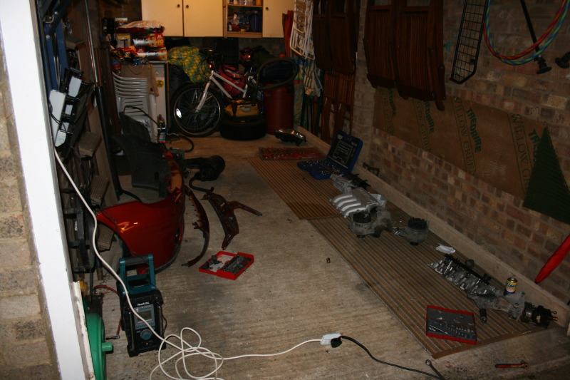

Few random pics.
Engine bay
Garage

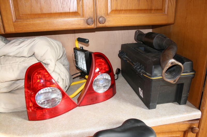

Oh and ph2 rear lights (i know most will hate these)

Wow your garage is organised, mine is ermm... well you've seen mine, can barely get in it! lol good to see your getting on with it :)

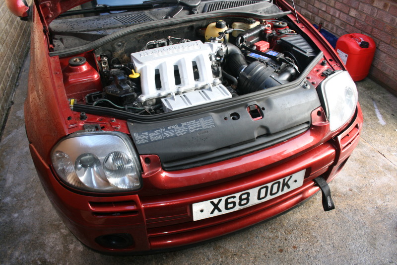

DONE! By 9am i had the matched inlets on, alternator in and aux belt on.
Spent the next few hours trying to make my bumper sit properly for once and just doing little bits and removing the carbon canister.
9am
1pm
Cars now alot lighter and seems to rev more freely. So im happy with my work, minus having an epic cold now!

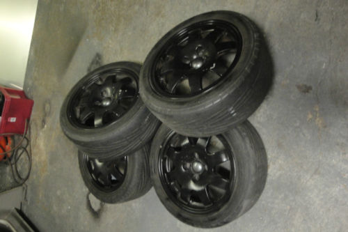

Another ebay bargin, another set of williams wheels this time badly painted black with worn tyres.
Plan is to wrap them is some decent tyres for use on track and get my white wheels refurbed and try to keep them mint!
I might respray this set with rattle cans as they wont be for best lol. Any ideas on colours? :)

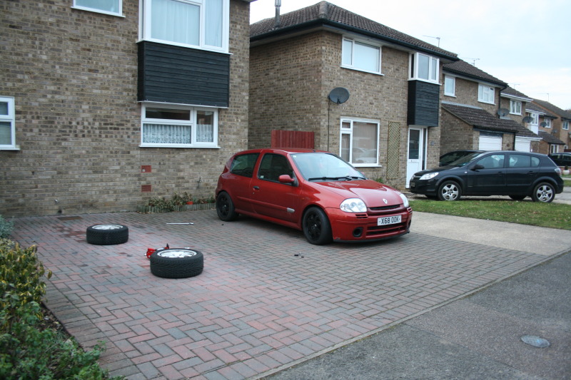

Wheels turned up today, theyre powder coated a matt black kinda colour. Theyre in pretty good nic, minus a few chips on each of the wheels on the spokes.
Think i will just leave them as they are and wrap them in some decent rubber.
Few pics with them on, car needs a very good clean!
