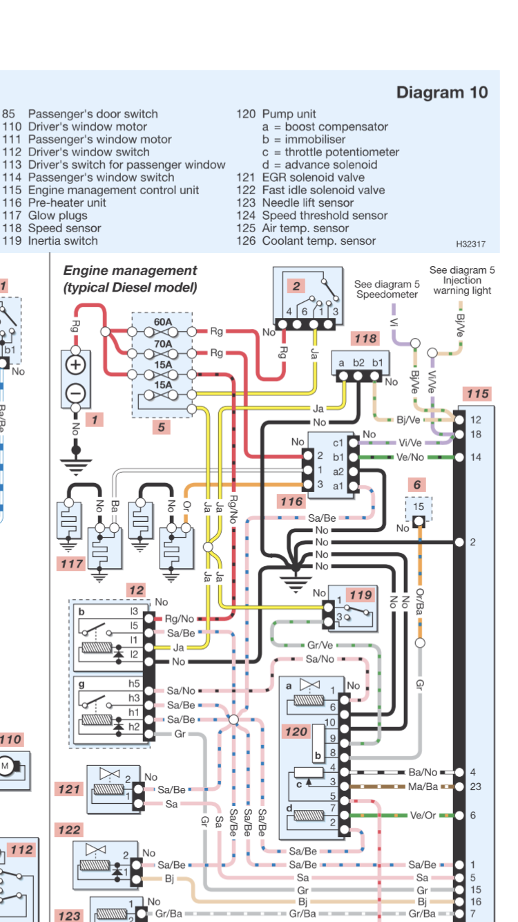

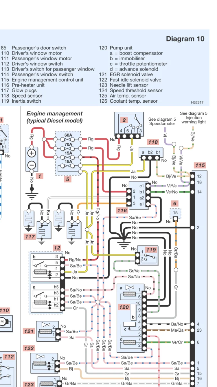

Hi Rich,
I took a look at a diagram I have, it shows a switched live, earth and the signal wire to the ecu and gauge. See attached drawing.
Speed sensor is 118 and ECU 115
These drawings haven’t been too bad when I have used them, hopefully they are correct for you.
Hope this helps,
Joe.

Cheers Joe
So looking at that it appears the signal from the sensor can be feed directly to the clocks rather than be decoded by the ECU before sent on, which is ideal.
I can make up a dedicated loom just for the Speedo drive to feed the clocks.
Rich

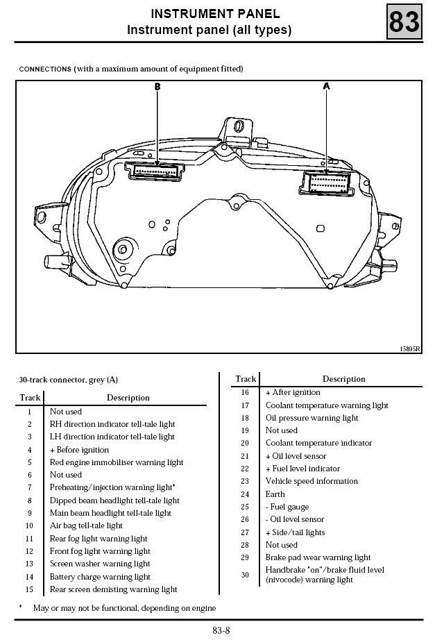

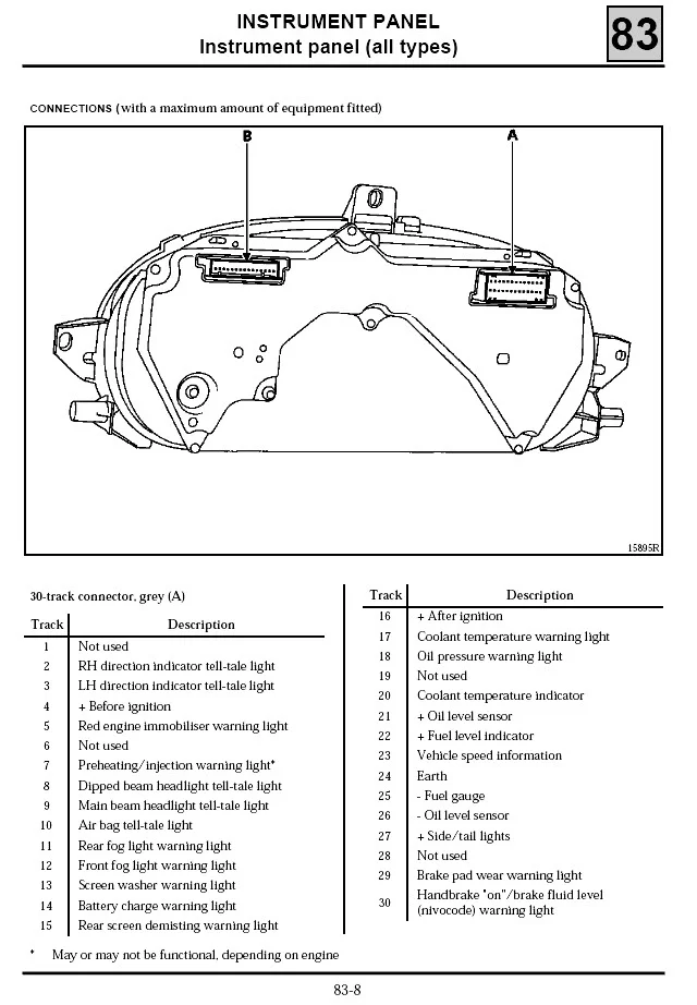

HI Joe
Bit of thread resurrection, I don't suppose you send me have a copy of all the diagrams, or at the very least tell which pin out on the back of the clocks is for the Speedo input?
Cheers Rich
Hi Rich,
Is this what you are after?
Regards,
Joe

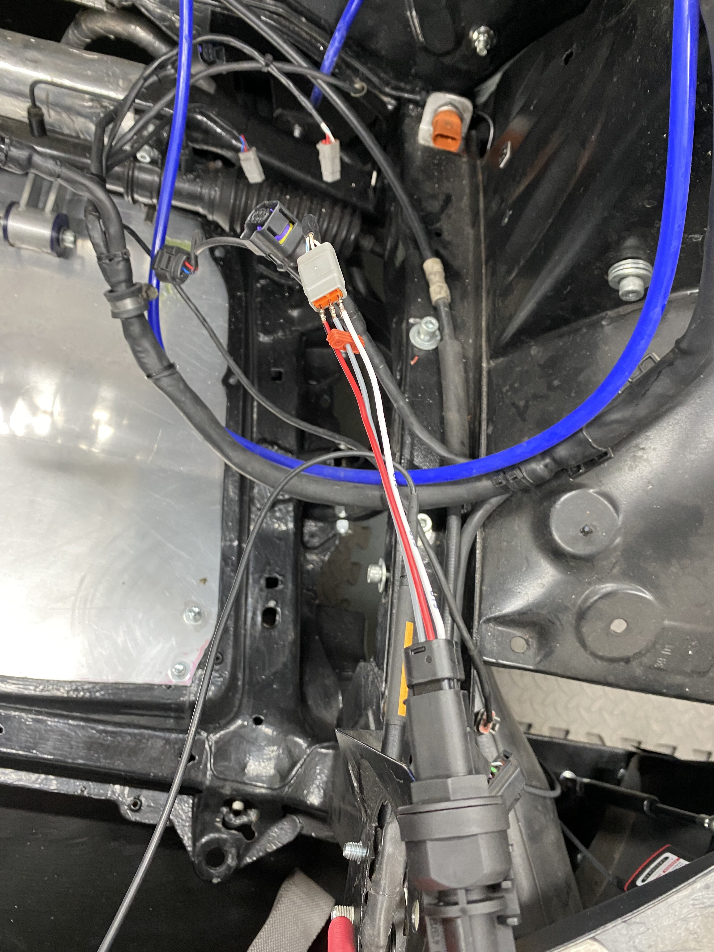

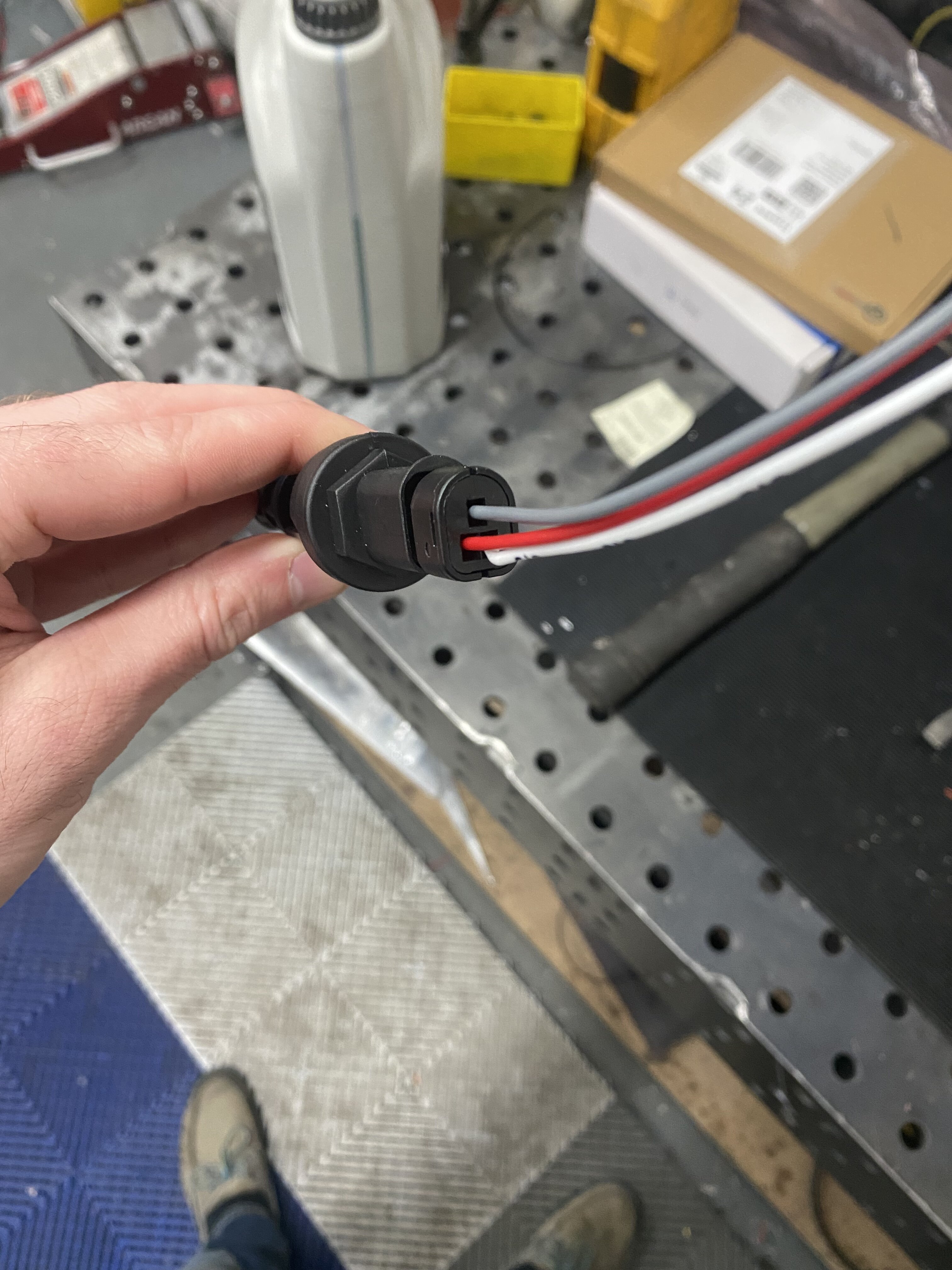

Rich, Joe, hope one of you can help.
Any idea what wires are which for the gearbox sensor?
Trying to wire the gearbox speed sensor into a standalone ecu but struggling to work out what wire is meant to be which.
Hi,
Does either the plug or the sensor have PIN numbers on them?
My drawings show
A - 12v+
B1 - Output signal
B2 - 12v- (Earth)
Hope this helps.
Joe.
Hi,
Have you tried putting a multimeter on the sensor output? I would expect that you would see some voltage output when the sensor rotates.
Hi Joe,
Nothing shows on the multimeter. But can be hit and miss with frequency outputs. So I’ve got an oscilloscope coming tomorrow and hoping that will shed some light.
Will let you know what I find out tomorrow or Friday.
