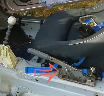

Ok I got that cover off with the torx screws and now I see two nuts that look like they are holding the handbrake plate to the car. i dont have to take the cover off the shaft of the actual handbrake do I ?
This might help^
You might have to take the cover off the handbrake lever too/only cant really remember.
