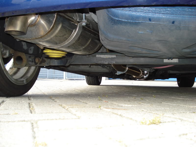

  Clio RS ph1
The stealth is quite loud. It`s a lot louder then I expected.
It takes some time to get used to;)
As said it`s a bit to low for the ph1 bumper but I don`t mind.
This is how it looks on my ph1:

  Clio RS ph1
I ordered new OE Renault exhaust hangers as well. And it wasn`t a problem to get it as its sits now.
You make sure your car is on a ramp or something. That way you can easily play with the brackets to get it as high as this.
There is about 1cm between the backbox and the heatshield. So it`s a thight fit, but I have no problems so far:approve:
