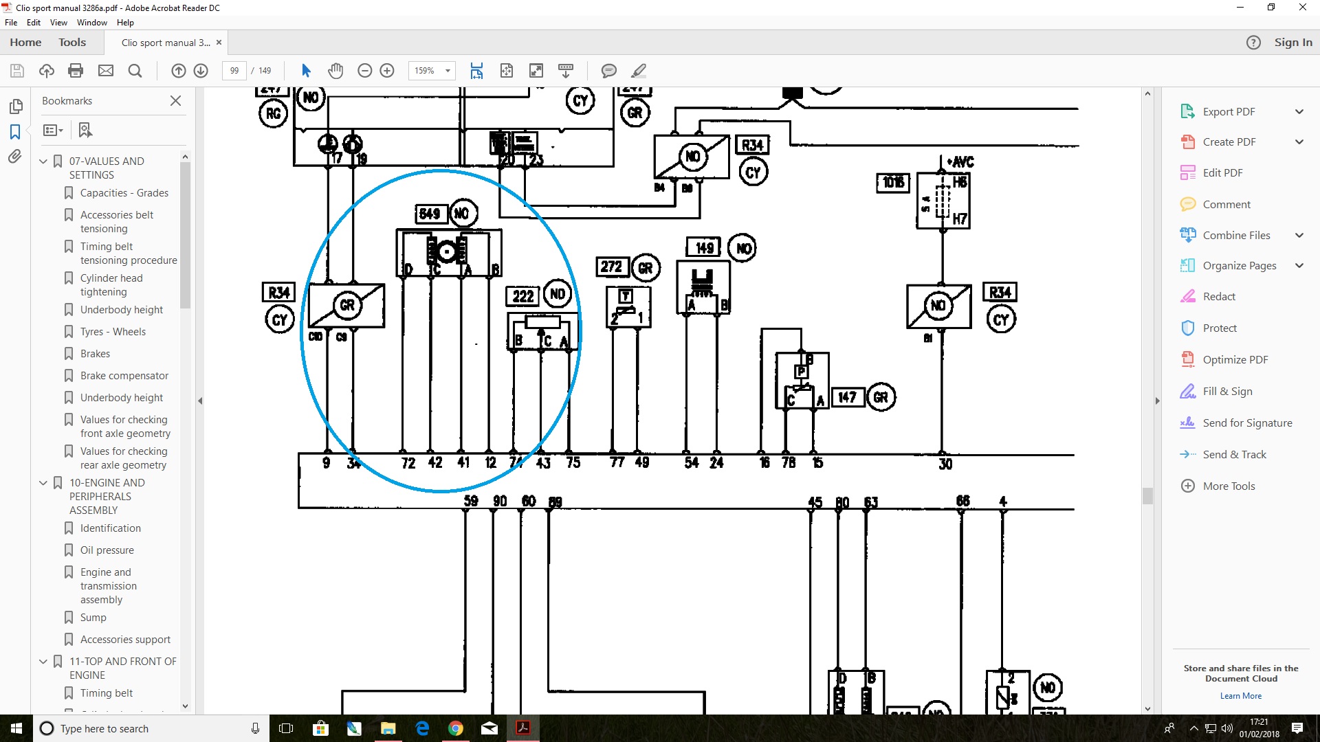

As per title been struggling to find the pinouts for a the phase 1 172 ICV, its 4 pin but I cannot find any pin / wiring diagrams for it. I have just forged my phase 1 172 engine and dropping it in my gtt and running standalone but need wiring pinouts so I can get it to work

Pin A - cream Track A
Pin B - White with black line Track B
Pin C- White with black line = Track C
Pin D - Pink = Track D
But which are signal, gnd, and live, Assume Pin A & D will be gnd and live feeds ?

Its a Renault 5 gt turbo, I had a previous engine conversion F7p turbo so have had the adaptronic 440 ecu for a few years now, decided to turbo an f4r now as parts easier to get hold of. I have found out I need a small driver circuit board to be added to my setup that will allow me to run the 172 idle control vale (Actually a 4 wire stepper motor).
