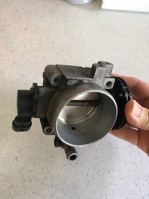

Since getting my phase 1 a couple of years ago, I have had no end of problems with the throttle body. Whenever I think I have cured the problems, they eventually rear their head again.
When I first had the car, the TB would stick. When coming to a stop, revs would hang and I would have to blip the throttle which sometimes didn't help and the engine would be sitting at traffic lights at 3000rpm 🤦‍♂️
I removed it, cleaned it up, cleaned the ICV, greased up the TB mechanism which helped for a couple of days before it would go back to its bad ways. So process of elimination started:
new ICV
new genuine throttle cable
sanded down the chamber to ensure the butterfly wouldn't catch on anything
still no luck. The throttle would still stick so I thought perhaps the spring mechanism was to blame. Did a bit of research here and there and noticed that people complain of the TB wearing down with age.
So I got a second TB by chance off eBay. A UK seller posted it to me. Before I fitted it, cleaned it all up and regreased the spring with white lithium grease. Fitted it up with a new gasket and lo and behold its instantly improved. Also have since fitted a new magnetti TPS.
Fast forward a year to now and some of the problems have returned. When the engine is cold, its fine. Throttle is smooth to apply. As soon as it warms up, the throttle gets stiff and gritty-feeling at small throttle applications and its impossible to drive smoothly. Luckily it is not sticking yet, the throttle is closing shut OK but I fear that problem is only around the corner...
These TBs are rarer than rocking horse s**t, non-existent in Australia and impossible to find online. Have got quotes for a brand new one from Renault of around $900 which is way too extreme. Are there any aftermarket options or a generic throttle body that anyone has had success with? Any tips on finding good condition replacements?
The TB part number is 7700871215, with other F3R/F4R TBs from Lagunas/Meganes having compatible TBs with part number 7700113286. 7711155379 is another part number and appears to be an RS Cup-specific part number.
Keen for any assistance.
I was taking a closer look today and when the butterfly is slightly open there is a small amount of play on the spindle. I assume this means the spindle bushes are shot and have grit in them.
can these be rebuilt easily?

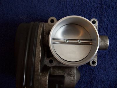

Had more problems with the throttle body, so got that rebored to 64mm i think it was, and had a new spindle and butterfly, and after doing all these 3 things , after about a year it seemed to have cured the problem and havent had any problems since

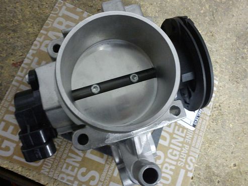

i remember seeing the guy on ebay with the uprated throttle body. 64mm oversize will have negligible improvement but just a new spindle and bushes alone would be worth it. Alas, havent seen him advertising recently :(

Ive got a copy of the ebay ad for the " Clio 172 phase 1 enlarged throttle body 64mm" advert
the seller was " sneakapeak99 " located in Langport, Somerset
But that was Janury 2017
Edit: Found it: Just realised it is same link as post above. Thats the guy that did mine, much improved
Thats a much cheaper option than getting Renault to make a new one.

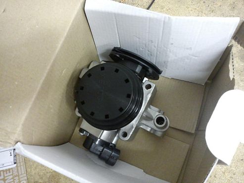

This should sort it out however I purchased a new one from Renault as a spare just incase.
If i remember correctly it was £350 and still available.

And when he replaces the butterfly and pivot spindle they have to be a bigger size, as he rebores the throttle body out a couple MM too
That would smooth out imperfections and make a perfect fit

Received back the throttle body from the ebay fella, installed. Its sticking so needs some adjustment. Overall quality of the work is very good but wish it worked perfect first time. He has offered some tips on how to adjust the butterfly slightly to stop it rubbing.
