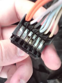

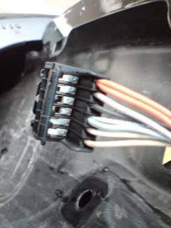

  FTO GPX 2.0 V6
How are they rewired, does the wire have to be cut, or can the connectors in the block be taken out and moved to the correct order, sorry, don't want ot cut any wires if I don't have to
Rob
The wires just pull out of the connector at the end, its a bit fiddly, but as soon as you do the first one the second is a doddle! You've already got the wire order there so just take the clip out the back of the light and un-clip the clip holding the wires in.
  FTO GPX 2.0 V6
Cheers mate, sounds like I had the right idea, they were really tightly in the connector, I undid the clip but it didn't seem to make any difference. I didn't want to pull and damage something. Will have to try again tomorrow in the daylight.
  FTO GPX 2.0 V6
Right, that didn't work for me, I just buggered up the rear lights by trying to pull, the stupid pins have bent and wont fit back in the connector properly and got stuck. Lights still work, but really dubious as it has little contact to the top contact of the two.
Anyone know a good place to get a replacement loom and connector?
  FTO GPX 2.0 V6
What, they just pull out of the block? it seems like the wire is connected all the way to the end of the pins.
Now youv got the clip at the front undone, turn it round to the back and prise out the little plastic bits behind the connector and they should now be able to pull out the wires
