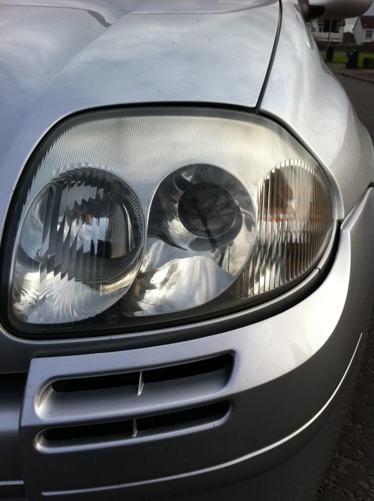

I have a Phs 1 172 and have recently done my headlights, wet sanding 2000,2500,3000 grit, then Megs UC followed by Megs 205 with my DA polisher
Whilst the lense came up like new, they still look yellowish on the top half? I'm guessing it's the reflective silver on the inside that has discoloured?
Anyone else had this on the Phs 1 headlight?
Cheers
Her I had this but don't rate megs so I changed to the 3m kit and they came up a lot better

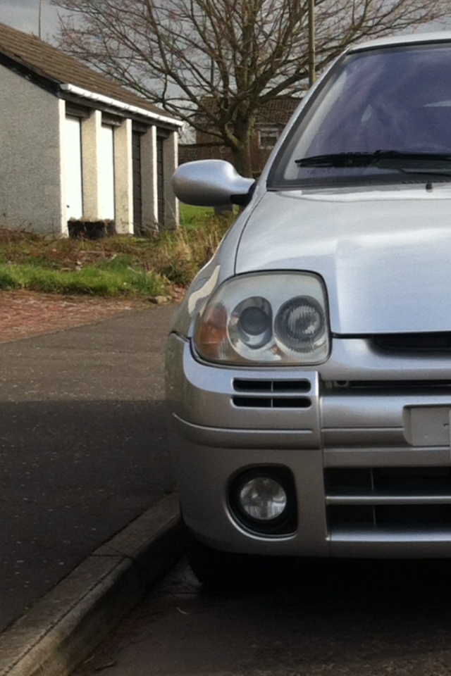

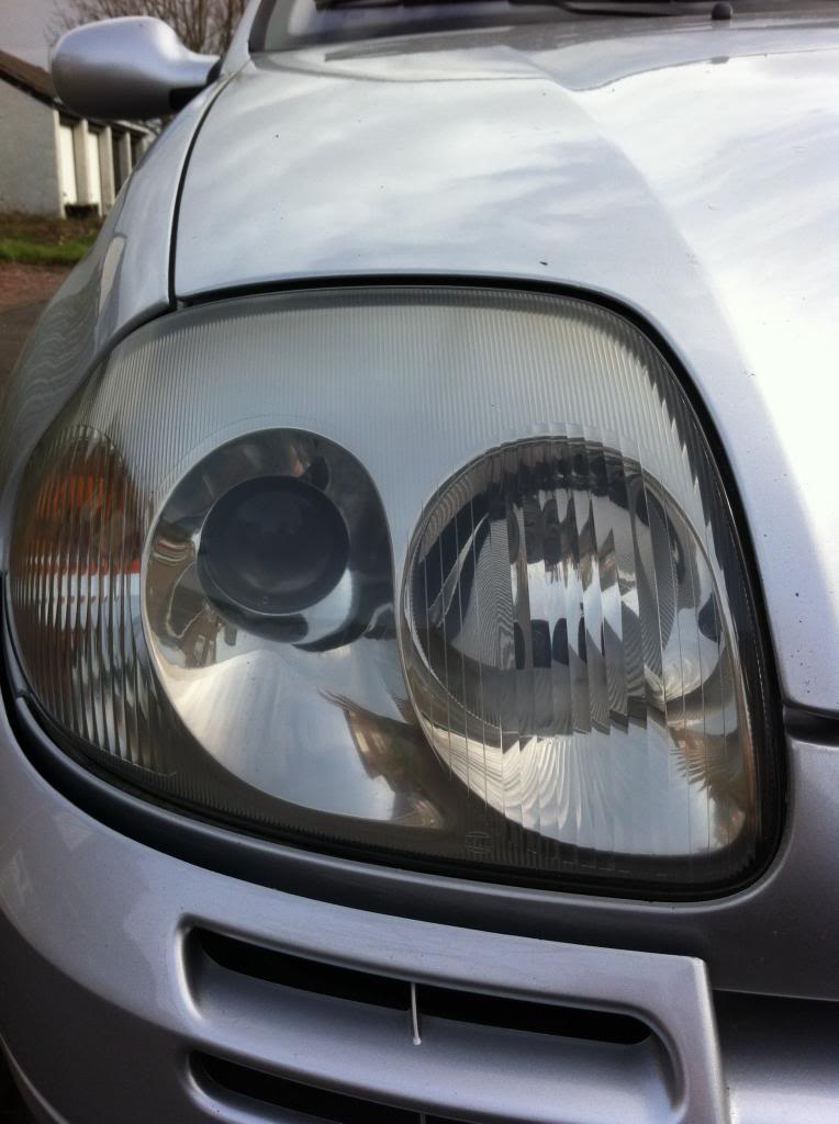

Here are my headlights.... i'm wondering if the top halfs just need more work????
I'd go over them again, but starting with a coarser grit. On the ones I did (on a phase 2 though) I started with 1200.
