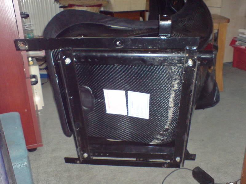

Can people show me some pics of there side mounted buckets in a clio mrk2
the standard tracks are off set and i cant line up my suzuka's :S

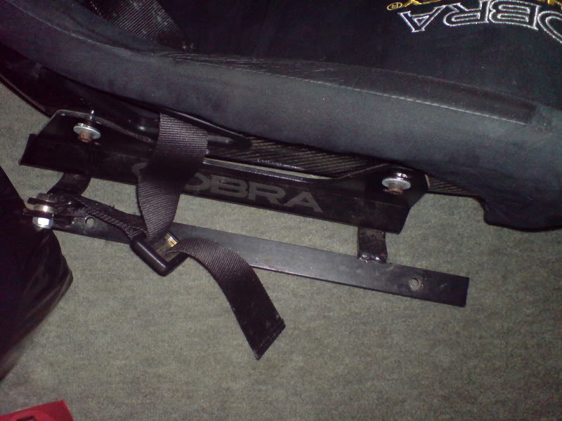

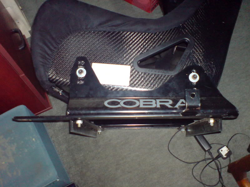

should give you an idea how we did mine, bolted to the actual chassis, you need to lose the pipes that feed the hot air to the rear seat passengers feet to line it up like mine, if your using subframes i dont think you need to do that.
anyway, hope this helps.
how wud u recomend to do it fred, if i was to keep my back seats and have harneses
you ever crashed head first into a tyre wall at 80mph?? things bend and snap easily!
i'd use proper subframes through the original bolt holes with the side mounts bolted to them, as per cobra sell, or wait until we bring out our new cobra specific sidemounts
ill wait for your subframes then, however at the mo the driving position is amazing so not sure how low it would be with subframes under them.
