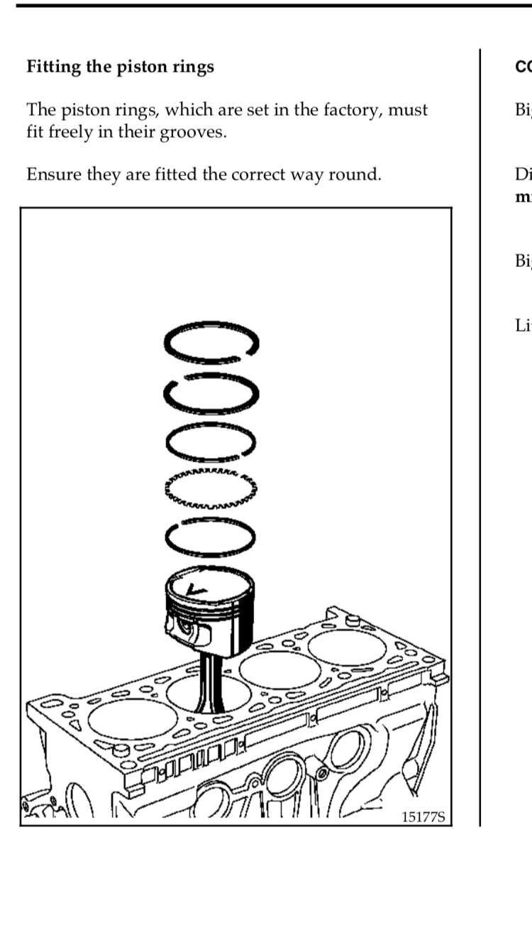

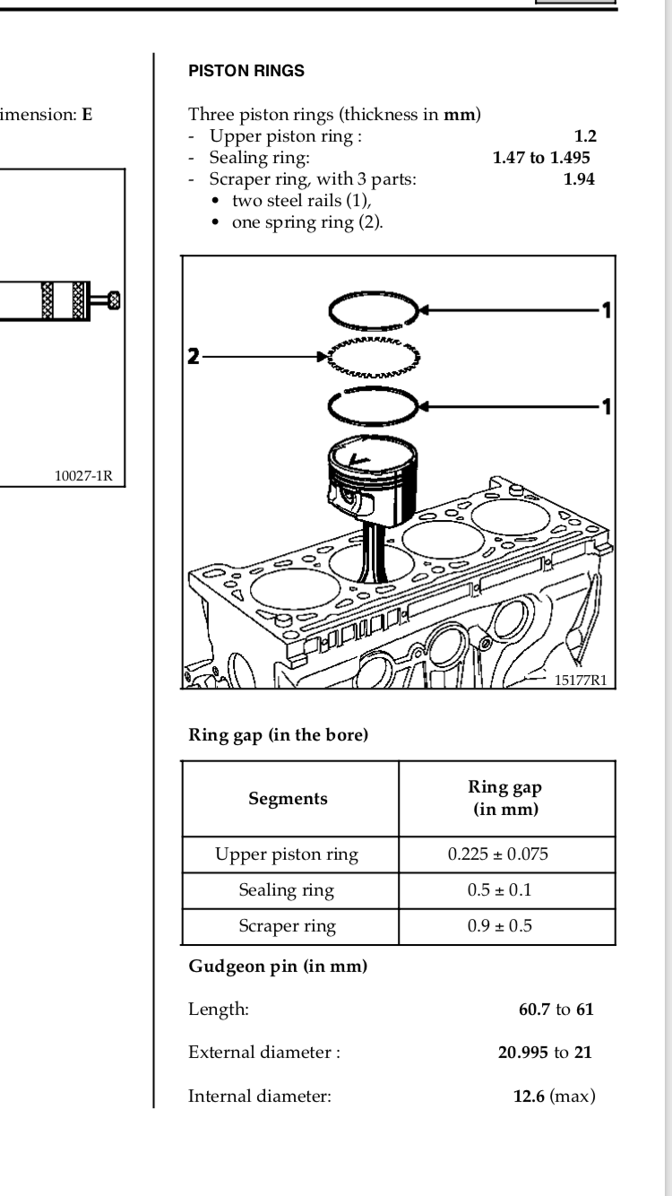

I’m after the official Renault manual which has the piston ring orientations and ring gap details. Needs to be the official source!
Would be great if it also had the oil pump cover torque specs in too.
Cheers
@GrahamS

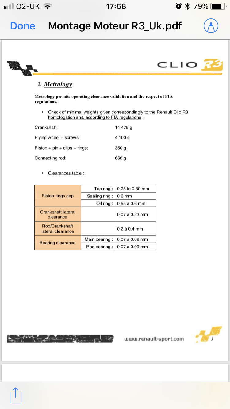

R3 maxi for reference:
And F4R:

If you’re after piston to bore clearance measurements though I don’t recall seeing any - only bore measurements and piston diameter measurements. Those sort of measurements are only usually needed if you’re fitting aftermarket wossner pistons for instance.

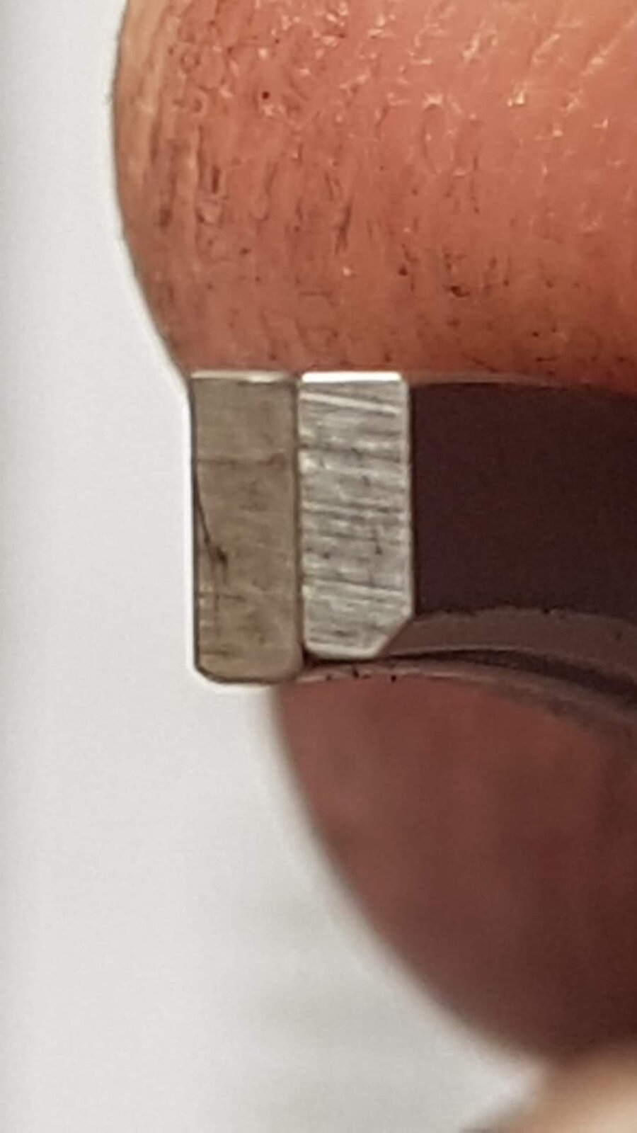

Just removed the top piston ring the existing gap was 0.35+ or - 0.05
brand new ring gaps are 0.40 + or - 0.5 how is that even possible?
Middle ring down from 0.70 to 0.40 so hopefully my compression loss is through the middle ring but I'm stumped why a new ring would have a bigger gap than the old can anyone shine any light its also has shorter depth existing ring is 3mm new is 2.71 rings were bought through PMS
