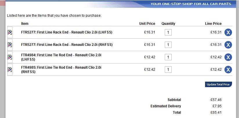

These are what I am thinking of ordering? What do you think?

i have changed both steering rack ends and track rod ends on mine and it made a huge difference, but after changing them i foundbottom ball joint had play aswell so may be best to get it checked out to see what it deffinatly is.
as for tools no special tools needed just the steering rack ends are a pig to get to, especially the near side.
track rods require a special tool (i made my own) bit of a t**t without it
track rod ends aren't too bad
if you have a cup, then the track rods are dealer only
i had the same problem. found out it was my track rod ends so got them sorted and now fine....;)
