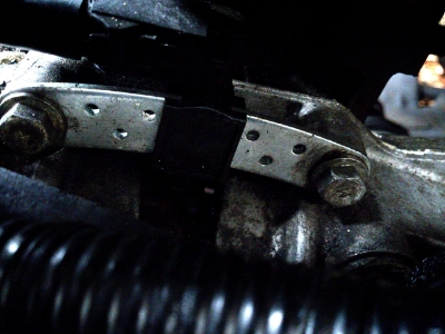

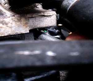

Is it this your having the problem with??
If you have pulled out the crankshaft sensor wiring it will never start, the ecu won't know the engine is turning over.
By the new modified sensor and plug and fit that, save you trying to find the right terminals. Parts are circa £26 from Remault.
It's the 2 wires going into the crank shaft plug. Is there any way I can just plug these 2 back into the socket? It's a real struggle to get to it in order to actually put pressure onto the plug to push it in
Common sense really, I don't know what you have been left with condition wise.
Remove the air filter box for best access first. Yes it's two wires (green and white) that comes out of that rubber covered loom you have pictured, take the plug off the sensor you have pictured (CPS crank position sensor) and see if its possible to put the wires back in the plug.
My guess is you won't manage to get the wires into the plug again due to the one use crimps hence my above comment about killing two birds with one stone and getting the modified sensor. It won't be long before that one fails, I done 5 between my sis and mums car over circa 5 years.

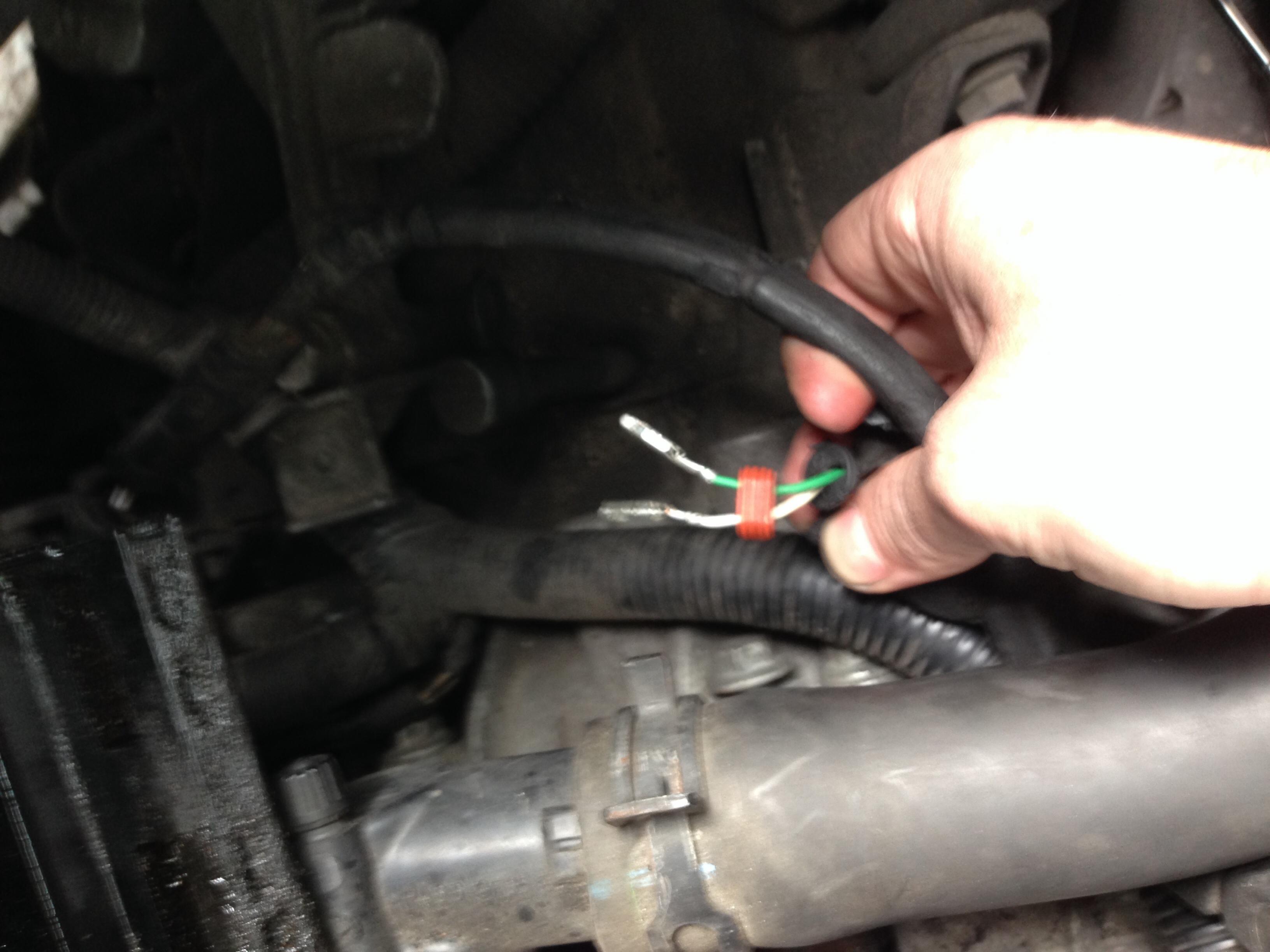

This is what iv found after reconnecting everything after cleaning the throttle body. I never removed this so I must have pulled out accidentally. Are we talking about the crank shaft sensor here? If so should there be a plug on the end of them two wires?

if the crank sensor isn't plugged in (the 2 wires you've ripped out of the connector!) you ain't going anywhere!

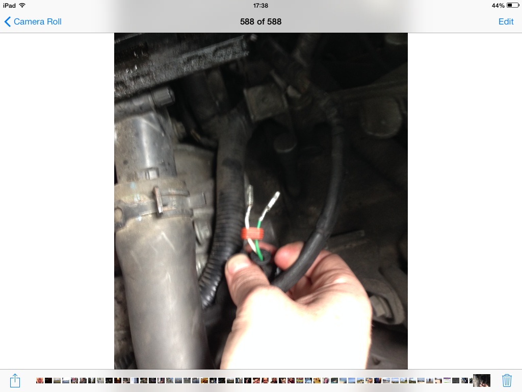

Right. Is the green n white wires I am holding in my hand in the picture above with the red bit in the end the crank shaft sensor?
Ok cool. Should there be a connector on the end of these 2 wires? If so how how do I put them back so it will start again.
IN.PLAIN.SIMPLE.ENGLISH
take the crank sensor off ( held on with two 10 mm bolts )
try re attach the wires back onto the two pins inside the sensor.
if all else fails, order the revised loom and sensor from renault and fit it. (you might not be able to wire it in as you cannot follow what anyone says! )
As everyone else has said. Reconnect the wires to the sensor. If you can't follow this simple information, then get someone that can to do it.

the crank shaft sensor plug actually snapped off from the soldered connector. its really fiddly to be honest but we got there
