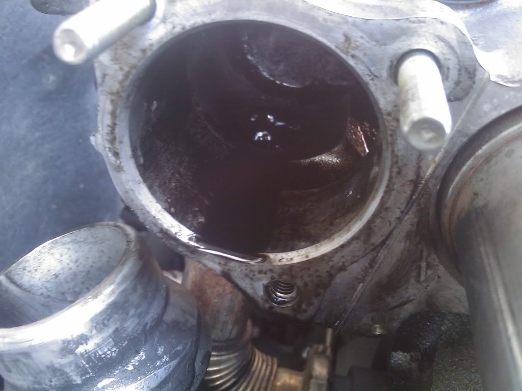

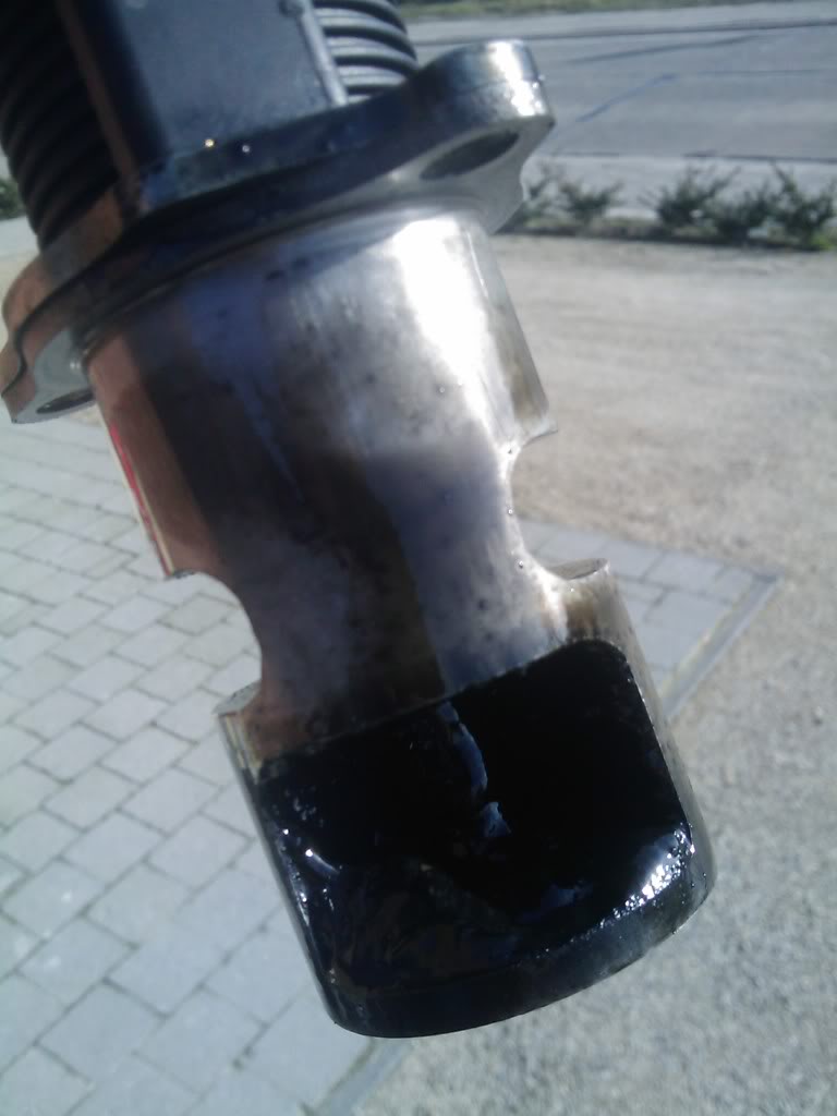

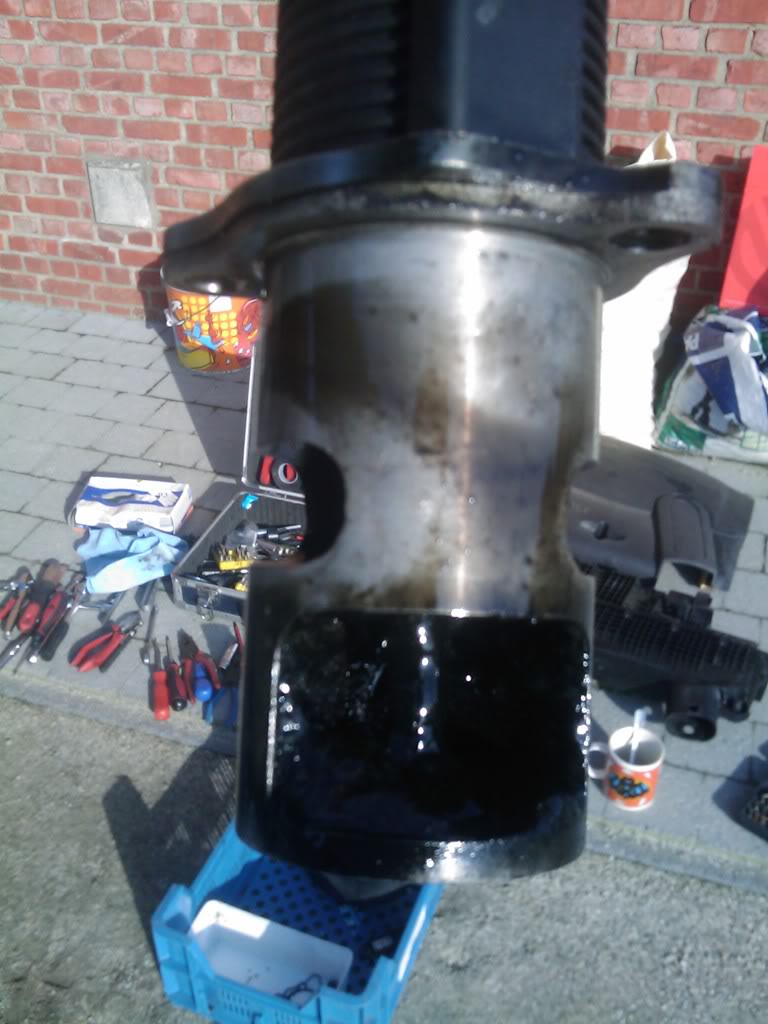

Quick test to see if it's the turbo.
Check the EGR valve, if it's like:
This ERG valve is showing that the turbo is 100% fecked and letting oil into the induction system, if you find your ERG looking like this -- DO NOT DRIVE THE CAR
if the turbo lets go all the oil in the sump will be pumped in to the piston and burnt, causing 100% meltdown of internals (NEW ENGINE TIME)
