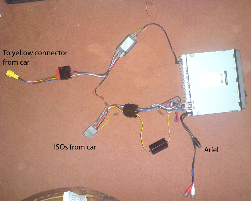

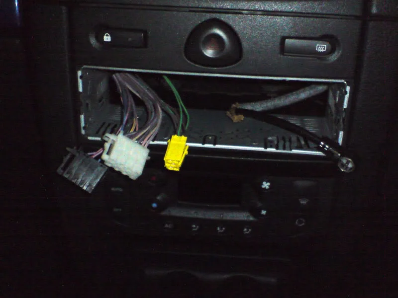

This is a photo of the leads coming from the car:
product_storeId_10001_catalogId_10151_productId_230735_langId_-1_categoryId_165626
And a photo of the main loom:
So the yellow connector goes to the yellow connector on the loom.
The other two go into the sockets on the loom, which then goes into the sockets in the rear of the HU.
So far, all is simple and straight forward. BUT where the hell does that 3.5mm jack connector go?!!?!?

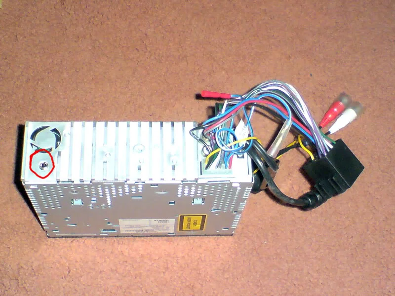

Heres a shot of the rear of my HU, the only possible connection is circled in red. It does fit in there, and it does APPEAR to be a jack socket.
But if I connect everything, it doesnt work :(
So am I being thick or have I done something wrong?

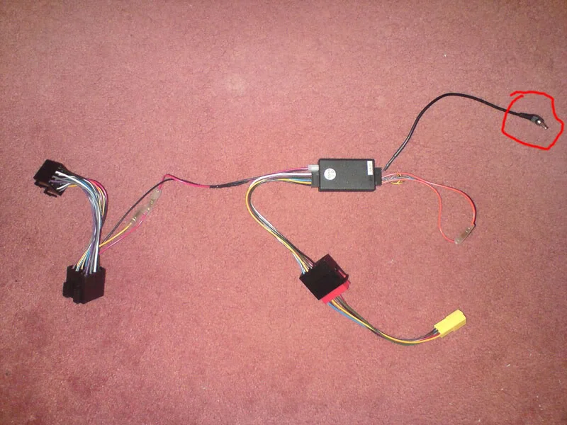

At halfruads, there was another loom: http://www.halfords.com/webapp/wcs/..._productId_230675_langId_-1_categoryId_165626
But this didnt have a socket for the yellow socket coming from the car!

BTW that 3.5mm jack does go into the part you've circled.
From your pics you have a yellow BLOCK connector which plugs to the cars loom, BUT there is still a yellow bullet connector i can see thats not plugged to anything hence the reason you arent getting it turned on = It doesnt know the ignition is on
Yellow is the Ignition wire, Reds 12v Batt IIRC
The ISO loom you have recieved with the Headunit should have a Yellow wire for that bullet to plug into, If it doesnt its the wrong one.
Screens not an issue it should still display the time just not the radio stations but that wont matter much because the headunit will show it
I reckon its the wrong Loom you have bought though TBF. The one you have boughts for the older cars
Tis my 2p
Alternatavly you should be able to splice a wire into the Ignition wire and link it up that via a bullet connector. Ive done this in the past

With the loom all wired up, the HU DOES work, but the remote controls dont work.
So the ISOs plugged into the loom, the yellow to yellow, and the loom plugged into the back of the HU.
Wrong autoleads kit then, Bloody french wiring, Whats a screen got to do with a stalk :rolleyes: Guess it needs the screen to create a circuit

The dash doesn't need removing providing you get the correct adaptor. At the time I was looking for one CarAudioDirect were the only place that stocked the Can Bus adaptor required for 2005+ cars. Halfords didn't even know they had changed.

I still dont get how the stalk controls connect to the loom you've just posted. Whats the purpose of the yellow connector coming from the car? Isnt that the stalk controls?
P.S. Is that pic of the main loom have the patch lead attached? Coz the photo of the patch lead looks the same as the part of the loom.

Yep the leads you have are for completely the wrong cars Renault Clio upto 06 / 1998. If your car is an 05 plate then it's March 2005> and you need the newer adaptor.
I can't remember 100% as it's over a year ago I did mine, do you have the standard Renault head unit still?
Yeah that pic shows the patch attached but as I read it it doesn't come included in the price.
from 2005 onwards you may need the CANBUS version of the steering control leads - which are ALOT more expensive.
If you're lucky, you'll have the standard controls which are normal price.
Best I've found are incartec as they don't at any point require removal of the dash. They are the ones I've used and they worked first time.
What make is your headunit btw? The 3.5mm jack is for JVC head units.
Here are the leads you require:
http://www.caraudiodirect.co.uk/ctsrn005-canbus-steering-control-adaptor-p-6245.html CANBUS Version
http://www.caraudiodirect.co.uk/29652-steeringstalk-control-adaptor-p-3474.html Standard Version
You may also need to buy the radio interconnecting cable (3.5mm jack lead) if the one you currently have doesnt fit into these controls.
Hope this helps!
Hi Dan,
No that patch lead will not work with the adaptor that I listed earlier on as they are of a different make and are not compatible.
If you buy an AutoLeads adaptor then you need an AutoLeads patch and the same goes for Connects2.
