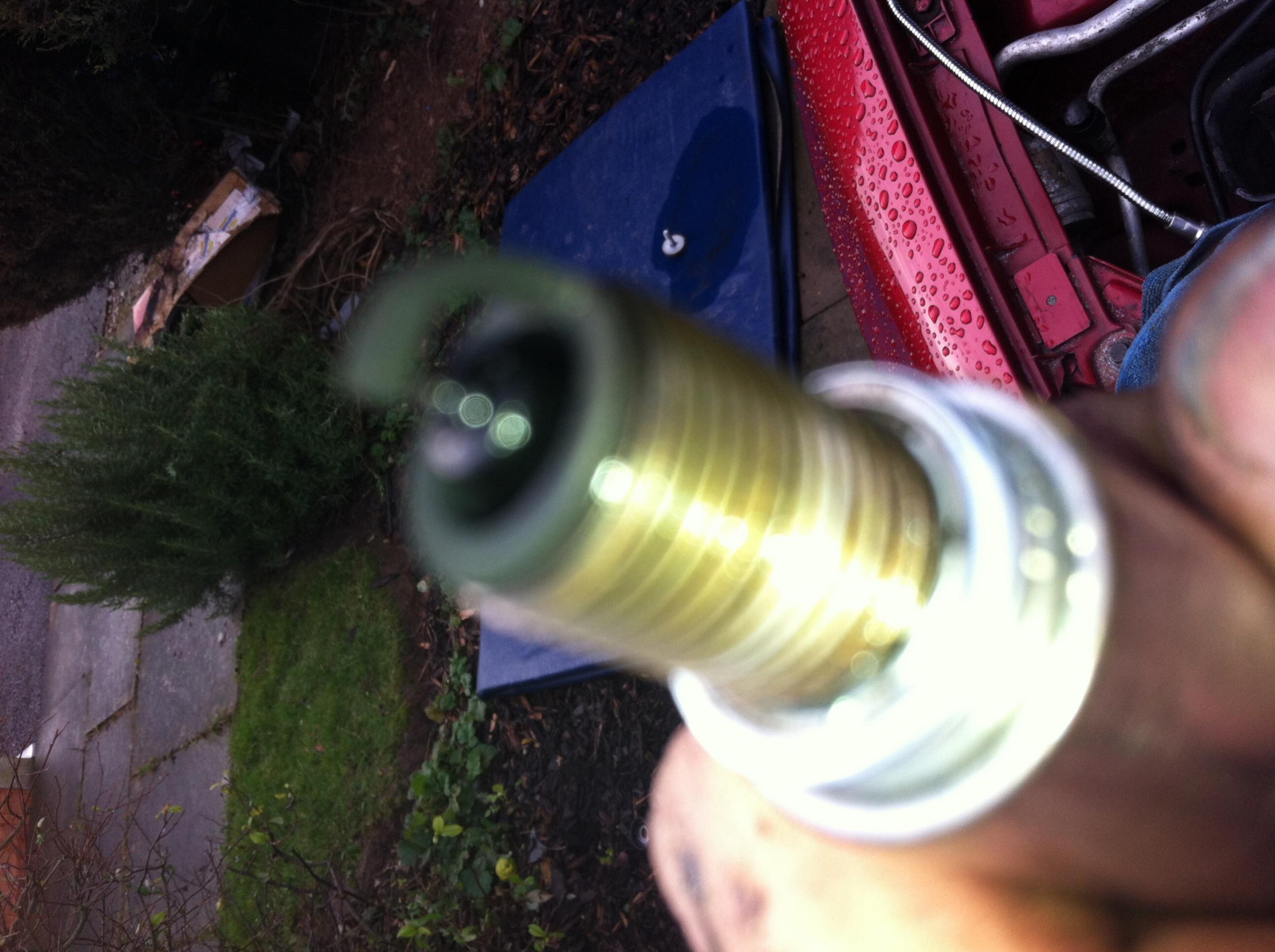

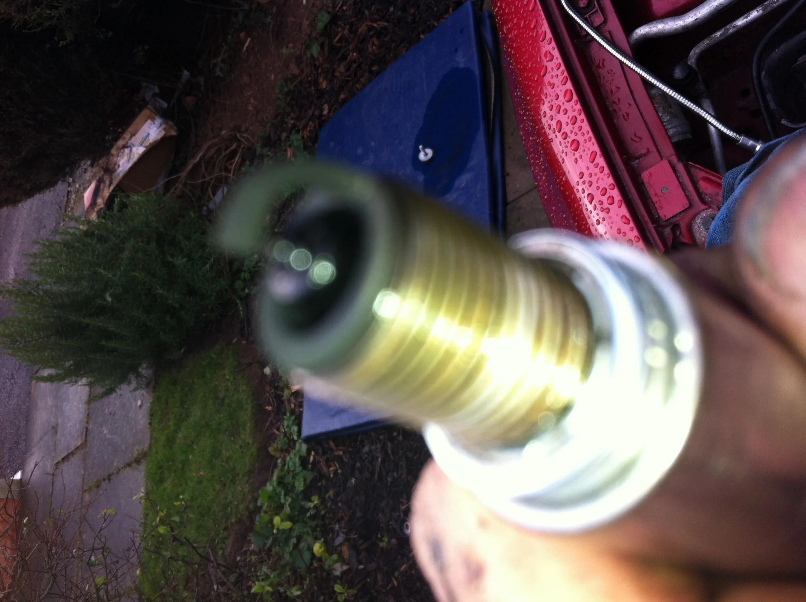

I think I have found the cause of my misfire , my plugs are getting soaked with fuel , it's had new plugs, leads , coil , crank sensor and now battery ..... I'm stumped lol

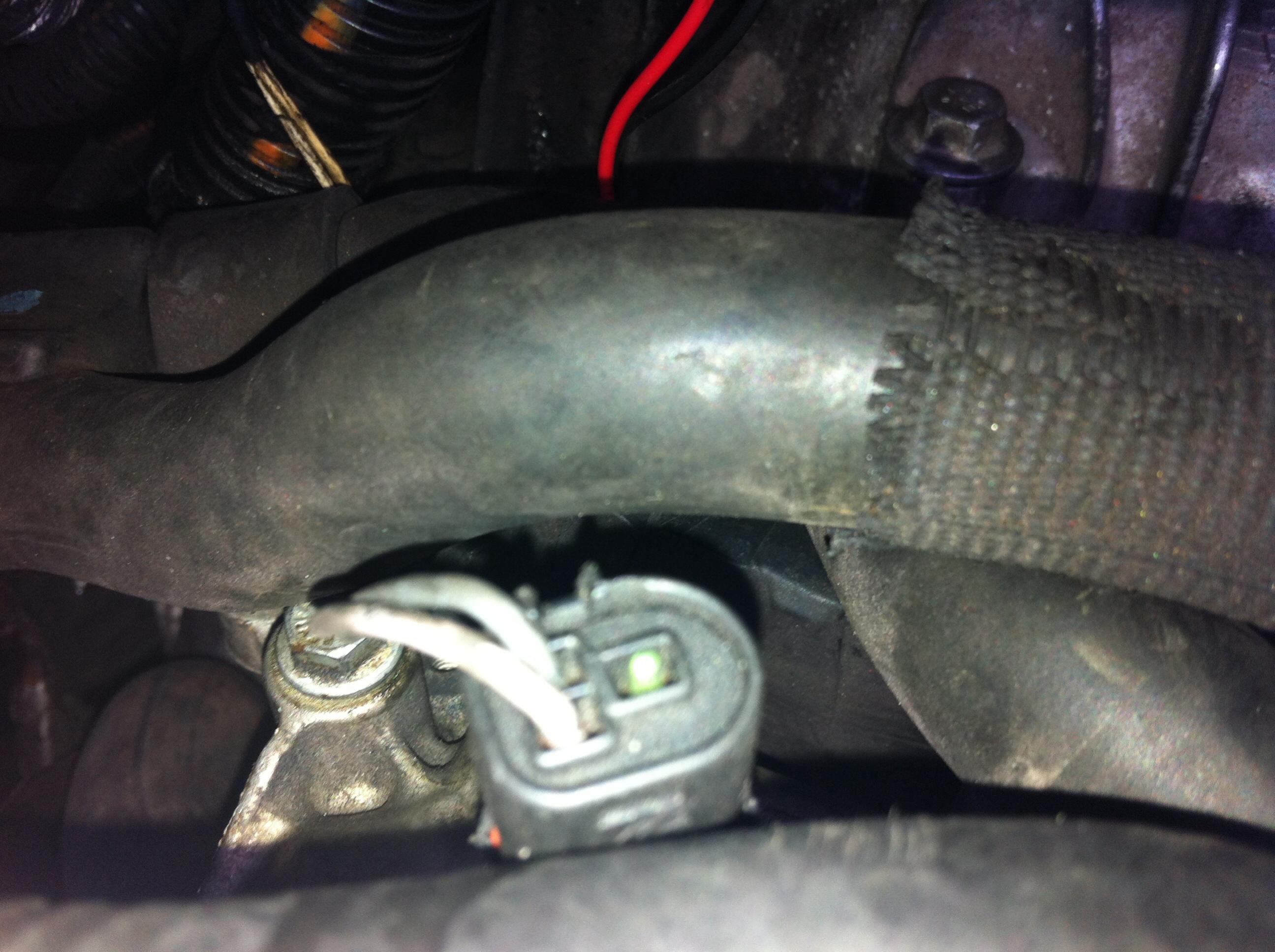

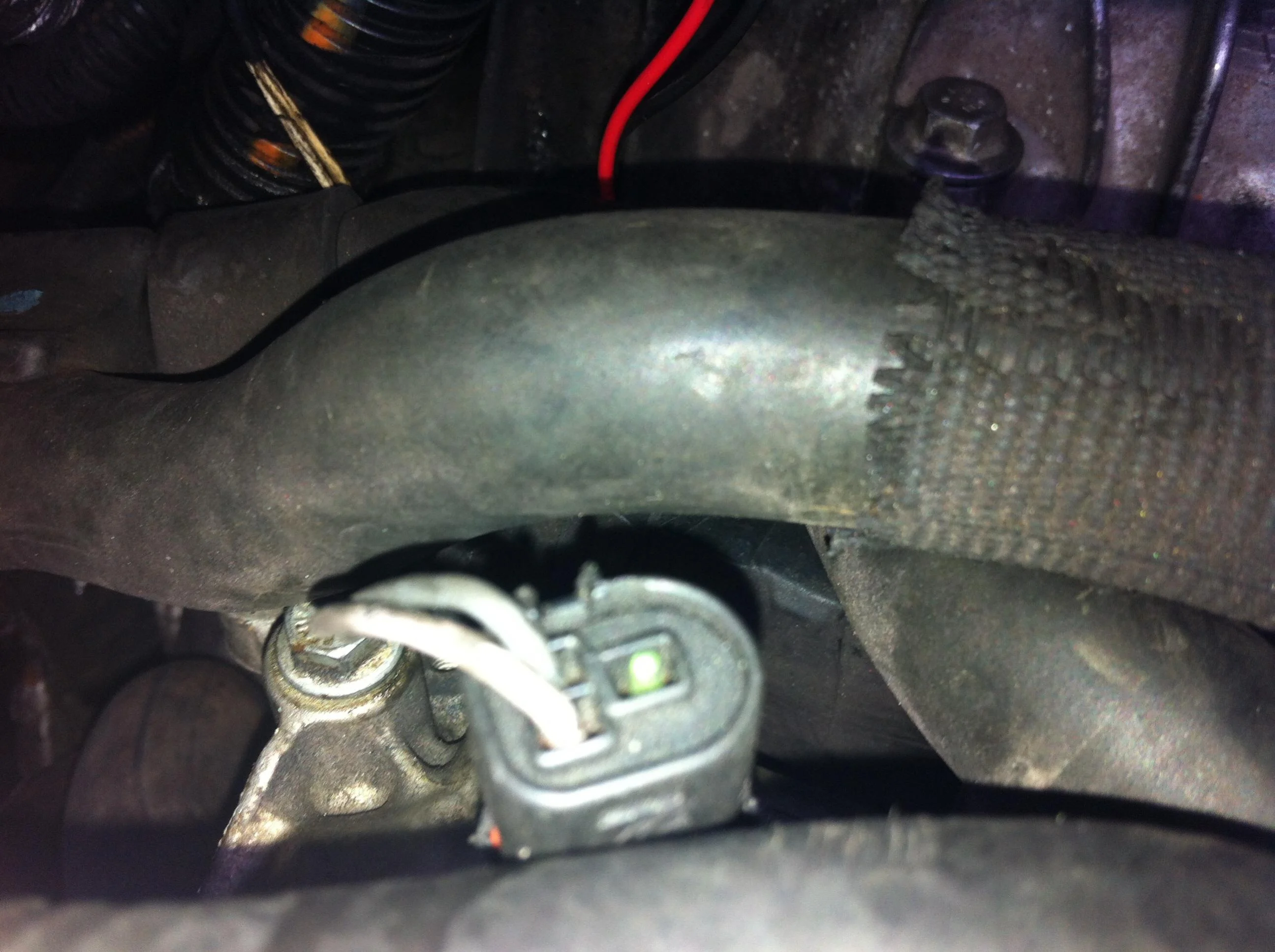

Using the right recommended plugs guys , my coolant temp sensor has a wire missing ( see pic) also it's just had belts replaced and dephaser done.

Also mate I have just noticed that there is no power going to the temp sender , and if I turn the car over when it's disconnected the cooling fan kicks in and it doesn't start
Don't think the fact the belts have been changed would of caused this. What work previous has it had?
Also that cts plug looks rather tatty
It had valves done and head gasket , valves were all checked after grinding etc , what puzzling me is that the is no power to the cts ,
It's over fueling, reason for the plugs being sooted. Take it it was running fine before you did the work? Just checking out some wiring diagrams now
Ha , that would explain that then mate lol , i disconnected the injectors 1 by 1 earlier and the engine not changed like it should too
It's whats known as a thermistor, resistance normally lowers the warmer it gets. Auto data doesn't contain any parameters/info for it though.
You will still get power at the CTS, how does the the ecu know what temperature the engine is if no power?
Sensor's are usually 0-5v varying with resistance.
A failed CTS would affect all cylinders equally and it may cause over fuelling depending on how it fails.
How can you know there is no power to the cts if you have not measured the voltage across it?
I just used a circuit tester on the wires going into the block connector on the cts mate
Tester? As in test light or multimeter? A multimeter will pick up the smallest of signal voltages. You also need to be whipping the cts out putting a meeting across it to measure resistance whilst its in a pan off water slowly warming up. Good way of testing them
Unless there's an issue with the ECU triggers this is most likely a faulty CTS.
