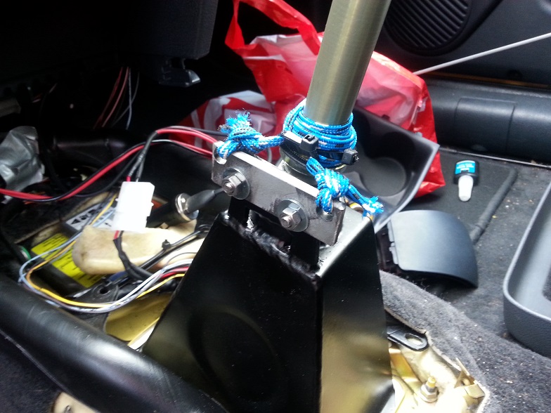

Sorry for the delay guys, here are my attemps with detailed pix :cool:
Attempt 1:
Results :
It reduced the rattle quite a bit. But i felt a better result was achievable.

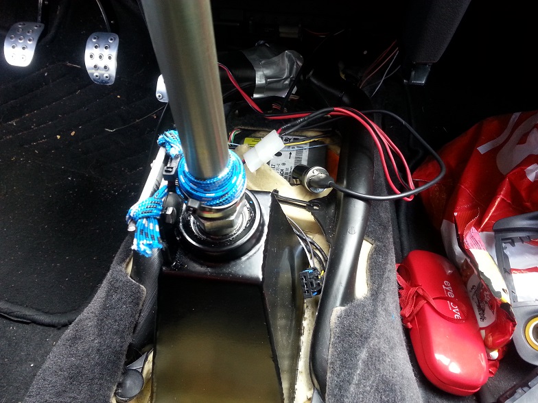

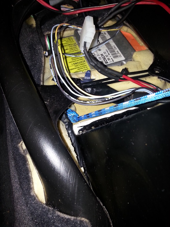

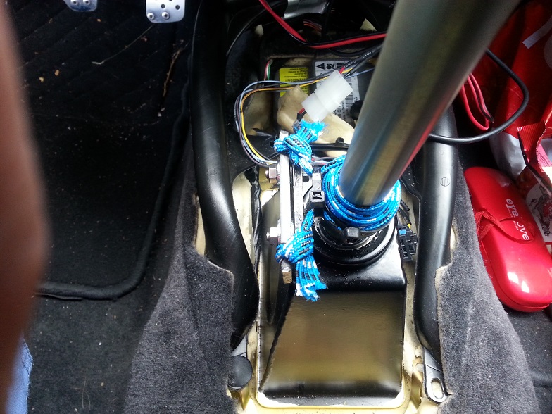

Attempt 2 :
Results :
I haven't driven it 5 miles with this fix yet, but already i can say this is going to be a better solution than the one above.
The trick is to get more force horizontally on this exact point. With the first attempt it didn't have enough force, but it reduced the rattle quite a bit.
This way you are able to adjust the strenght with the elastic AND the cable binder. Better to tweak it just like you want.
In 1st/2nd/3rd/4th there is very slight to no significant force, only in 5th (cruising speed) will it be most effective (which for me was the most annoying).
Ill post the results for a long run tomorrow :smile:
I don't think the issue is the spring though, I have tried driving the car without the spring or reverse sleeve on and it still rattles. I have now fitted springs tensioning the shifter and the rattle is minimal, (especially in 5th, which is all I care about)
