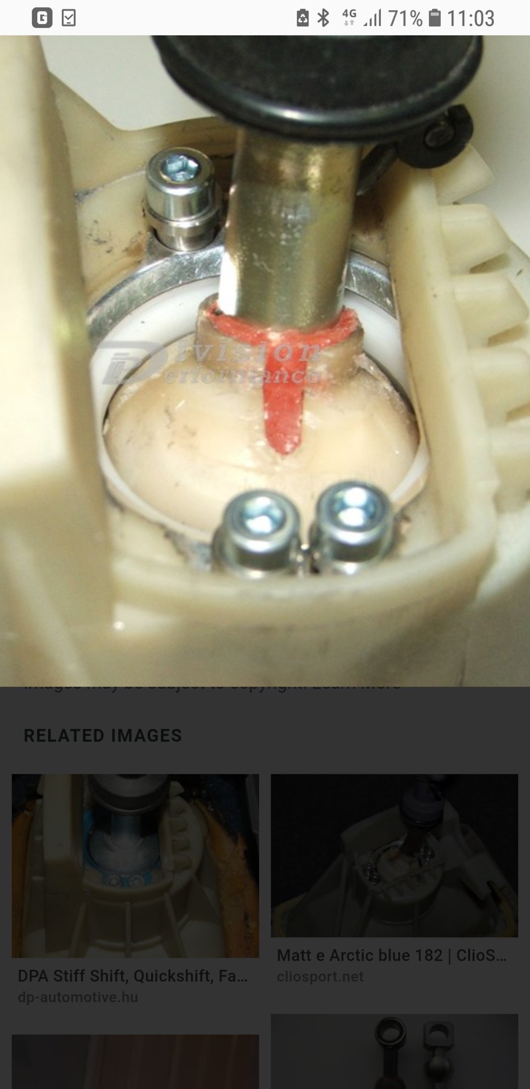

Back on topic though, I think there must be another issue if the yahnoo kit did not make much difference. Did you just fit the brass lower bushes? Mine has all the bits replaced where the gear stick goes into the lower section. I didn't bother with the brass bushes as were too stiff and there was nothing wrong with the origional lower bushes. Hope that makes sense.
This bit.....
