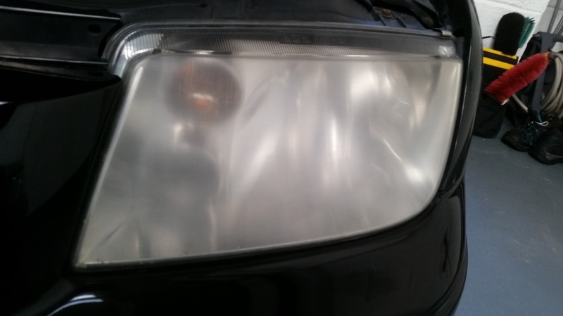

To start the lights weren't so bad. I ran the machine over them quickly when I detailed my car a couple of weeks before.
Still dull and a bit hazy.

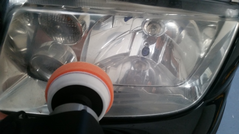

Starting at 1000 and working to 2500, they were wet sanded to remove the top layer with all of the yellowing, chips, foggy haze.

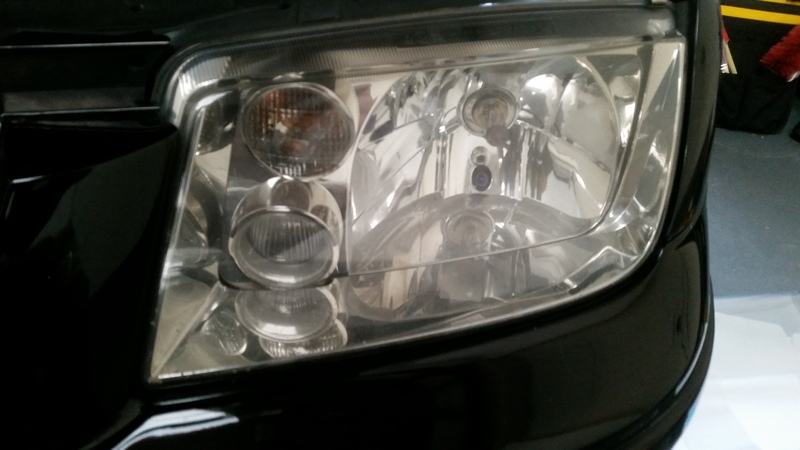

Using spot pads and a rotary polisher, the lenses were worked until the sanding marks had been removed.
Now, if they are left to the elements - they will drop back and cloud up again. Usually after a couple of months.

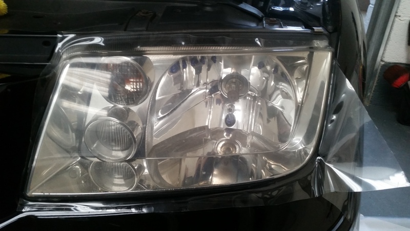

I apply paint protection film to the lens after a panel wipe.
This will give the lens protection against anything the road throws at it - grit, rain, stones, etc.

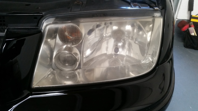

Trimmed up and finished :smile:

I apply this to a lot of cars with Xenon headlights and haven't had a problem yet. The adhesive is thermoset so there's no issues.
