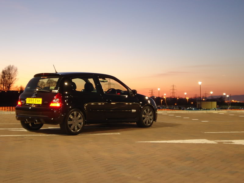

My old 182...
Massive amount of time and care taken to get it to this standard..

I have to say Alan that finish is sublime! Though i dont know weather i'm gonna shell out for the machine, i'll try by hand first see how i get on...

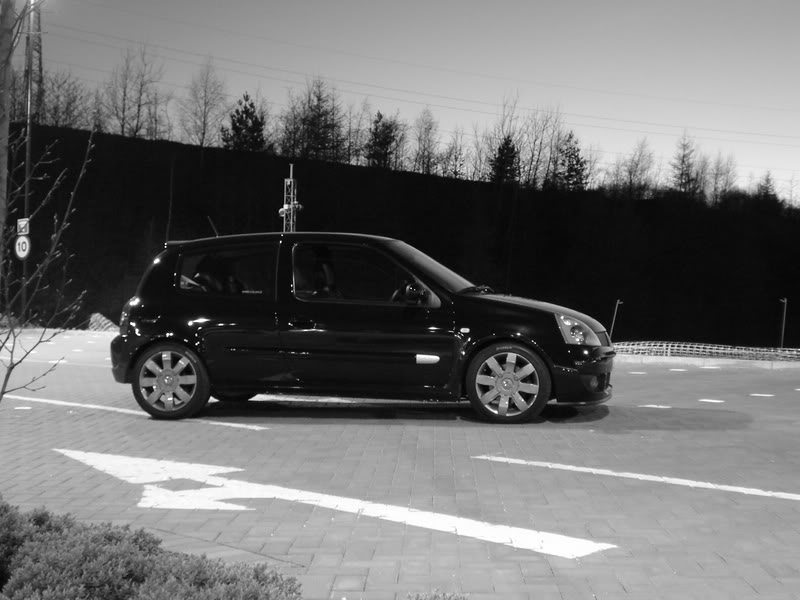

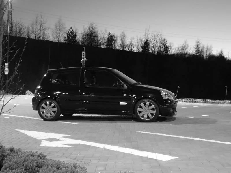

These are my results achieved by hand.
Wash with meguiars gold class shampoo,
clay with sonus green clay,
polish with auto glym super resin polish,
second polish with poorboys polish with sealent,
Wax with meguiars Nxt Teck wax x2.

Aluco - thats real talent getting that finish by hand, fancy doing mine too?
I think while good results can be achieved by hand, it will take a lot longer and wont quite deliver the same results as machine polishing.
