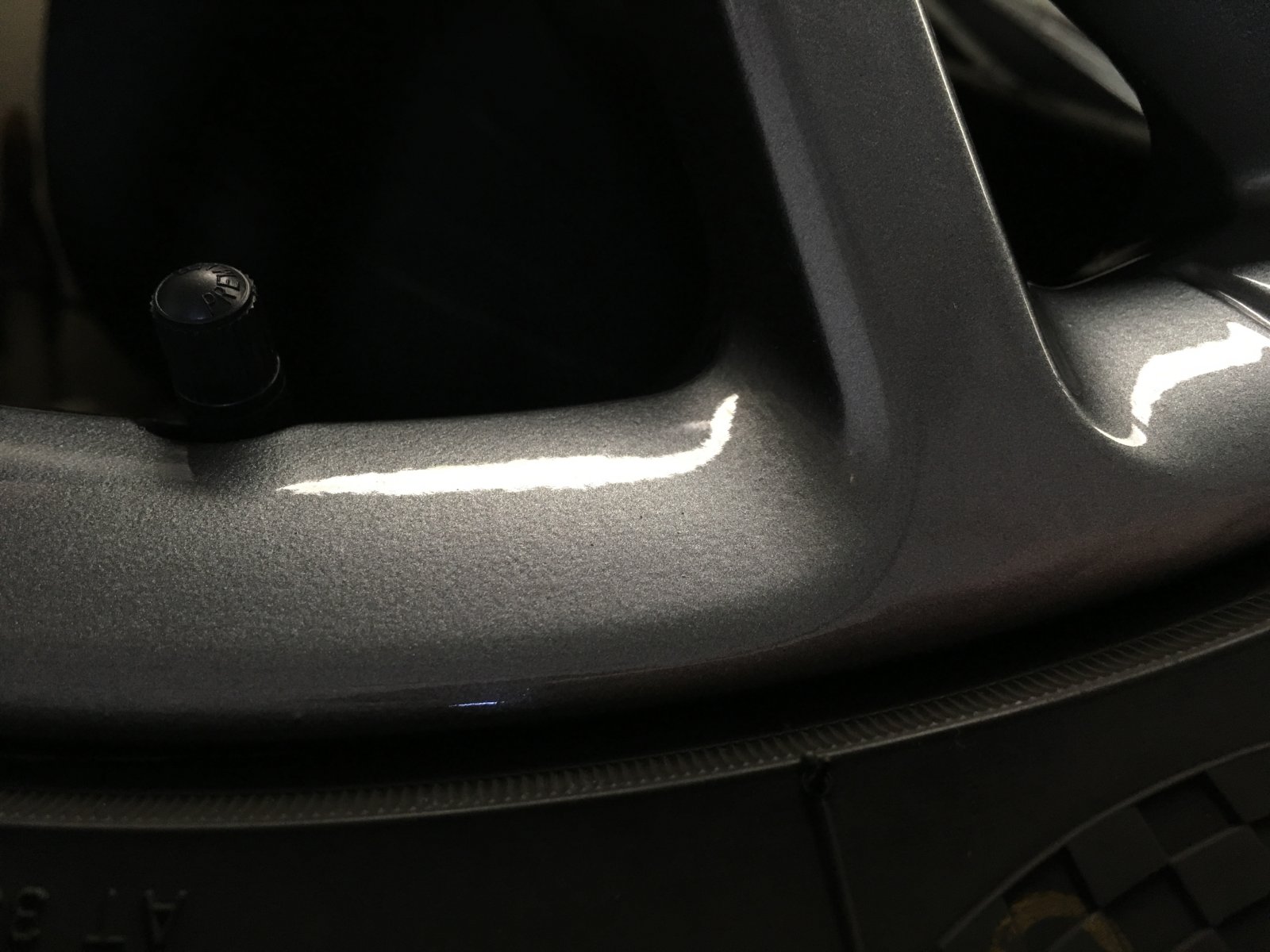

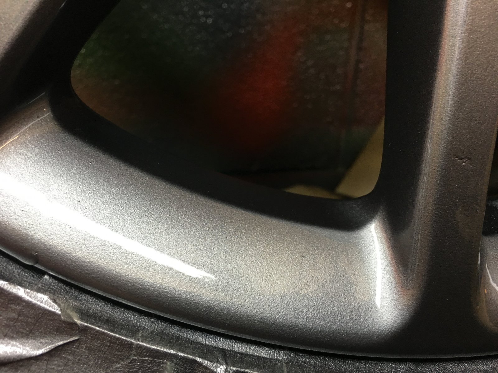

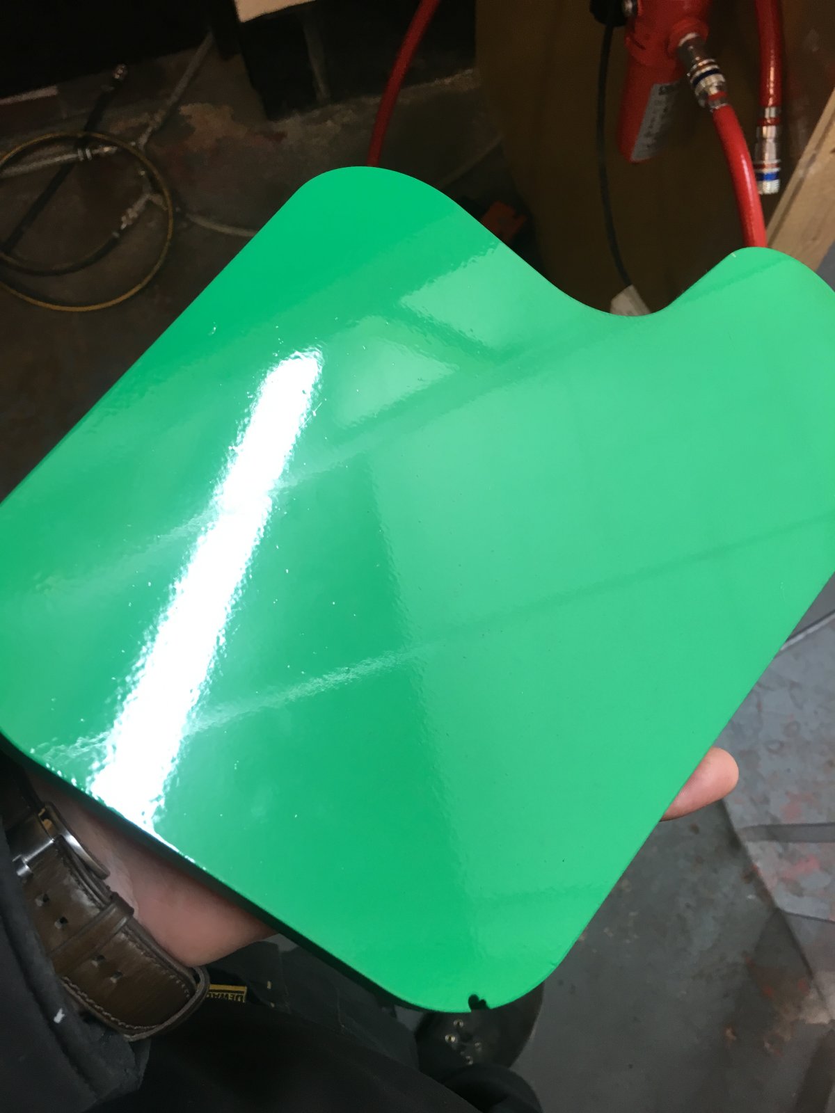

I've whored these around enough but until I find something else to paint, these will do.
A few colour coats of metallic followed by a 'dust' coat while the paint was still tacky.
The dust coat was to allow the metal flakes to stand up and not be pulled flat by the paint.
Once that dried, I did a close coat of lacquer, allowed that to tack off then two wet coats, allowing 10-15 mins in between to tack off.

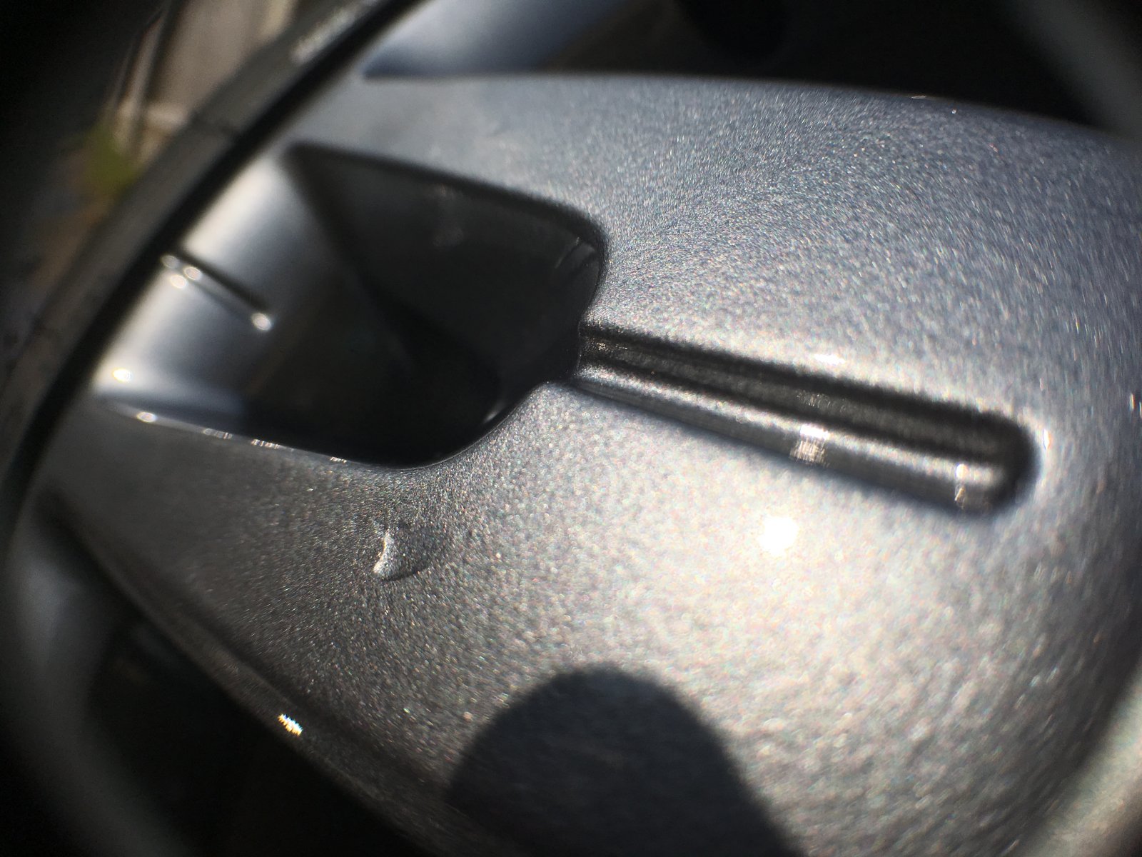

I can get the automotive paint (which I use for my own stuff) to fan reasonably well, 6" fan and even coverage while settling great.
But when I use the work paint, I can't remember exactly what it is but it's meant to be a 'single coat gloss coat', I can't get more than a 2.5" fan unless I go up to about 40% thinners.
The specified 10-20% thinners makes it flow and lie awfully, giving a nasty almost textured finish. That's fine for work, but I want to know why it does this and how to stop it without upping the thinners.

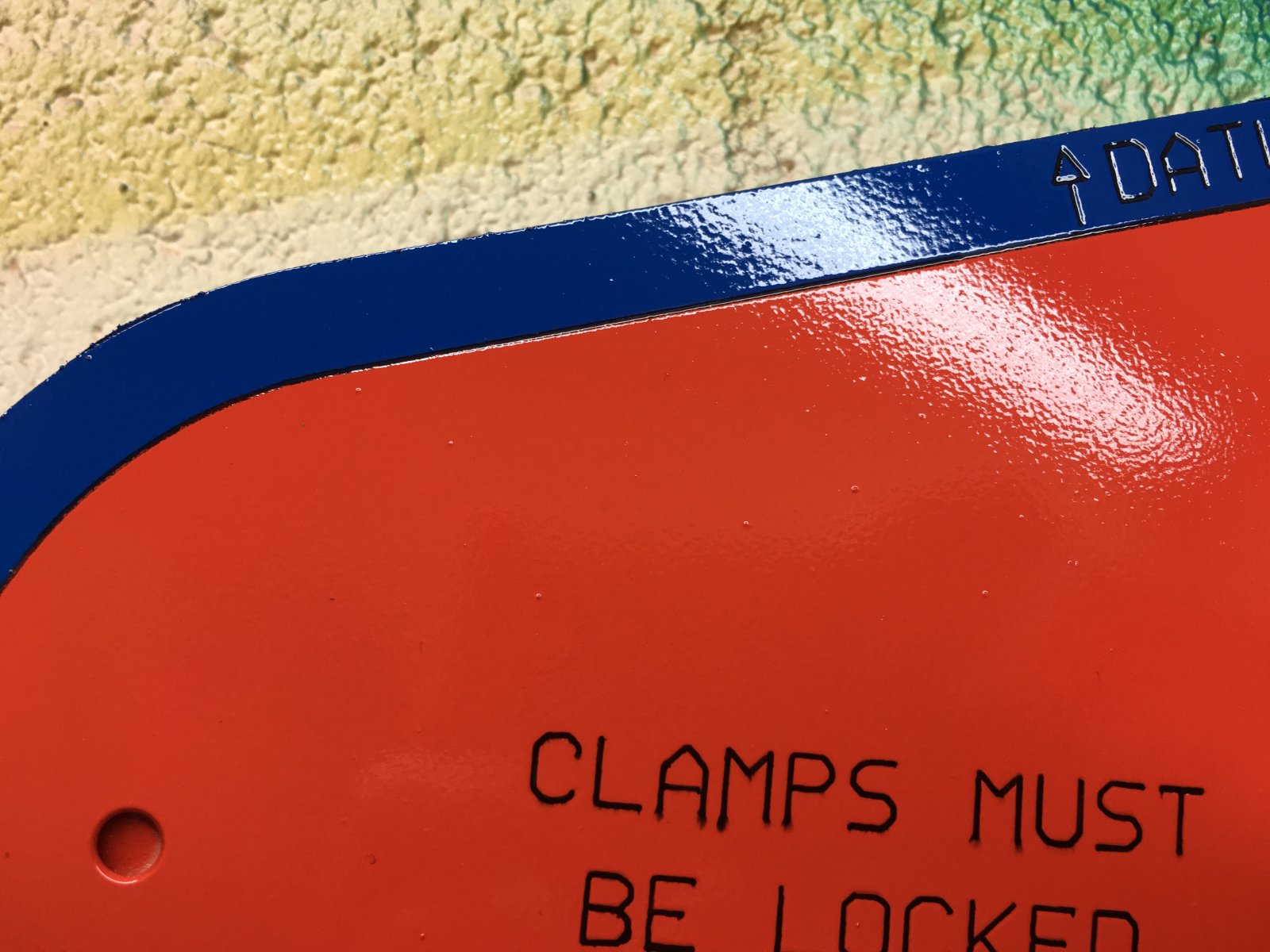

Here's what I mean, that has the lacquer over the top, but due to how the paint underneath was lying, I couldn't get the lacquer to settle right.
Now, I can flat the colour and/or lacquer back and flow coat the top coat of lacquer to get a nicer finish but that's not really ideal when trying to get jobs out of the door.

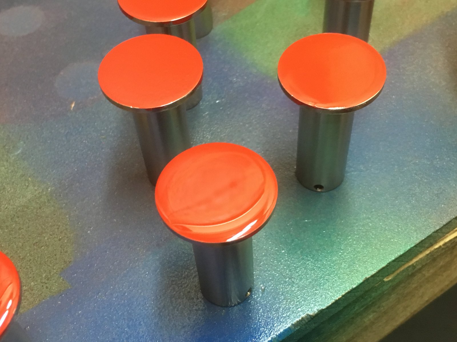

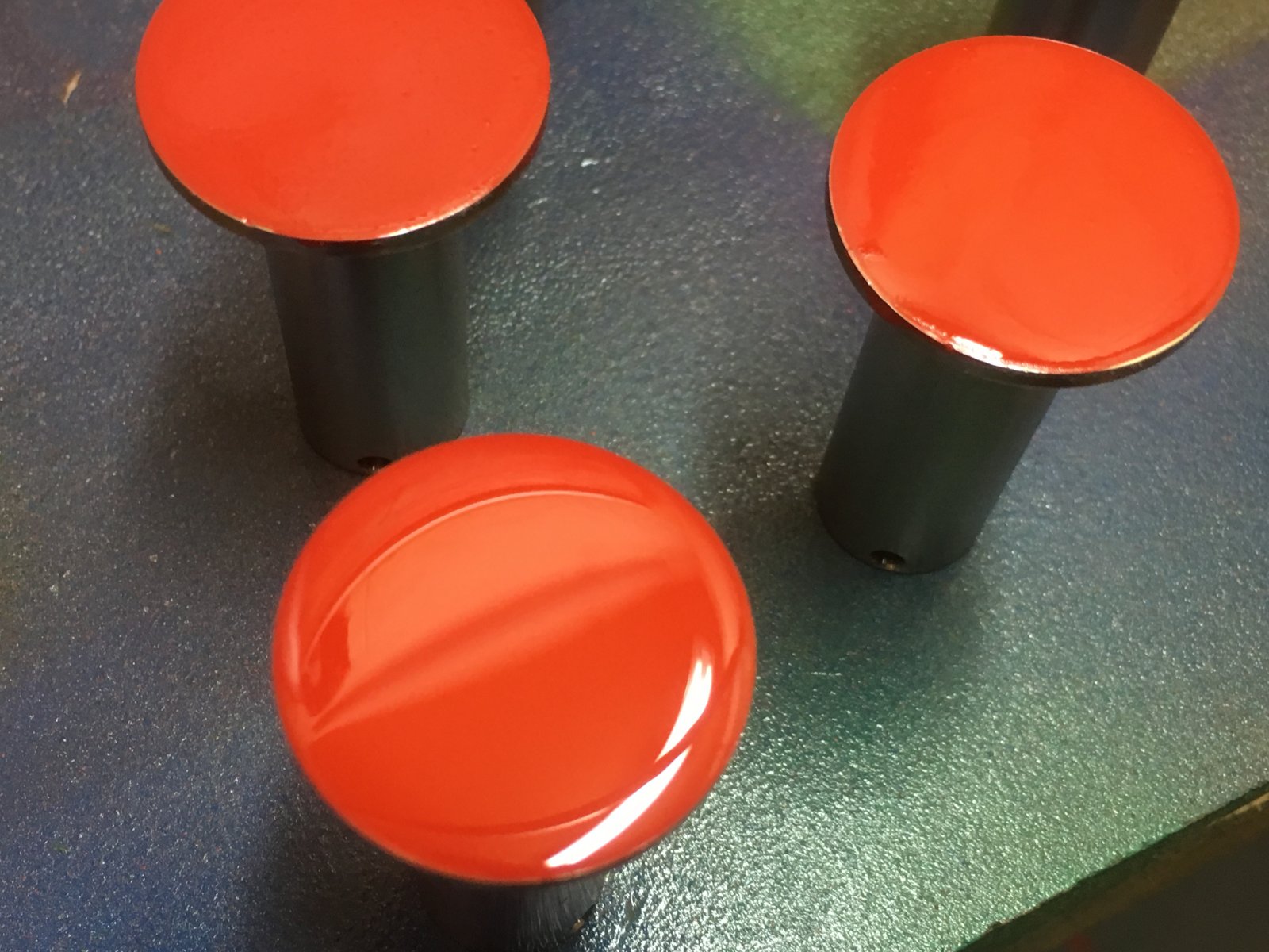

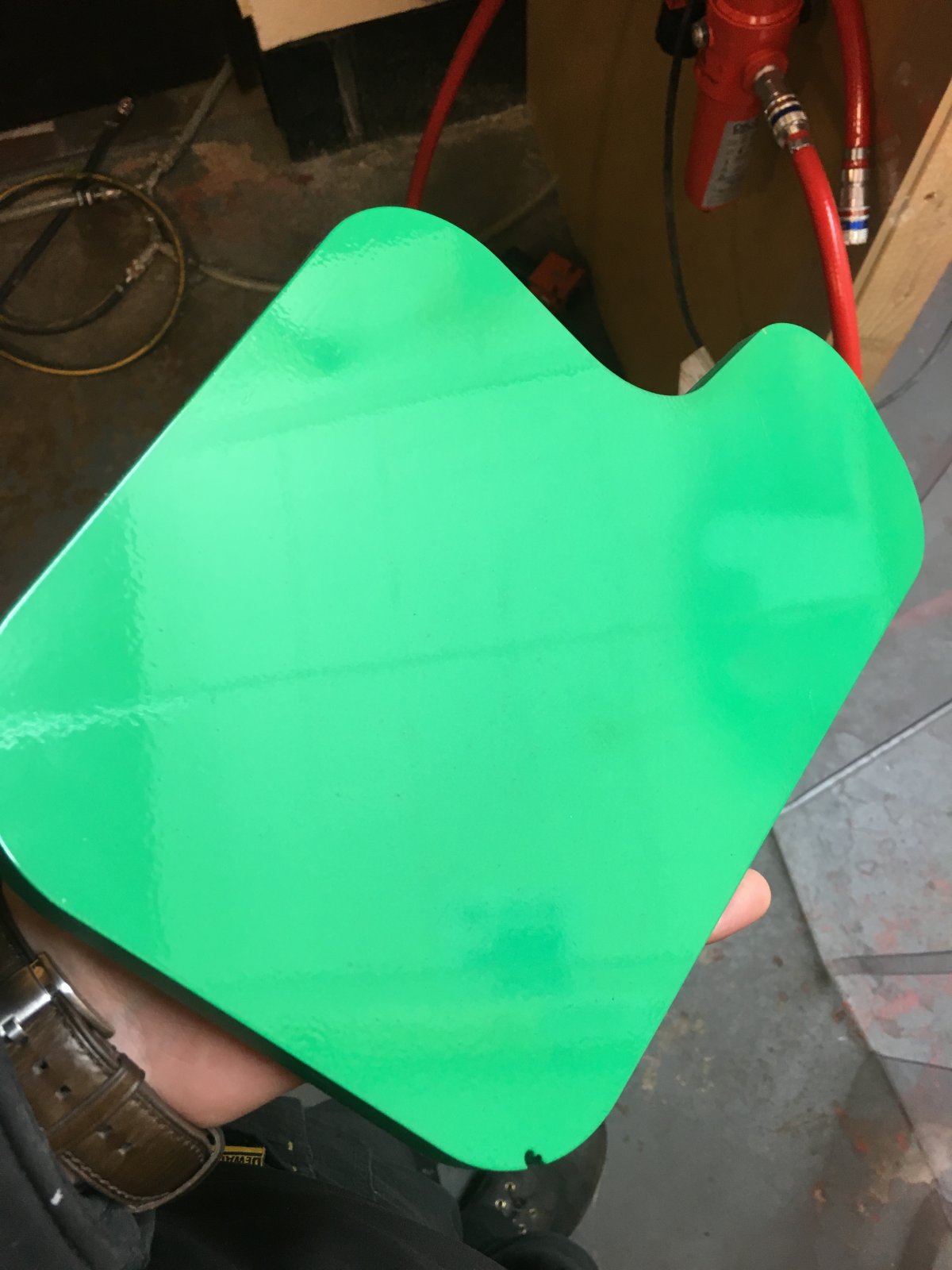

Here's one.
What will give a finish like this, but not take forever to dry, and be fairly resilient?
To get that finish I had to thin the paint quite a bit and properly lay it on to get it to pool up.
But obviously that's laid on thick and will take forever to dry. Is there anything quicker, easier and better to use?
I have 'epoxy resin' in my head but I can't find anything online which matches what I'm after

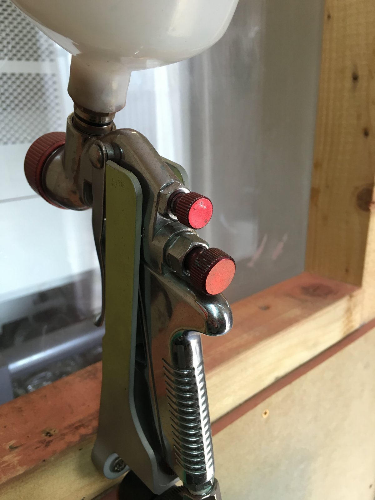

One is a devilbiss somethingorother
And this is the other, it came in some cheap looking box set but it works brilliantly with automotive paint, just not the s**t I use in work lol
