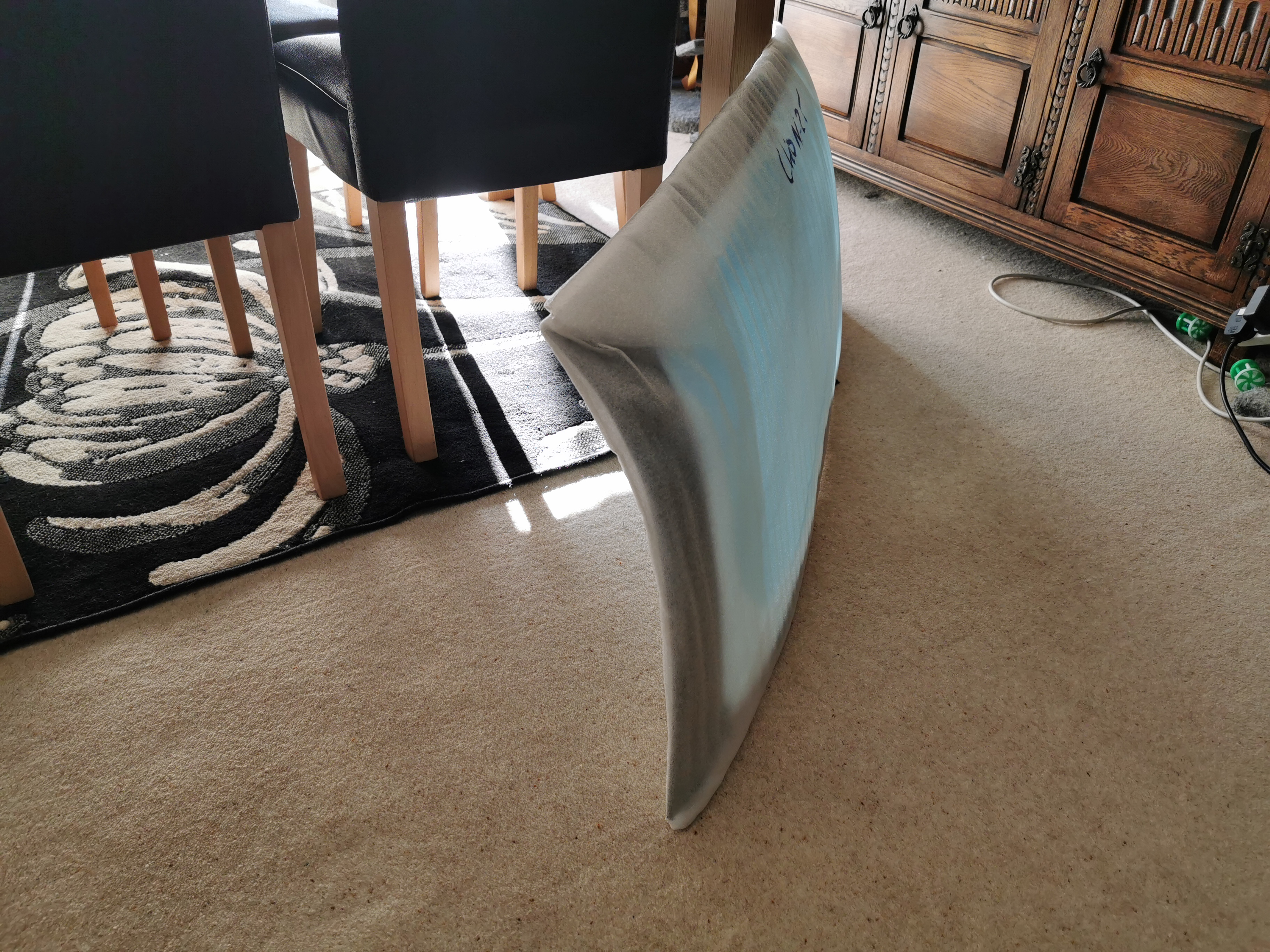

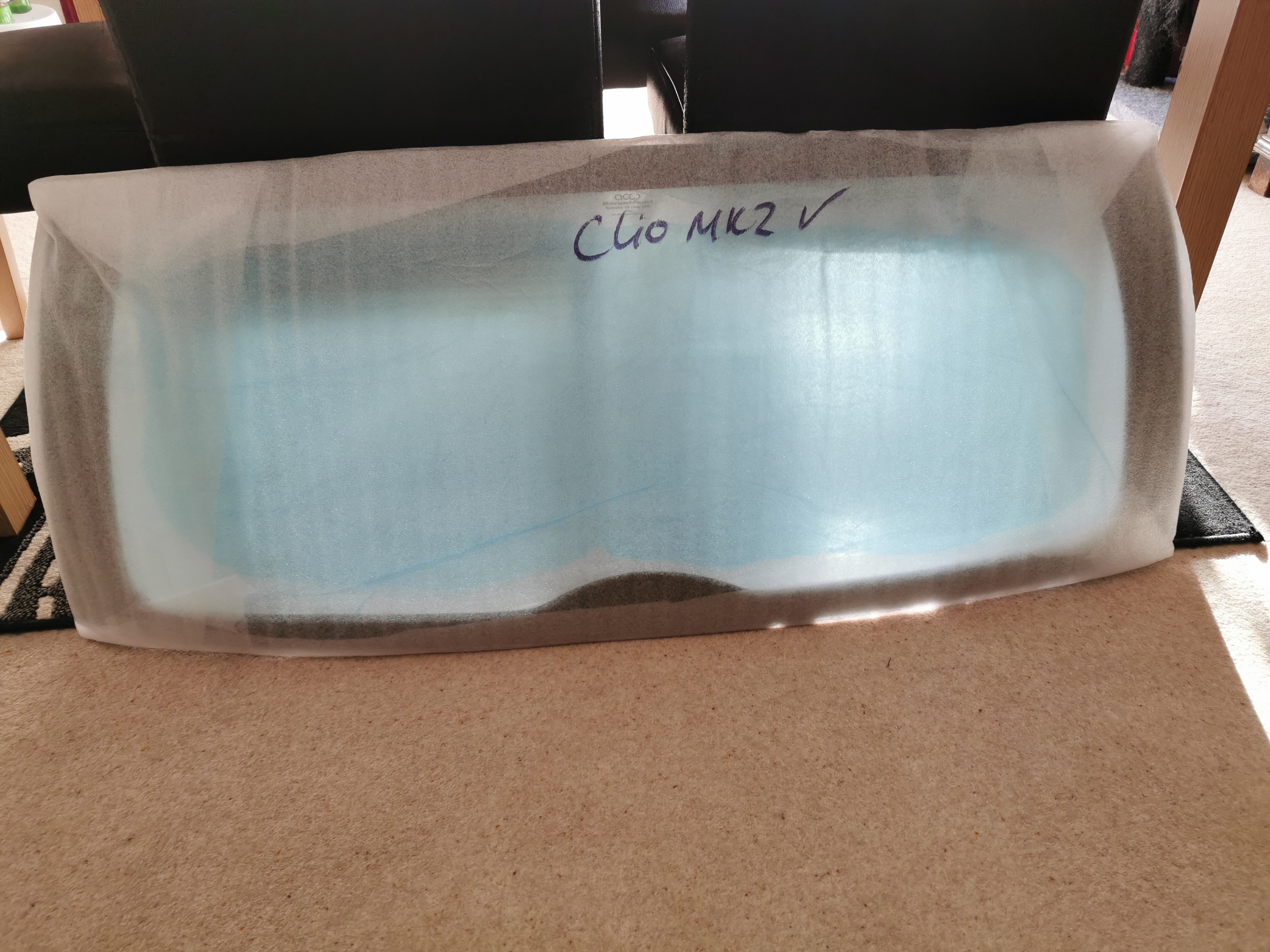

What does the thermoforming do , provide a fit / finish?
  Clio 172 Merc ML55
Yeah, it gives the original curved shape back to the windows, and possibly slightly more rigidity. It is an additional cost but I think it looks a lot better than just a flat surface either bonded or bolted in place, I'll stick a pic in of my rear screen (still covered in protective wrap but you'll get the idea)
